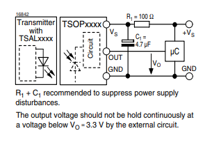

    khoam wrote:
    Maybe connect the power supply to the TSOP as DS recommends to start with:
    LED strip control with D1 Wemos + IR TSOP1736 by Domoticz
    Thanks!
    It helped, although, I remember running a similar circuit once and there everything worked without the 4.7uF capacitor....
    I will now check this RULES and let you know.

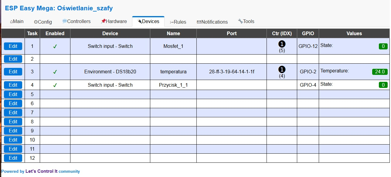

    Give a screenshot of the Devices tab.

    LED strip control with D1 Wemos + IR TSOP1736 by Domoticz .

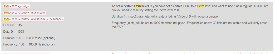

    I read on the forum that
    pwm,12,1024,1000,4000
    <pwm><GPIO><fill><time><frequency>
    and when switched on it brightens the LED strip, but at fill "0" it goes out immediately(no smooth dimming effect)

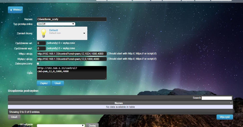

    my settings in domoticz
    the action that turns the LEDs on works correctly

    https://espeasy.readthedocs.io/en/latest/Plugin/P000.html?highlight=pwm
