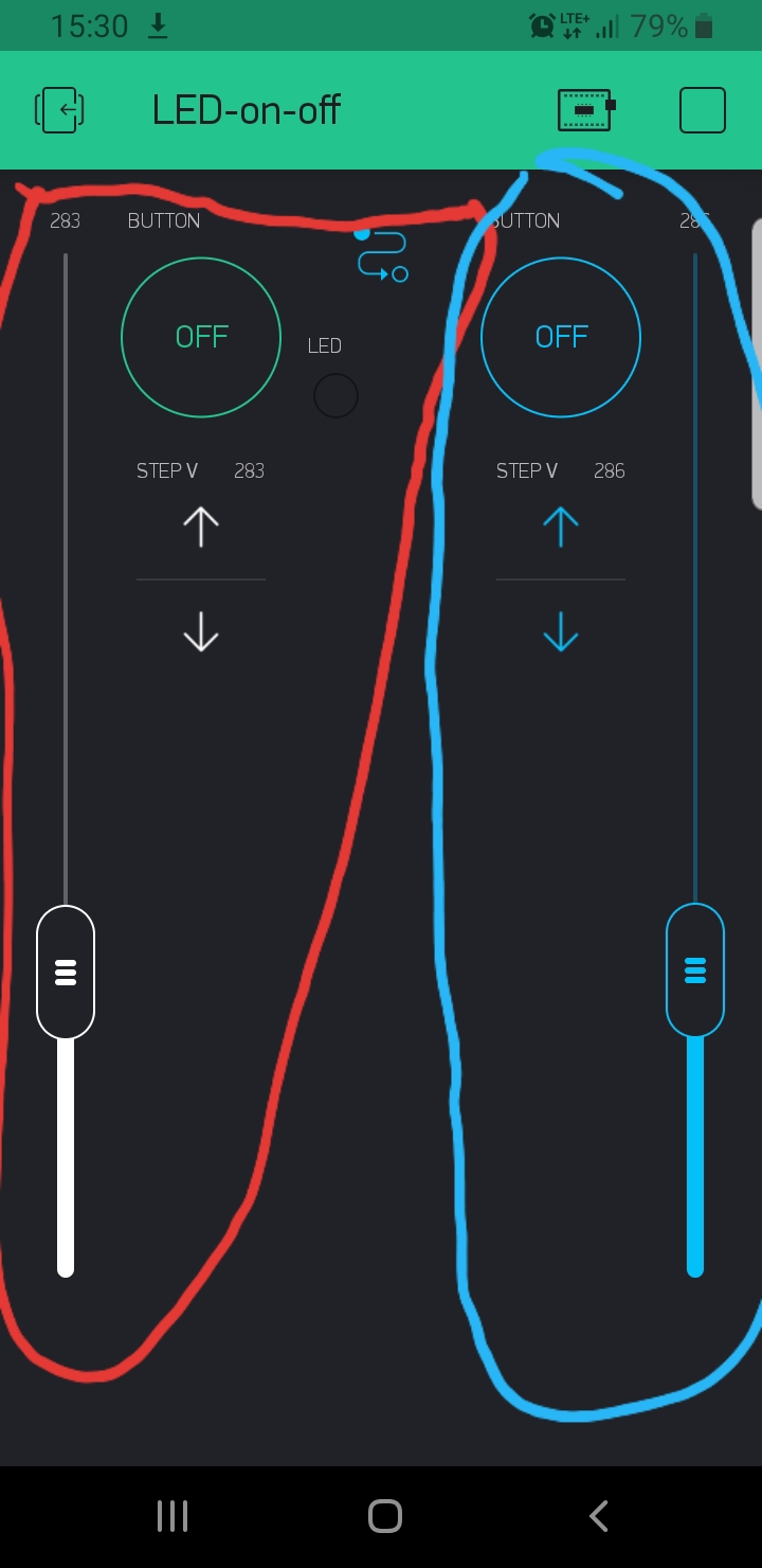

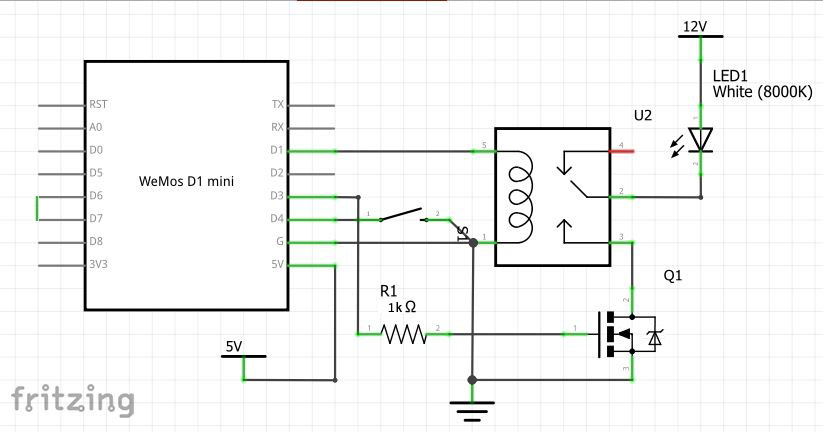

    I need to make a Blynk control via a WeMos D1 mini LED strip placed behind the TV.
    I have roughly grasped the subject:
    WeMos D1 mini connected via D1 to a relay for LED on/off
    Pin D3 via the IRL530N MOSFET controls the LED brightness
    Attached is a screan from Blynk and a schematic (with errors because I've only just started fritzing the first one).
    In red I have marked the WeMos D1 mini A to TV
    Blue WeMos D1 mini B to the led in the kitchen.
    The circuit is supposed to work like this.
    When the BUTTON button is pressed, it turns the led on, and the slider controls the brightness of the LED light
    From the blynk itself everything works ok, however I need to add a physical bell button to the D4 which will also turn the led on and off. LED.
    I do not know how to combine this in the program code.

    I have added a button with the D7 pin in the blynk
    It works but sometimes it switches itself or blinks.

    only how to add a physical monostable button here?
