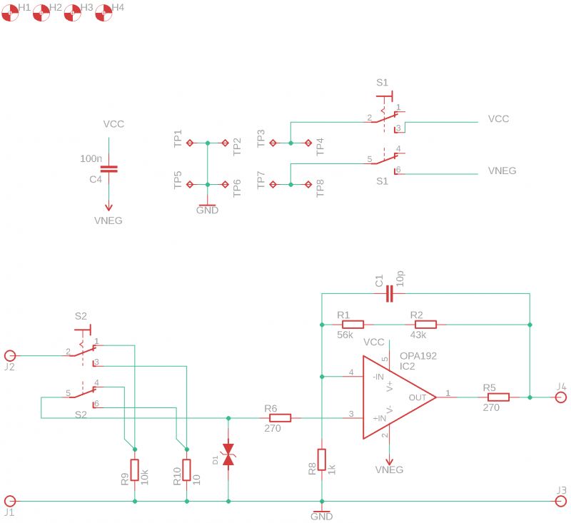

    I decided to make my version, slimmer, cheaper, but with similar (or even better in some respects) parameters.
    What did I not like about the original?
    - Power. One CR2032 battery and artificial zero. The circuit is complicated (like one opamp, but always), and the power supply of the output amplifier is only +/- 1.5 V.
    - The use of two expensive and hard to reach opamps in the amplifier. The cascade circuit improves the frequency response a little compared to one amplifier with higher gain, but is megahertz important, for example, when measuring the current consumed by the circuit in the sleep state?
    Changes made by me:
    - Two ranges instead of three. Each multimeter measures the milliamps, and for the oscilloscope you can use a resistor in series.
    - Easily available operational amplifier - you can buy it at TME.
    - Power supply from two 12 V batteries. This gives an output voltage range from 0 to 10,000 mV, so in the nA range I can measure currents from 0 to 10 uA, and in the uV range up to 10 mA. This is 10 times more than the original.
    - Place for a diode protecting the amplifier input. Just in case.
    - I also resigned from the battery voltage monitoring system.
    Thus, the layout was created as in the diagram. Simple, not to say primitive.
    Circuit diagram of a device featuring components such as resistors, capacitors, and an operational amplifier.
    The value of the capacitor C1 has been transferred from the original schematic - if necessary, I will try to improve the compensation using a generator and an oscilloscope.

    The offset voltage is less than 1 mV. With the input shorted, the output voltage fluctuates in the range of 0.3 to 0.8 mV.
    The accuracy of indications is surprisingly high, better than 0.5%. But I assume it will be safe to assume 1%. Calculated using the technical method, because I have nothing to calibrate this device with. Yet the meters I use to measure voltage and resistance have their limitations.
    The voltage source was a 3V battery, a current limiting resistor in series and my adapter. The voltage is measured at the ends of this series circuit, and its total resistance, including the leads, is measured with a multimeter.
    For the uA range:
    At the entrance = 3.1630 V, R = 99 890 ?
    And the theory. = 31.6 uA
    And d. = 31.8 uA
    error = 0.42%
    For the nA range:
    At the entrance = 2.9434 V, R = 5134000 ?
    And the theory. = 573.3 nA
    And d. = 574.4 nA
    error = 0.19%
    Enough for me.

    1. How with the stability with ordinary resistors?

    The original has a near-zero DC offset and drift through the use of autocorrelating zeroing techniques ", how can the effects be affected by using OPA192 instead of MAX4239?
    Maybe you will make a wider production available for purchase, e.g. on auction portals, or maybe it could be introduced to the elektroda.pl gadgets? ;)
    What do you estimate the cost for unit production or the final price for small lot production?
    OPA192 landed there a bit by accident.
    Now I see that TME has MAX4239 in SO8 housing, but I didn't see it then (or it wasn't on offer). Besides, its power supply is +/- 2.75 V maximum, so I would have to stay with two 1.5 V batteries, or one 3 V with artificial zero. I was looking for something else, so I didn't focus on it.
    Then the OPA189 caught my eye, which has a similar offset to the MAX. But it is also missing from TME. There is OPA192, which statistically has a larger offset, but when I measured what I have, it satisfies me. Maybe I drew a good copy :-)

    Regarding the amplifier error, you might have added some compensation. The 100 k? potentiometer, the multiturn, is best connected between V + and V-, and its brush through the 470k-1M resistor to the IN-pin of the amplifier. An even cooler option would be to add an input stage on JFETs with compensation. The cost is 4 NPN transistors, two JFETs, 6 resistors and one potentiometer.
    But why? Secondly, it will not compensate for it as there are amplifier inputs, it is better to give an amplifier with processing.

    @Janusz_kk
    I was thinking about something like this:
    Electronic schematic showing a circuit with transistors, an operational amplifier, and resistors.
    Q1 and Q2 should be glued together, as well as Q3 and Q4. R1 and R9 should be of the best possible quality. I did not choose the Rs value. Control should be started from R12 at the positive input of the amplifier shorted to ground. Then R10 is regulated when both measuring inputs are shorted to ground. The circuit has a significant input impedance, so you need to take care of good cleaning after soldering and, optionally, painting it. Overall, this should work fairly decently.

    I guessed :) except that this system does not exist here, this is how the oscilloscope inputs are made, which must be high ohmic, but here the gain from it is negligible, because we do not need such a high resistance, and the flow of the entire system will destroy the good parameters of the operational amplifier, all the more so, that there are amplifiers on fetal inputs on the public and you do not need to organize such guerrillas, moreover, look at e.g. AD8551, input current

    there are amplifiers on fetal inputs available to the public and you don't need to organize such guerrillas
    In the diagram @Urgon is the LF356 which has this feature: "JFET Input Operational Amplifier". I am also eager to find out why it is worth adding a handful of discrete elements to add a JFET buffer to the JFET input.
    This is from the LFx5x datasheet including LF155, LF156, LF256, LF257, LF355, LF356, LF357 amplifiers

    There is an error in the feedback circuit in the diagram - wrong resistor values and wrong connection layout.
    You're right, it doesn't make sense a bit to be honest. I used the schematic for a good op-amp simply. But I thought that by adding three relays, converting two potentiometers to digital and adding ADC, you can make a micro / nano / picoammeter with auto-zero offset and temperature drift.
    EDIT:
    One advantage of such a solution, as I showed, over the "naked" op-amp - the polarization current can go below 1pA (LF356 has 30 pA, OPA192 has 5 pA), so the noise would be lower. But you probably need to choose better transistors.

  • OPA192 lacks autocorrelating zeroing advantage
    #27 19489620
    linuxtorpeda
    Level 26  
    Posts: 825
    Help: 93
    Rate: 295
    TechEkspert wrote:
    Original has near-zero DC offset and drift through the use of autocorrelating zeroing techniques ", how can the effects be affected by using OPA192 instead of MAX4239?
    The original basically eliminates the imbalance voltage drift caused by temperature or aging of the system. If we use an amplifier without this functionality instead, we might as well insert any amplifier with high impedance inputs there and calibrate the offset voltage with a potentiometer before each measurement.
    As for me, the circuit with another opamp in this project misses the point and only feeds on the popularity of the original solution, unless the author would try to implement the above-mentioned "autocorrelating zeroing" using cheaper and more widely available components.
