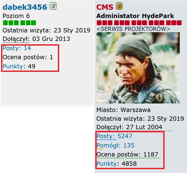

    Buddy Dabek, instead of criticizing someone who voluntarily conducts tests for you in his spare time, and then describes it, also in HIS FREE TIME, I suggest you write an article yourself, or at least read Article - How much time and work the Editors of Electrode spend for you.
    I will add this photo:
    Current source, 4-20mA Signal Generator - Test / Review / Opis
    I am still not going to comment on your statements.

    You answered sharply and principally, but my colleague Dabek deserved a sharp retort.

    Maybe I rose a little, but as my regular reader you know perfectly well how much nonsensical * I have to read sometimes in the comments. And an administrator, moderator, or editor is also a human being and has limits of patience.
    * even about a draft in the room and loose wires during the reference voltage test. I am surprised that then I managed to refrain from commenting ...

    Nothing at all. I like your answer with "picture script" or as you called it "picture" :|
