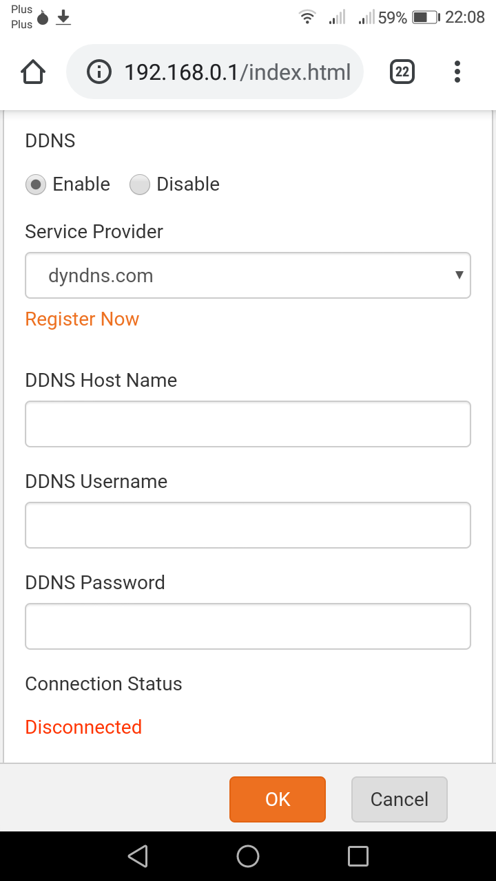

    Until such an old man? Have you checked if there is a newer FW for it?
    In the router, show your DDNS settings.

    Butthead
    Posts: 120
    ... Please, here are my DDNS settings.
    I do not see.

  • #36 18934118
    Butthead
    Posts: 120
    I can't see because I don't use ddns ... Normally I have disabled option.
  • #37 18934136
    sosarek
    Posts: 83875
    Help: 9320
    Rate: 15532
    What is this router, what provider?
    You can use dyndns if you have a public IP address.

  • #38 18934166
    Butthead
    Posts: 120
    The router is a poor F3 tenda so I can have a fixed IP. What is it exactly?
  • #39 18934168
    sosarek
    Posts: 83875
    Help: 9320
    Rate: 15532
    If you can buy a fixed IP, it will be the best, the easiest and the safest because you connect directly, then on the router it is enough to redirect the ports to the IP address of the recorder.

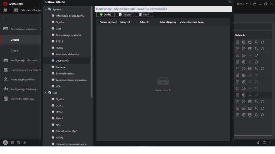

    avatar255
    Posts: 532
    Rate: 61
    Thank you for such a configuration through the cloud.
  • #52 20244335
    avatar255
    Posts: 532
    Rate: 61
    @sosarek Are you talking about managing the recorder via the cloud from this menu?
    Hikvision Remote Access: Cloud Configuration for Cameras Worldwide (No Public IP/Router/DDNS)

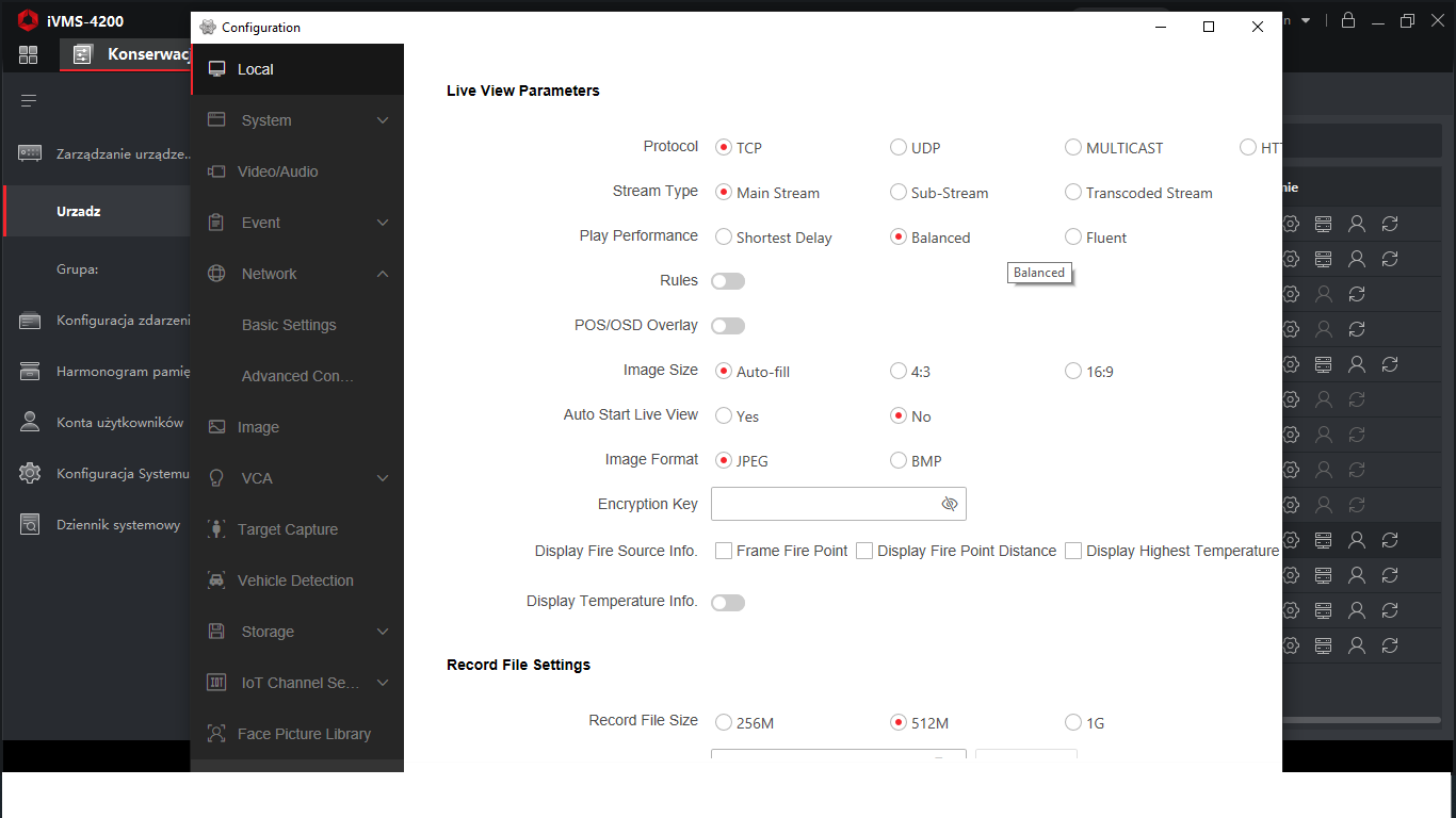

  • #54 20244358
    avatar255
    Posts: 532
    Rate: 61
    @sosarek It is probably underdeveloped IVMS software as soon as such access is possible. Don't you think ...? How does this compare to e.g. Dahua?
  • #55 20246213
    avatar255
    Posts: 532
    Rate: 61
    @sosarek I mean access to such a menu, unfortunately it does not work with HIK Connect.
  • #56 20246332
    sosarek
    Posts: 83875
    Help: 9320
    Rate: 15532
    Then log in to the application with the account to which you have been assigned the recorder.
