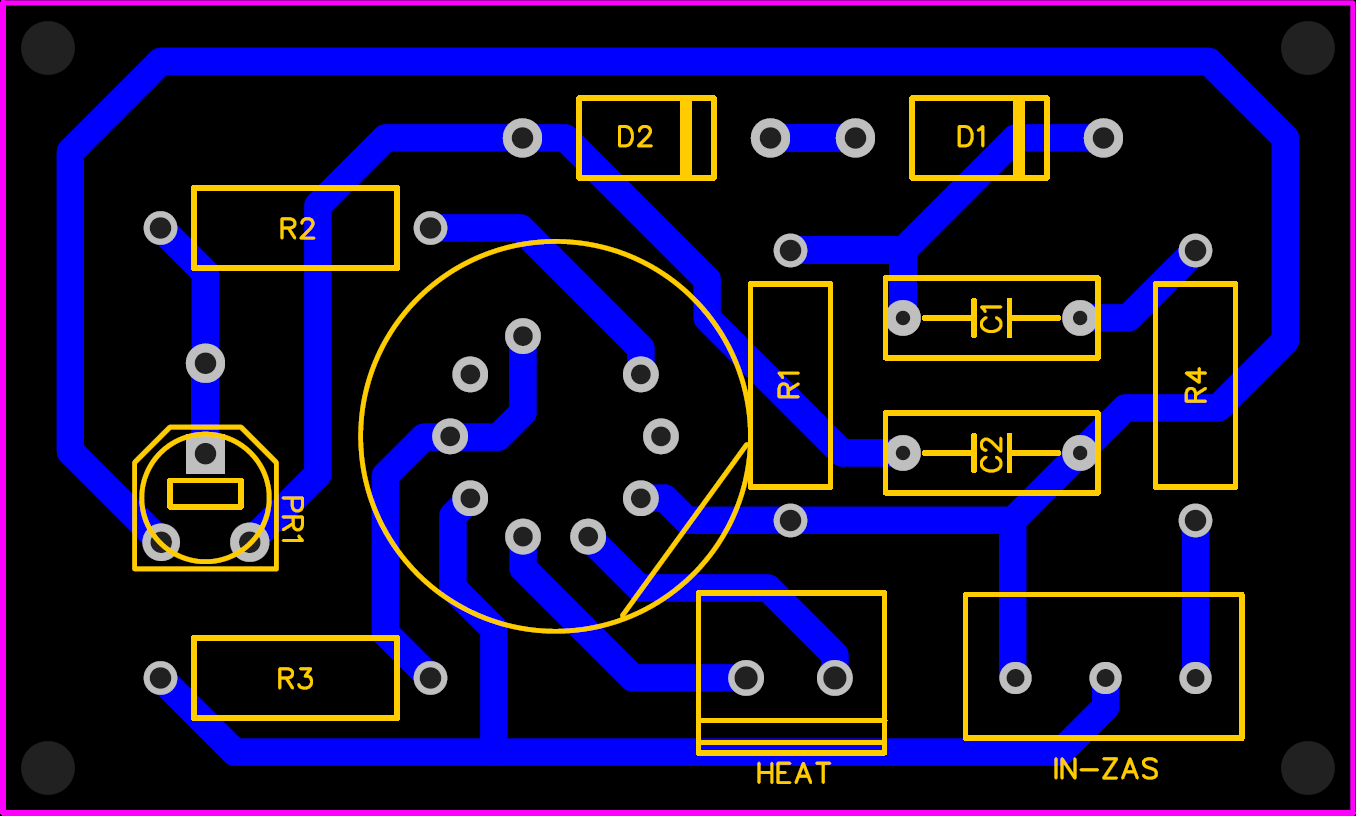

    @DJCheester Thanks for the answer.
    And what do you think about such a solution:
    ECL86 and EM84 Tube Amplifier - PCB
    Thank you in advance for your answer.
  • #62 20184351
    DJCheester
    Level 28  
    Posts: 2090
    Help: 75
    Rate: 958
    After all, the same is only on yours, there is a divider at the input, two resistors and in mine there is one rest the same.
    Compare, best regards ...
  • #63 20184373
    mariosvd
    Posts: 29
    Apparently so, but I replaced two diodes connected in series with one and replaced the 330k resistor with a diode.
    The question is whether, thanks to the lower voltage drop on one diode, the magic loop will react more quickly?
    Kind regards.
  • Magic eye circuit tuned with 15 kΩ and 100 nF input

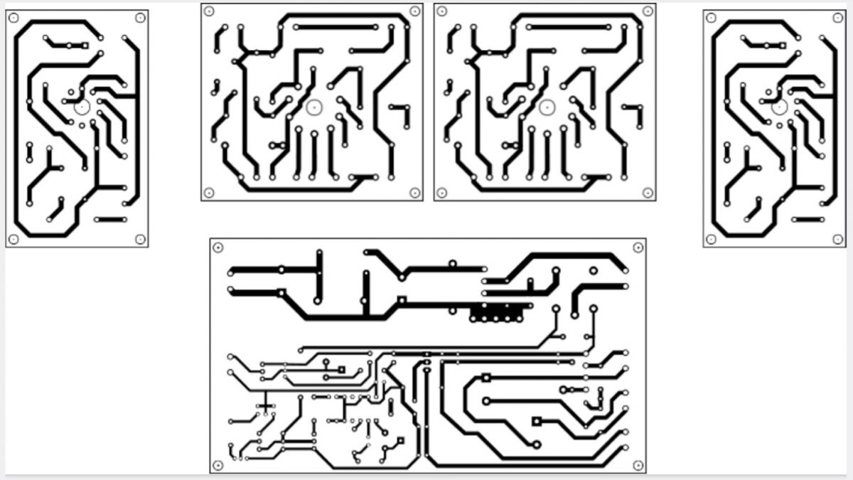

    Hello everyone very warmly.
    The motive for writing this post is the completion of the construction of my amplifier based on the DJCheester project presented here, for which I would like to thank you very much, because the knowledge I gained here, as well as specific solutions turned out to be crucial.
    And I started in 2017 with the purchase of a power transformer and two loudspeakers (which I then had to change) ... then PCB design, enclosures, looking for components ... and so a few years passed.
    My amp looks like this: ECL86 and EM84 Tube Amplifier - PCB
    When making the housing, I was inspired by a photo seen on the web some time ago.
    I designed the PCB myself and commissioned them:
    ECL86 and EM84 Tube Amplifier - PCB ECL86 and EM84 Tube Amplifier - PCB ECL86 and EM84 Tube Amplifier - PCB
    The power supply has three circuits:
    Anode: for PCL86 and EM84 lamps.
    Glows: 6.3V and 14.5V (doubler).
    Control: layout delayed switching on of the anode voltage and illumination of PCL86 lamps (they are illuminated from the bottom with an amber LED).
    I finally knitted the magic eyes according to the instructions from previous posts:
    I changed the input resistor from 56k to 15k, the capacitor from 150n to 100n and connected the input to the speaker terminals. Thanks to this I got the expected effect.
    I attach some photos:
    The amplifier sounds surprisingly good - sure, it's not DREAM AMP from Noise Reducer, but for its simplicity, you can enjoy the sound of a tube amplifier.
    I encourage you to do it, because it's really worth it.
    Regards.
