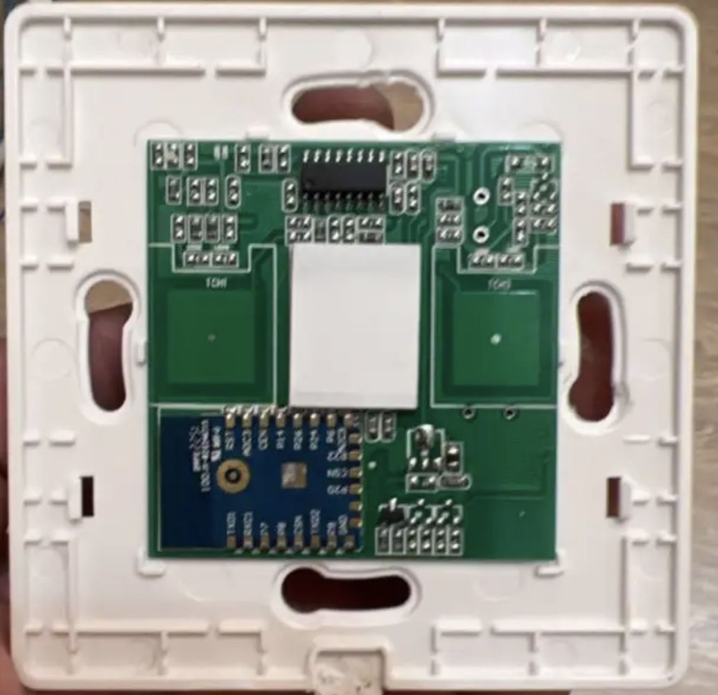

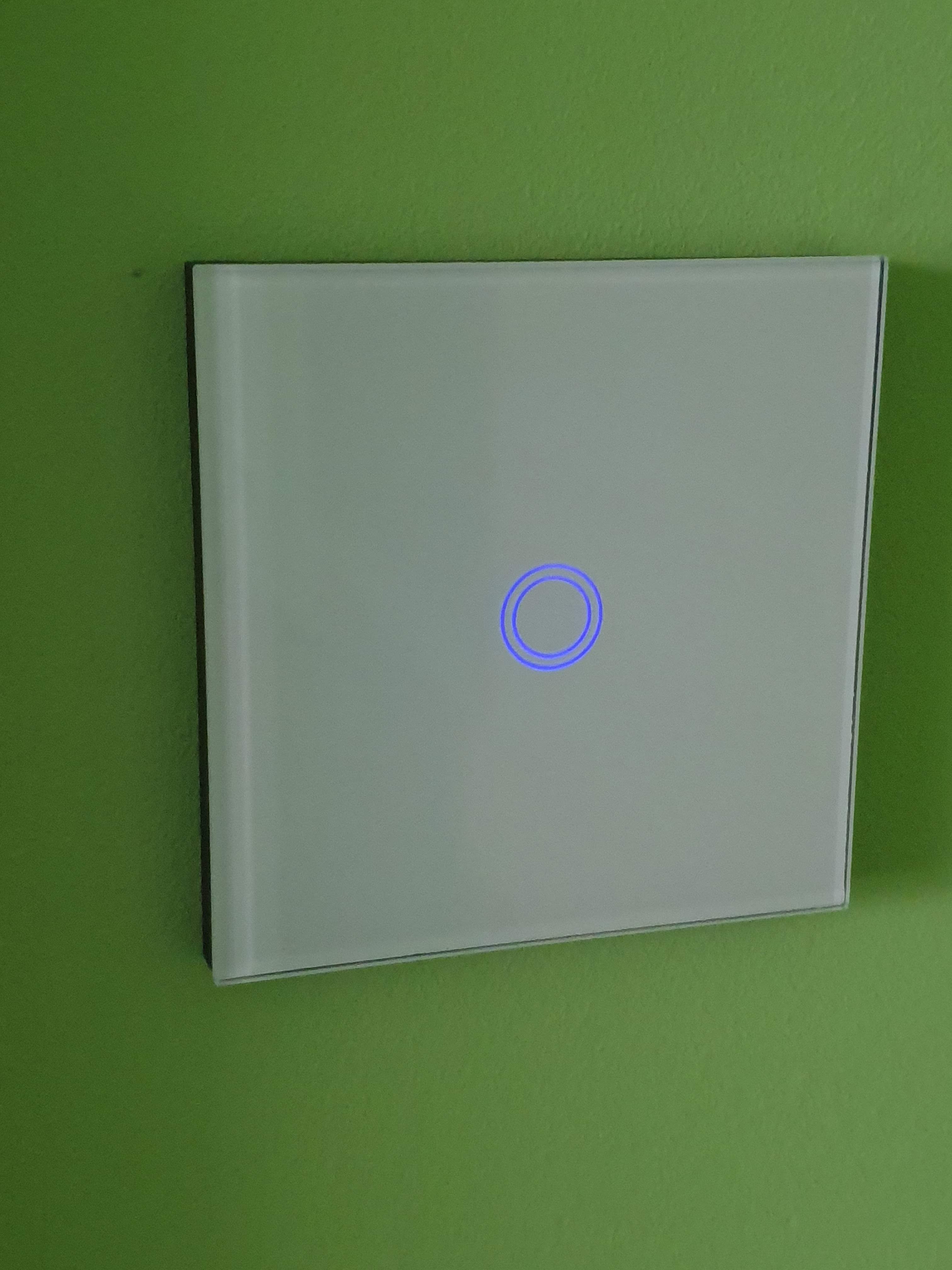

    Recently I had a touch-sensitive light switch installed, it works via wifi (via the eWelink app) and radio via remote control (I don't really care about that). I have a single switch and a double switch. And it is with the single one that there is a problem of the type that sometimes the light turns on by itself - not non-stop, but nevertheless it is a nuisance. I suspect that someone nearby opening the car simultaneously sends a signal to my switch (maybe I'm wrong - I don't know). Do you have any idea if it is possible to disable the remote control, or to solve this somehow? With dual switches I have no problems.
    I am attaching a photo of the switch.

    Touch-Sensitive Light Switch via eWelink App and Radio Control: Unintended Activation Issue I have the same problem. Sonoff touch single sometimes even in the event log in ewelink it appears that the device itself went into on mode. Light connected in the bathroom. Zero cables plugged in wago

    A faulty switch, incorrect connection, problems with N, poor WiFi coverage.... There are many possibilities - you need to check them.
    It is worth starting by looking at the logs - there may be the answer.

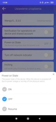

    Maybe try using without pairing with WiFi and adding to the Ewelink app? They should work on/off without the smart function. You will eliminate problems with the network and ewelink app. This will give you a basis for further steps to eliminate the problem.
    It could be that the switch loses the wifi connection and when restored goes into the default OFF state?

    Hello, in my case the problem of the light turning on was a glass panel that was ill-fitting; after removing the glass, the problem disappeared. It is possible that something when screwing the switch to the wall went crooked.
    Check at your place.

    At my place is also similar, all day nothing and before 24 hours the light turns on by itself every now and then, and so until morning, until I had to unscrew the bulbs 😅 I read and the problem turned out to be a little too tightened switch fixture, and a little loosened the screws and it is ok, only the strangest thing is that why it always started to go crazy at night and during the day it was ok? 🤔
  • #17 20467176
    pompidu7851
    I had the same problem and, as someone else wrote, I dismantled the panel, loosened a bit of the screws with which the switch was bolted to the wall and it helped.
