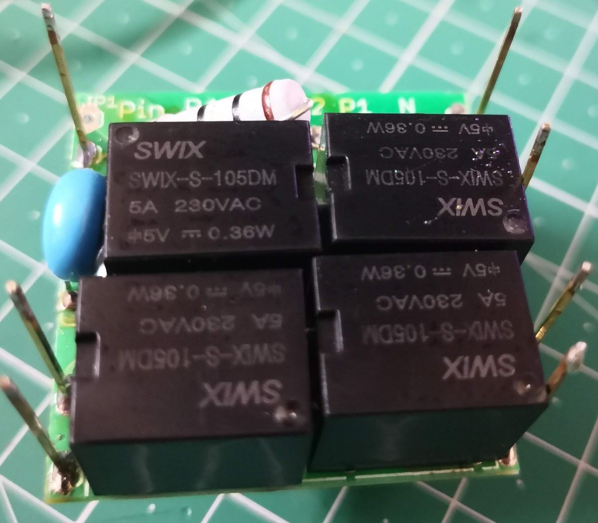

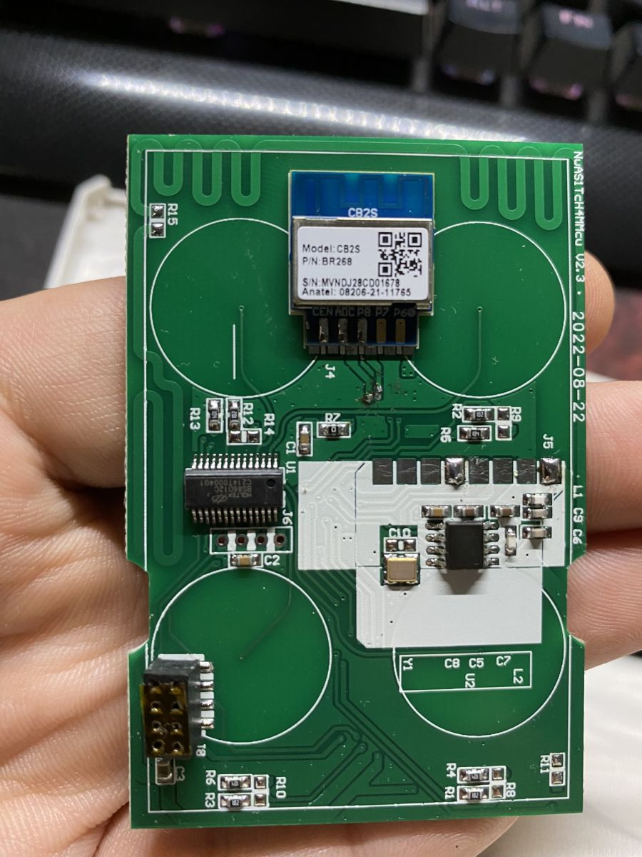

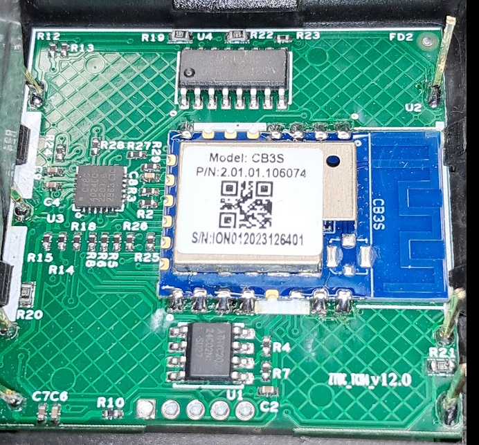

  • HomeMate Wi-Fi + Bluetooth Smart 4 Gang Touch Switch for Roma fitting uses a CB3S module with BK7231N and TuyaMCU control.
  • The switch stacks three soldered boards: touch/controller, relay board, and power board, with long header pins linking them together.
  • It exposes 12 dpIds and uses 4× 5A 230V relays, a ULN2003A Darlington array, and an HLK-PM01L power module.
  • OpenBK7231T firmware is installed by running TuyaMCU, mapping channels with autoexec.bat, then uploading the file, rebooting, and configuring MQTT.
  • Two datapoints remain unclear: Delay-off Schedule on dpId 19 and Memory Status on dpId 14.

    Tuya 4 CH touch switch for Roma fitting for Indian homes, it has CB3S chip (BK7231N)
    https://amzn.eu/d/3K8uk6I
    HomeMate Wi-Fi + Bluetooth Smart 4 Gang Touch Switch HomeMate Wi-Fi + Bluetooth Smart 4 Gang Touch Switch HomeMate Wi-Fi + Bluetooth Smart 4 Gang Touch Switch HomeMate Wi-Fi + Bluetooth Smart 4 Gang Touch Switch
    Technical Specs
    TuyaMCU: T1616-N TH 2720E (ATTINY1616)
    Darlington transistor array ULN2003A
    Relay: 5A 230V x 4
    Power Module: HLK-PM01L
    This switch consists of 3 board, soldered with long header pins,
    Top board is the controller board, top side is with the touch buttons, and on the other side it has CB3S and TuyaMCU, after that, is the relay board and then the power board.
    Total dpId 12

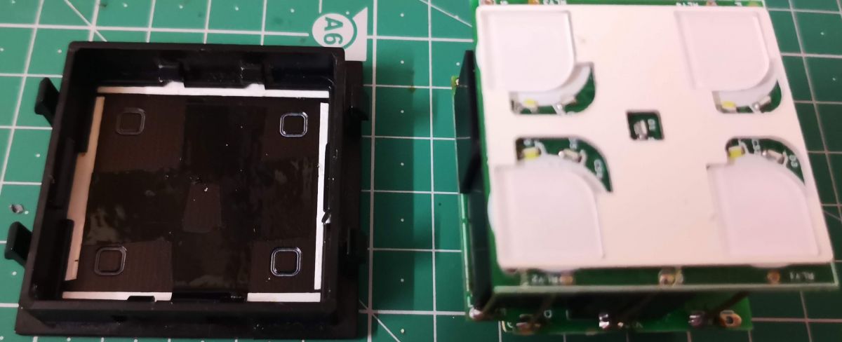

    Teardown
    HomeMate Wi-Fi + Bluetooth Smart 4 Gang Touch Switch HomeMate Wi-Fi + Bluetooth Smart 4 Gang Touch Switch HomeMate Wi-Fi + Bluetooth Smart 4 Gang Touch Switch HomeMate Wi-Fi + Bluetooth Smart 4 Gang Touch Switch HomeMate Wi-Fi + Bluetooth Smart 4 Gang Touch Switch
    HomeMate Wi-Fi + Bluetooth Smart 4 Gang Touch Switch HomeMate Wi-Fi + Bluetooth Smart 4 Gang Touch Switch HomeMate Wi-Fi + Bluetooth Smart 4 Gang Touch Switch HomeMate Wi-Fi + Bluetooth Smart 4 Gang Touch Switch HomeMate Wi-Fi + Bluetooth Smart 4 Gang Touch Switch HomeMate Wi-Fi + Bluetooth Smart 4 Gang Touch Switch HomeMate Wi-Fi + Bluetooth Smart 4 Gang Touch Switch HomeMate Wi-Fi + Bluetooth Smart 4 Gang Touch Switch HomeMate Wi-Fi + Bluetooth Smart 4 Gang Touch Switch HomeMate Wi-Fi + Bluetooth Smart 4 Gang Touch Switch HomeMate Wi-Fi + Bluetooth Smart 4 Gang Touch Switch HomeMate Wi-Fi + Bluetooth Smart 4 Gang Touch Switch HomeMate Wi-Fi + Bluetooth Smart 4 Gang Touch Switch

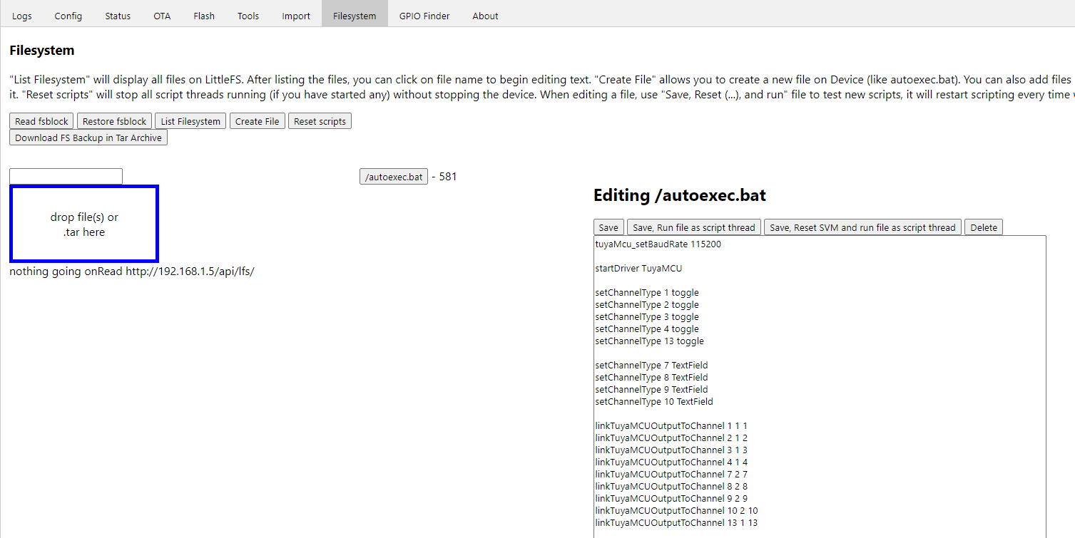

    Prepare for firmware upload
    download the latest firmware from https://github.com/openshwprojects/OpenBK7231T_App/releases/
    Create autoexec.bat file with below content
    startDriver TuyaMCU
    setChannelType 1 toggle
    setChannelType 2 toggle
    setChannelType 3 toggle
    setChannelType 4 toggle
    setChannelType 13 toggle
    setChannelType 7 TextField
    setChannelType 8 TextField
    setChannelType 9 TextField
    setChannelType 10 TextField
    linkTuyaMCUOutputToChannel 1 1 1
    linkTuyaMCUOutputToChannel 2 1 2
    linkTuyaMCUOutputToChannel 3 1 3
    linkTuyaMCUOutputToChannel 4 1 4
    linkTuyaMCUOutputToChannel 7 2 7
    linkTuyaMCUOutputToChannel 8 2 8
    linkTuyaMCUOutputToChannel 9 2 9
    linkTuyaMCUOutputToChannel 10 2 10
    linkTuyaMCUOutputToChannel 13 1 13

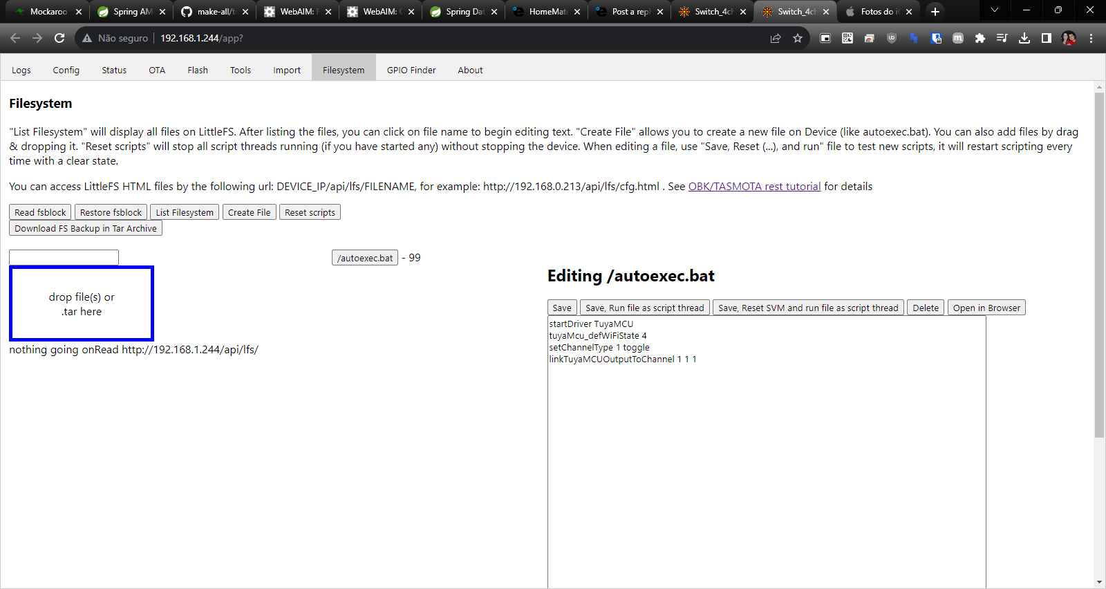

    After upload is done. open http://192.168.4.1/app, go to Filesystem and drop the autoexec.bat file in the "drop file(s) here" box, reboot the device, change the host-name, connect to the network, configure MQTT and start using the device with you home automation system.

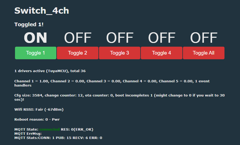

    after flashing and finishing the config. toggles are visible but relays are not working. when pressed shoing below in log. but nothing happens to relay.

    also some time the relays and switches working automatically like the below video.

  • TuyaMCU baud rate must be set before driver start
    #6 20574203
    parmarshailendra47
    This is the content of autoexec.bat
    Moderated By p.kaczmarek:
    You have tuyaMcu_setBaudRate call before you startDriver TuyaMCU! The tuyaMcu_setBaudRate call will be ignored. Please be aware that you always have to start the driver first!
    tuyaMcu_setBaudRate 115200
    startDriver TuyaMCU

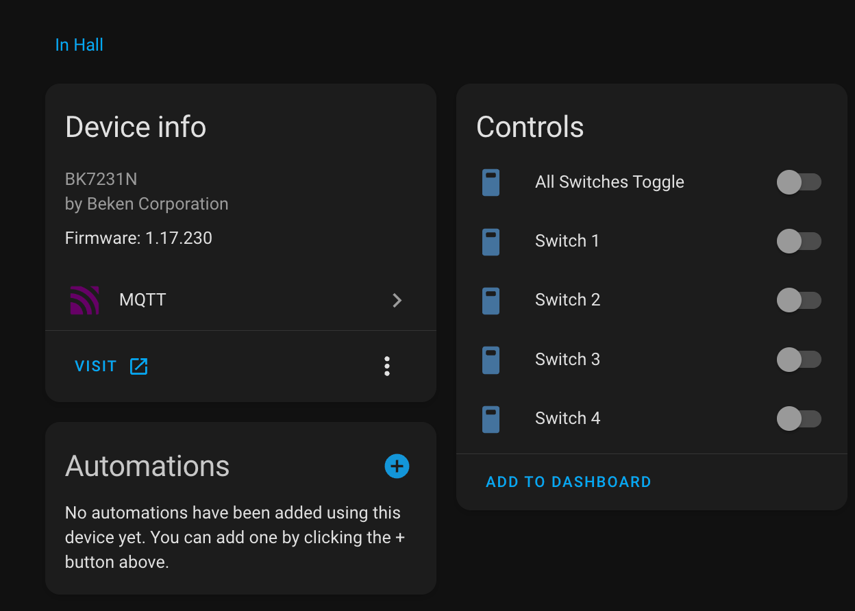

    Update - Switch is working fine and able to integrate with Home Assistant aswell :)
    I just went thru the details in the OP again and followed the "autoexec.bat" instructions.
    -- Open Web App
    -- File System tab
    -- Create a file (autoexec.bat) and click on the newly created autoexec.bat button
    -- Copy & paste the entire code (startDriver TuyaMCU) mentioned in the OP on the right side dialog box
    -- Click save & restart the device....
    you are now all set and device will work fine... tested & confirmed. (working fine in Home Assistant)
    Home Assistant user interface with BK7231N device information.
    the issue mentioned by @parmarshailendra47 seems to be a faulty device.

    User interface of the Switch_4ch device with TuyaMCU driver active, showing switch status and diagnostic data.
    Another problem that is happening is that I can turn on the buttons through MQTT or web interface but I can't turn off, I couldn't solve it in a simple way, but if I define this:
    setChannelType 13 TextField
    it works, setting a value of "1" on the interface, unsuccessfully with MQTT/interface button.
    The model in question is manufactured by NovaDigital, a Brazilian model. There is 4 touch buttons.
    Circuit board with CB2S module and electronic components.

    Backup your config and try:
    startDriver TuyaMCU
    tuyaMcu_defWiFiState 4
    The following code should allow you to both turn on and off the first relay... check it and tell me whether the bug persists.
  • #17 20726488
    latocheski
    Posts: 8
    Unfortunately, same.
    Screenshot of a file system editor interface in a browser.

    8. Press HTML GUI button several times (4+)
    Now, on the web interface:
    Info:MAIN:Time 61, idle 185125/s, free 71880, MQTT 1(1), bWifi 1, secondsWithNoPing -1, socks 2/38
    Info:MQTT:Channel has changed! Publishing 1 to channel 1

  • Memory status enum and OffOnRemember setup
    #20 20742733
    Posts: 14791
    Rate: 12937
    marioalmeida wrote:
    @p.kaczmarek2 how to configure the below 2 dbId?
    { dpName: "Delay-off Schedule", dpId: 19 }
    { dpName: "Memory Status", dpId: 14 }
    dpID 14 describes the state of the device after power up. So, for example, if you lose power in the house, what happens when power comes back.
    dpID 14 has 3 options:
    - 0 , means "off by default"
    - 1, means "on by default"
    - 2, means "remember last state"
    You can set it manually via command:
    // [dpID] [type] [value]
    tuyaMcu_sendState 14 4 0
    The type is 4 here because it's enum, this variable is using enumeration type.
    You can also put that on Gui with a channel type OffOnRemember:
    https://github.com/openshwprojects/OpenBK7231...mmit/c948af2a3af4abbbdab6c09bb7fb5f6ef14f4f0a
    More details later

  • Added EEPROM complicates in-circuit reprogramming
    #23 20841367
    sundeepgoel2
    >>20103196
    Excellent teardown and instructions. I was able to use it to reprogram 2 modules I bought recently.
    Couple of challenges though,
    1. an EPROM seems to have been added to the board now. Unable to reprogram with the module attached to the board, had to de-solder the chip for the writer to work. Any suggestions on how to reprogram with module attached - since de-soldering impacts some of the plastic parts directly below.
    Printed circuit board with mounted CB3S module and integrated circuits.
    2. Reading firmware from the module fails (read fails), or the rare occasion it does complete the CRC fails.
    3. The definition for toggle 4 seems to have changed. While the toggle action works (blue light comes on), the white LED and Relay dont work.
    Welcome suggestions for workarounds / fixes....
  • #24 20841432
    Posts: 14791
    Rate: 12937
    Can you check where RX1 and TX1 are connected? They are most likely connected to the MCU, that's how TuyaMCU works. Still, they may be connected to the MCU through resistors. In this case, it should be possible to just temporarily desolder the resistors for the time of the flashing.
    Btw, that's interesting, what is the EEPROM for?

    sundeepgoel2
    Have no idea at this stage.
    Am very new to this framework, taking baby steps (get the module to work as is) before digging deeper :-)
    Added after 3 [minutes]:
    Thanks - will trace back from the 7231N chip, the SMD resistors around the MCU are really tiny and have other parts collocated. Makes me nervous around removing / adding them back in fearing collateral damage to surrounding parts.

    Q:
    1. How is the Darlington array chip 2003 connected, does it connect 1:1 to the TuyaMCU outputs ?
    2. How does touch work - directly via the tuyaMCU ?
  • Use MCU reset pin to isolate TuyaMCU during flashing
    #26 20842607
    Posts: 14791
    Rate: 12937
    I haven't analyzed this particular device, but usually everything connects to TuyaMCU and then TuyaMCU only communicates via UART (RX1/TX1) with WiFi module.
    That's why TuyaMCU devices always seem to work even after reflashing WiFi module.
    That's because all the work is done on the MCU, and WiFi can only control that with dpIDs.
    If you want to flash WiFi module without removing UART connection to the MCU, you can try to identify the MCU chip and check it's datasheet for RESET pin. Some MCUs may have documented RESET pin that can be used to put MCU in RESET state, and that may prevent it from interfering with the flashing process

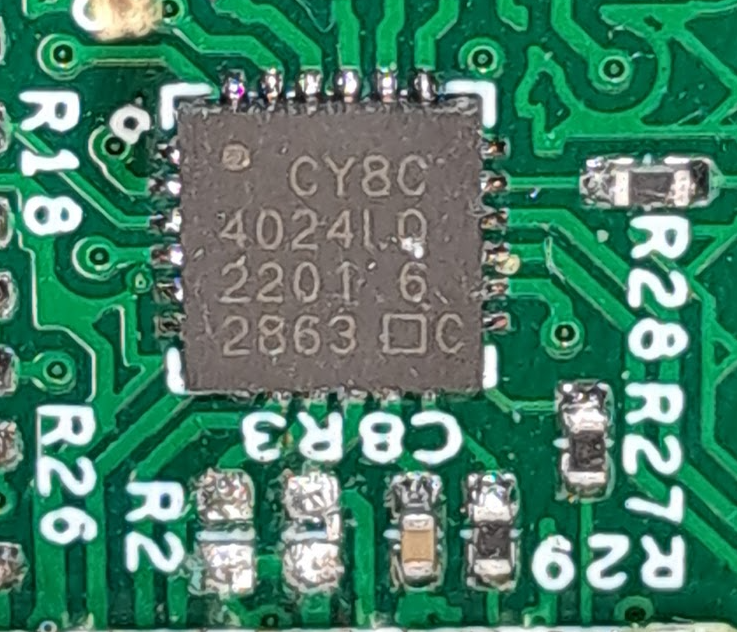

  • Using CY8C40xx reset pin to isolate UART during flashing
    #27 20842887
    sundeepgoel2
    Thanks - I identified the SMD resistors (R2, R3 on attached image) connecting to the UART, however, they turned out to be pull-ups. So removing them didnt help
    Image of Infineon CY8C4024LQ microcontroller and SMD resistors on a printed circuit board.
    The MCU seems to be infineon CY8C40xx : https://www.infineon.com/dgdl/Infineon-PSoC_4...N.pdf?fileId=8ac78c8c7d0d8da4017d0eda97715cf1
    Reset pin seems to be 18 (pulled high), will try with that now.
  • #28 20843007
    Posts: 14791
    Rate: 12937
    Ok, try to put that in RESET state and maybe show a photo how you did that, so future users can benefit. Good luck!
  • Removing the module was required for flashing
    #29 20843161
    sundeepgoel2
    Will post details soon, however, connecting pin 18 to GND proved unsuccessful
    I then lifted the module partially out, effectively desoldering the uart pins from the board (hence the MCU). Surprisingly even after that proved unsuccessful. Seems the other connected pins somehow interfere.
    Then removed the module entirely, flashing worked fine.
    After that was a frustrating two hours trying to solder the removed SMD resistors back ok. Got lucky with one, the other flew away with the hot airflow
