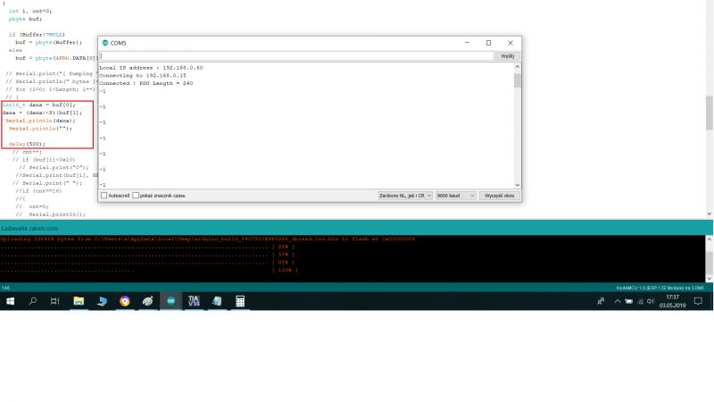

    ESP8266 Integer Type 32 Bits vs 16 Bits for PLC Communication .

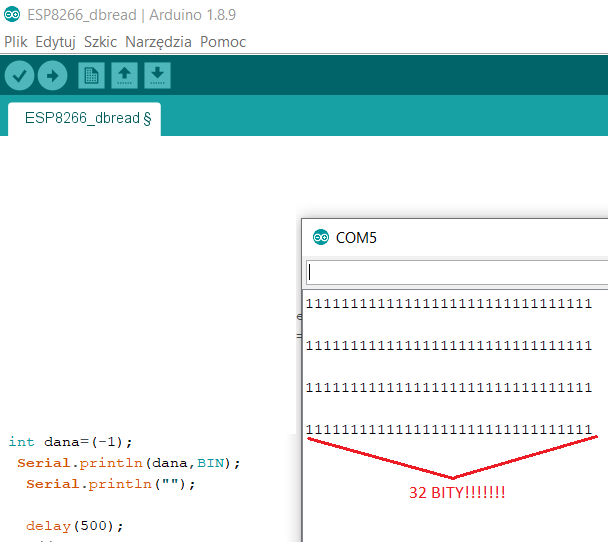

    It deals with the communication of my ESP8266 with a PLC. From the PLC the value of an integer type variable is taken, which is 16 bits. The reading on the serial monitor was ok, until I wanted to display negative numbers. Wanting to check the number of bits, I rigidly typed -1 into the variable and after displaying it in binary form, I noticed that the variable of type INT has 32 bits. This is a big problem for me because when I have a -1 on the PLC, the microcontroller reads it as 65535.

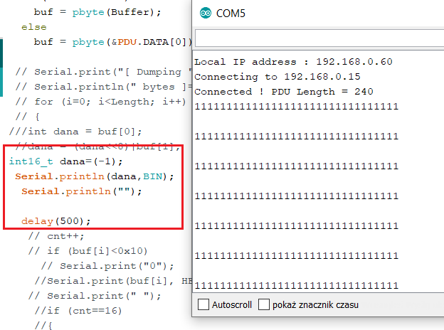

    I tried to declare the variable as int16_t, but the effect is the same. I am using the Settimino.h library to connect to the PLC, it is covered there:
    Code: C / C++
    What is the problem? I know that the ESP8266 is 32-bit, but I need, to have a 16-bit variable

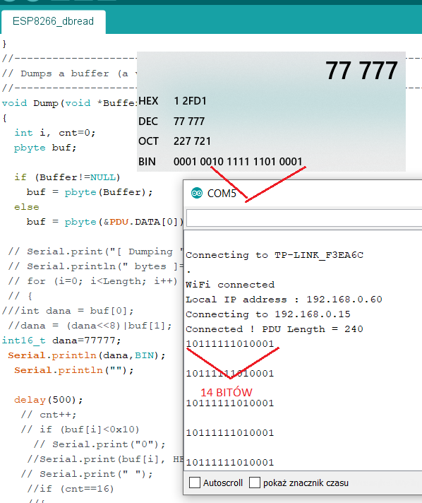

    Please see that I still have 32 bits

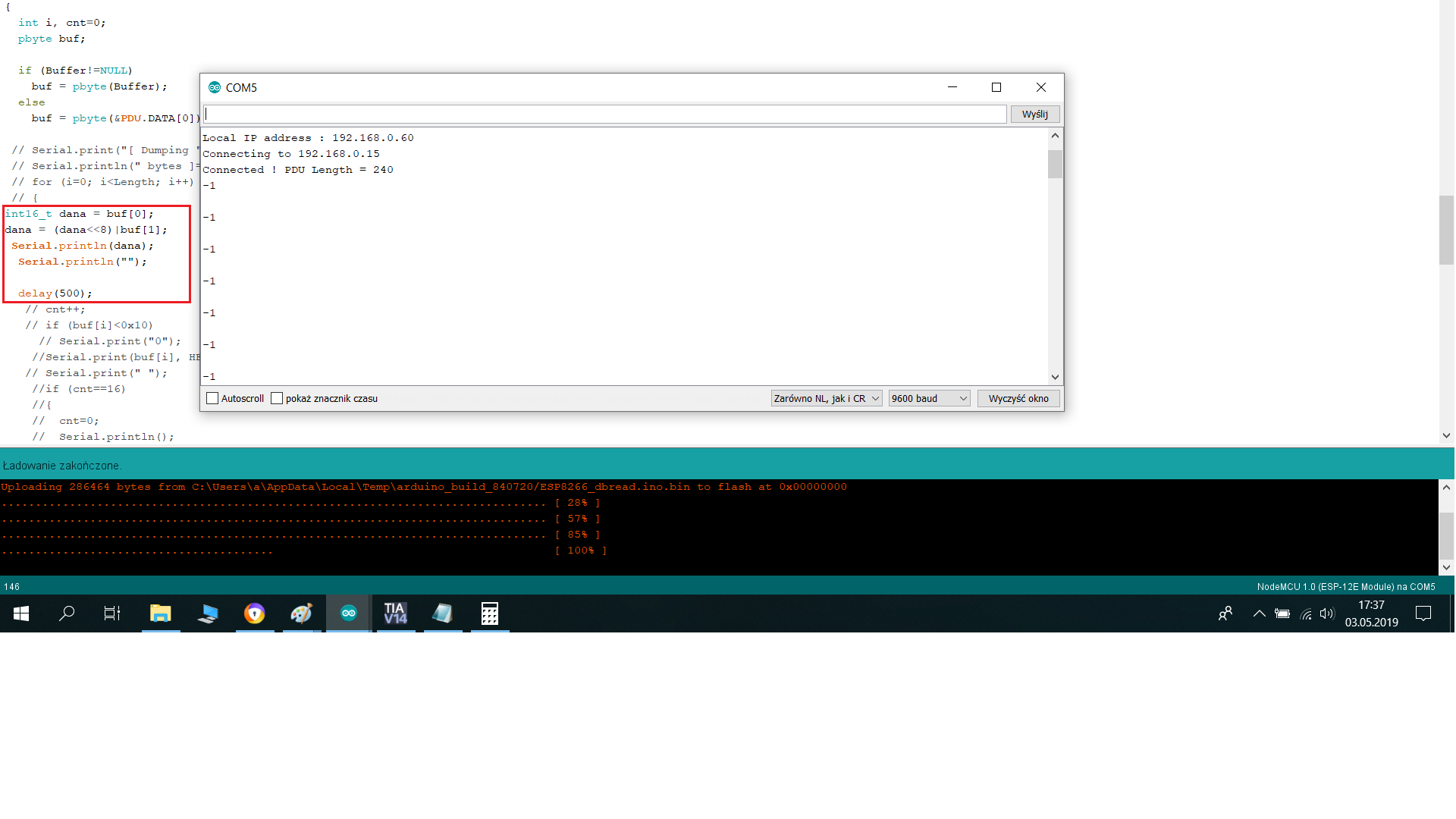

    But when I entered a numerical value greater than 16 bits the displayed entry was not complete. What can I do to make the 16 bit negative value read correctly on the ESP8266, as the value -1 is read as 65355
    Added after 3 [minutes]:
    Immediately....... already ESP8266 Integer Type 32 Bits vs 16 Bits for PLC Communication I don't understand
    now that I have used a write as in the above picture and sent from PLC -1 it reads correctly. I have to go out now but will get back to the subject when I return. I think it is ok :) .

    In ESP all INTs will be 32bit, In Arduino (surprisingly 8 bit) all INTs will be 16 bit. As you want to be sure, in many platforms the universal designation for a variable is uint8_t, int8_t, uin16_t, int16_t, uint32_t, int32_t, etc. The same is true for INT in various x86 or x64 PC operating systems - if you're getting on with a new one, always on a "DAILY" basis use the sizeof(int) function. Watch, watch, watch!
