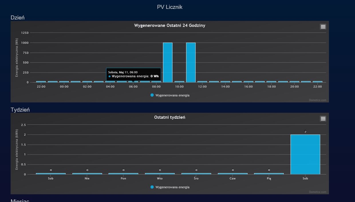

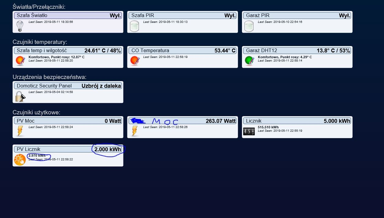

    I have a SDM 120 Modbus meter hooked up to a Wemos d1 mini on ESPEasy software which sends data to domoticz. I want to monitor the power and the amount of energy produced (PV installation). As far as the power of the installation is concerned, the graphs are ok, i.e. I can view the entire day's production with any degree of accuracy. On the other hand, the kWh meter and the statistics in domoticz give the data when a full kwh is passed. Today, for example, I produced 2.97 kWh, and the graph and meter show 2 kwh (meter status 2.97). Tomorrow morning, after producing 0.03 kWh, it will mark this one kWh for me. I have a small installation of 1.2 kWp and I want the whole day to end with a result with 2 decimal places. How can this be changed ?

    This is probably because of the way the counter data is parsed. To say more, you would need to know the mechanisms for passing data to the Domoticz API, scripts, etc.
    More likely it is not the fault of Domoticz itself, but precisely the way the data is delivered.
