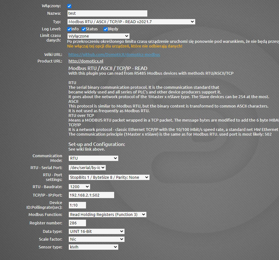

    Hello. domoticz and energy measurement.
    Hello, can someone help with the configuration of reading 2 DMMetering PRO 1250D MODBUS meters?
    Reading by modbus via USB converter.
    The meters have already assigned addresses.

    I used the settings as shown in the picture. Unfortunately when domoticz tries to read the data 0kwh disappears from the icon which is added to the utility tab
    • Configuration of DMMetering PRO 1250D MODBUS meter reading in Domoticz Bez tytuÅ_u.jpg (194.74 KB) You must be logged in to download this attachment.
