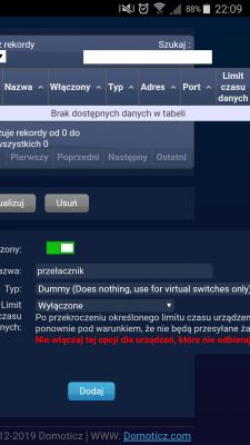

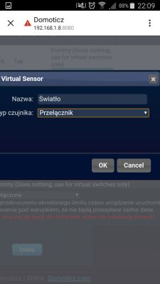

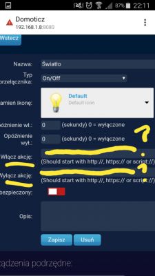

    Hello. I have a problem with the configuration of domoticz.
    I have purchased a light switch with wifi function which works via the company app. However, it does not in domoticz.
    It seems to me that the correct information is missing at the option "enable action ". I am uploading some photos. The place I am interested in is marked in yellow. I know the Ip of the switch.
    Please help. What should I do to add the switch to domoticz?

    It is best to change the soft in it to Tasmota or ESPEasy.

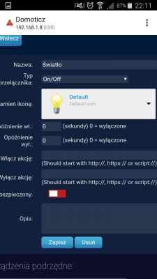

    I don't want to be spiteful because it's unnecessary, but the fact that you have to type something in is something I've figured out even without google. I even highlighted it in yellow.
    I think that the correct information is missing at the option "enable action ".
    By changing the software I will lose the ability to control the switch via a dedicated app????

    tom.tych wrote:
    By changing the software I will lose the ability to control the switch via its dedicated app??
    Yes. However, what difference does it make whether you control via ewelink or via domoticz?
    In addition, when switching to an alternative soft. The switch is yours and yours alone and does not work in a Chinese cloud.
