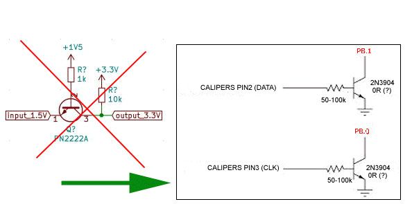

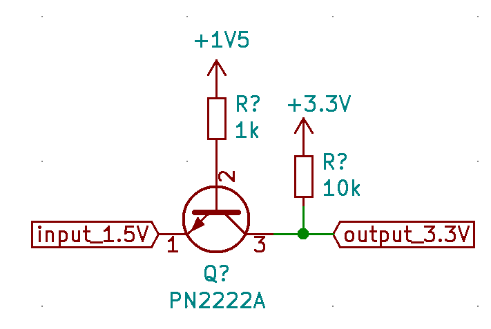

    Dear forumers,
    I am making an interface to communicate between ESP32 and an electronic caliper which is powered by a 1.5V battery. The signals coming out of it are also 1.5V.
    I need to build a circuit (preferably on a single transistor) for the ESP to read 3.3V correctly.
    Can I use a PNP instead of an NPN so that the signal is not inverted? Which transistor should I choose? What parameters should I pay attention to?
    Thank you in advance.

    Write more about how the communication is done, speed etc. A diagram would also be useful.

    The best thing to do, however, is probably a logic level converter.

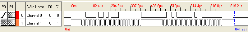

    Such a Chinese one-way protocol for callipers. A clock line and a data line.
    Which transistor/scaler? - reading data from an electronic caliper .
    The shortest pulse is about 6us so about 166kHz.
    Of the converters so far I have found a TXB010*, the one on the BSS138 does not work.

    But it's the other way it's supposed to work. From 1.5 to 3.3V.

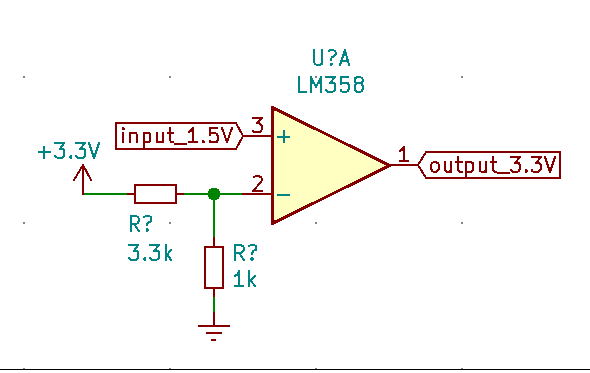

    Of course you can use a converter, but does it make financial sense since an LM358 for 50gr will also ensure correct operation.

    To the (-) input of the LM358 connect: 3.3k to +3.3V, and 1k to GND. To the input (+) the signal from the caliper. Output the amplifier to the microcontroller. If the voltage on the (+) is greater than on the (-) i.e. set with resistors around 0.75V then the amplifier output will be 3.3V. This will ensure that we do not have signal inversion.
    You can use basically any operational amplifier.
    With transistors it will not be so easy anymore, as you would have to take into account the need to draw current from the caliper to supply the base of the transistor.

    It would look something like this?

    Seems ok, the circuit with the transistor will unfortunately discharge this small battery from the caliper.

    LM358 connected, 1.9V output signal and ESP does not see it. Maybe some values to change?

    LM358 supplied with 3.3V and the output is 1.9V?

    pawlik118 wrote:
    LM358 powered from 3.3V and output is 1.9V?
    And how much should it have, after all it is not rail2rail.
    I have already written previously
    krzysiek_krm wrote:
    Using an operational amplifier as a comparator is a poor idea - the amplifier has some things that are not needed for anything in a comparator, such as compensation.
    Modern comparators are from sudden death, they are just RRIO, either push - pull or open drain, sometimes they even have some kind of reference voltage source.

    Well yes, in the doc. the LM358 has Vo=Vzas-1.5V. In this situation, the output of the amplifier needs to be pulled up to +3.3V by e.g. 1k.
    Of course there are a whole bunch of comparators, but the LM358 has the advantage that almost everyone has it at hand.

    After pulling up the outputs it works as it should. Thank you.
    I have an LM393 on hand, can it also be used? In the same way as the LM358? only without pulling up the outputs?

    The LM393 has an OC output and pull-up is necessary in this case.

    I don't know why you see such a problem with signal reversal. After all, as you write the program, this is not a problem. The circuit on the right should work, but in the processor you need to switch on the input pull-up (INPUT_PULLUP) or possibly give 10k resistors to PB-0 and PB-1 and connect to 3.3V. This is the most classic circuit for such applications.

    After all, you have a bipolar transistor in the schematic, not a MOSFET. Use any low power npn bipolar transistor.
    As far as the VGS is concerned you have got it right. It just needs to be small. In MOSFETs you have to look for such, in bipolar (silicon) you always have about 0.6V drop across the base-emitter.
