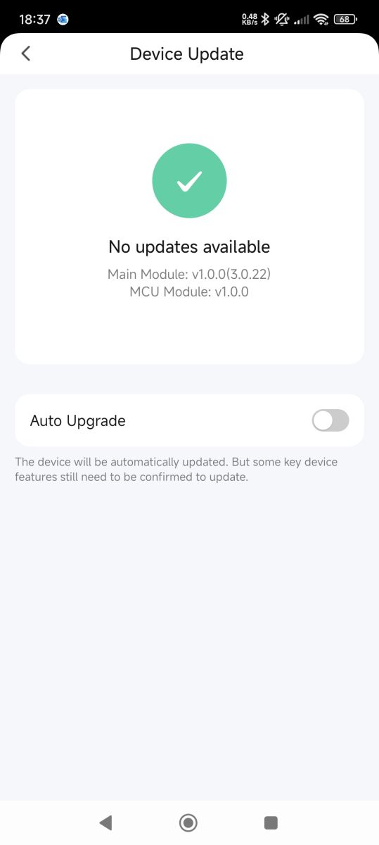

  • OpenBK7238 was flashed over factory firmware, the app revealed dpIDs, and the device ultimately behaved like a temperature and humidity sensor.
  • Keeping the factory bootloader broke OTA updates, and after reflashing the device gave only about 20 seconds before the MCU cut power, with no TuyaMCU replies yet.

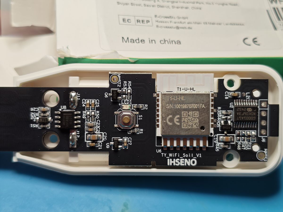

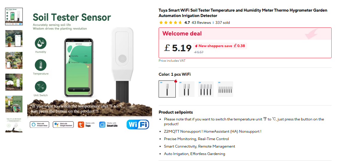

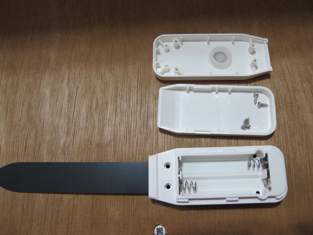

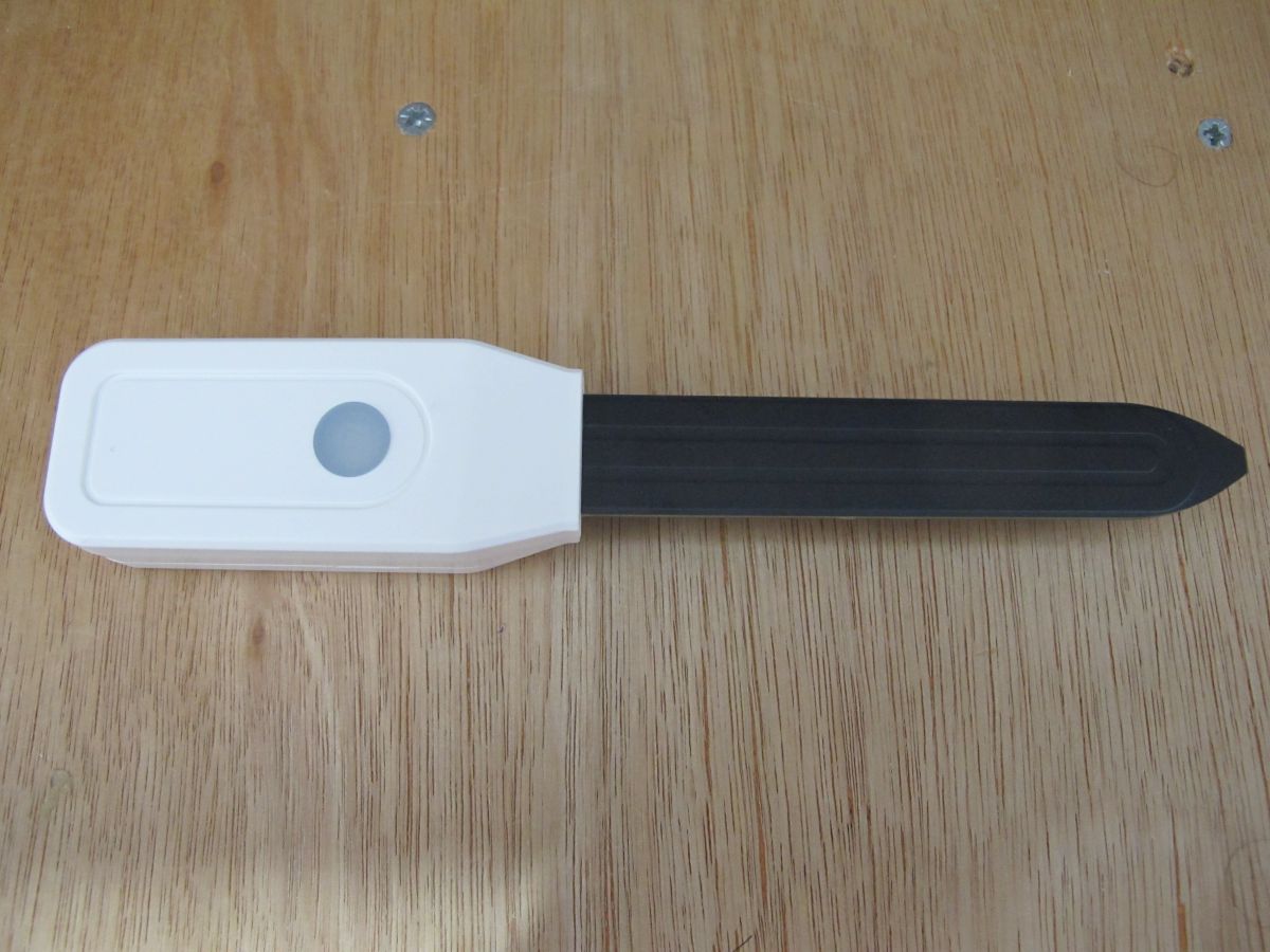

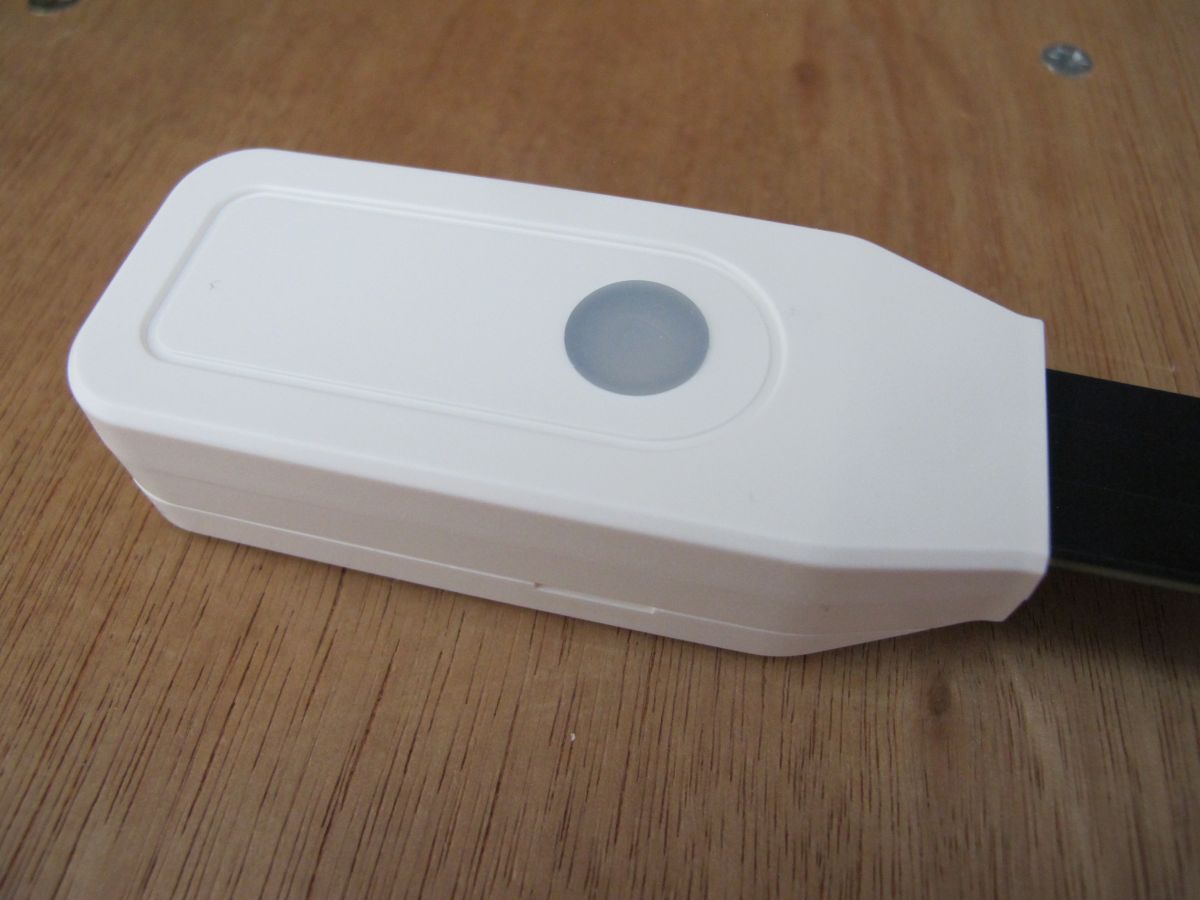

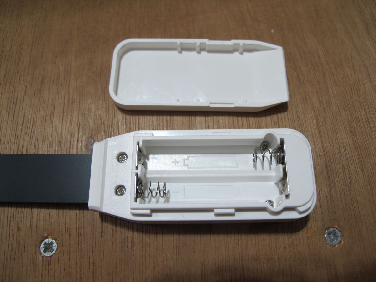

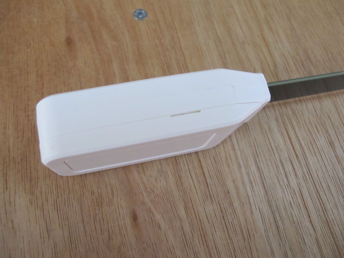

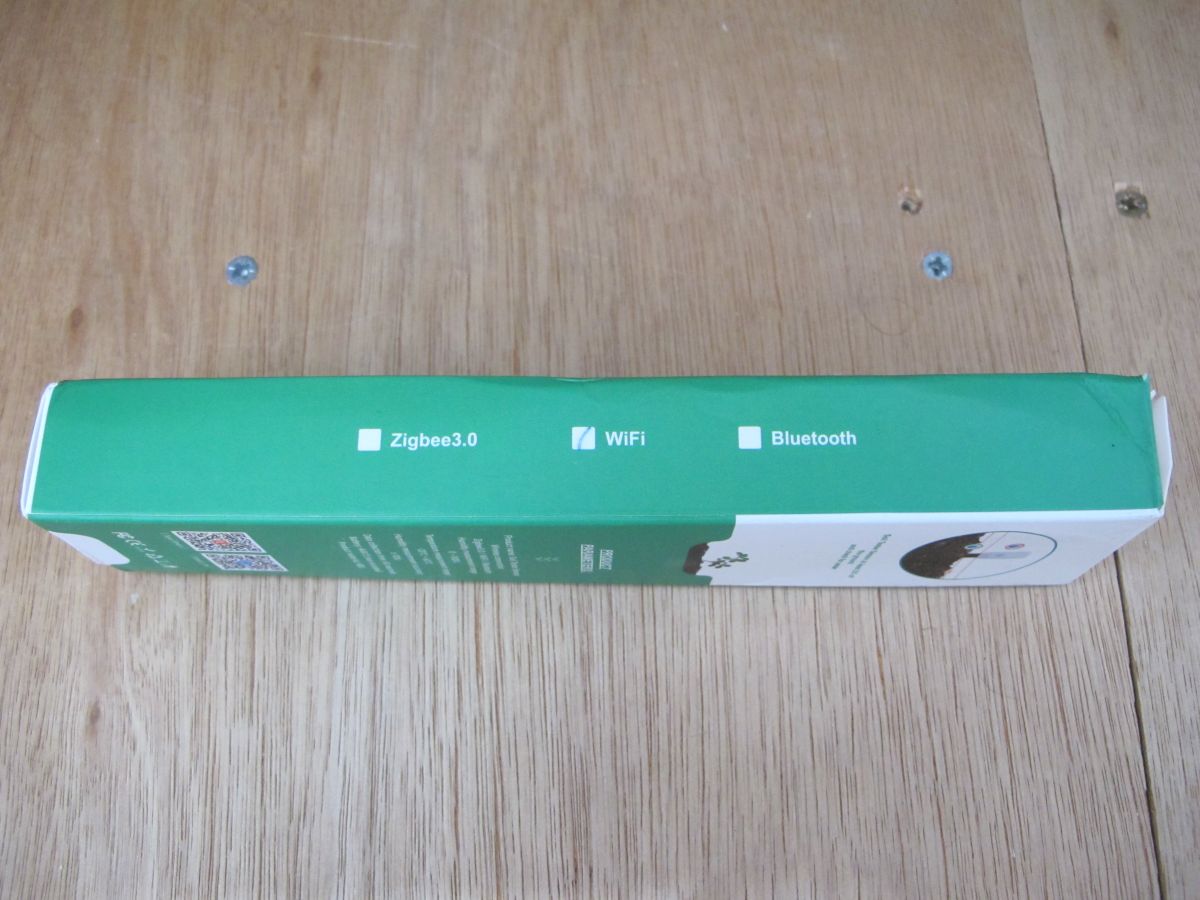

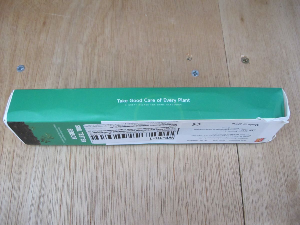

    This is a 'Soil Tester Sensor' from Ali Express.
    Screenshot of Tuya soil sensor product page showing device, app, and function icons
    Soil moisture sensor with package and user manual on a wooden table Side of green packaging box showing Zigbee 3.0, WiFi, and Bluetooth icons. Green box labeled “Take Good Care of Every Plant” lying on wooden surface. Smart sensor package label with manufacturer info and barcode Green box labeled “Soil Tester Sensor” with product model WF-TR-1 and barcode. Green soil moisture sensor box with specs list and QR codes

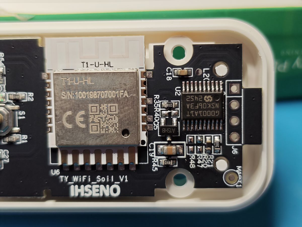

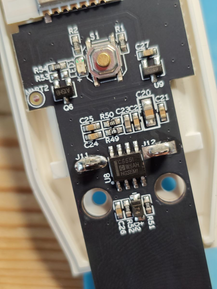

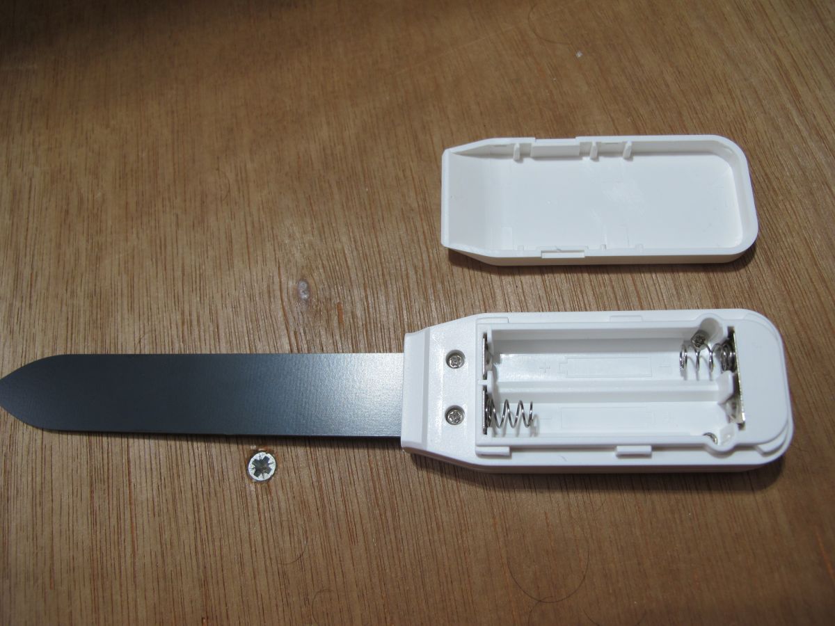

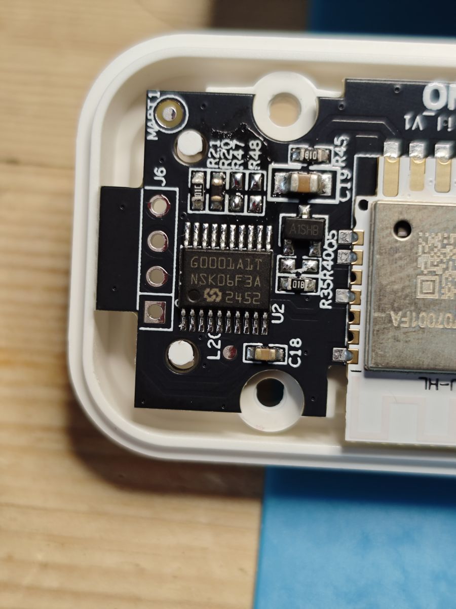

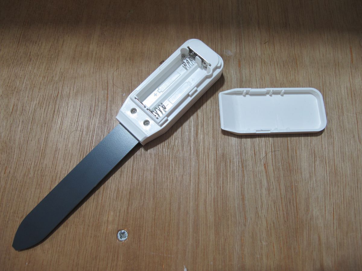

    After popping off the battery cover, just 4 small cross-head screws allow for the removal of half the case
    Close-up of a probe-style soil sensor with a plastic casing White sensor with plastic casing and metal probe lying on a wooden surface Soil sensor with white plastic housing and black probe, placed on wooden background Disassembled soil sensor case with battery holder and screws on wooden surface Open soil sensor case showing two AA battery slots with springs and cover Disassembled soil sensor with battery compartment open and terminals exposed Opened soil sensor with white casing and exposed battery compartment White plastic sensor with a button on top, lying on a wooden surface
    to reveal the main module - the T1-U-HL, a 16kb MindMotion MM32G0001 Arm Cortex-M0 TuyaMCU (also seen here) and an HGSEMI C5551 WSAH SOIC8 chip.
    Tuya T1-U-HL module and components on IHSENO TY_WiFi_Soil_V1 sensor PCB Tuya T1-U-HL module and IC on PCB of IHSENO TY WiFi Soil V1 device Close-up of PCB with push button, HGSEMI C5551 chip, and SMD components. Close-up of PCB with MM32G0001 chip and Tuya T1-U-HL module with exposed test pads

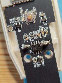

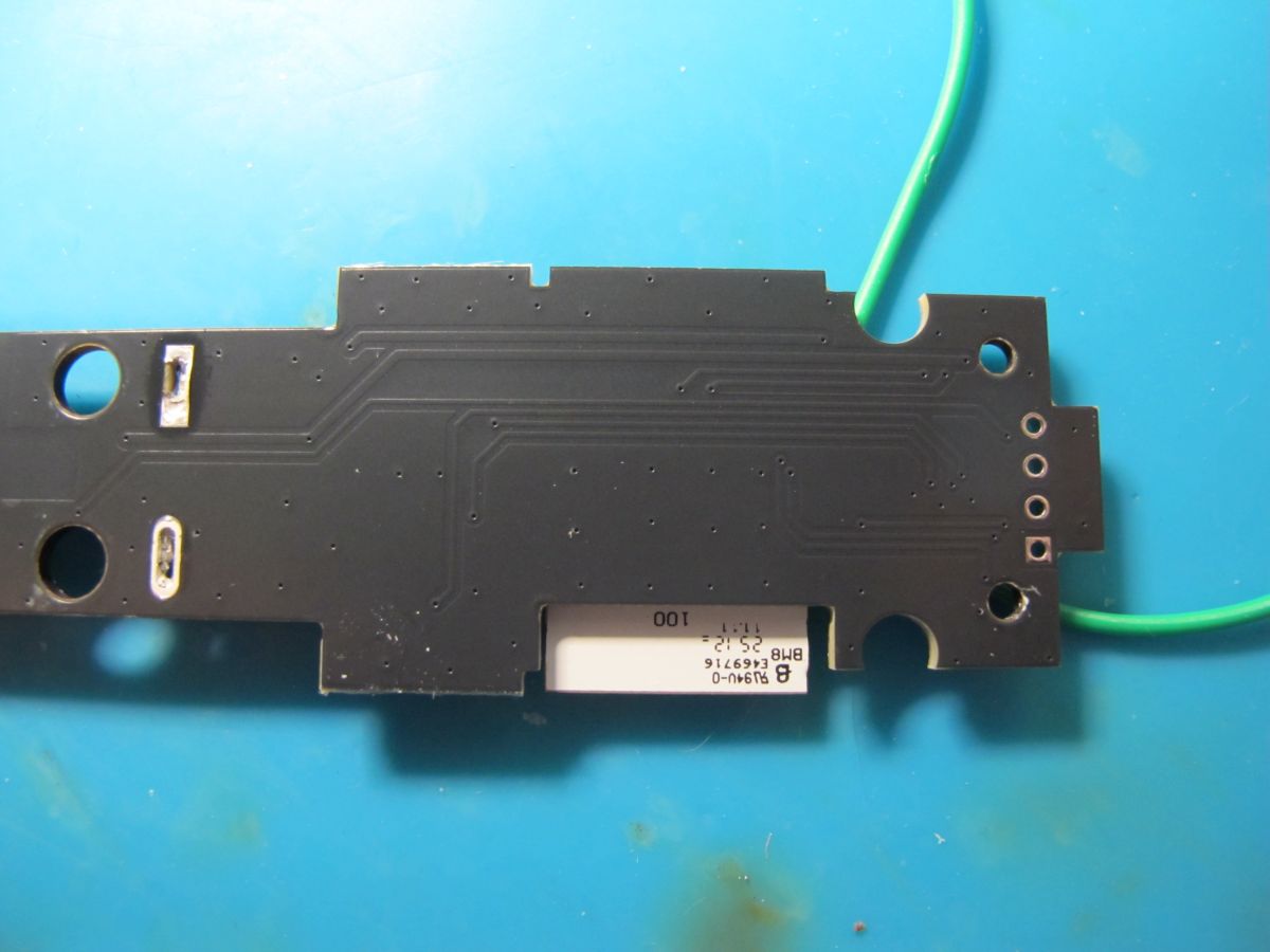

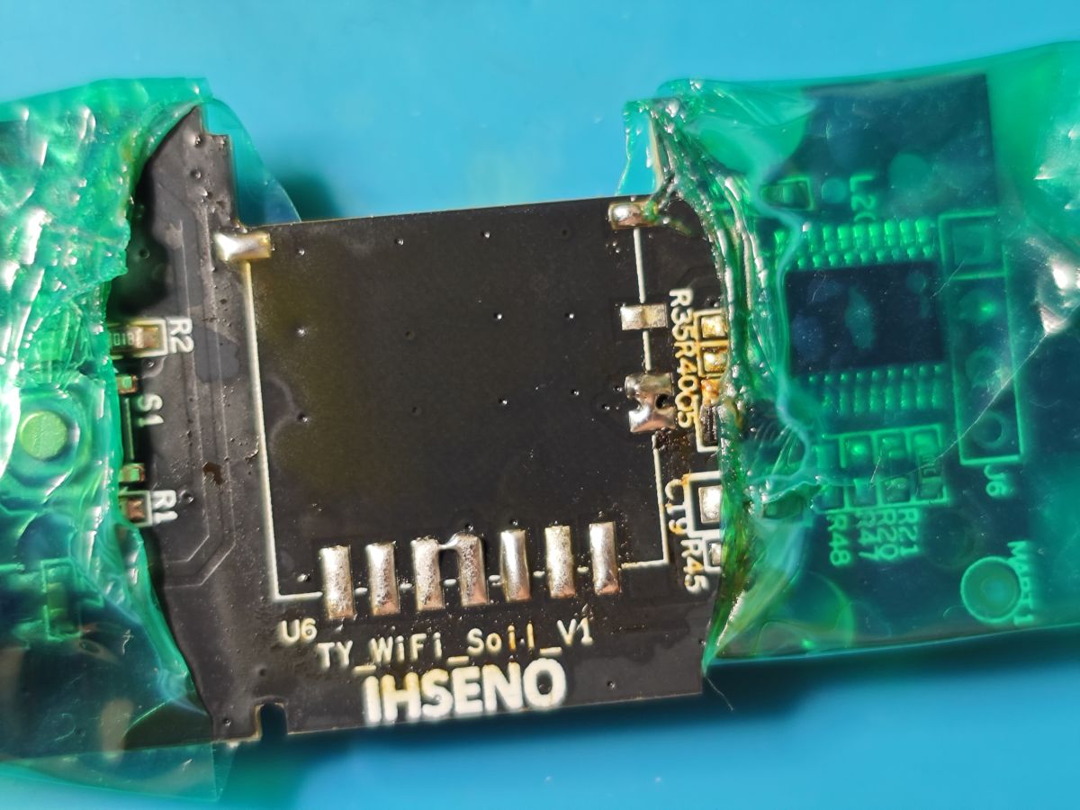

    Unfortunately, the back of the PCB cannot be examined without de-soldering the battery terminals. There was little to be gained, however.
    Bottom of black PCB with green wire and visible copper traces

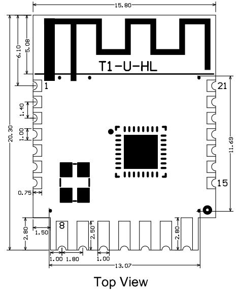

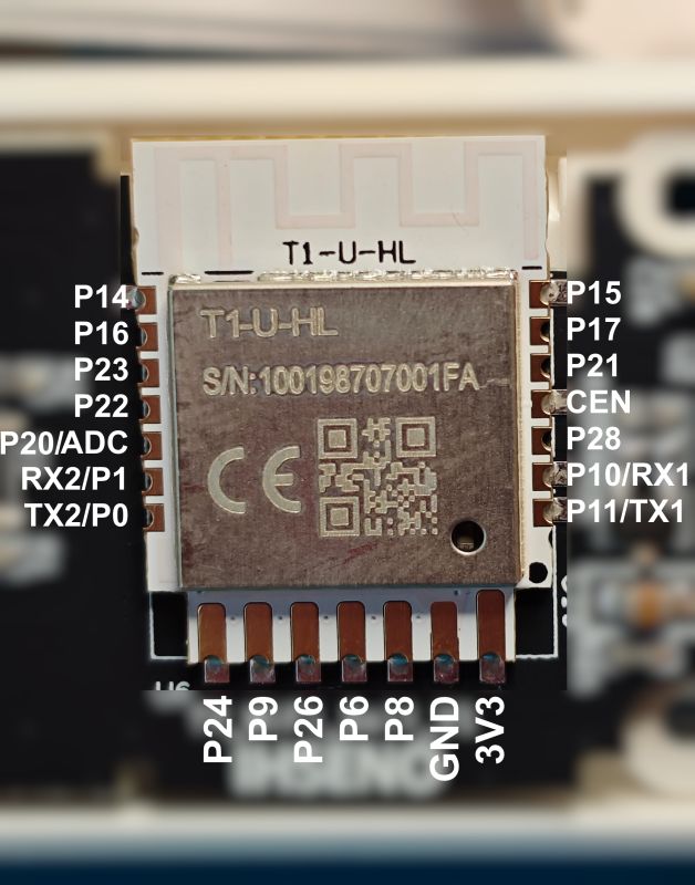

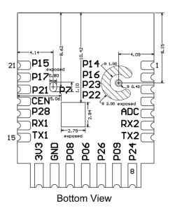

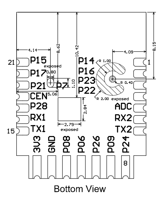

    T1-U-HL details - https://developer.tuya.com/en/docs/iot/T1-U-HL-Module-Datasheet?id=Kdfp5j893qwxg
    Top view of Tuya T1-U-HL module with pin numbers and size measurements Bottom view of T1-U-HL module with labeled pins and mechanical dimensions
    Pin No.SymbolI/O typeDescription
    1P14I/OA normal GPIO pin, corresponding to Pin 19 on the IC. It can be reused as SPI_SCK.
    2P16I/OA normal GPIO pin, corresponding to Pin 20 on the IC. It can be reused as SPI_MOSI.
    3P23I/OA normal GPIO pin, corresponding to Pin 16 on the IC.
    4P22I/OA normal GPIO pin, corresponding to Pin 15 on the IC.
    5ADCI/OAn ADC pin, corresponding to P20 (Pin 13) on the IC.
    6RX2I/OUART_RX2, corresponding to P1 (Pin 30) on the IC.
    7TX2I/OUART_TX2 to print logs, corresponding to P0 (Pin 31) on the IC.
    8P24I/OSupport hardware PWM4, corresponding to Pin 17 on the IC.
    9P9I/OSupport hardware PWM3, corresponding to Pin 27 on the IC.
    10P26I/OSupport hardware PWM5, corresponding to Pin 23 on the IC.
    11P6I/OSupport hardware PWM0, corresponding to Pin 24 on the IC.
    12P8I/OSupport hardware PWM2, corresponding to Pin 26 on the IC.
    13GNDPGround pin.
    143V3P3.3V power pin.
    15TX1I/OUART_TX1 to send user data, corresponding to P11 on the IC (corresponding to Pin 29 on the IC).
    16RX1I/OUART_RX1 to receive user data, corresponding to P10 on the IC (corresponding to Pin 28 on the IC).
    17P28I/OA normal GPIO pin, corresponding to Pin 12 on the IC.
    18CENI/OThe reset pin, active low, and pulled up internally. It is compatible with the designs of other modules. Corresponding to Pin 11 on the IC.
    19P21I/OA normal GPIO pin, corresponding to Pin 14 on the IC.
    20P17I/OA normal GPIO pin, corresponding to Pin 22 on the IC. It can be reused as SPI_MISO.
    21P15I/OA normal GPIO pin, corresponding to Pin 21 on the IC. It can be reused as SPI_CS
    Tuya T1-U-HL module with labeled signal and power pins

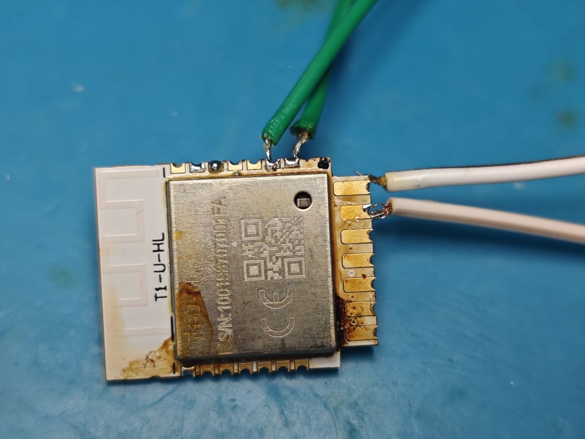

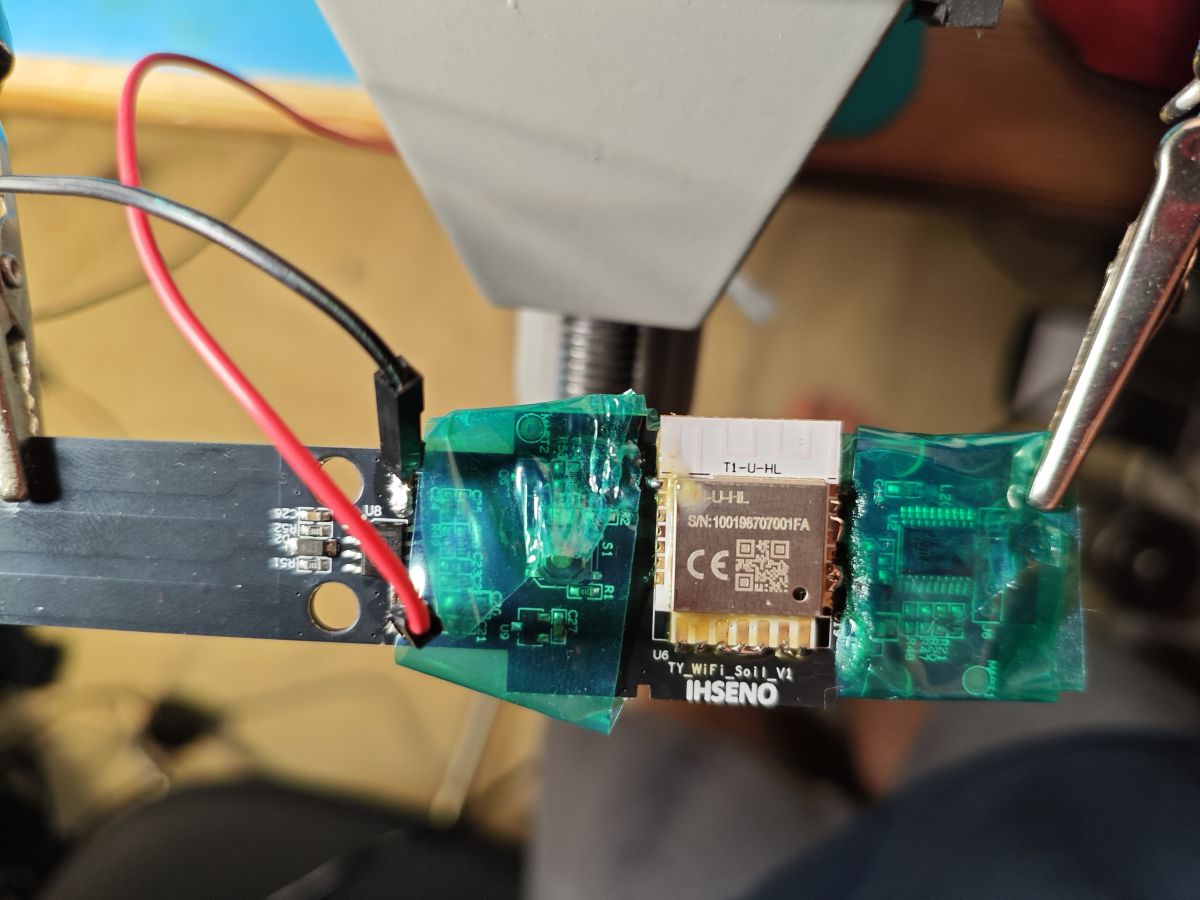

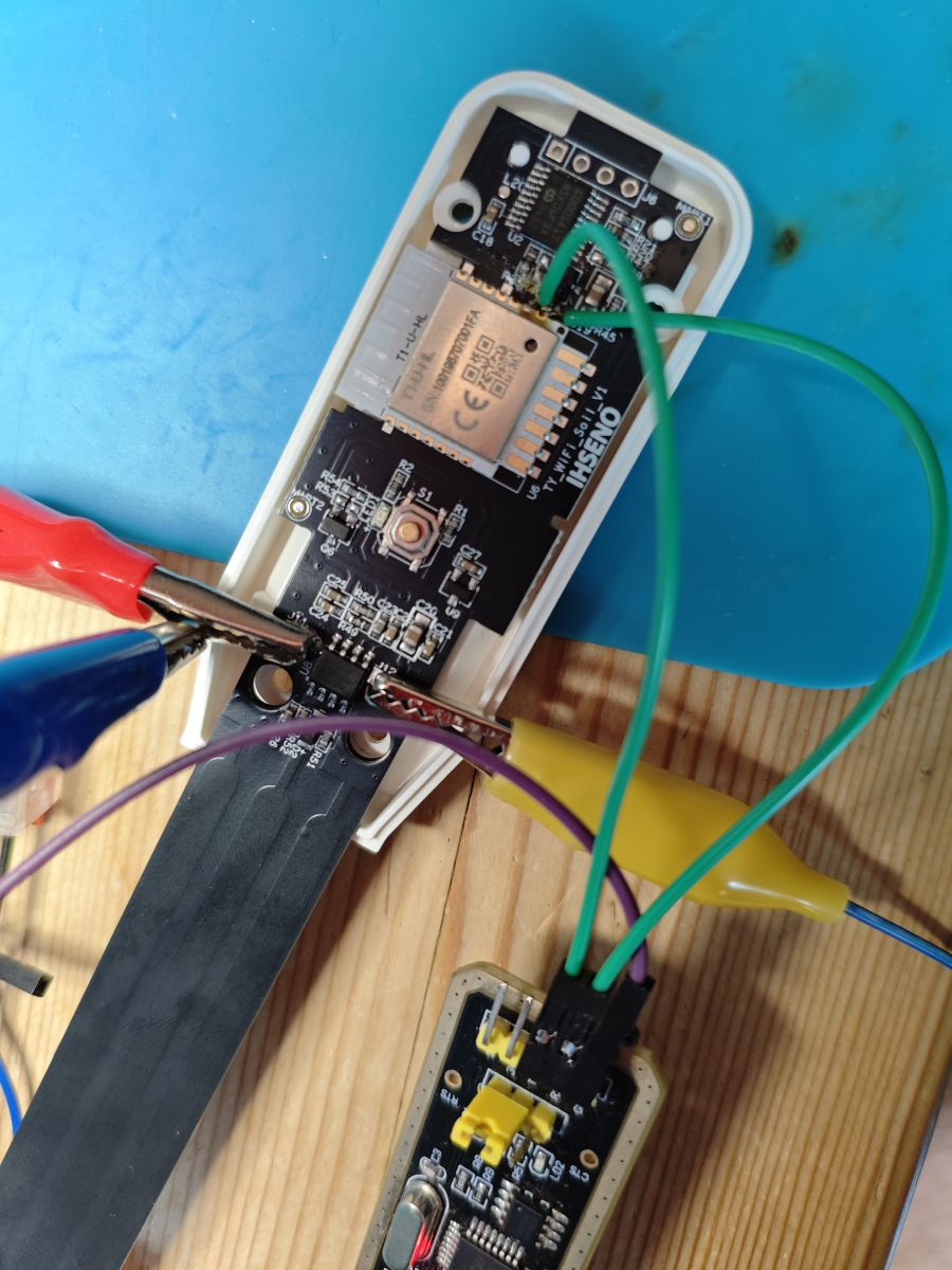

    Feeding 3V through the batters terminals and from TX2 the boot log is captured at 115200 baud:
    Unfortunately, the MindMotion MCU gets in the way of any flash read efforts on RX1/TX1, even with the MCU Nrst held low, so the module had to be hot air gun removed for flashing away from the MCU.
    Sensor with Tuya T1-U-HL module wired to programmer via test leads
    Tuya T1-U-HL module with BK7238 MCU attached to a test board Close-up of PCB with TY_WiFi_Soil_V1 module and components under green coatingTuya T1-U-HL module with test wires soldered, placed on a blue surface

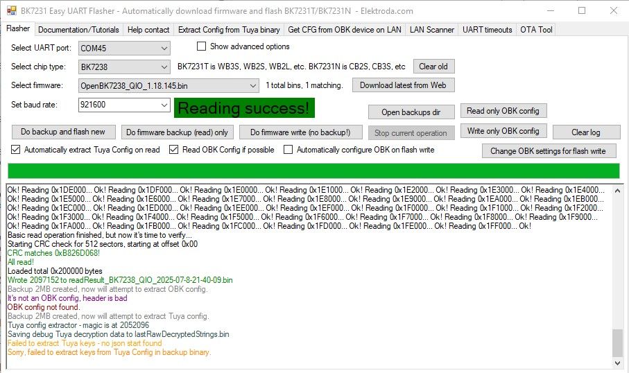

    Easy Flasher reads whole flash successfully in BK7238 mode
    Screenshot of BK7231 Easy UART Flasher showing “Reading success!” message
    As a precaution a backup is also taken with BKFIL

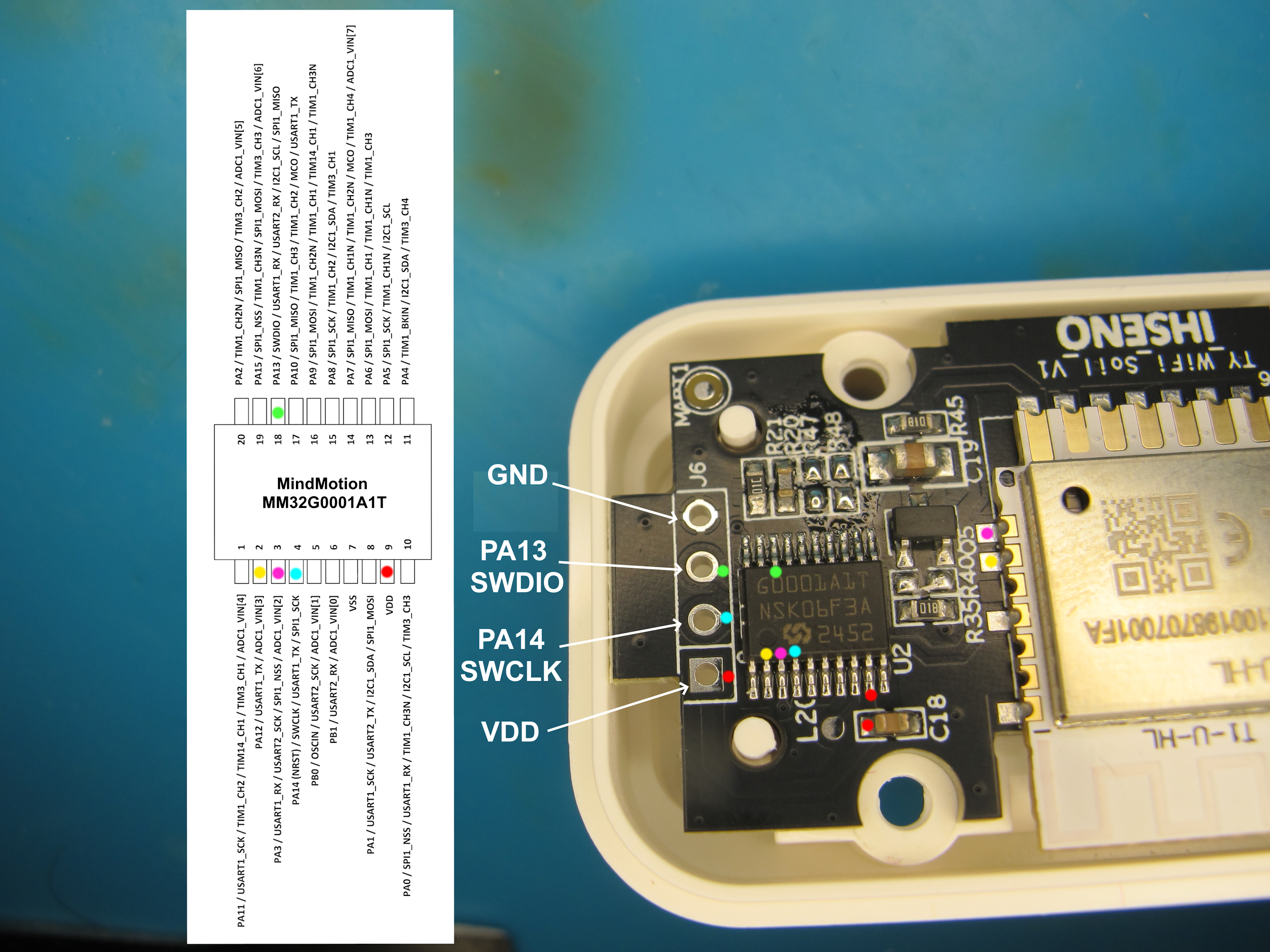

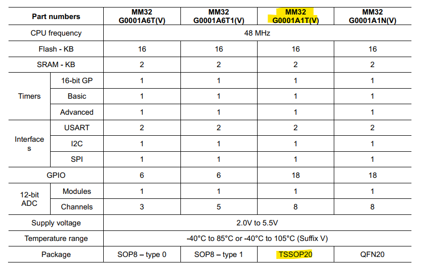

    Regarding the TSSOP20 MM32 MCU (datasheet attached) we read this overview
    Comparison table of MM32G0001 microcontrollers highlighting TSSOP20 variant
    And to put how it connects to the 4 test pads and to the T1-U-HL in context:
    Close-up of PCB with Tuya module and labeled MM32G0001 microcontroller pins.

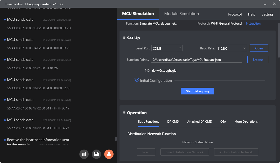

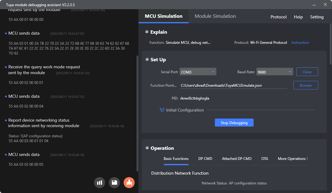

    With the backup flashed to the NiceMCU and setup to talk to the Tuya Module Debugging Assistant with product ID rknwi0ctbbghzgla we can pair it with the Tuya app to check firmware versions, device appearance, options and readings
    View of MCU simulation in Tuya Module Debugging Assistant with diagnostic data

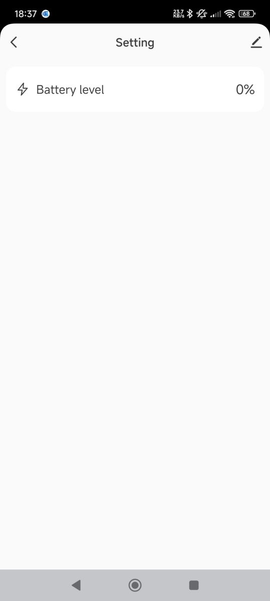

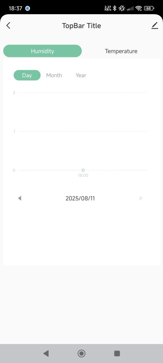

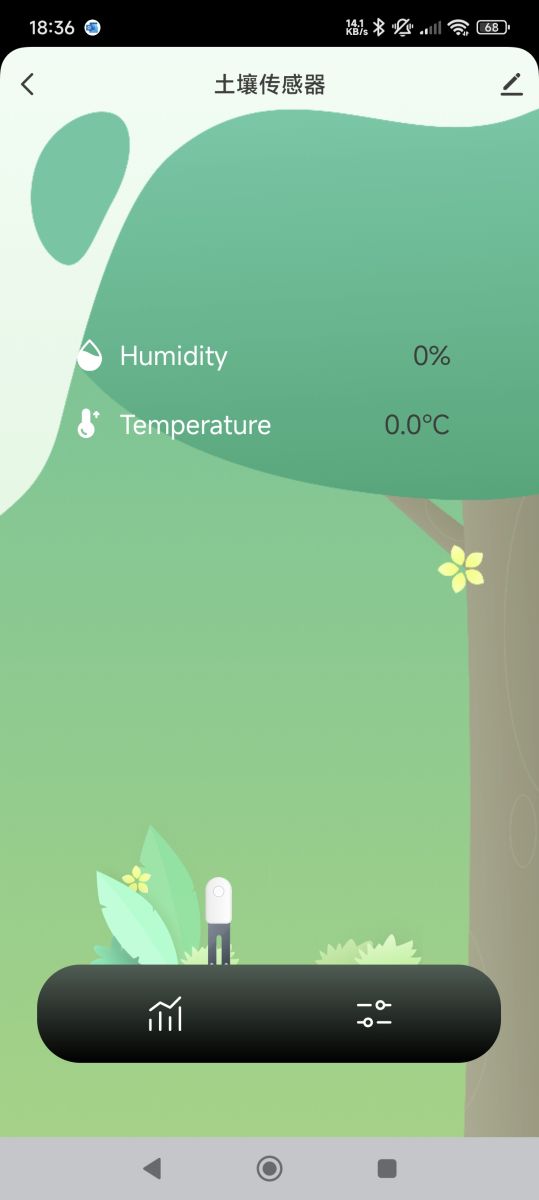

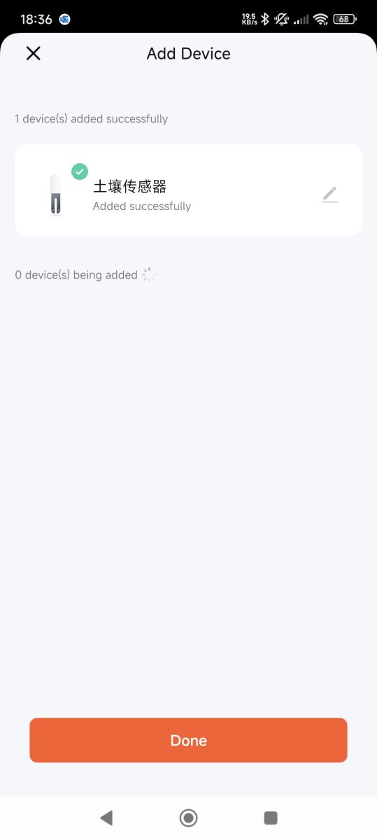

    It seems it's just a glorified temperature and humidity sensor.
    App screen showing successful addition of a soil sensor to Tuya systemApp screen showing soil sensor with 0% humidity and 0.0°C temperature readings Mobile app screenshot showing humidity graph for 2025/08/11 App settings screen showing battery level at 0% Device update screen indicating no updates available
    with the Tuya app linked to a dev account we can retrieve the dpIDs, needed for OpenBK7238 setup
    which when made pretty:
    Interesting, separate dpIDs for Fahrenheit and a switcher dpID. I don't see a change function in the app. The manual offers no clues.

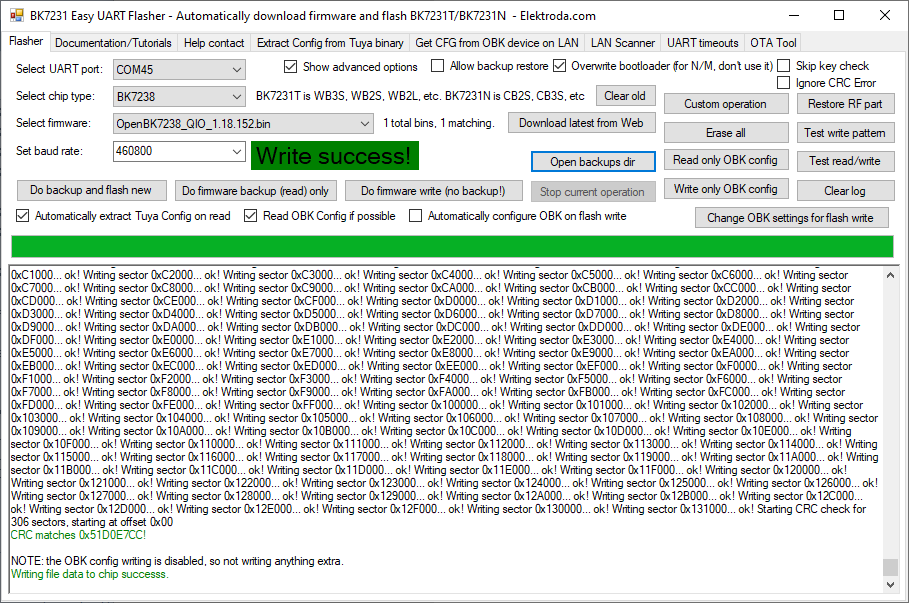

    OpenBK7238 flashed over the top of factory firmware. I chose to overwrite the bootloader because keeping the factory BL meant OTA updates were not successful.
    Screenshot of Easy UART Flasher showing successful BK7238 flash operation

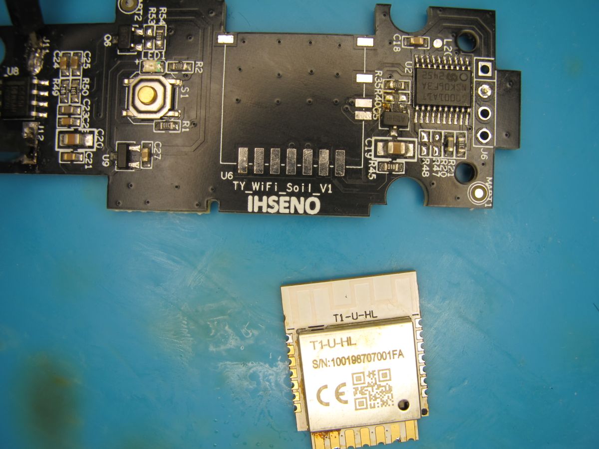

    PCB and module cleaned up. Excess solder removed with solder braid.
    T1-U-HL module next to TY_WiFi_Soil_V1 PCB, pads and microchips visible
    It appears the top two pads are only there to secure module to PCB - no traces on either side. It looks like P21 goes somewhere but I've yet to get any continuity to any component.

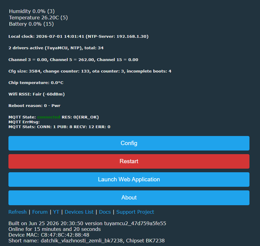

    With the module soldered back in and OBK unconfigured, you get 20s from button-push wake-up until the MCU withdraws power from the T1 module. This gives just about enough time to navigate to the web app, create autoexec and set a starting script
    With a basic starter:
    I get no readings and no response to tuyaMcu_sendQueryState. Flag 26 ([UART] Use alternate UART for BL0942, CSE, TuyaMCU, etc) toggled doesn't change that.
    This is where I will pause to investigate TuyaMCU comms to the NiceMCU with TMDA and to research the HGSEMI chip.

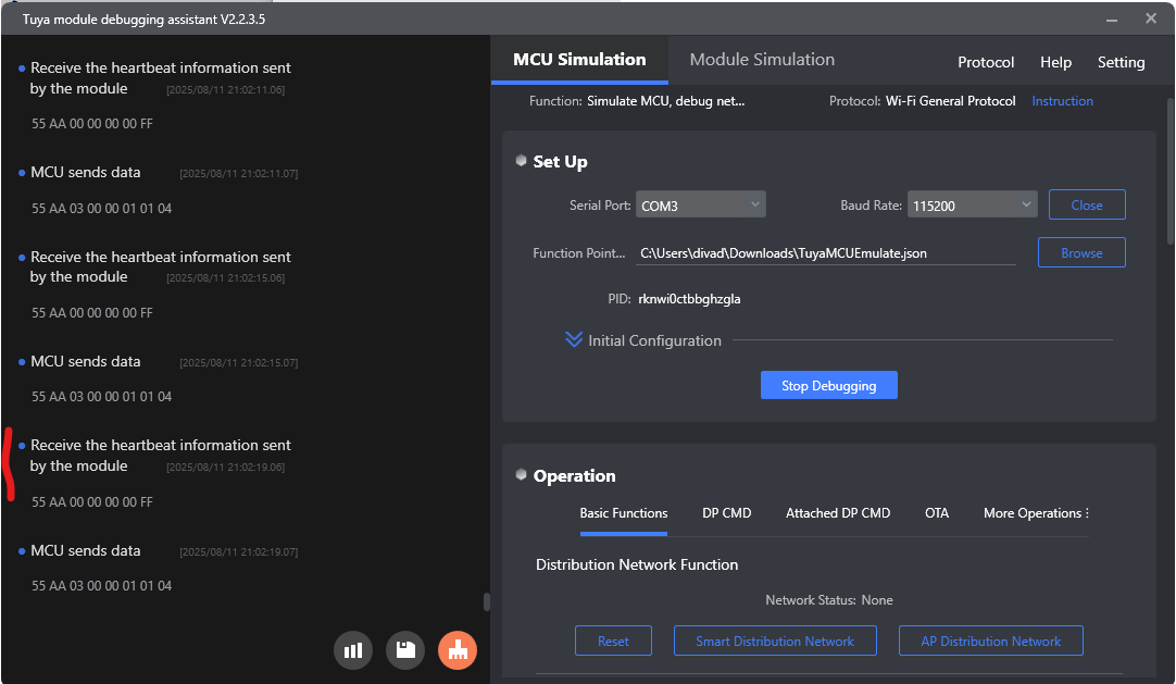

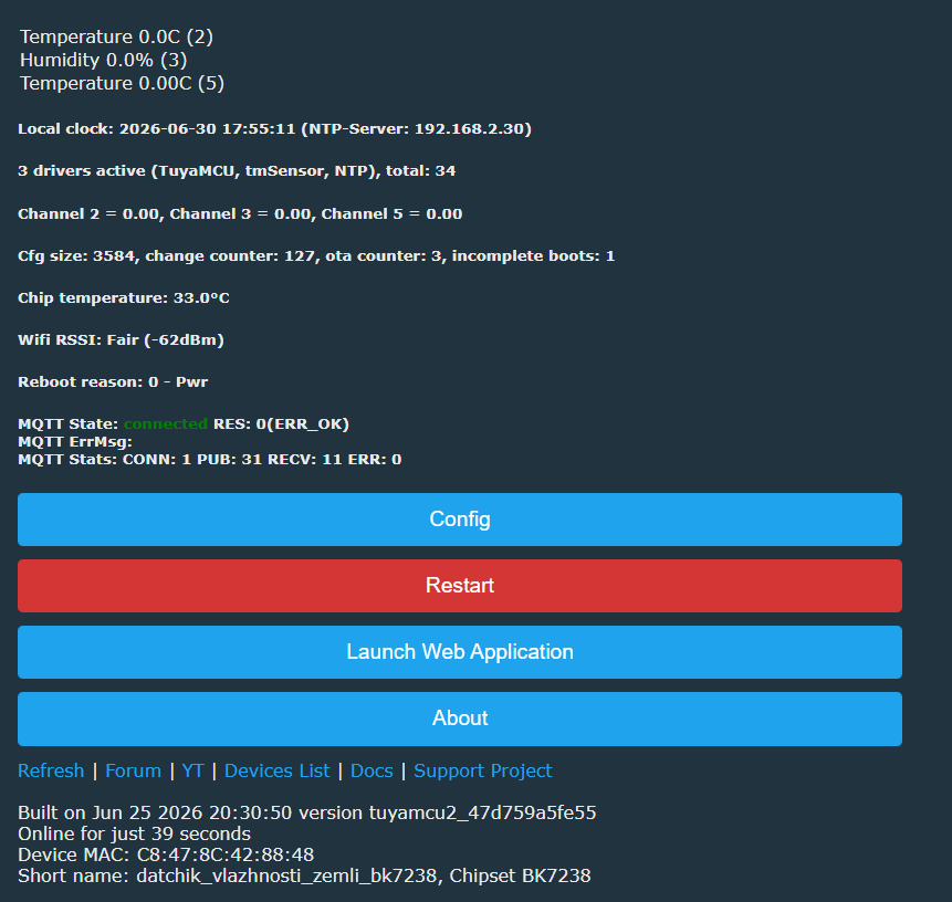

    TMDA says it is receiving a heartbeat from the NiceMCU
    Tuya MCU Debugging Assistant interface showing received heartbeat data
    but OBK doesn't log a valid heartbeat
    With tuyaMcu_sendQueryState command to TMDA we see TMDA receiving the request and sending loads of info
    Tuya MCU Debugging Assistant interface with active COM3 simulation
    BK7238 logs nothing received. To test this setup should work, swapped to BK7231N and many responses enumerate

    Very nice analysis, here's some little info from me - as far as I know, tuyaMcu_sendQueryState is only for core TuyaMCU (non-battery powered). So it is fully expected for battery powered (tmSensor) to ignore tuyaMcu_sendQueryState call.
  • #4 21634599
    Posts: 5209
    Help: 446
    Rate: 914
    OK sure, but on NiceMCU with no tmsensor running I would expect to see TuyaMCU responses in OpenBK7238 log. No heartbeat or any commands manually sent from TMDA are shown as received.

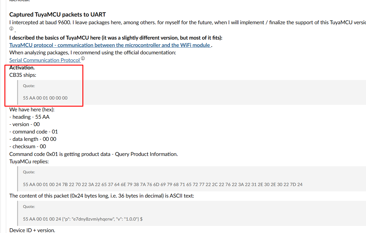

    If the device is using Battery Powered Tuya Serial Protocol, then it will not reply to classic TuyaMCU driver. tmSensor (Battery Powered Tuya Protocol) is different, and, as far as I remember, the MCU expects a very special packet to be sent from tmSensor when WiFi module boots.
    There was somewhere a nice Tuya page with full documentation of that.
    Also see here:
    https://www.elektroda.com/rtvforum/topic3914412.html
    Screenshot of forum showing TuyaMCU packet analysis and hexadecimal command example.

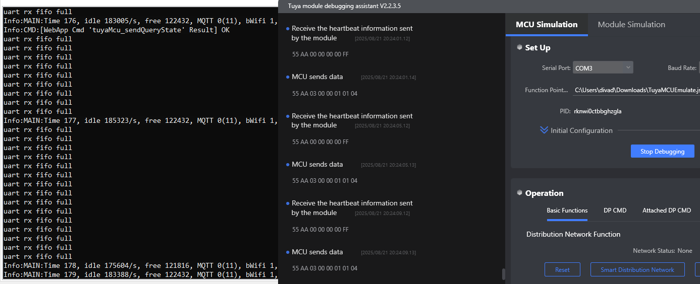

    back again.
    NiceMCU / Tuya Module Debugging Assistant TX/RX over P0/P1:
    TuyaMCU driver only.
    TMDA acknowledges heartbeats and will send query state response to BK7238 but BK7238 only prints this for anything received from TuyaMCU simulator:
    Screenshot of UART fifo full messages and Tuya debugging interface with MCU simulation

    getting something. no response to tuyaMcu_sendQueryState though and no sensor readings
    Humidity 0.0% and temperature 0.00°C displayed on dark background

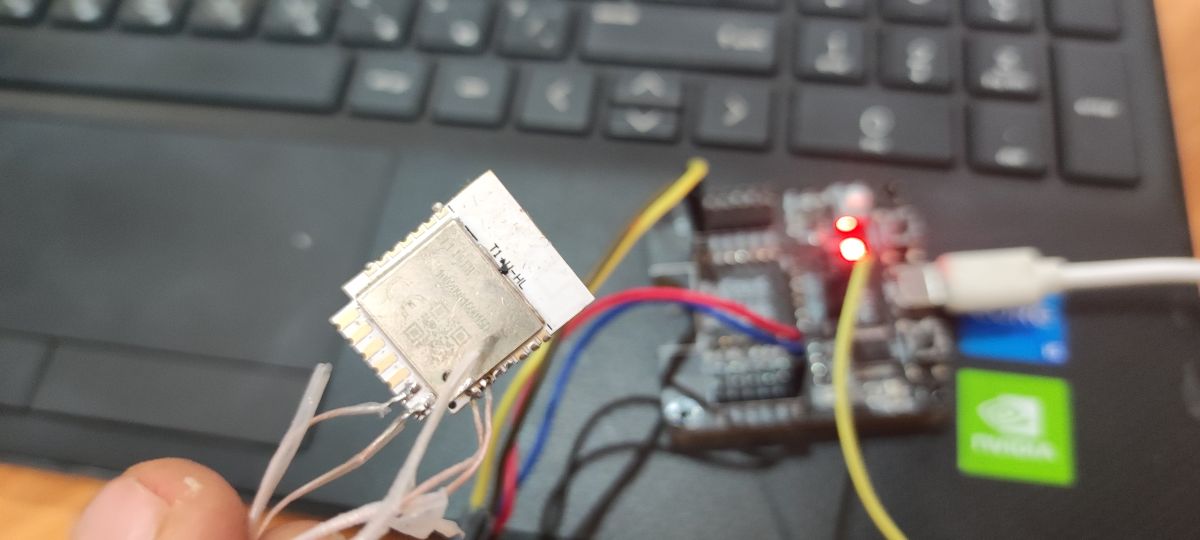

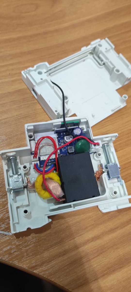

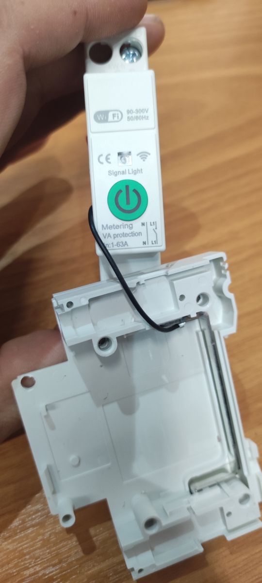

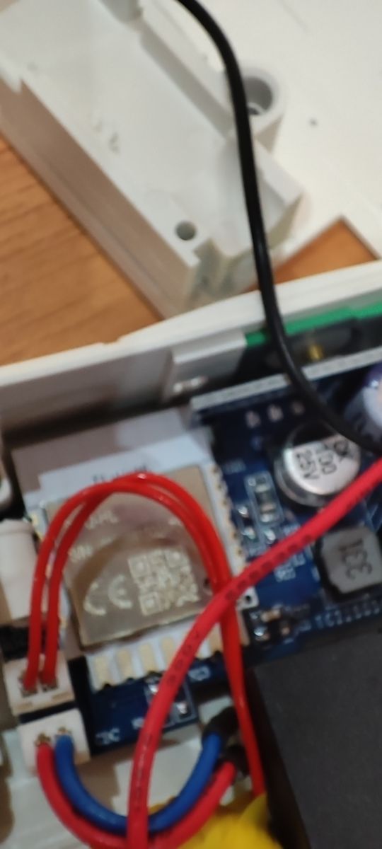

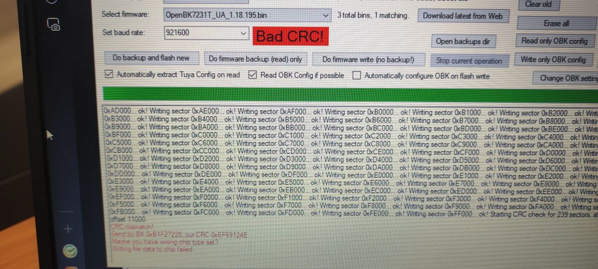

    Hi! I can't flash a smart starter to a din rail. The t1-u-HL chip. Gives the following error:
    CRC mismatch!
    Send by BK 0xB1F27228, our CRC 0x69DCC8B9
    Maybe you have wrong chip type set?
    Writing file data to chip failed.
    I have several devices. And I can't flash any of them. Please help me, friends
    ESP32 module with connected wires in front of a development board and laptop
    Added after 3 [hours] 34 [minutes]:
    Please tell me how I can select only the BK7238 chip in the flasher, and not all BK7231T chips?
  • #12 21722607
    Posts: 5209
    Help: 446
    Rate: 914

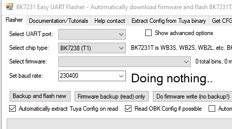

    not sure what this means. You can only select one chip mode at a time in Easy Flasher
    Screenshot of BK7231 Easy UART Flasher with BK7238 chip selected and idle status
    T1-U-HL is BK7238

    And if you have multiple T1 devices, you should either do "Show advanced options" -> "Restore RF part", or "Show advanced options" -> "Custom operation" -> "Restore RF from backup".
    "Restore RF from backup" is recommended. Backup can be either original firmware, or even with OBK already flashed.
    Otherwise there will be MAC conflict in your network.
    (I think this needs to be added to guide)

    Screenshot of BK7231 Easy UART Flasher with firmware selection options shown.
    I don't have a T1 chip. How do I add it?
  • #16 21723648
    mvz0209
    Posts: 20
    Everything is clear) I'm stupid)) I'm using the 2023 firmware
  • #17 21723650
    Posts: 5209
    Help: 446
    Rate: 914
    mvz0209 wrote:
    Everything is clear
    Added after 55 [seconds]:
    don't forget to take a full backup first
  • #18 21723653
    mvz0209
    Posts: 20
    Thanks, to be honest, I've never needed backups before) I'll try to post a few of my devices on the forum soon

  • #23 21930329
    malaysk
    Level 4  
    Posts: 11
    Hello. I bought the same soil moisture sensor device and successfully reflashed it. I’m facing the same situation as you—the sensor readings are all showing zero. Did you manage to solve this problem?
  • #25 21930357
    malaysk
    Level 4  
    Posts: 11
    divadiow wrote:
    probably the missing v3 TuyaMCU protocol command support.
    Sorry, I didn't quite catch that. Do I need to update the firmware to
    OpenBK7231T_App_tuyamcu2_47d759a5fe55_OpenBK7238_battery
    ? If so, could you tell me what the full auto-exec config for this device should look like now?
  • #26 21930541
    Posts: 5209
    Help: 446
    Rate: 914
    I didn't complete full device setup, but I think the starter autoexec in the first post still stands.
    Flash QIO from OpenBK7231T_App_tuyamcu2_47d759a5fe55_OpenBK7238
  • Sensors still read zero with TuyaMCU config
    #27 21930634
    malaysk
    Level 4  
    Posts: 11
    Unfortunately, the firmware update didn't help me. The sensors are constantly reading zero.
    Screenshot of TuyaMCU web panel showing 0.0 temperature and 0.0% humidity with Config and Restart buttons
    I used your configuration.
    tartDriver TuyaMCU
    startDriver TMSensor
    startDriver NTP
    // set TuyaMCU baud rate
    tuyaMcu_setBaudRate 115200
    // set TuyaMCU default wifi state 0x04, which means "paired",
    // because some TuyaMCU MCUs will not report all data
    // unless they think they are connected to cloud
    tuyaMcu_defWiFiState 4
    // dpID 5 is tempererature div 10
    setChannelType 5 temperature_div10
    linkTuyaMCUOutputToChannel 5 val 5
    // dpID 3 is % humidity
    setChannelType 3 Humidity
    linkTuyaMCUOutputToChannel 3 val 3
  • #28 21930638
    Posts: 5209
    Help: 446
    Rate: 914
    maybe not.
    get rid of tmsensor and reboot
  • #29 21930665
    malaysk
    Level 4  
    Posts: 11
    Unfortunately, this didn't help either. Do you still have this device?
  • #30 21930857
    malaysk
    Level 4  
    Posts: 11
    divadiow wrote:
    get rid of tmsensor
    My temperature miraculously dropped to 26-29 degrees Celsius three times. But that happens very, very rarely. The humidity is always at zero.

What UART settings and pads should I use to capture logs?
Capture the boot log at 115200 baud from TX2. Power the board at 3V on battery terminals. You will see SoftAP startup, BLE advertising, and product identifiers. Keep ground common and observe the 20-second wake window after button press. [Elektroda, divadiow, post #21632460]
Why can’t I read flash over RX1/TX1 even with the MM32 reset held low?
The MM32G0001 still interfered on RX1/TX1, blocking access. Holding NRST low didn’t help. The fix was to hot-air remove the T1-U-HL and flash it away from the MCU. That edge case can save hours of failed reads. [Elektroda, divadiow, post #21632460]
What are the key T1-U-HL pins for development?
RX2/TX2 provide logs; 3V3 and GND power; CEN is active-low reset. ADC maps to P20; UART1 TX/RX are P11/P10; various PWM-capable GPIOs exist. The two top module pads act as mechanical anchors only. P21 appears routed but lacked continuity in testing. [Elektroda, divadiow, post #21632460]
