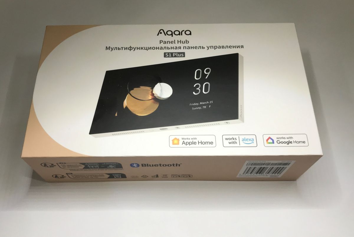

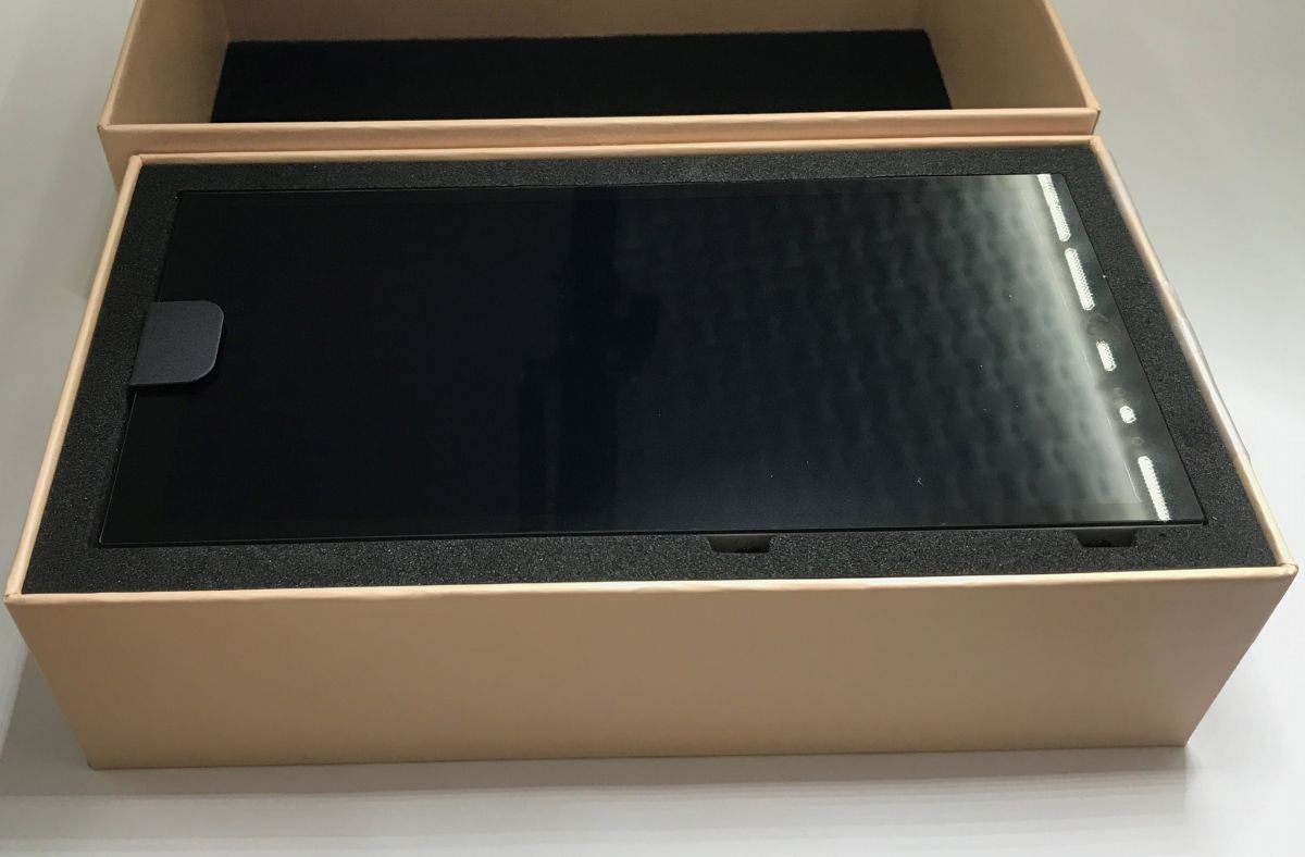

    Let's start with the contents of the kit:
    Aqara Panel Hub S1 Plus box with device image and compatibility icons Top side of Aqara Panel Hub S1 Plus box with labels and Bluetooth logo Back of Aqara Panel Hub S1 Plus box showing specifications and multilingual feature list .
    The whole is well protected for transport:
    Aqara S1 Plus panel inside packaging with foam protection .

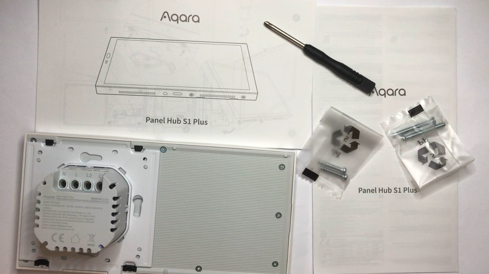

    We receive a manual, fixing screws, screwdriver and the device itself:
    Aqara Panel Hub S1 Plus kit with instructions, screws, and screwdriver .

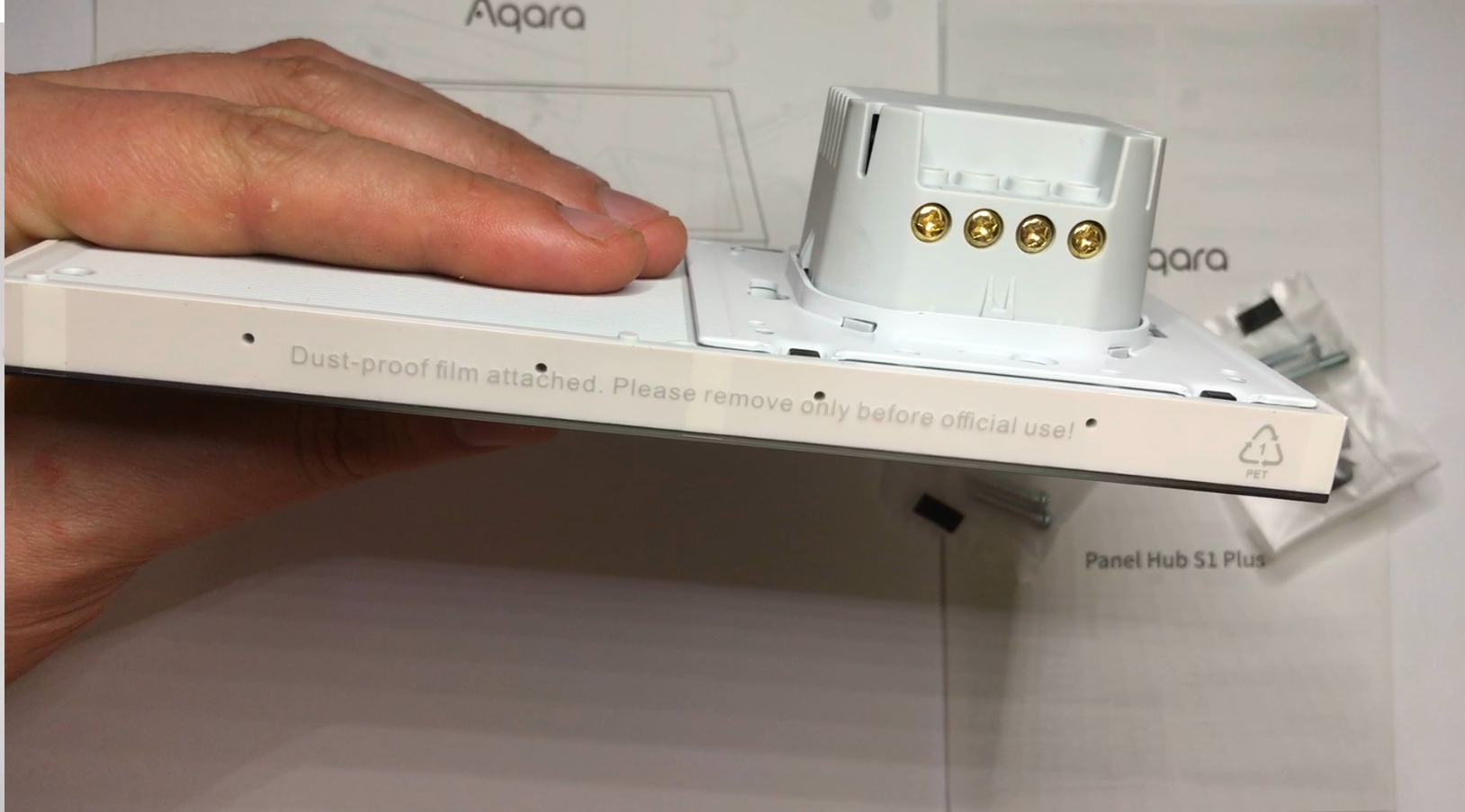

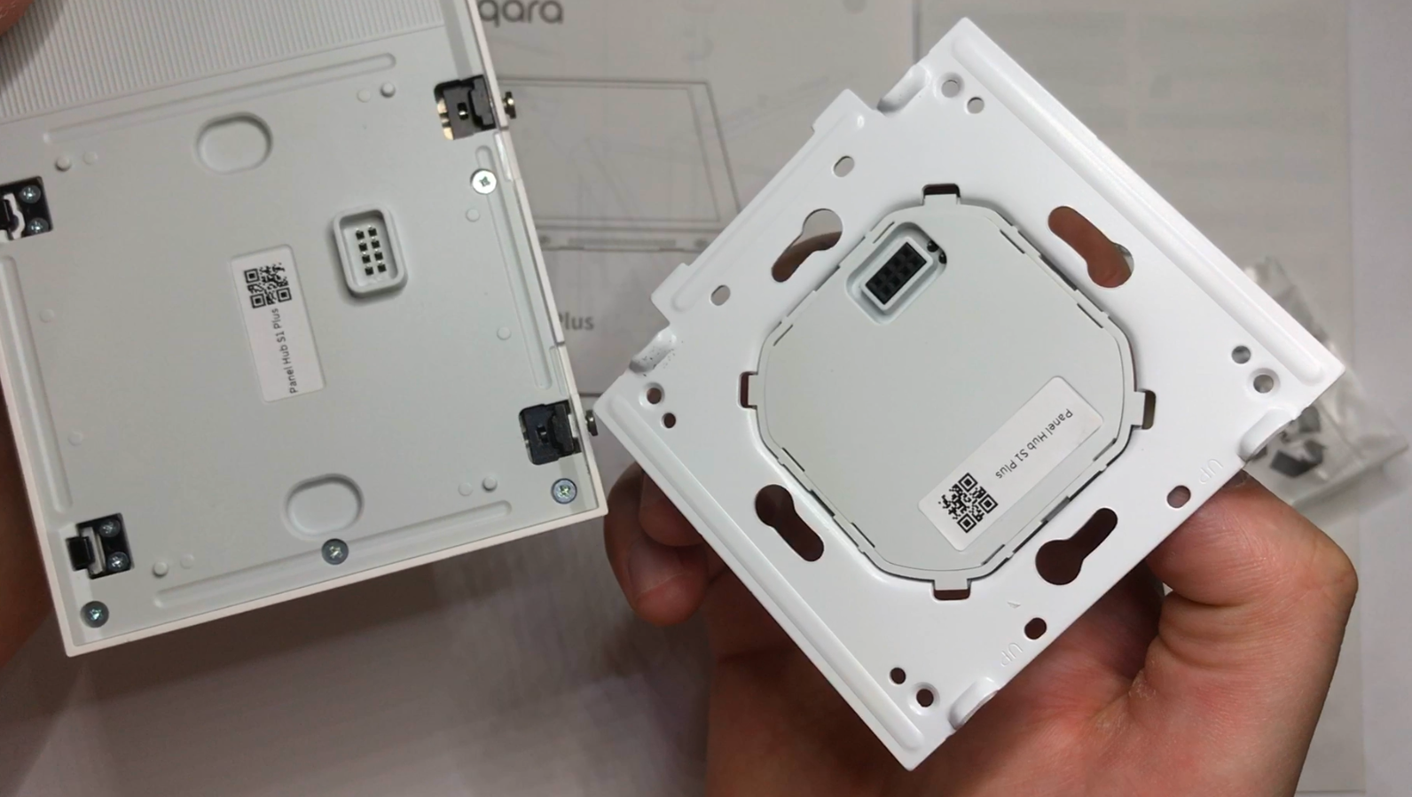

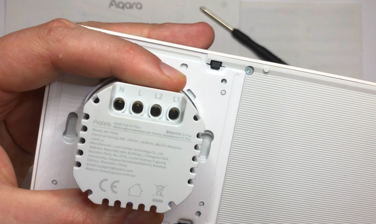

    The unit on the back has screw terminals for power supply and two relay outputs for lighting control. Fits into a typical box:
    Close-up of power terminals and relay outputs on Aqara S1 Plus panel .

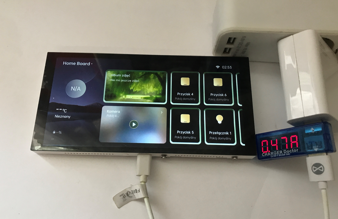

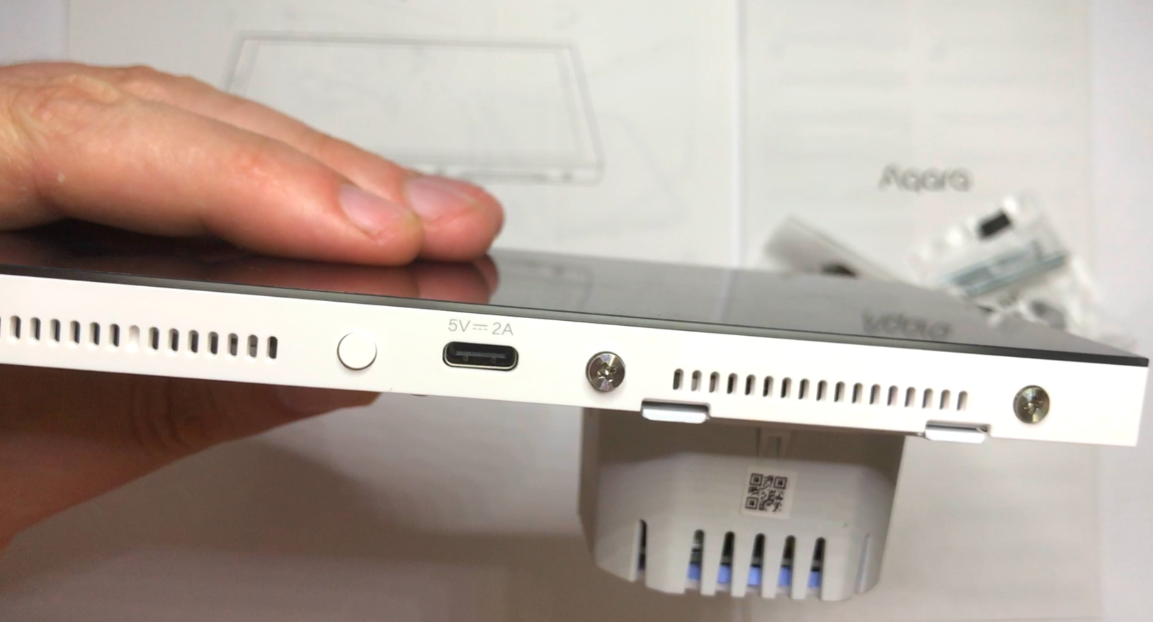

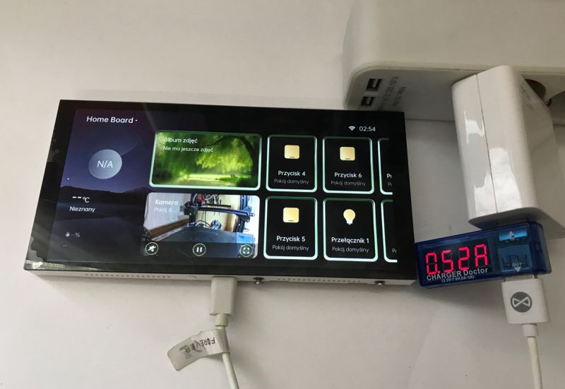

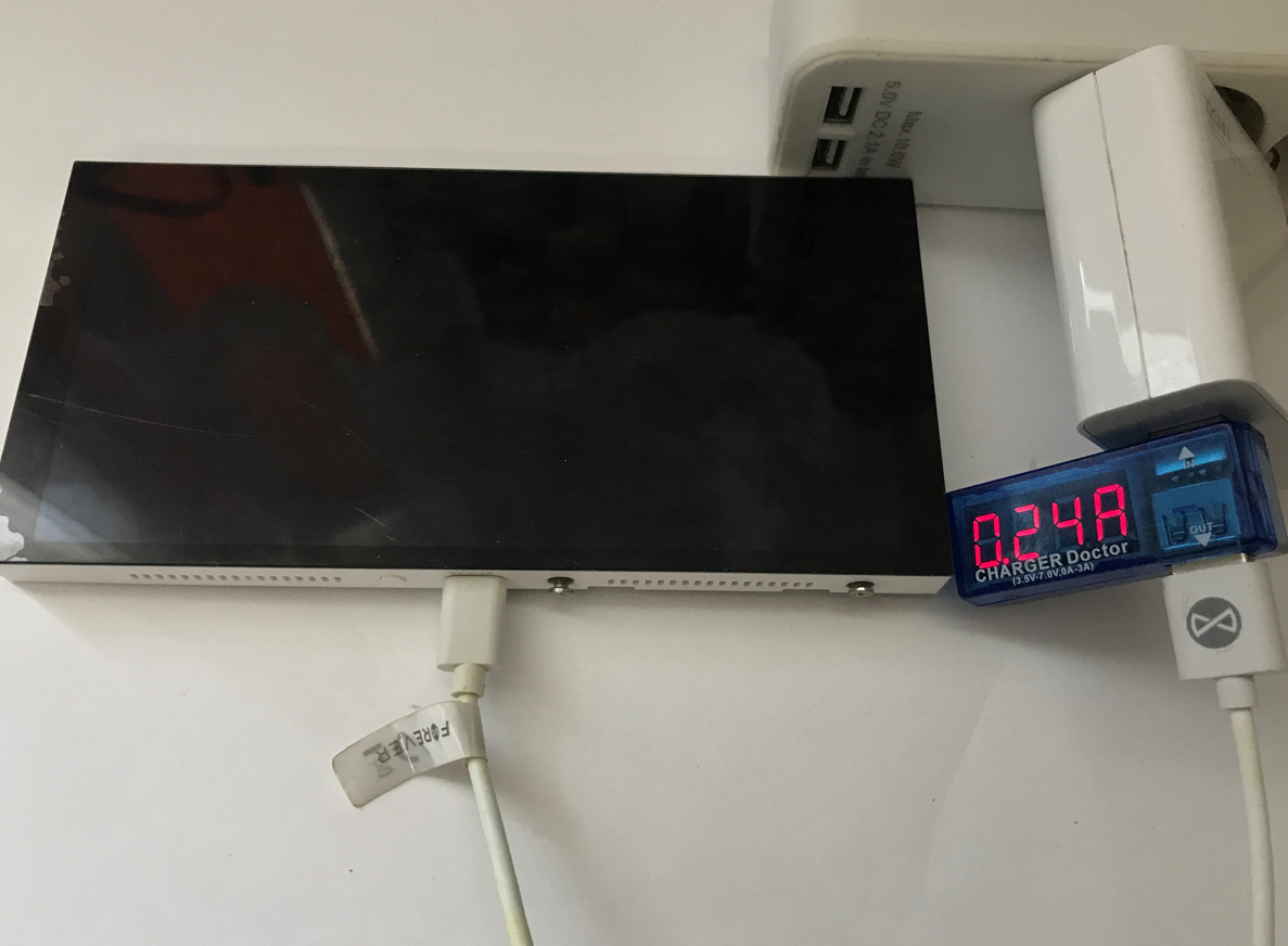

    However, this is not the only way to mount it. The panel is removable and can be powered by USB. In addition, here we have two 1W speakers and a button from the display.
    Close-up of Aqara panel top edge with USB-C port and power button visible .

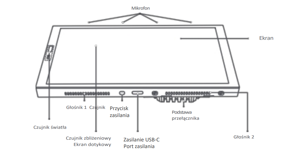

    On this side, in turn, you can see four microphones - if you add a camera to the set, you can even have a video intercom:
    Side view of Aqara panel with protective film and screw terminals visible .
    The device here also has an invisible proximity sensor and a light sensor:
    Front panel diagram of Aqara S1 Plus showing microphones, sensors, and controls .

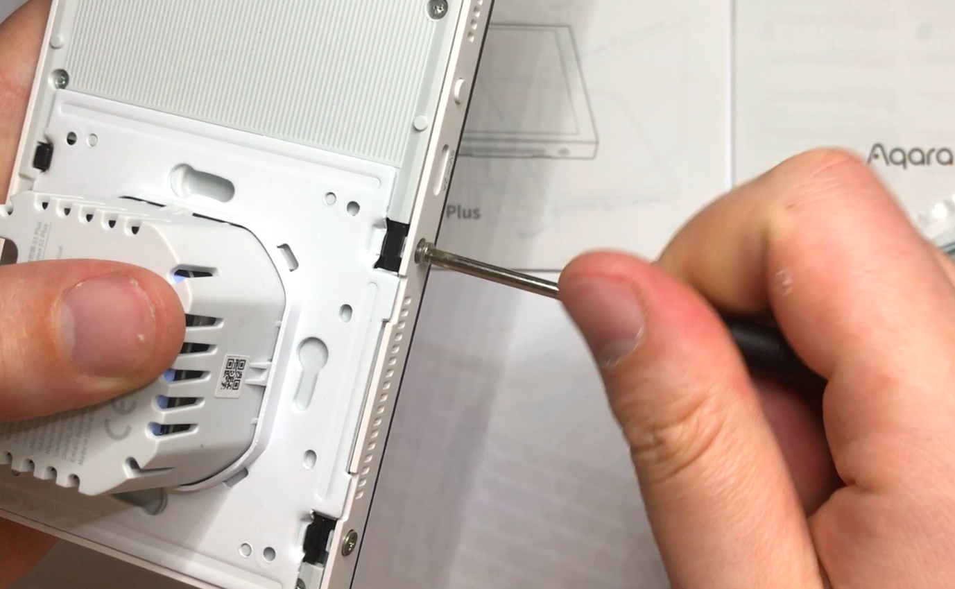

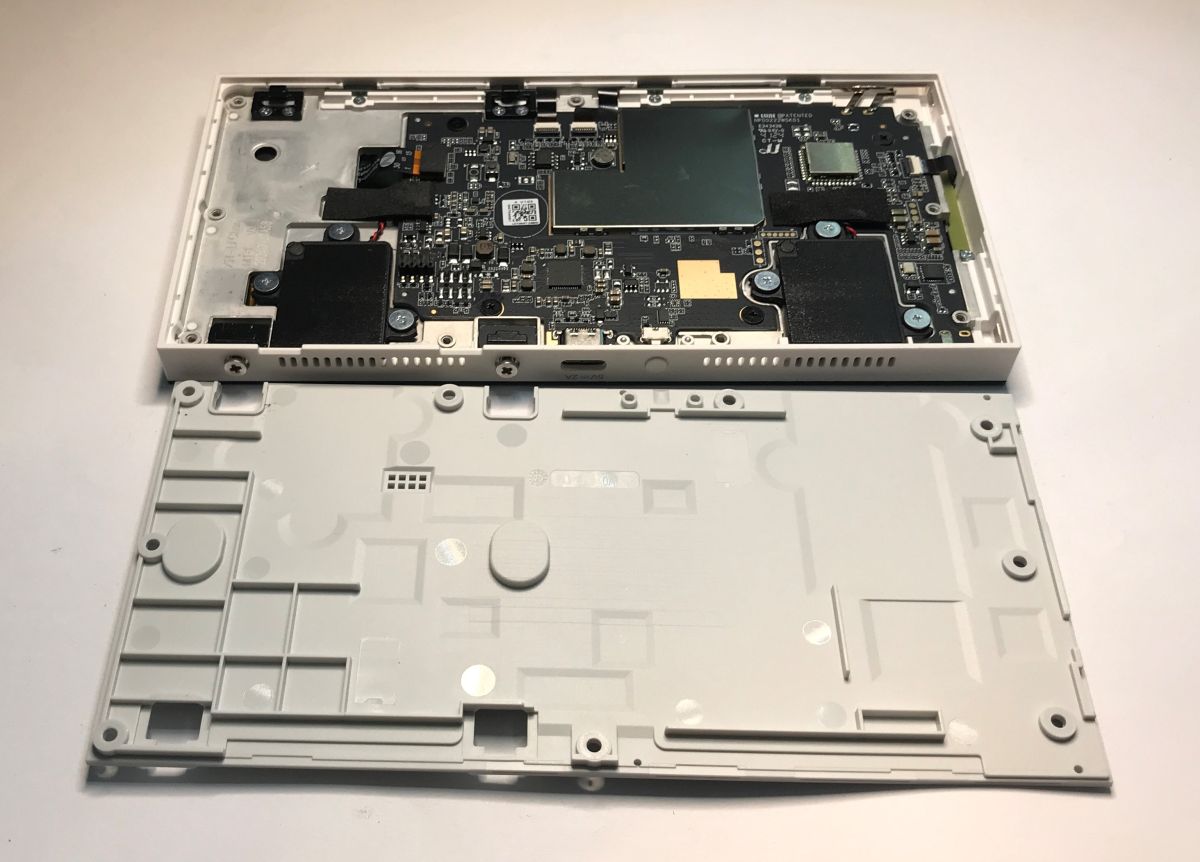

    The panel is very easy to remove:
    Hand unscrewing the Aqara Hub S1 Plus case with a small screwdriver .
    Finished:
    Rear view of Aqara S1 Plus panel and mounting bracket with connectors visible .

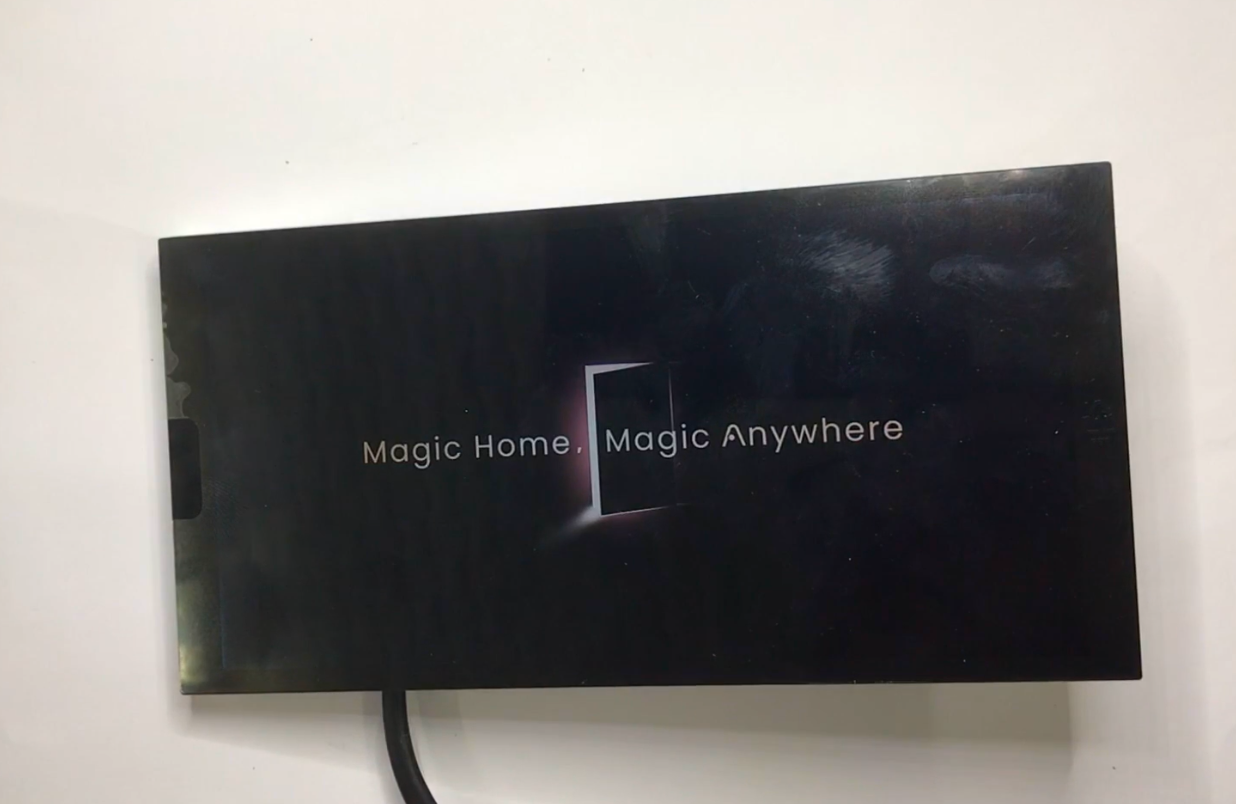

    First the welcome screen appears - you have to wait a while:
    Black Aqara S1 Plus startup screen with Magic Home, Magic Anywhere text and door icon .

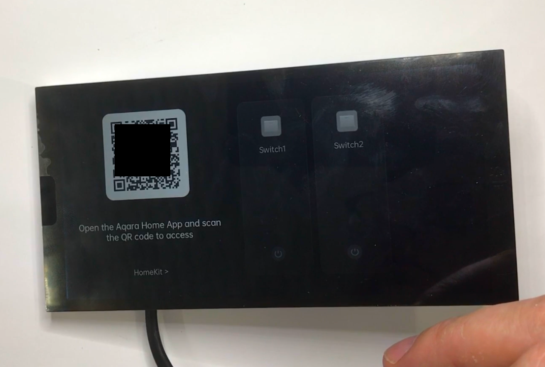

    The operation of the device is well thought out - no pairing is needed to control the relays. This allows testing at the installation stage by the contractor. QR code censoring has been added by me.
    Aqara S1 Plus panel with welcome screen, QR code, and Switch1 and Switch2 buttons .

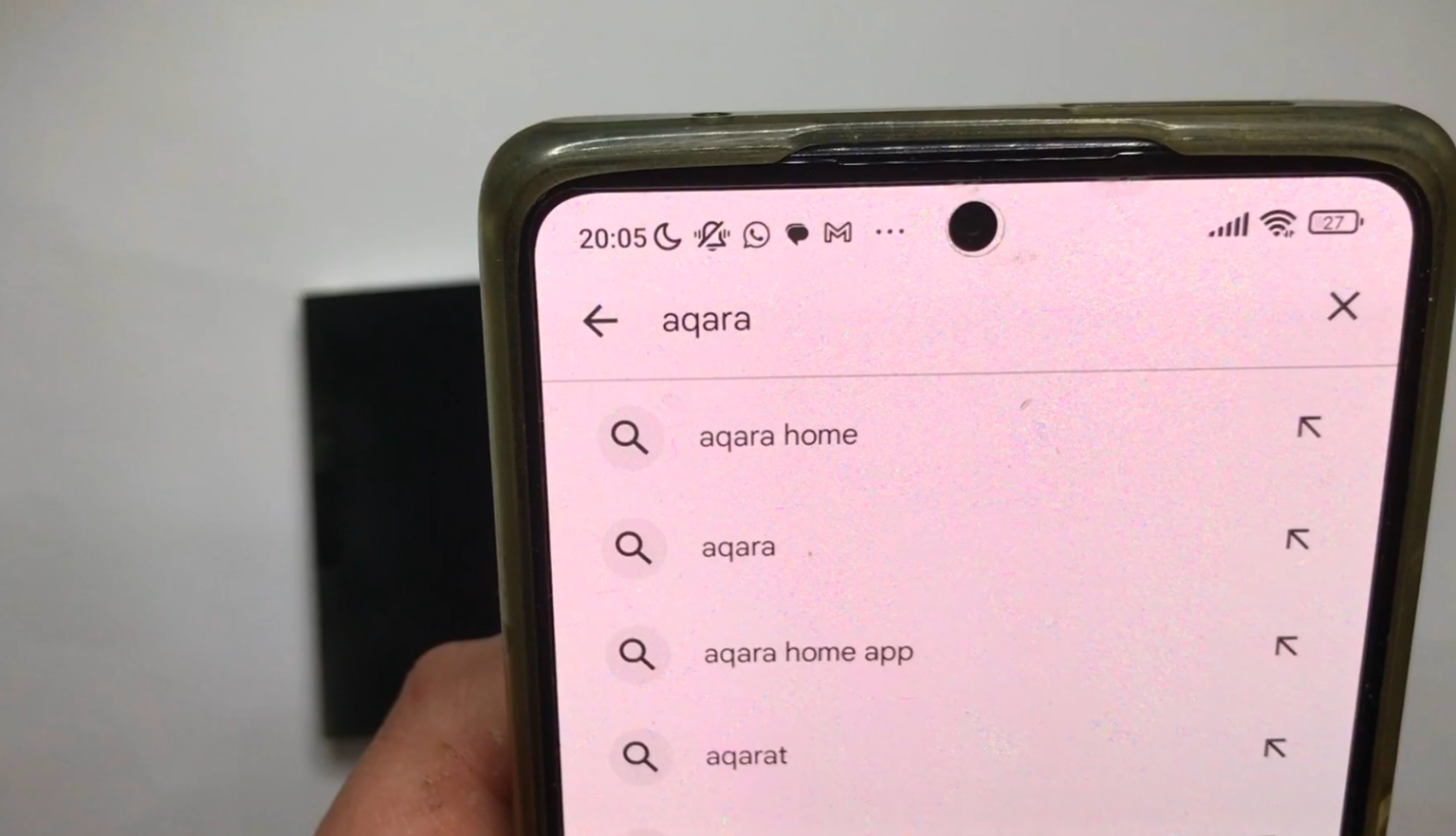

    So we download the Aqara Home app:
    Phone showing search results for “aqara” in an app store. .

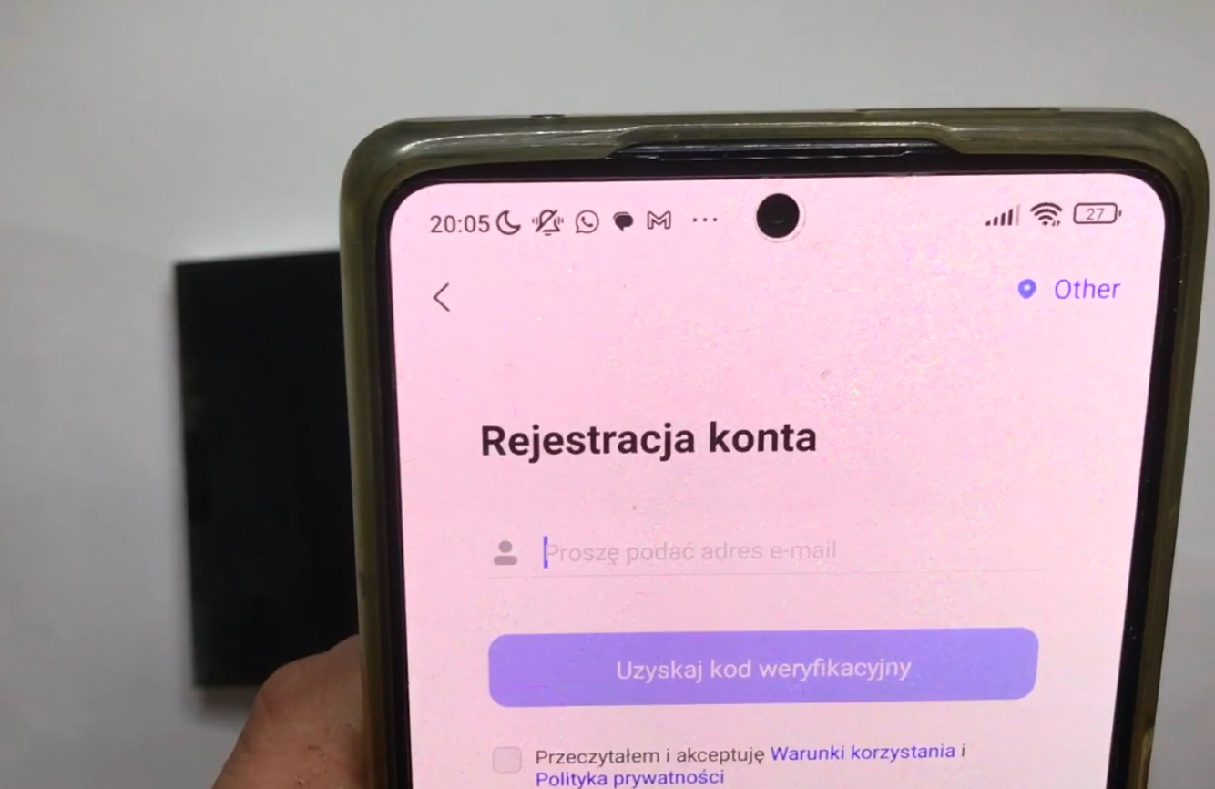

    We register an account - email is enough, they didn't ask me for a phone number. That's a plus, I don't want them to have too much data.
    Account registration screen in a mobile app displayed on a smartphone .

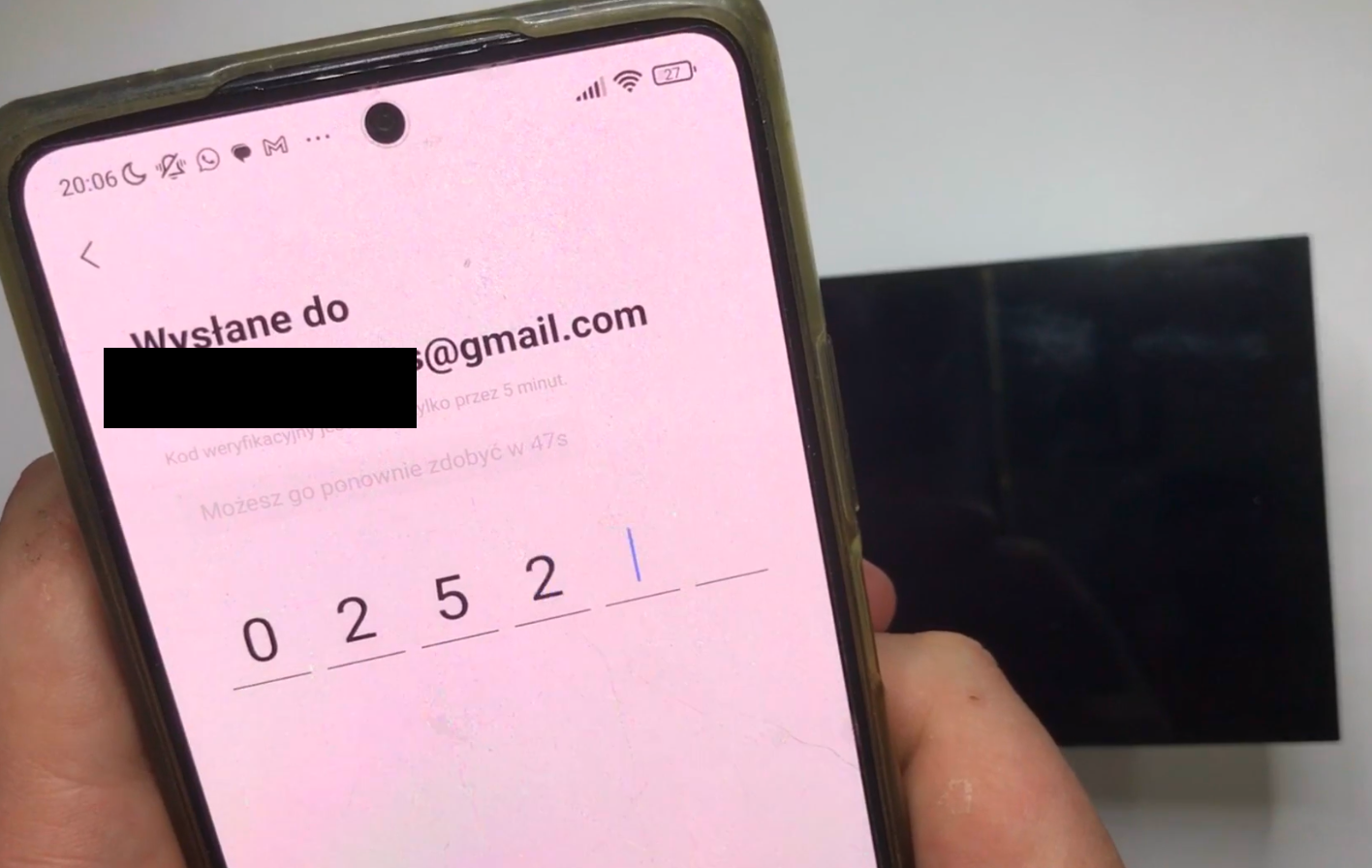

    Receive the activation code - check the Spam tab if you need to:
    Phone showing verification code screen in Aqara Home app .

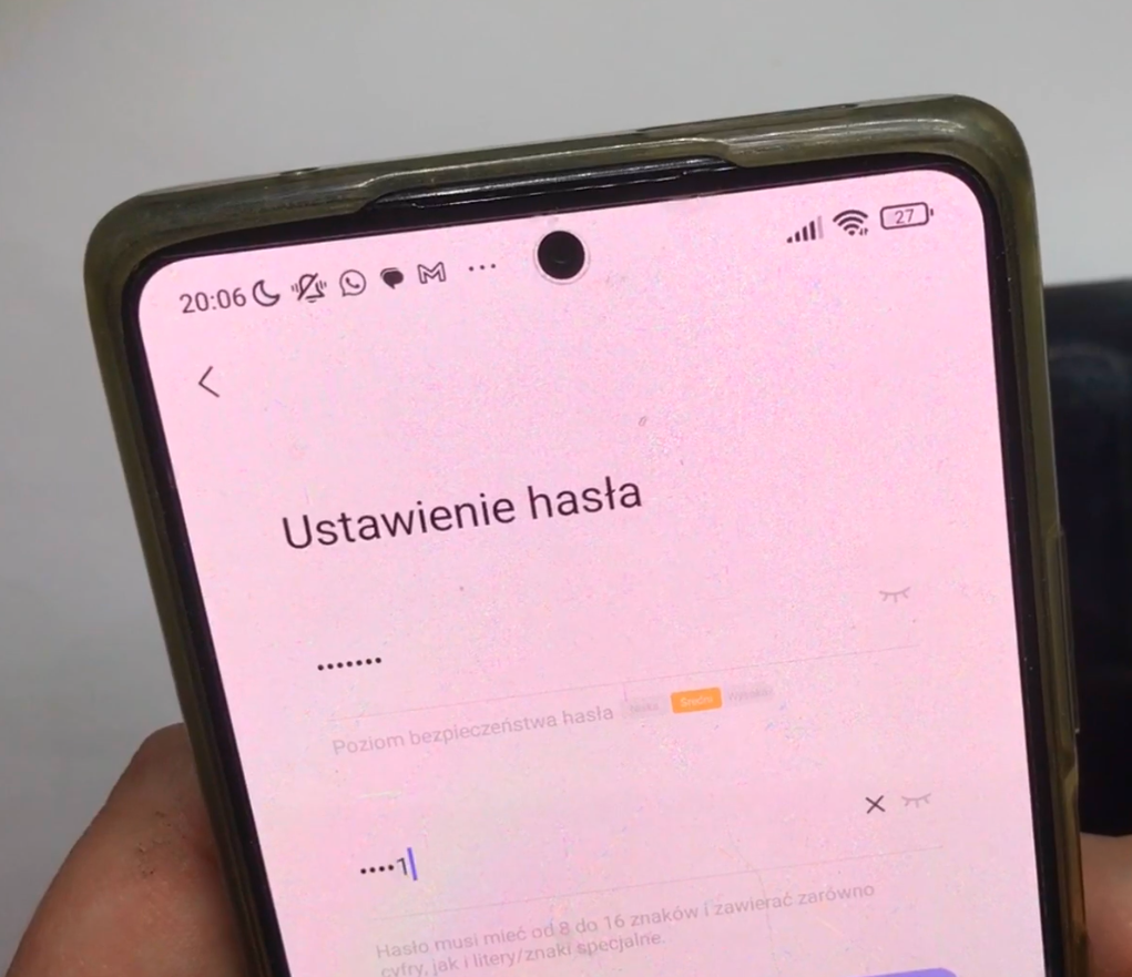

    We set the password:
    Smartphone showing password setup screen in Aqara app for Hub S1 Plus .

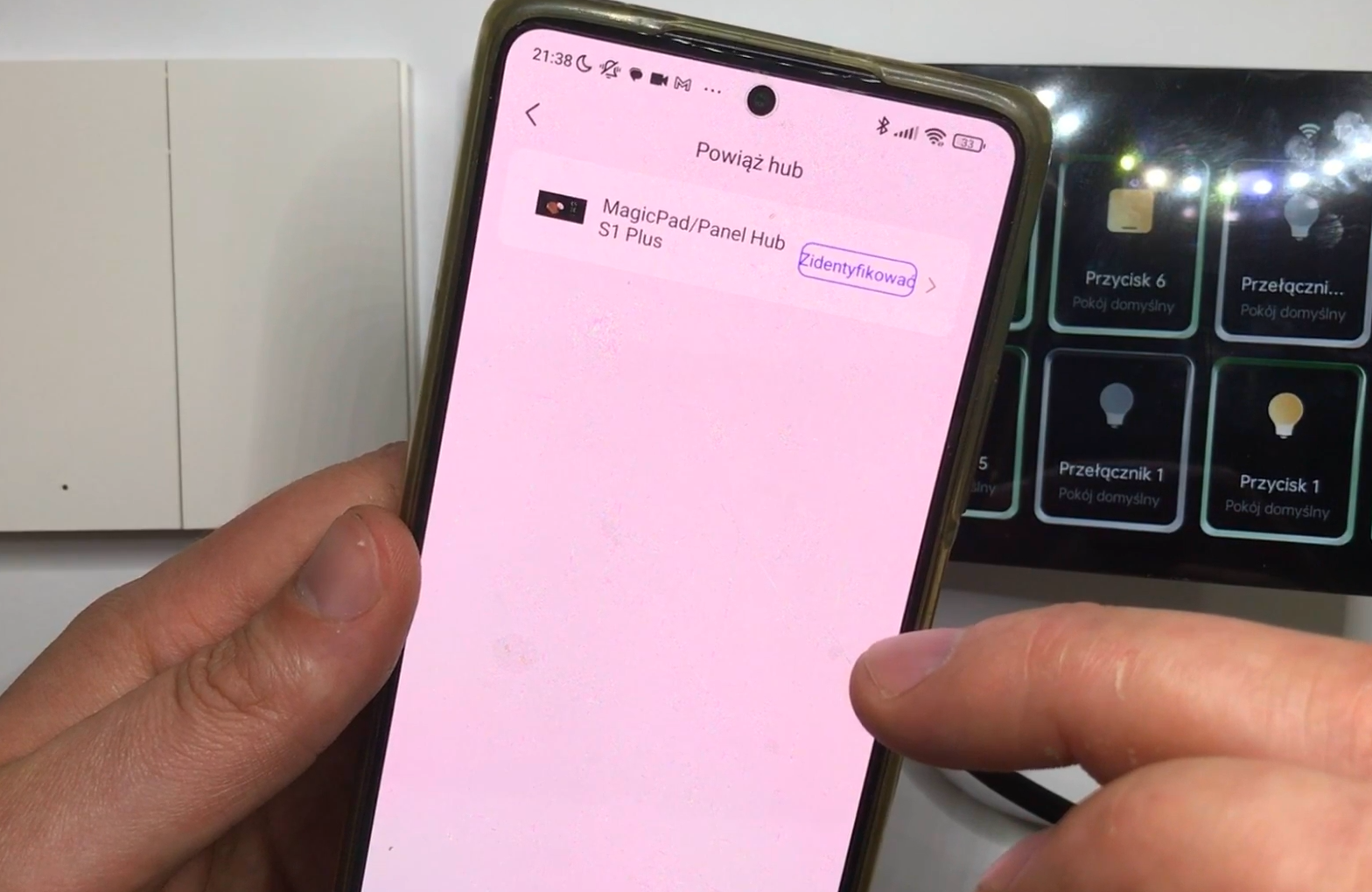

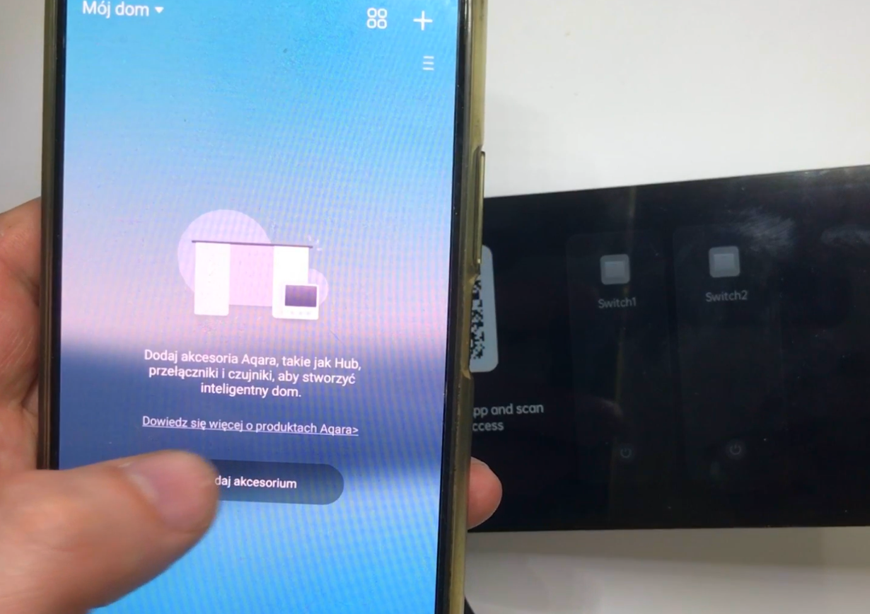

    We log in, select "add accessory":
    Smartphone with Aqara Home app screen in front of Aqara S1 Plus control panel .

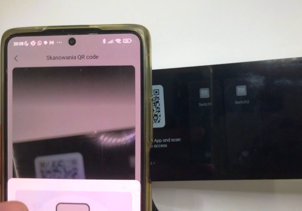

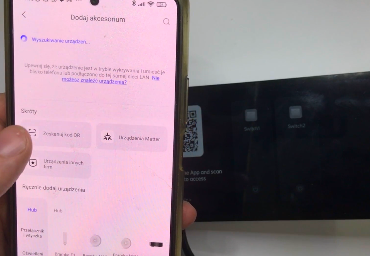

    We select the method with the QR code:
    Smartphone showing Aqara app next to a panel hub with QR code and two light switches .
    We scan the QR code:
    Smartphone scans a QR code displayed on the Aqara S1 Plus panel for pairing We scan the QR code.

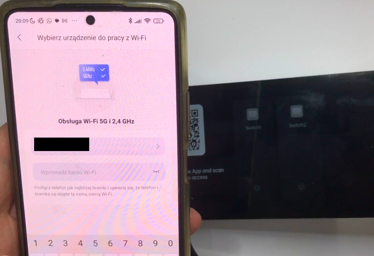

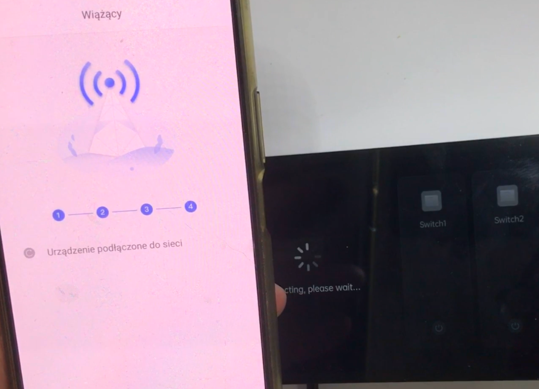

    We enter the details for our WiFi network:
    Phone showing Wi-Fi setup screen next to Aqara Hub S1 Plus panel with QR code .
    We wait for the pairing to complete:
    Phone with pairing app and Aqara S1 Plus panel displaying Connecting, please wait... .
    From then on, the device will be visible in our panel in the app, and the device display itself will also be given access to the other devices paired with our account.

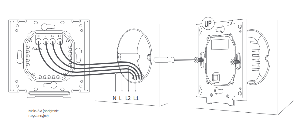

    The device has two built-in relays supporting loads up to 8A, which is certainly enough to control the lighting in a room.
    Wiring diagram for connecting Aqara S1 Plus panel in electrical wall box .
    The whole thing works smoothly and responsively - it catches clicks well and you don't have to touch twice to turn the light on. The configurability of the panel also allows you to change the order of the tiles, so you can give the most important touch switches a go if you need to. The operation of the switches is shown in the video:

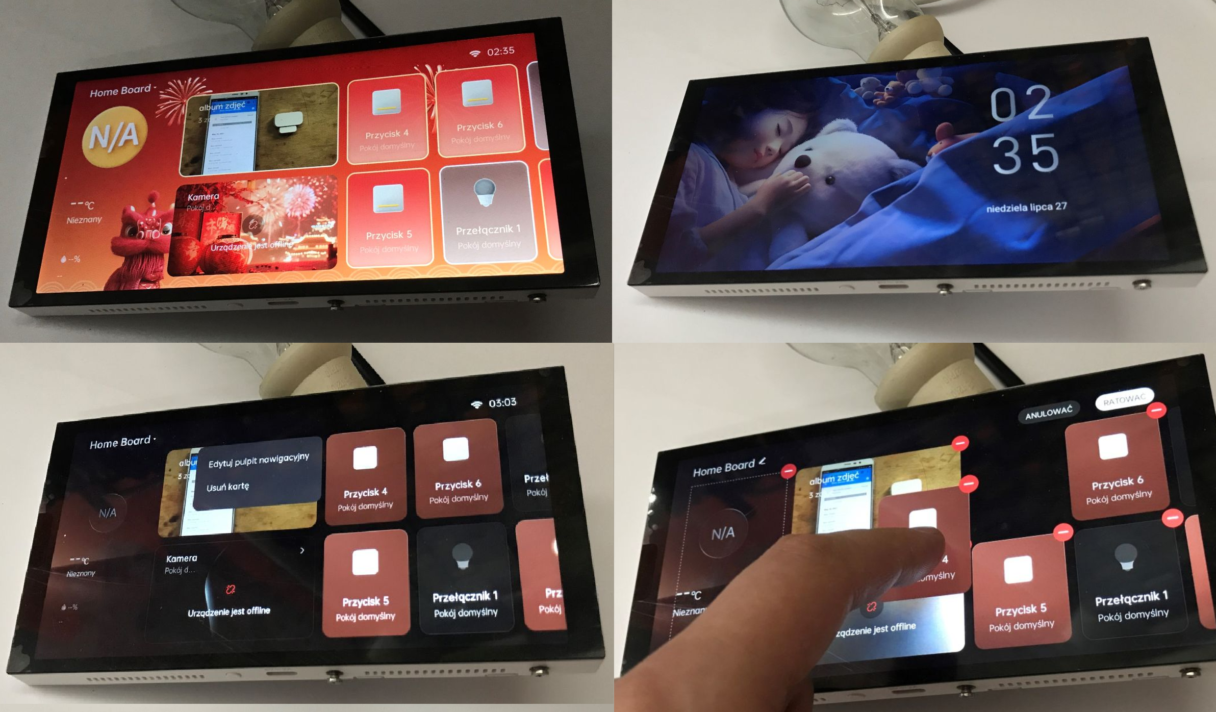

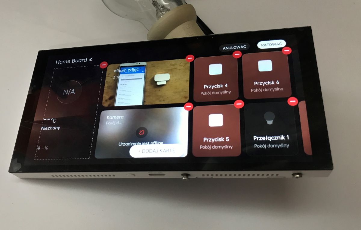

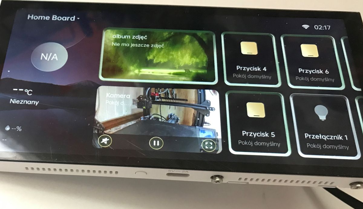

    Wide customisation possibilities .

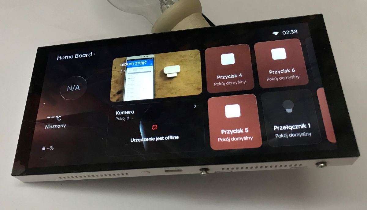

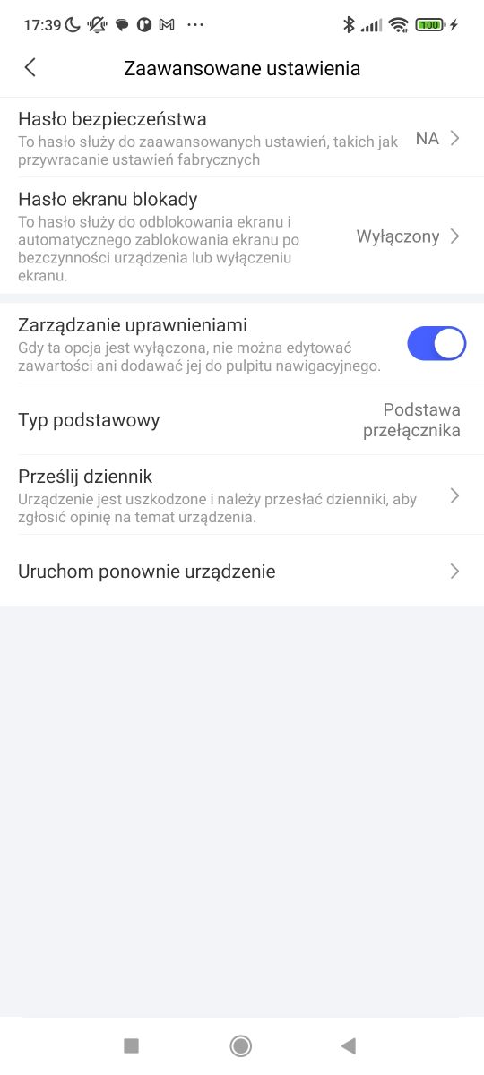

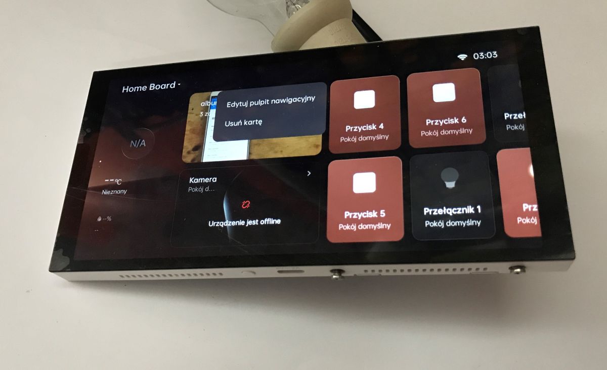

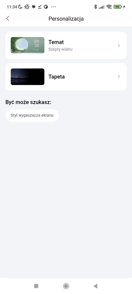

    One of the first things that strikes the eye is the high configurability of the device panel. There are selectable skins, editable tiles and even an option to upload your own photos. There are also wallpapers and screen savers.

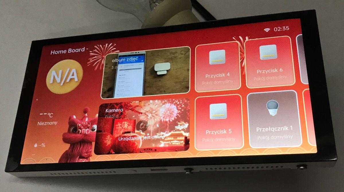

    Let's perhaps start with skins , all of which are free:
    Aqara panel personalization screen with theme and wallpaper selection App screen showing Aqara S1 Plus theme library with eight theme options .
    Here are some photos of what they look like in practice:
    Aqara S1 Plus panel on red screen with control buttons and camera preview Aqara S1 Plus panel screen showing time and a wallpaper with child and teddy bear Aqara S1 Plus panel showing home screen with control widgets and camera preview .

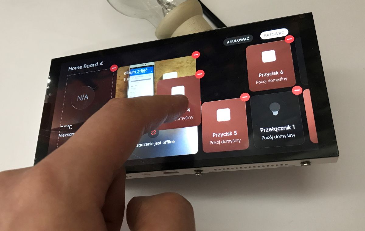

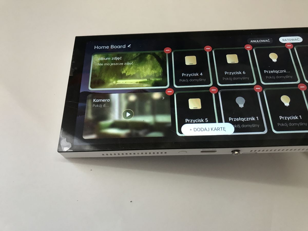

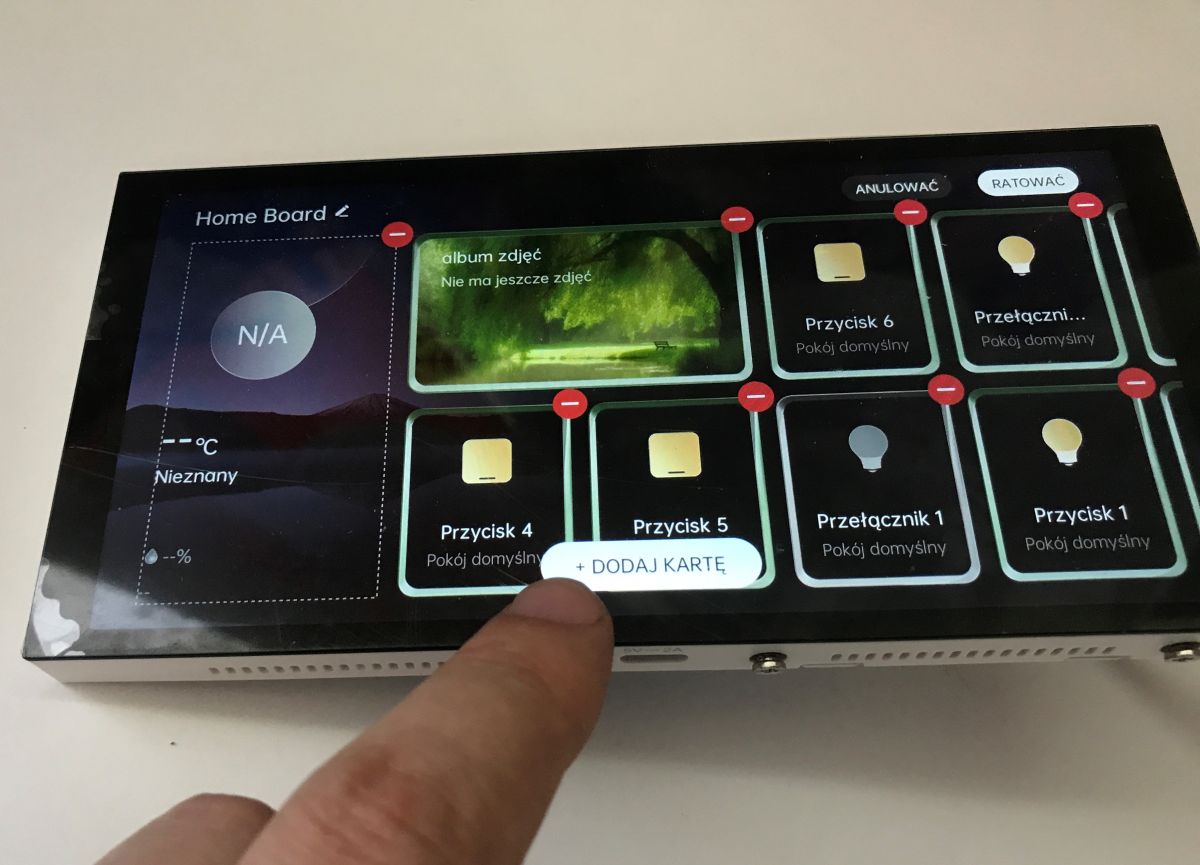

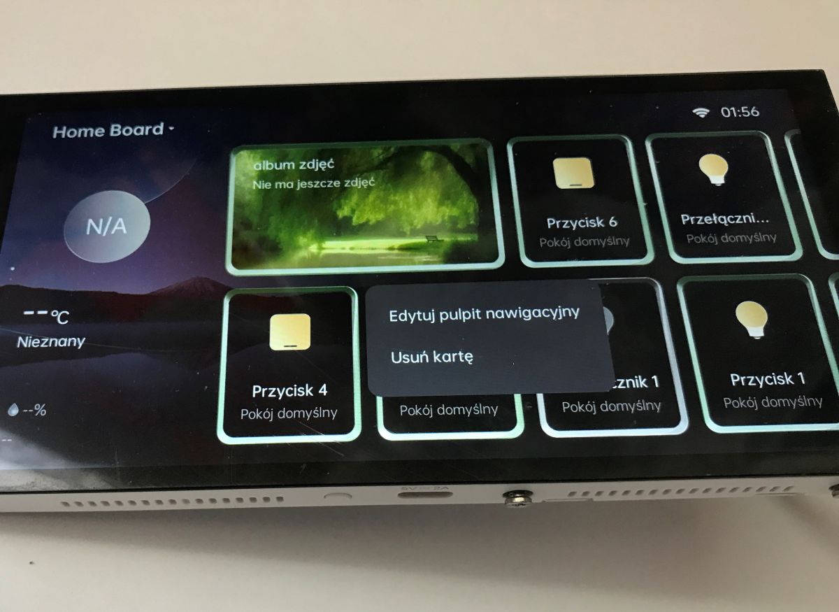

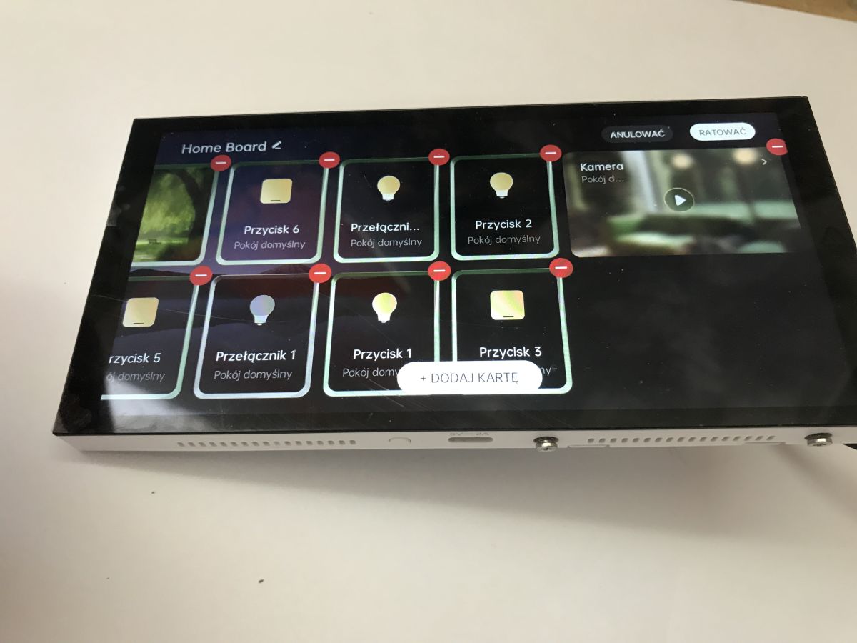

    The caps themselves can be easily moved, added and removed. Press one of the tiles longer and select "Edit dashboard":
    Aqara S1 Plus panel with touchscreen showing control tiles and offline camera status Aqara S1 Plus panel in card editing mode with buttons and camera widget Finger dragging a tile on the Aqara Panel Hub S1 Plus touchscreen .

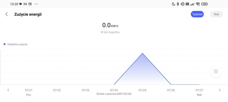

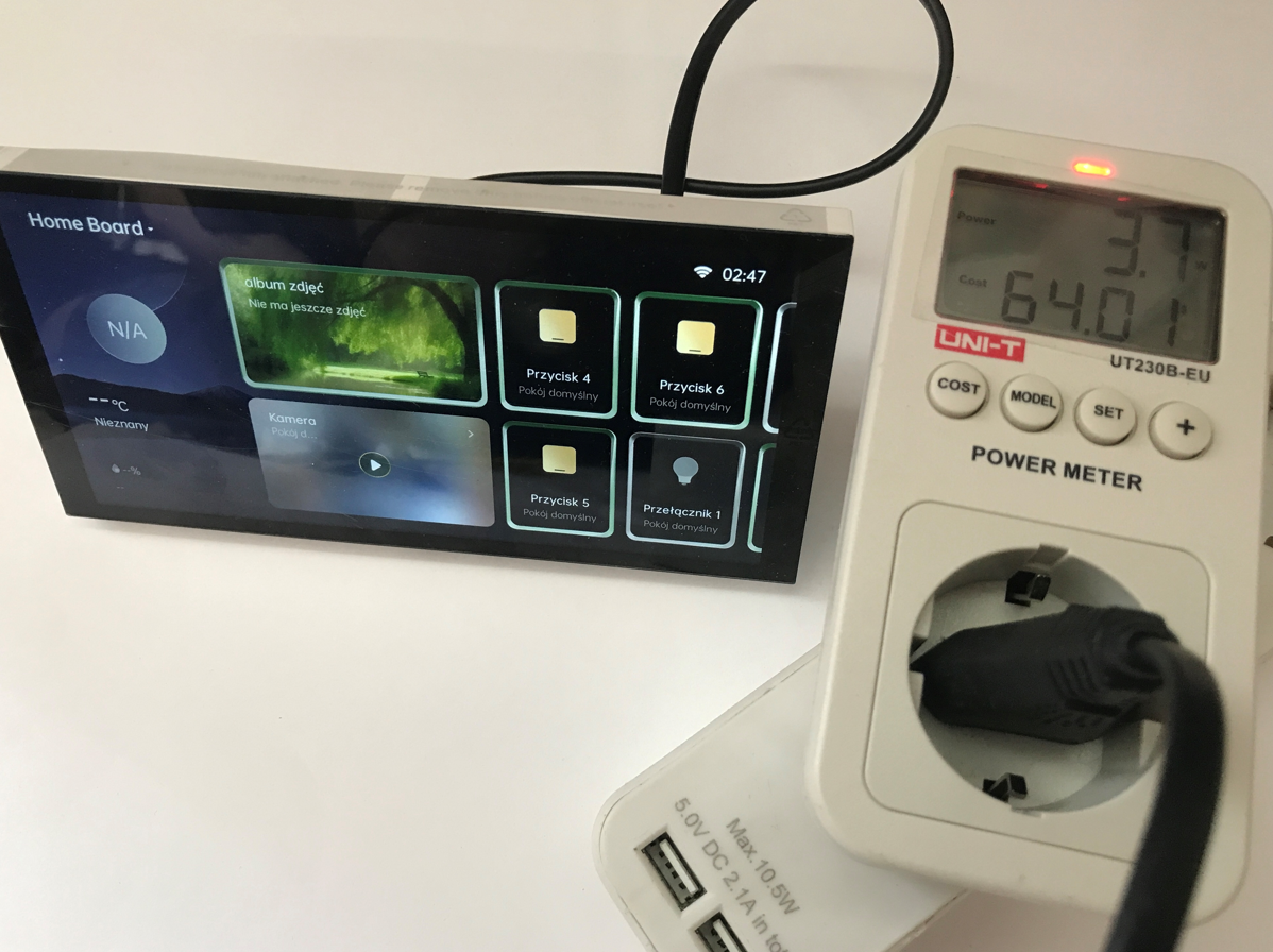

    Built-in relays - power measurement .

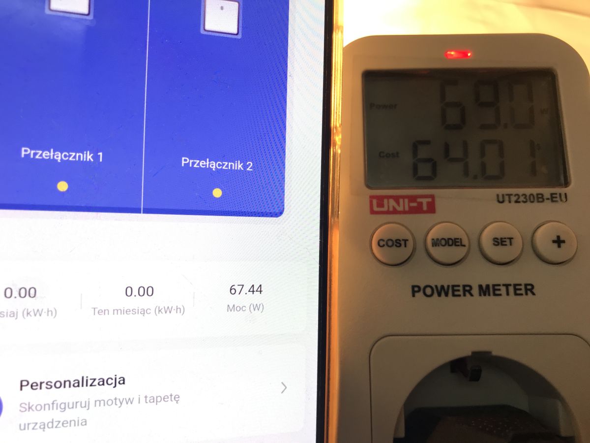

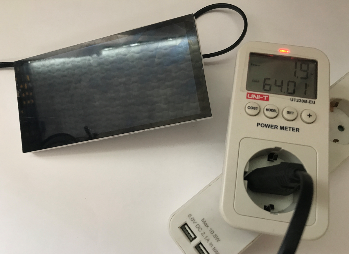

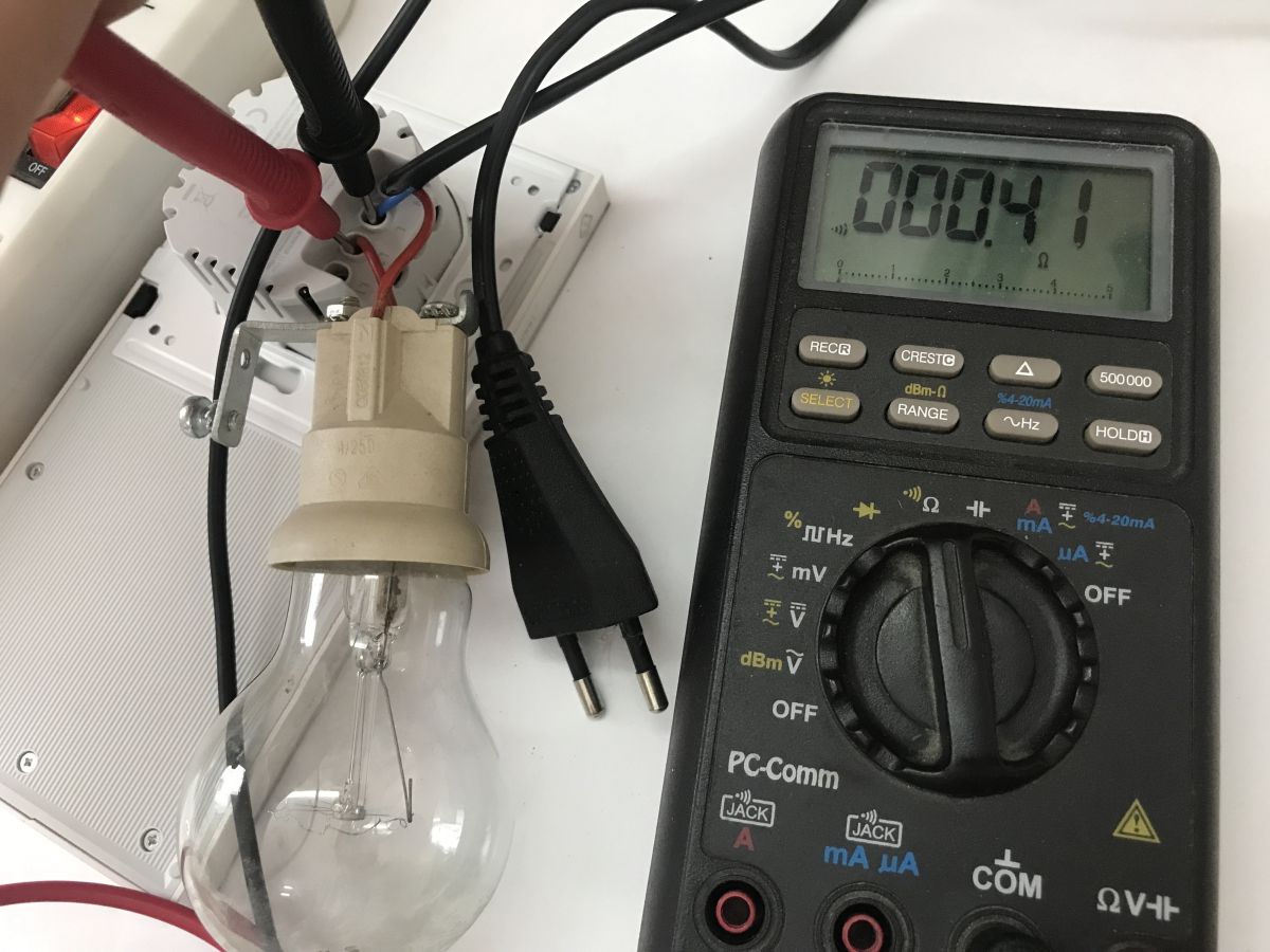

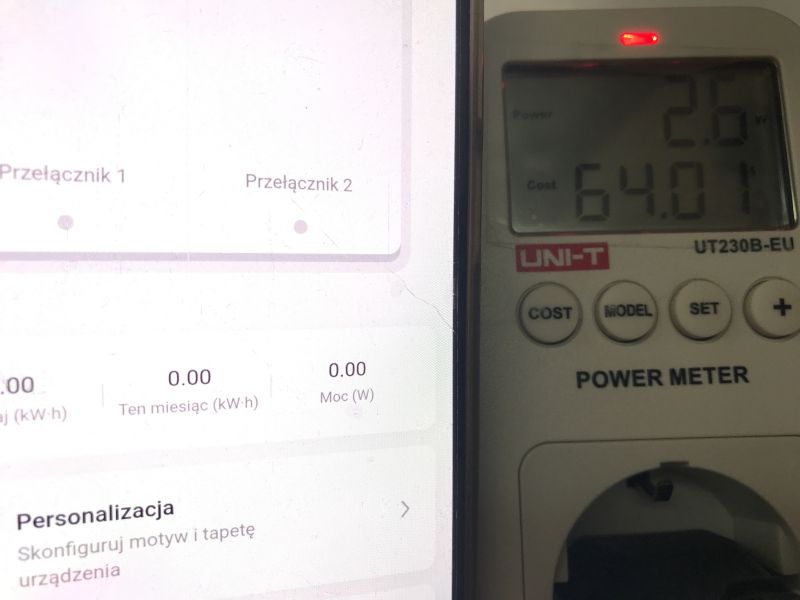

    The device is also capable of measuring load power. The measurements are placed on intuitive graphs, giving us an insight into the energy consumption history.

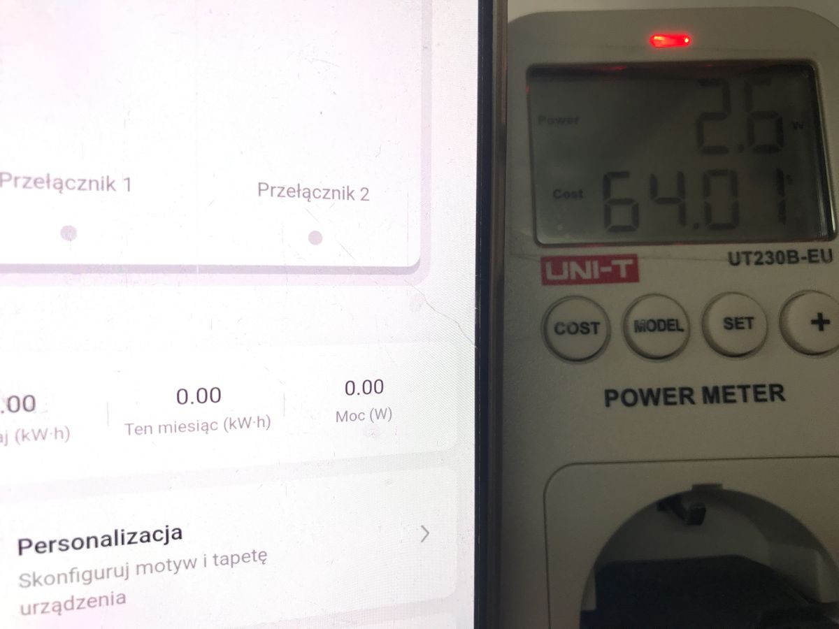

    Let us verify the accuracy of the measurement.
    Power consumption of the light bulb - according to the device - 67.44W, power consumption of the whole (including the device) - 69W:
    Power reading: Aqara S1 panel shows 67.44 W, power meter reads 69.0 W .
    With the relay off, my meter shows 2.6W. You can now count: 69W - 2.6W = 67.4W, practically perfect.
    Aqara S1 Plus panel next to a power meter displaying 2.6W consumption .

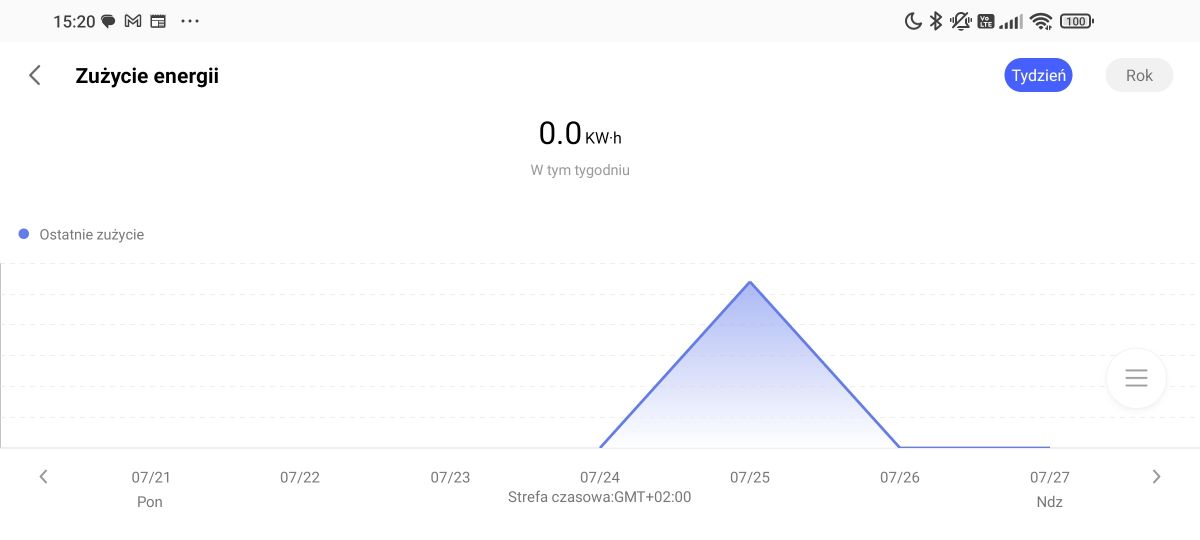

    The charts also have a convenient option to rotate the screen by 90 degrees.
    Energy consumption chart in the Aqara app showing one week's data

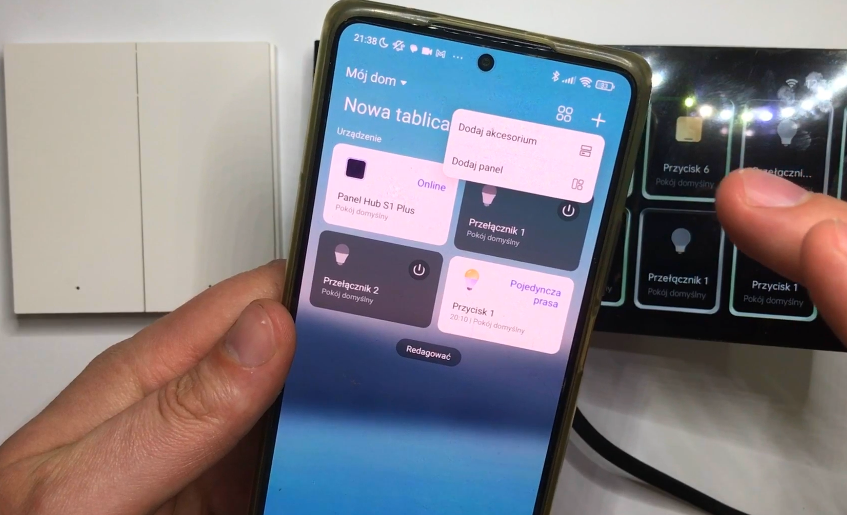

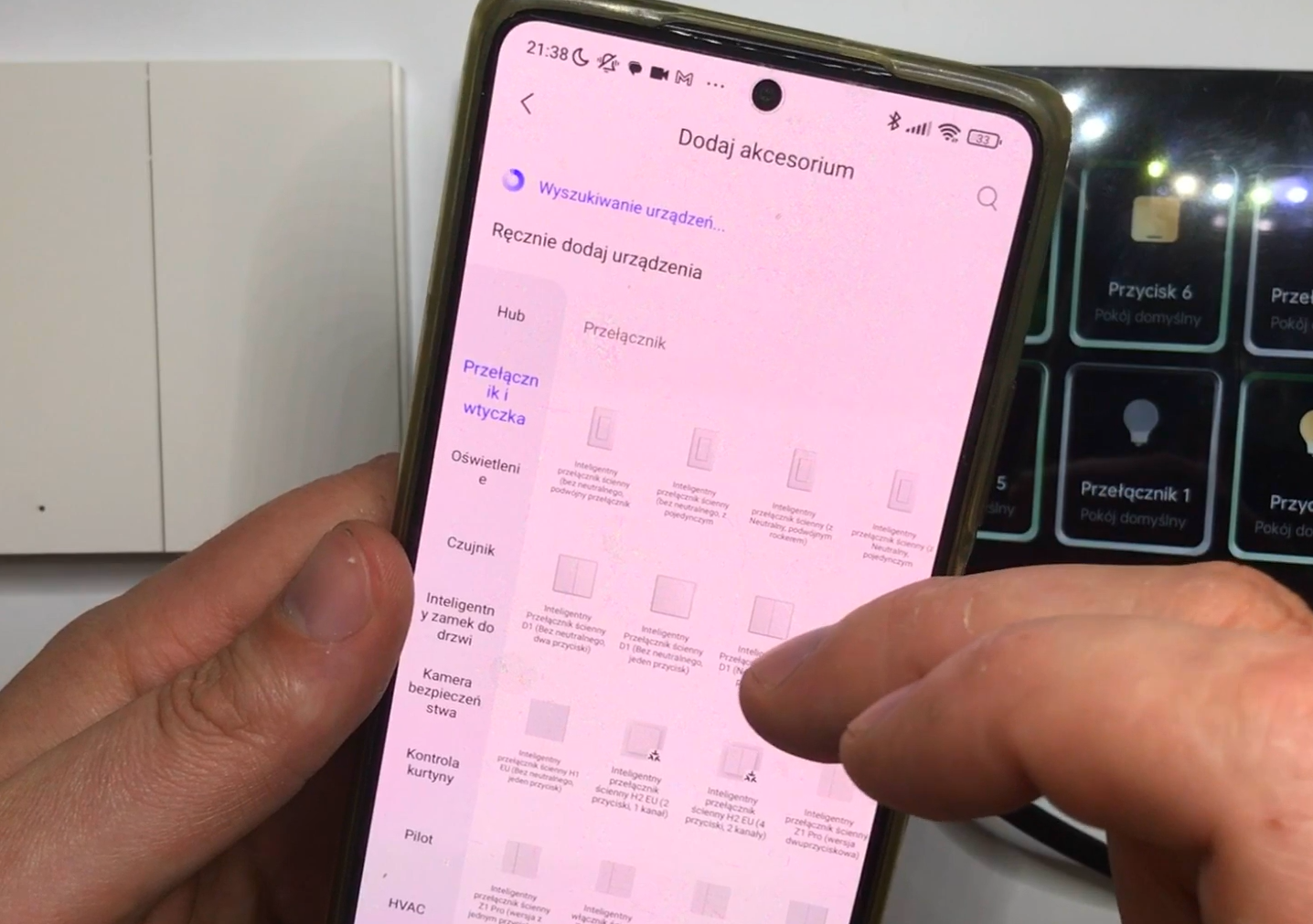

    S1 Plus as Zigbee Hub - add your own devices .

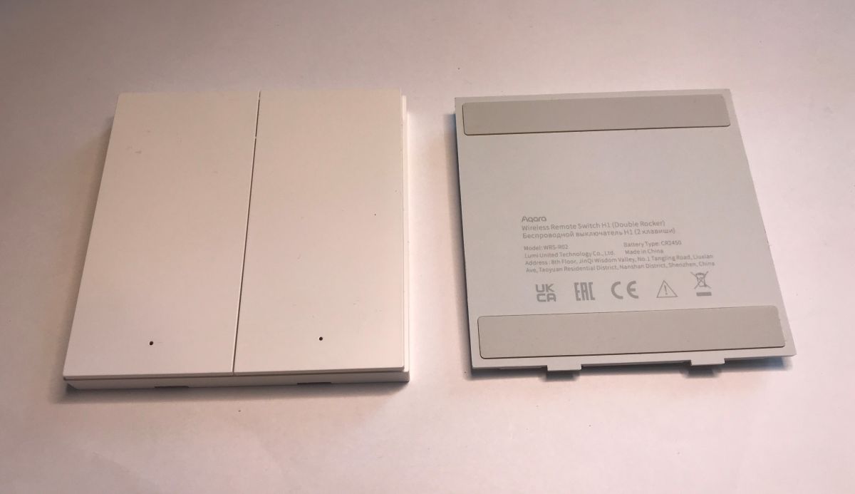

    The panel shown also acts as a Zigbee coordinator, so more devices can be connected to it. As an example, I have connected this battery-powered device/scene controller:
    Aqara H1 wireless switch front and back view, model WRS-R02 with double rocker .

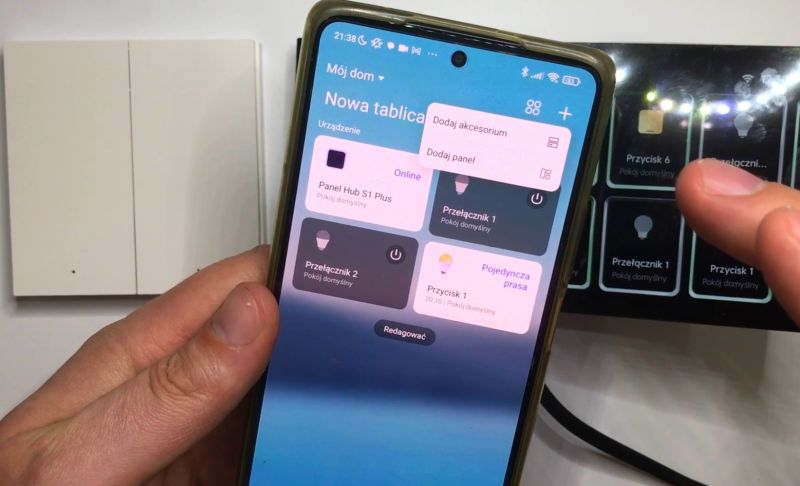

    Pairing starts with a tap in the top right corner, from the menu select "Add accessory":
    Aqara Home app screen showing devices and Add accessory menu on smartphone. .

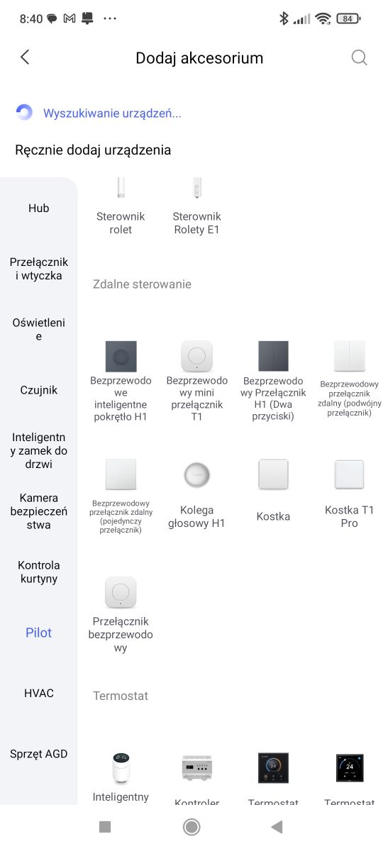

    We select our device type from the list:
    Smartphone with Aqara app open, showing device pairing screen with categories and icons..
    Here we normally have a stage for selecting a control panel, but in the case of one the app goes on by itself:
    Smartphone connects to Aqara MagicPad S1 Plus via mobile app .
    We reset the device according to the instructions:
    Phone displaying instructions for pairing Aqara smart wall switch .

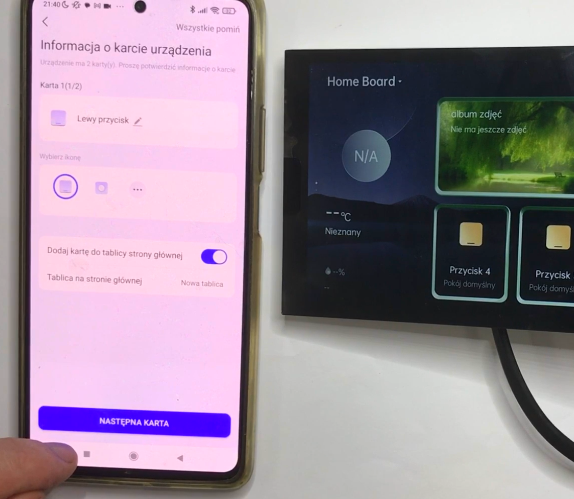

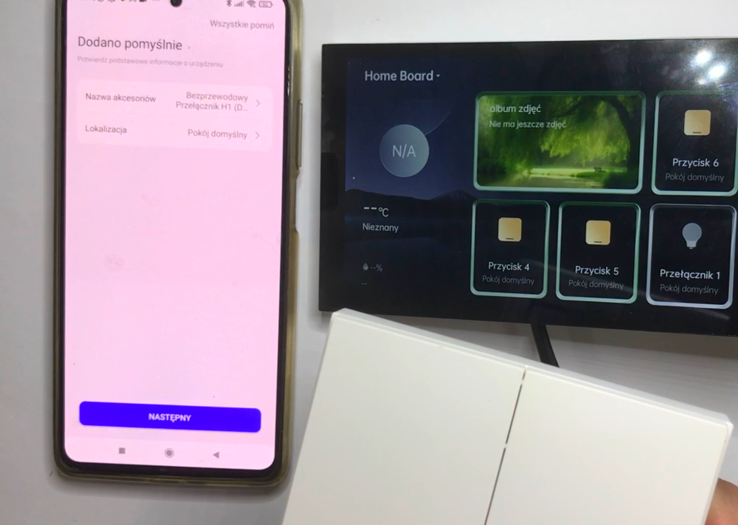

    You can immediately configure the device cards, this switch has two buttons, so there are two cards:
    Smartphone and Aqara S1 Plus panel during Zigbee device setup .
    Paired:
    Smartphone with Aqara app, S1 Plus panel and dual Zigbee button switch .

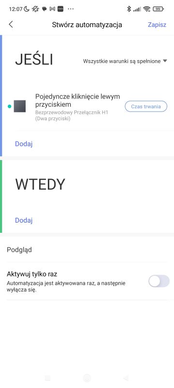

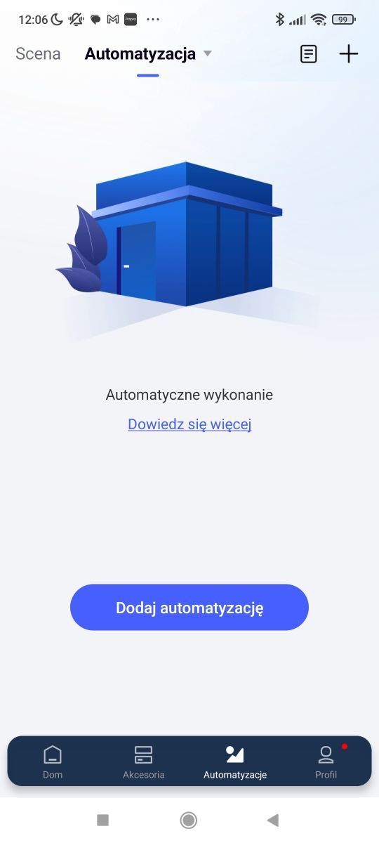

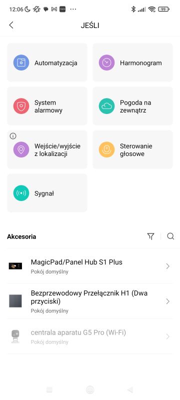

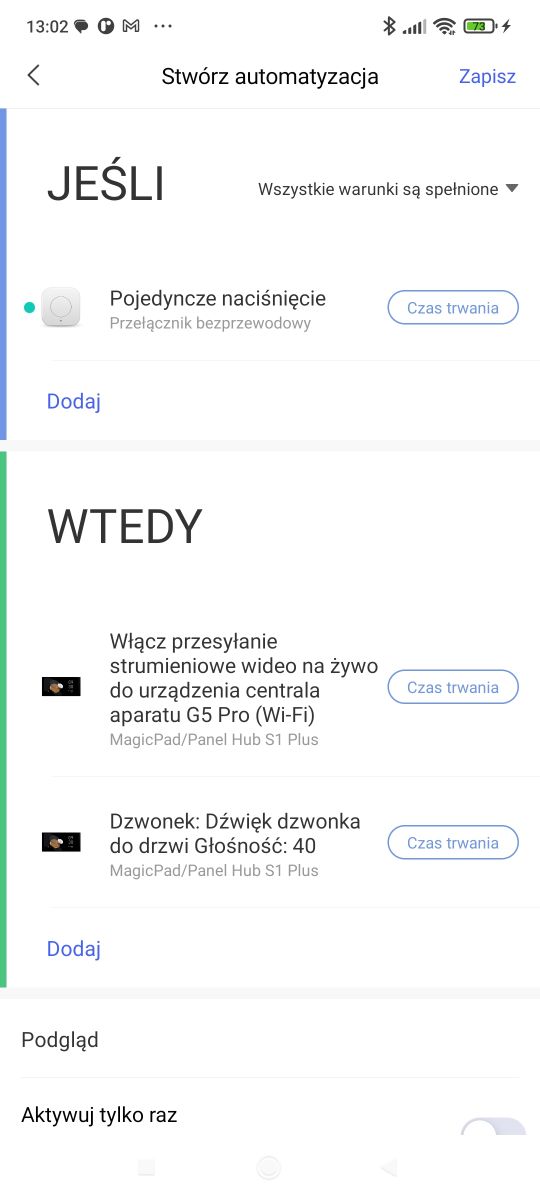

    Let's try to create an example automation. Here we will combine the previously paired scene button on Zigbee with a relay from inside the Hub S1 Plus. This is quite a practical idea, because who wouldn't want to have two switches from the same light? Such a thing is useful not only on the stairs, but also for a large room, a bedroom or there living room.

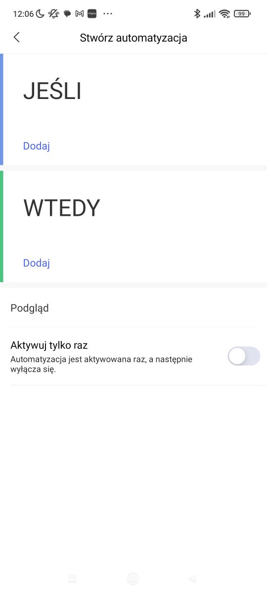

    We start by going into Automation:
    Aqara Home app screen showing the automation creation option .

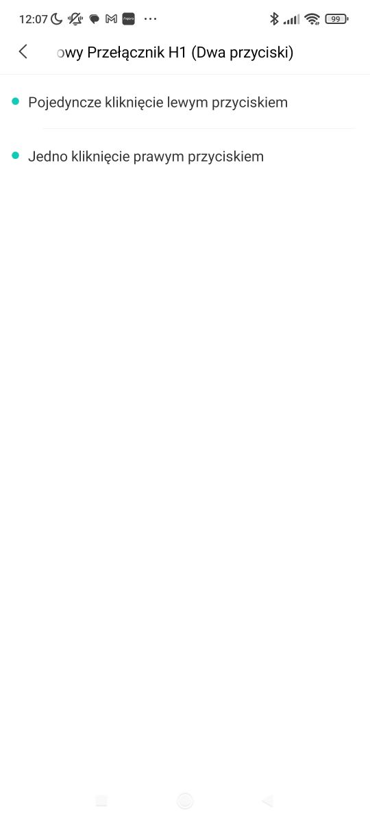

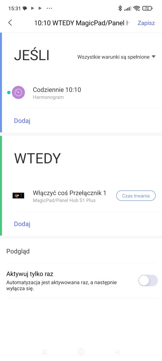

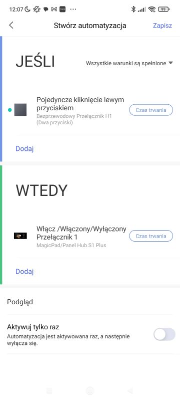

    The automation scheme is very simple - we fill in the trigger (IF) and the effect (THEN).
    App screen for creating automation with IF and THEN sections .

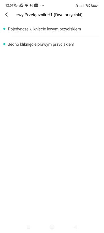

    In IF we select our wireless button, or more precisely its single left click.
    Aqara Home app screen showing automation options and paired devices Switch H1 button click options shown in Aqara Home app menu Automation creation screen in Aqara Home app with trigger condition selected .

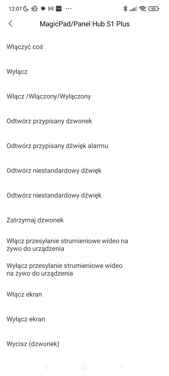

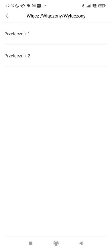

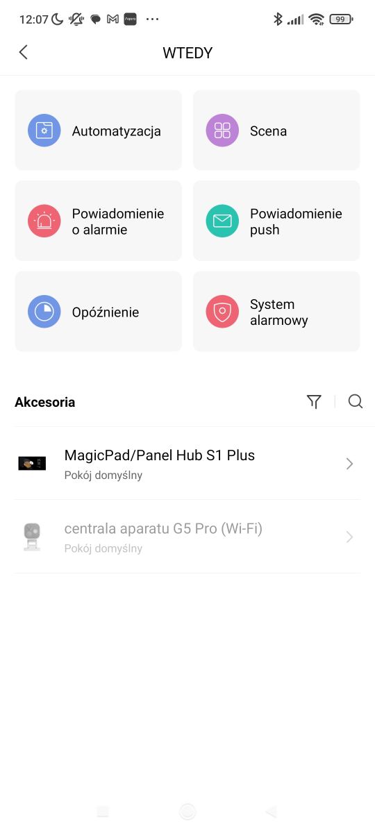

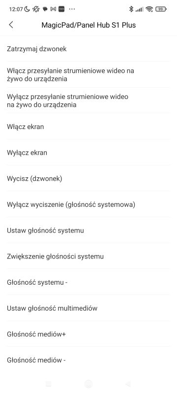

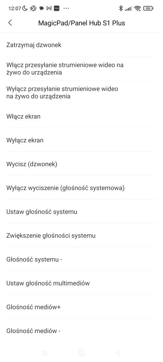

    We now fill in the effect - "THEN" field. We select the Hub and can use to admire the wide range of possibilities of this device:
    Aqara app screen showing automation options and device selection List of automation actions for Aqara Panel Hub S1 Plus in mobile app interface List of control options for Aqara Panel Hub S1 Plus in the mobile app .
    As an effect, I chose to flip the relay state to the opposite. This is most convenient for turning the light on and off.
    Aqara app screen showing two switches: Switch 1 and Switch 2 Aqara automation screen showing button linked to switch action .

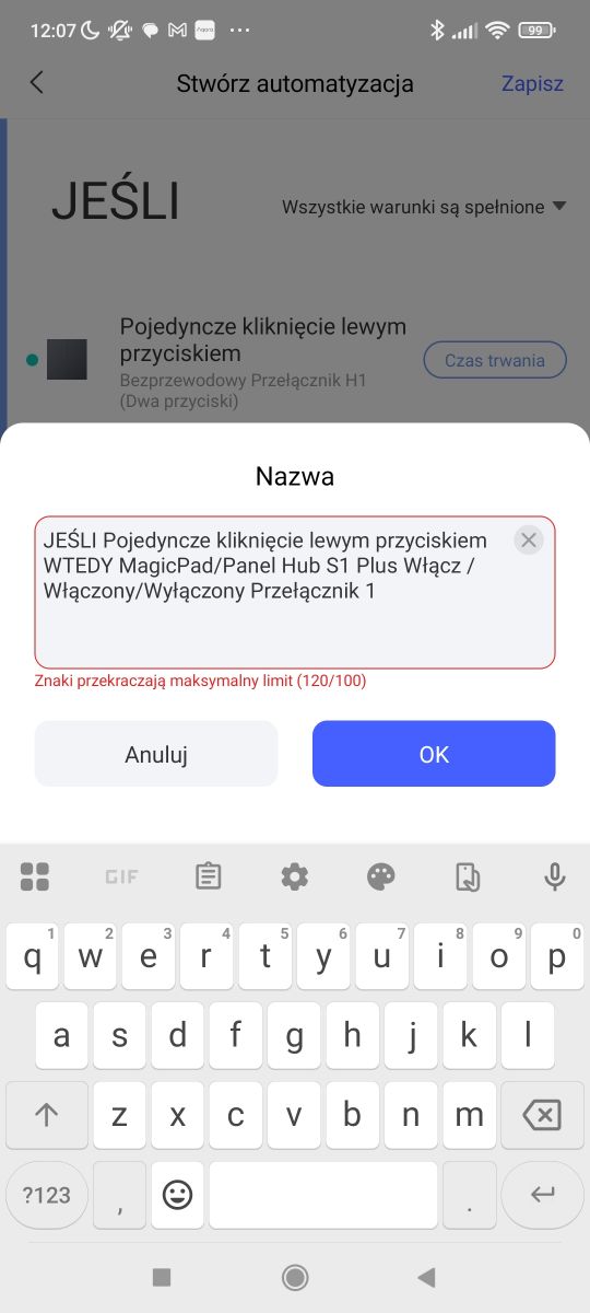

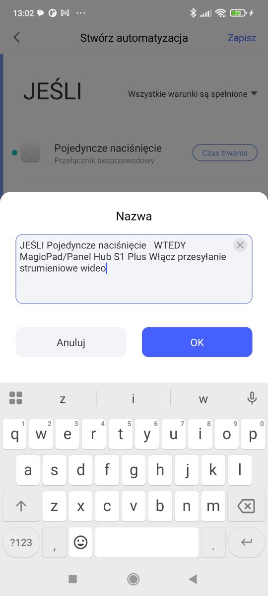

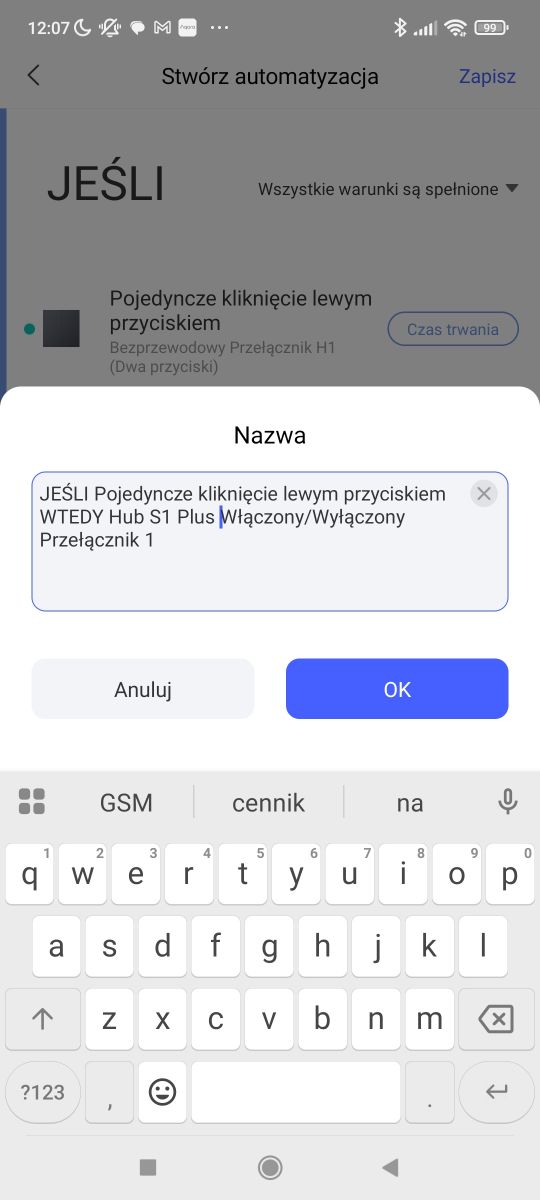

    Finally, we still need to name the automation - the programme suggested a name, but it was too long:
    App screen for renaming automation, character limit exceeded warning shown Automation naming screen in Aqara app with editable input field .
    Everything works and the response is almost instantaneous:

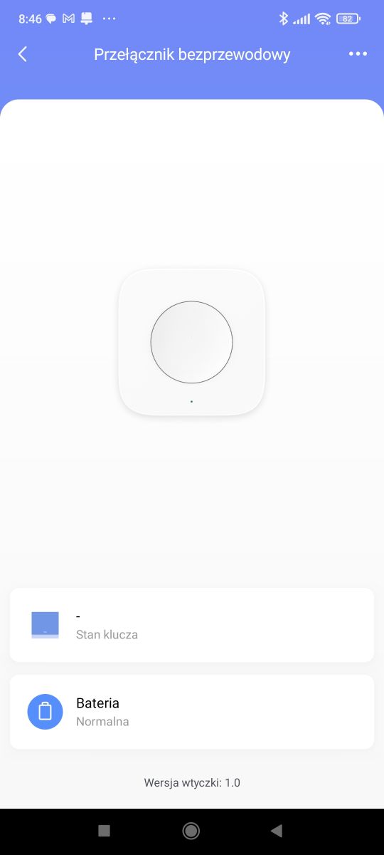

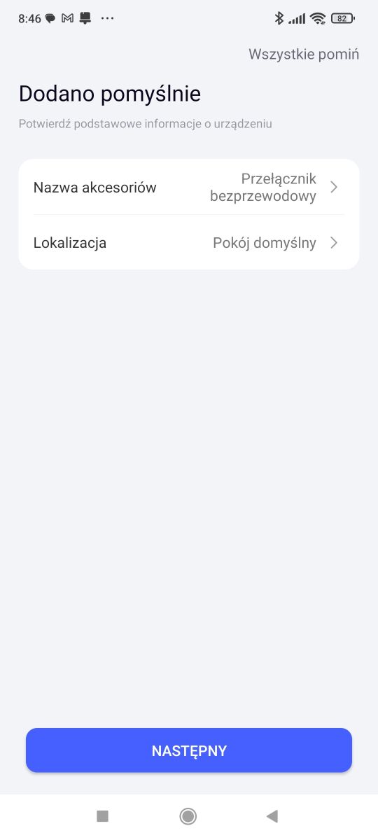

    Another button for an example - WXKG11LM .
    It is worth remembering that the hub shown here works with a wide range of devices. For my next attempt, I used the Aqara WXKG11LM on Zigbee already presented.
    Pairing went off without a hitch. Interestingly, I also had the choice of just adding the camera as a hub:
    List of devices to add in the Aqara Home app with categories on the left side App screen showing list of hubs: G5 Pro (Wi-Fi) and Panel Hub S1 Plus App screen showing reset instructions for Aqara T1 mini switch .

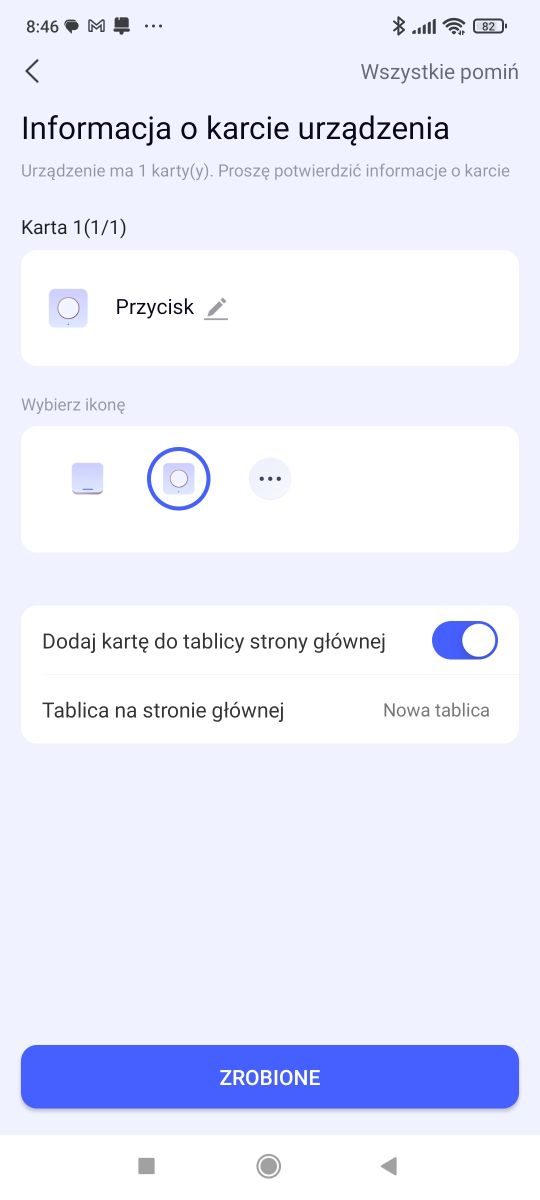

    Once paired, again the room or icon and device name can be changed.
    App screen confirming successful addition of a wireless switch Device card setup screen with button in Aqara app on smartphone Screenshot of Aqara panel showing info for a wireless switch .

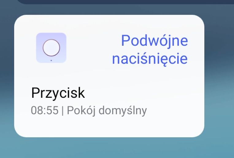

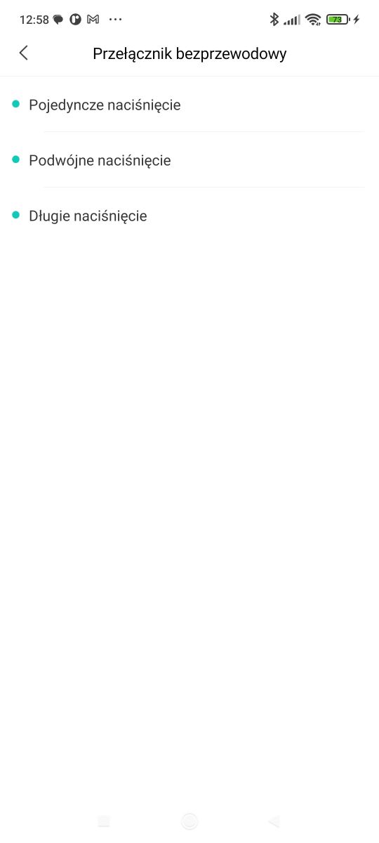

    The device correctly detects events such as single and double clicks.
    Notification of double press from button in default room .
    On top of this, there is also an option to detect button presses - full list of triggers below:
    Screenshot showing three action modes for a wireless switch button .

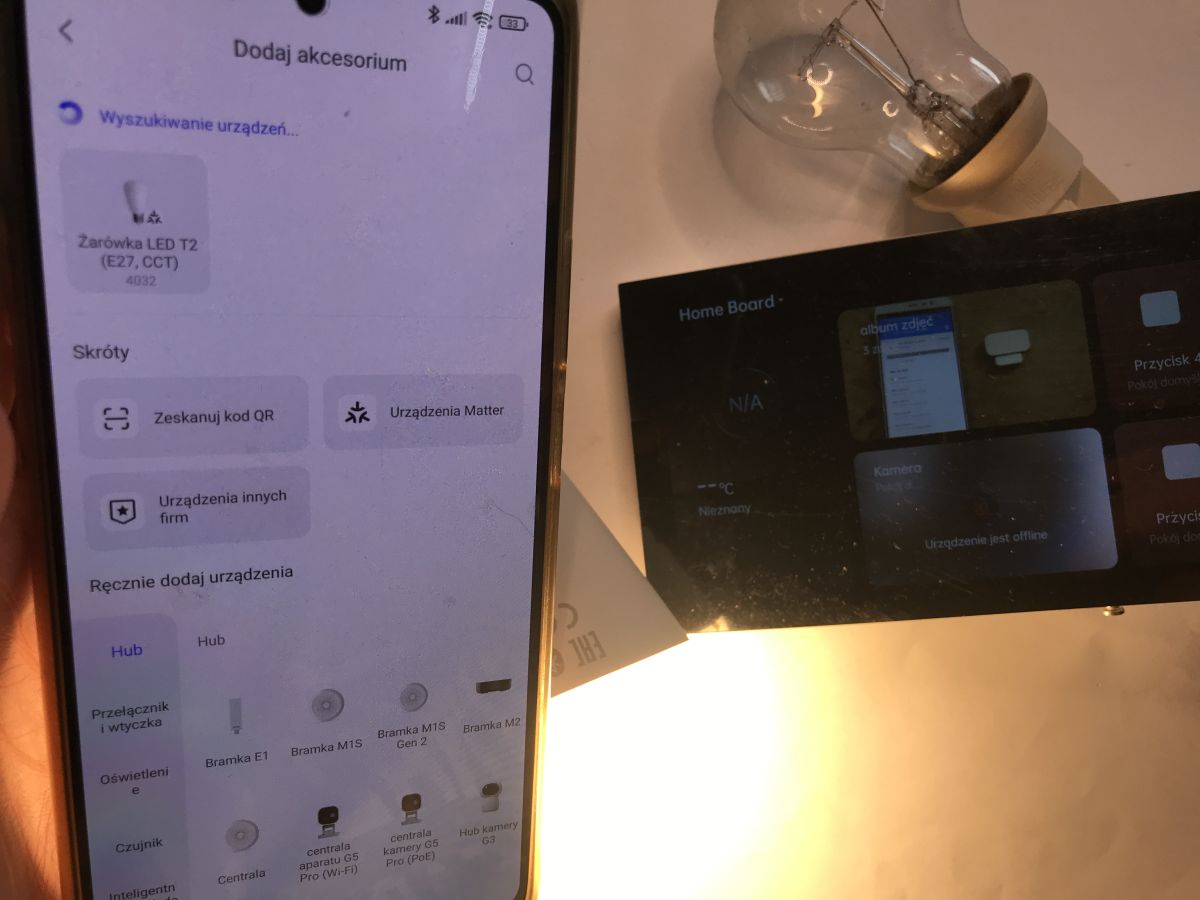

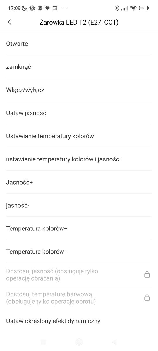

    The Aqara LED light can be connected in a similar way. A single device can be paired and displayed on the screen:
    Smartphone with Aqara app and Aqara S1 Plus panel in background .
    In this way, its status can be monitored:

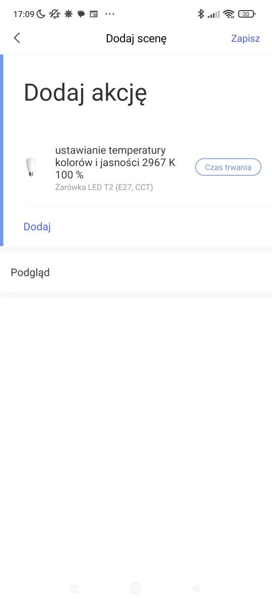

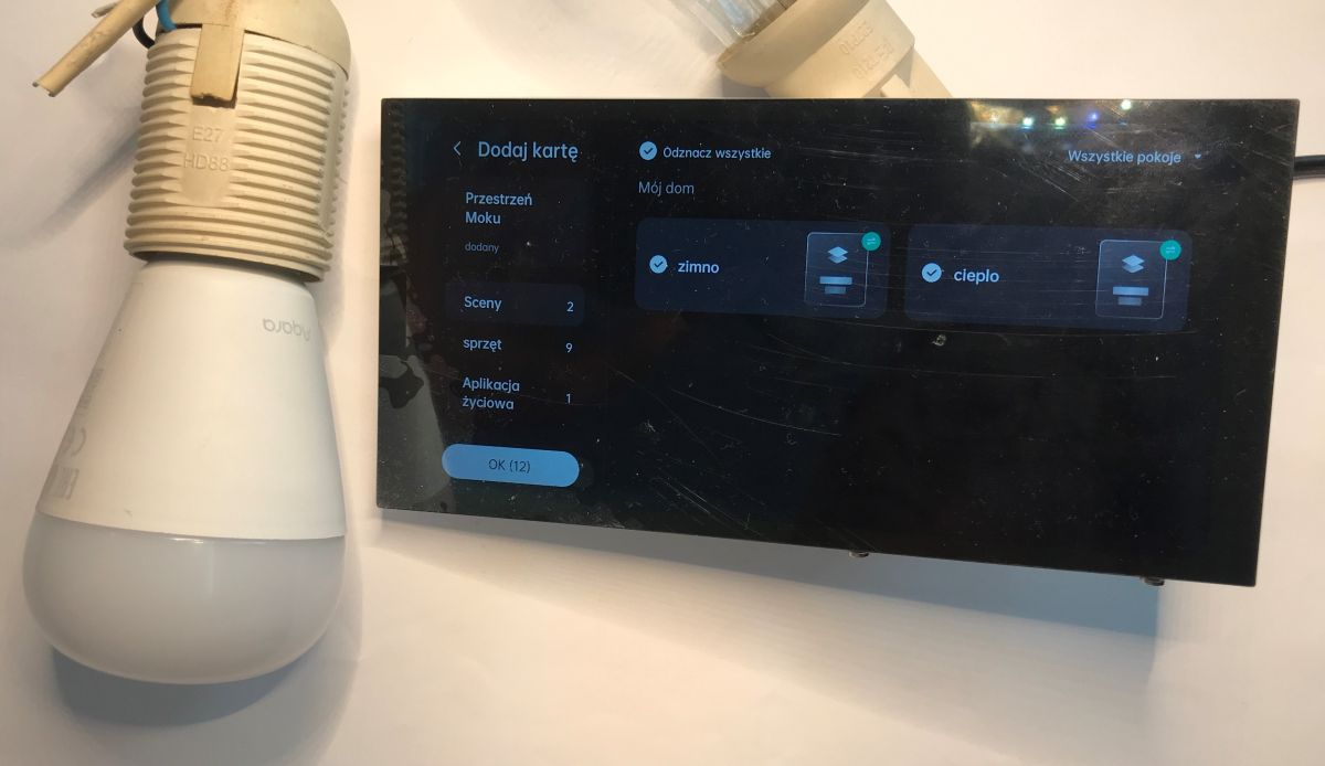

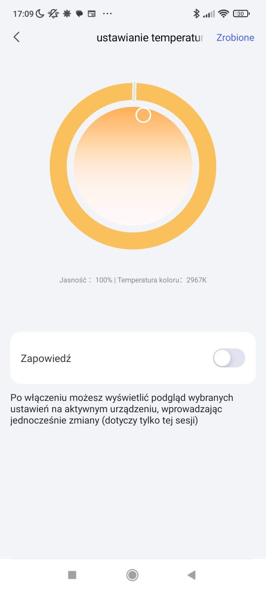

    However, controlling a single light source is not a very practical idea. It is better to control them in groups. In addition, it is also useful for us to be able to choose the white temperature. Warm white is generally intended for relaxation, for the bedroom, and cold white for work.
    For this reason, I have prepared two scenes setting the two white temperatures respectively:
    Control options for LED T2 (E27, CCT) bulb in Aqara Home app interface Color temperature adjustment screen in the Aqara Home mobile app App screen showing scene setup: 2967 K color temp, 100% brightness for LED T2 bulb .
    Such a scene can control multiple devices simultaneously. I have added both scenes to the screen:
    Aqara S1 Plus panel showing warm and cool light scenes, LED bulb on the side .

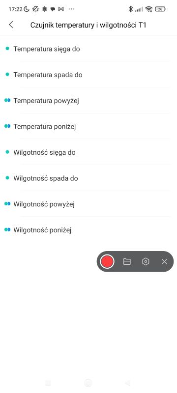

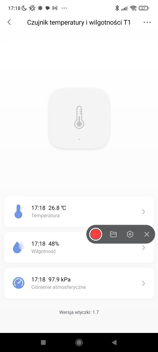

    Another device - temperature and humidity sensor .

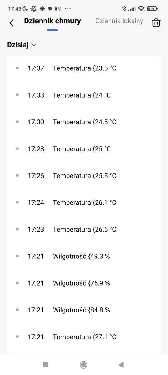

    Everything analogously as before. We pair the sensor via Zigbee. We immediately get measurements from it along with their history:
    App screenshot showing logged temperature and humidity sensor readings App screen showing temperature, humidity, and pressure readings from T1 sensor .

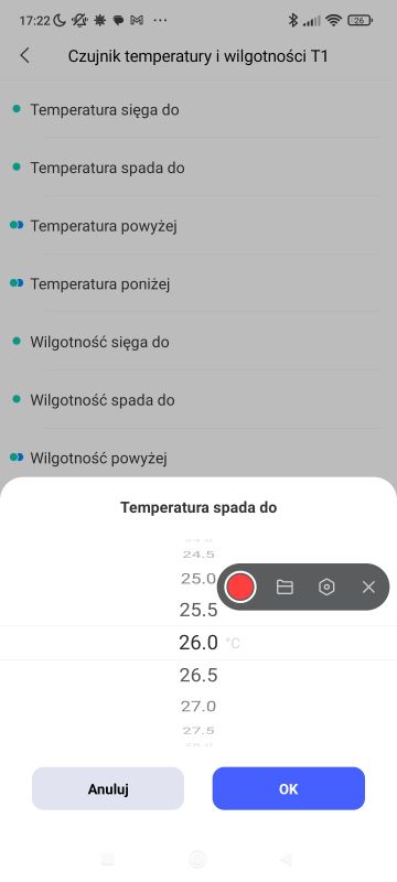

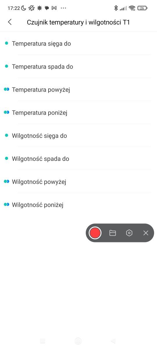

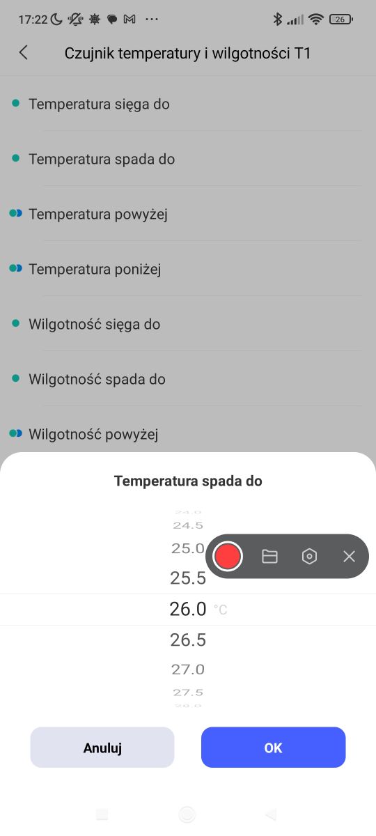

    Any measured quantity can trigger automation - heating, cooling, air conditioning can be controlled in this way....
    List of automation triggers for temperature and humidity sensor in Aqara app App screen setting temperature drop threshold for T1 sensor to 26.0°C .

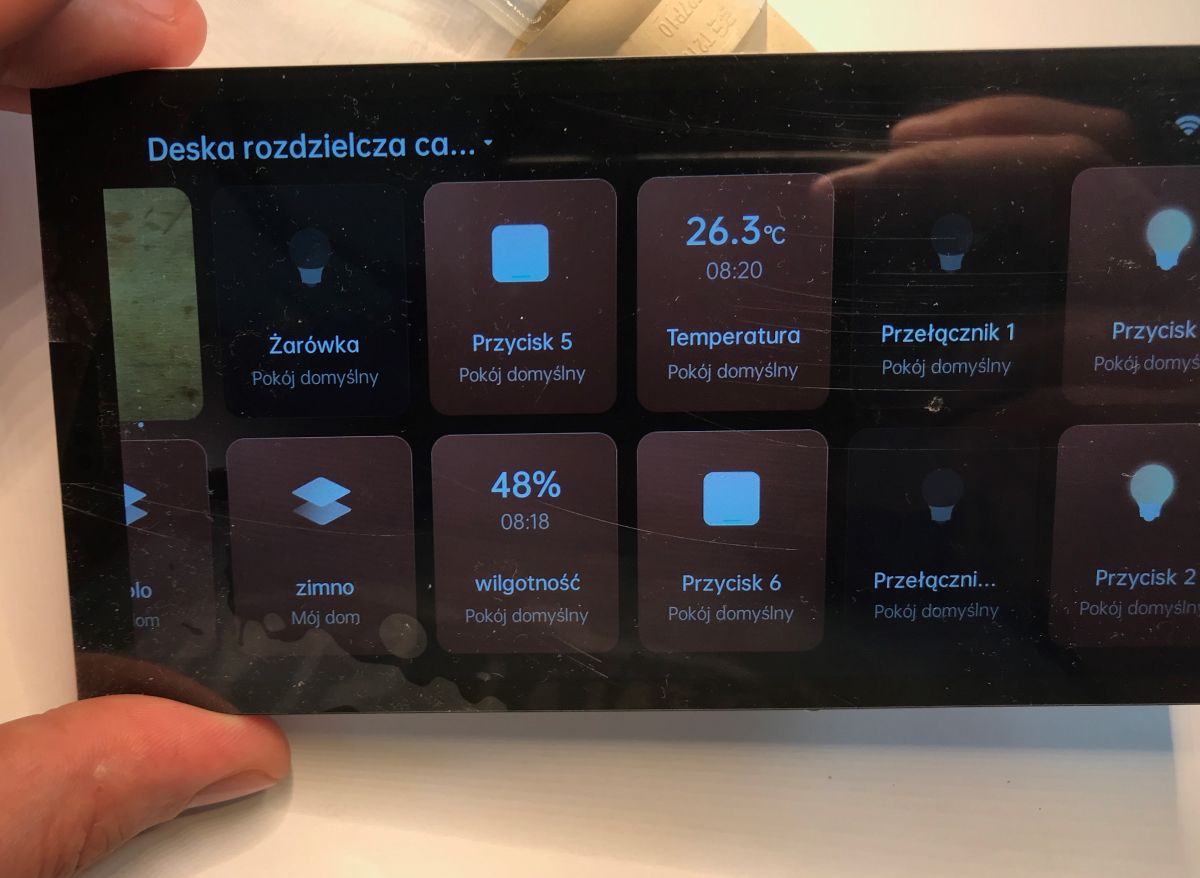

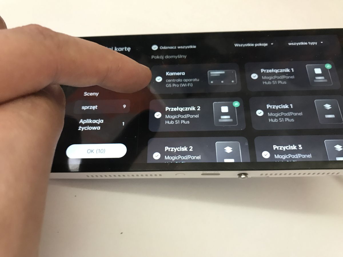

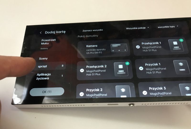

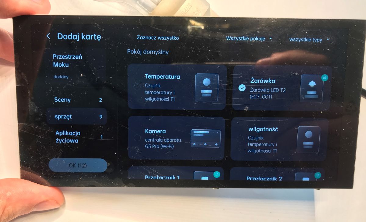

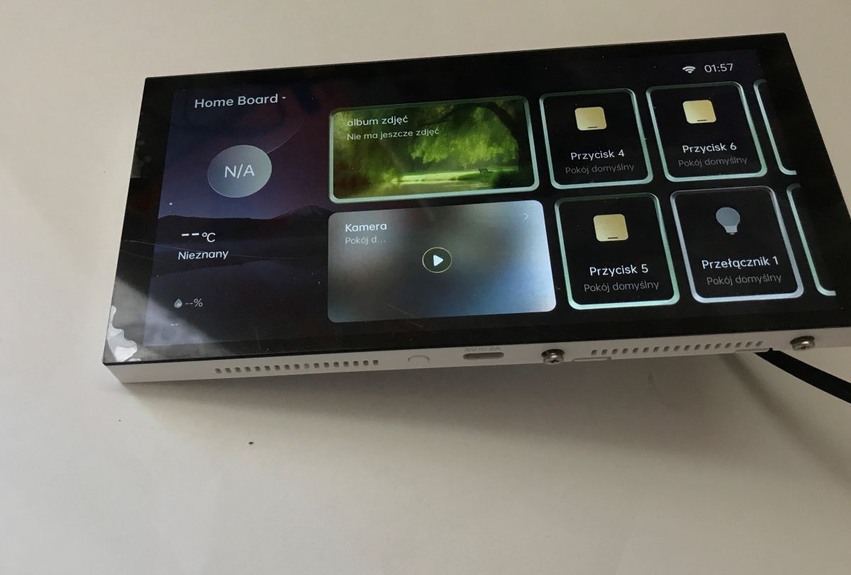

    The read values can be placed on the panel with the appropriate icon and name. In this way we can have a quick overview of the temperature in the various rooms as well as the one outside.
    Aqara S1 Plus touch panel showing smart home device selection interface .
    Aqara S1 Plus panel touchscreen showing widgets with sensor and switch data

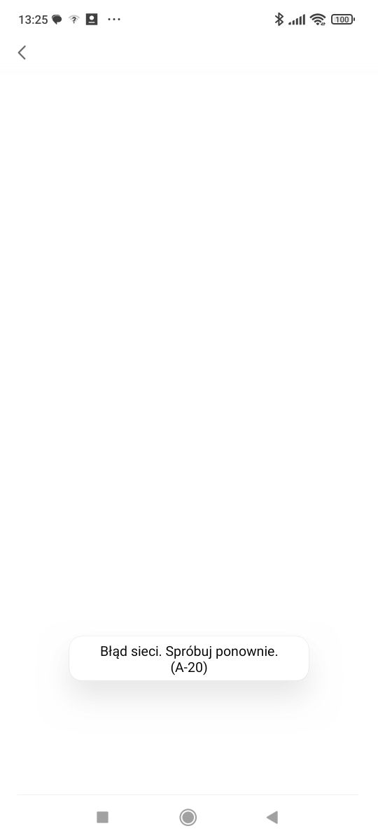

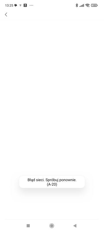

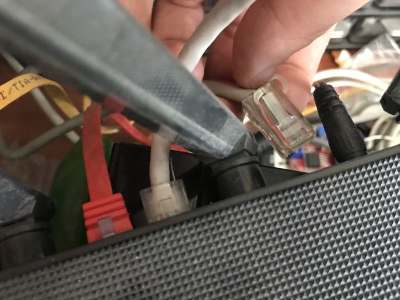

    Is the automation performed without the internet? .
    The automation from the previous paragraph performs so responsively that I began to wonder, what happens if I remove the Ethernet cable from the router's WAN port? The router will continue to work, WiFi will still be on, but there will be no access to the cloud.
    Close-up of hand unplugging Ethernet cable from a black router .
    Control from the app does not work, but there is still a connection from the switch on Zigbee.
    Network error message in mobile app with error code A-20

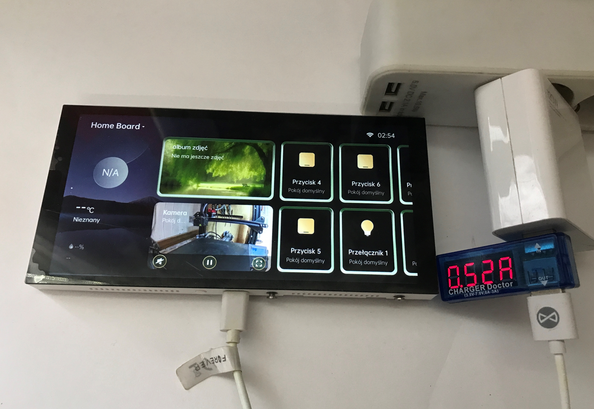

    Is the automation done without WiFi? .

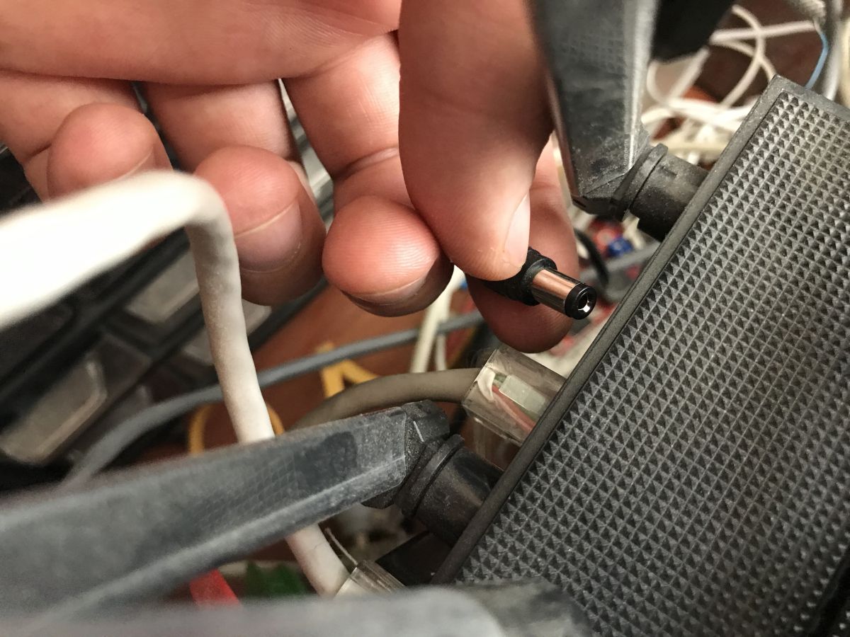

    This time I completely unplugged the router from the power supply:
    Hand disconnecting a power plug from a network device. .
    Zigbee-level control still works, i.e. the automations are remembered by the Hub itself and do not require access to the cloud to execute.

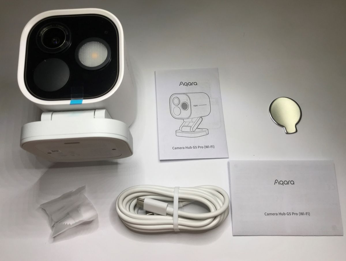

    Aqara camera view - DIY video intercom part 1 .
    The panel can also work with Aqara cameras, for example the G5 Pro WiFi . As the name suggests, such a camera communicates via WiFi rather than Zigbee, but this is no problem.
    Aqara G5 Pro Wi-Fi camera box showing smart home platform compatibility icons .
    We launch and pair the camera with our Aqara Home account as per the instructions. The Hub S1 Plus panel is not needed at this stage.
    Aqara Camera Hub G5 Pro kit with camera, manuals, and accessories on white background .
    Now it is time to add a camera to our panel. We click any tile longer and enter Desktop Edit:
    Aqara S1 Plus panel screen with visible tiles and navigation edit menu .
    Here you can rearrange the tabs, but this is not our purpose. We select Add Card:
    Aqara touch panel displaying control tiles and a Add Card button being pressed .
    From this point, we have access to all the equipment from our account. The camera that I have already paired with the app before is also visible there.
    Index finger selecting “Scenes” option on Aqara Panel Hub S1 Plus touchscreen display. .
    All you have to do is attach it - check the box:
    Finger touching Aqara S1 Plus panel screen showing device selection list. .
    After exiting and accepting, the camera will be the last tile on our panel. You can now press and move this tile so that it comes first.
    Aqara S1 Plus panel in edit mode, showing tiles for buttons and a camera .
    Finally, we save with the button in the top right corner.
    Aqara S1 Plus panel showing touchscreen with customizable control cards .

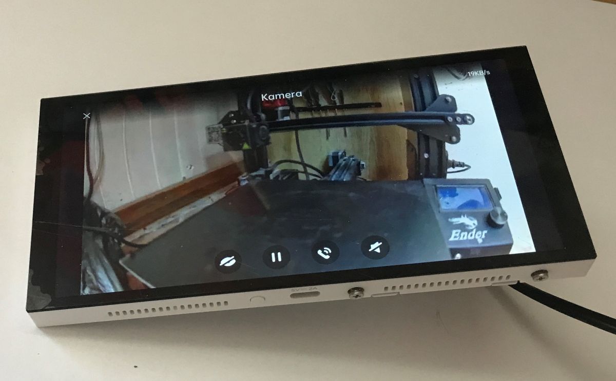

    From now on we have a live view of the camera. The full screen can also be switched on.
    Aqara S1 Plus smart panel showing home screen with various control tiles. Aqara S1 Plus touchscreen interface with control tiles and camera preview Aqara S1 Plus panel showing camera feed with Ender 3D printer .
    In full screen mode, additional options are available, such as enabling/disabling camera audio or a talk mode, allowing two-way communication.

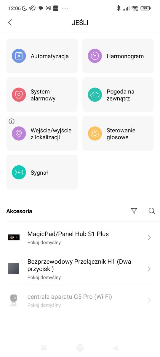

    We already have a button, a camera and a hub with a screen - can you make an intercom out of this?
    Of course it can!

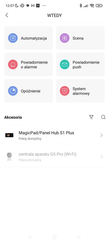

    We'll now do the automation as I showed earlier, except that we'll assign it two effect actions:
    - playing a melody
    - switching on the video stream from the camera to the hub panel
    As below:
    Aqara app automation screen showing trigger and two configured actions Automation naming screen in Aqara Home app on a smartphone .
    Time for a short test:

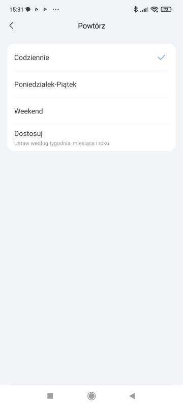

    Triggering automation according to a schedule .

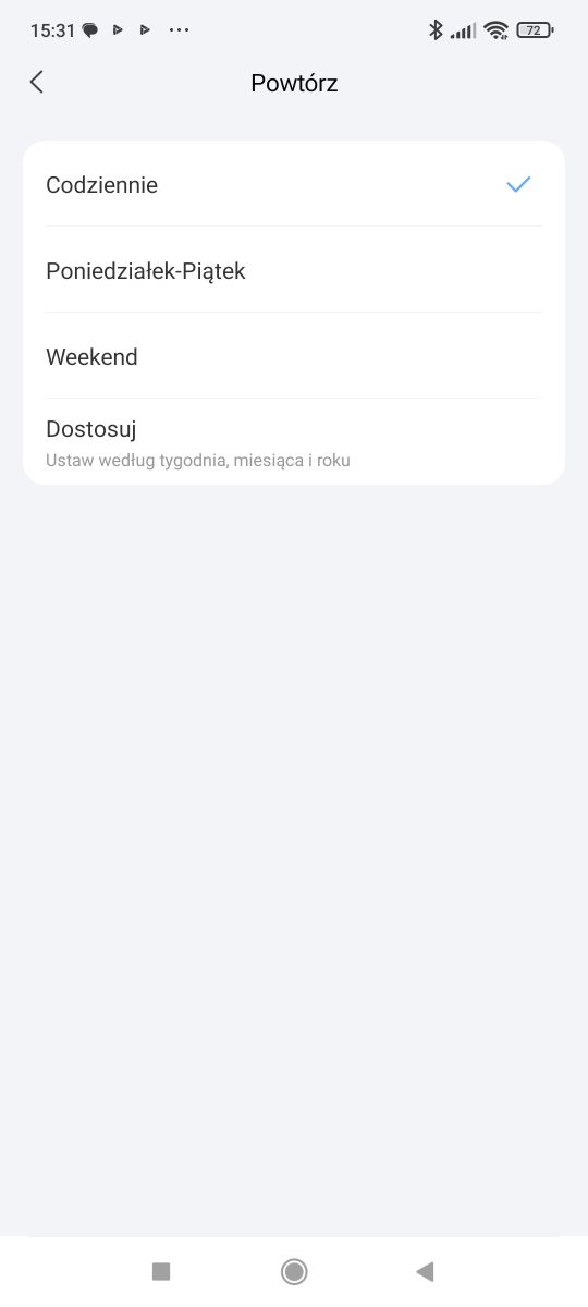

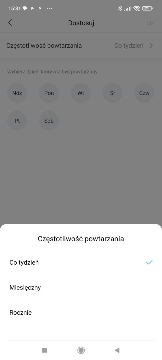

    The scheduler allows you to trigger any action at a selected time. The time can be set in hourly and minutely increments, in addition, we can select on which days of the week the action is repeated. In addition, there is also a monthly and annual repeat option.
    App screen showing a daily automation trigger for Aqara Panel Hub S1 Plus Schedule repeat screen with options: daily, Monday–Friday, weekend, custom App screen showing schedule repeat frequency settings options .
    For example, this could be used to automatically switch on the lights in the evening or switch them off in the morning.

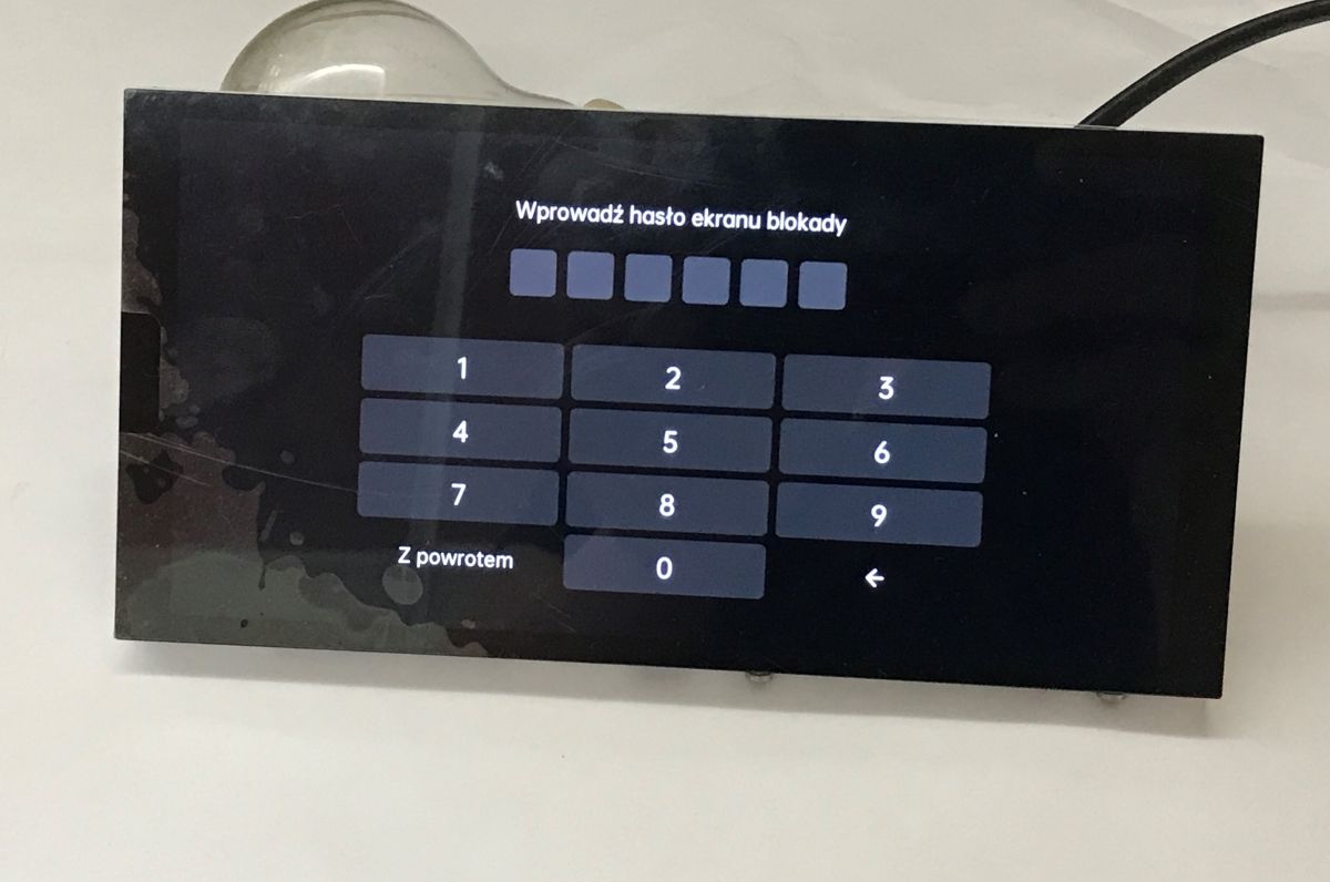

    Screen lock password .
    The S1 Plus system offers various slightly more advanced but still useful functionalities. One of these might be the ability to set a screen lock password. In this way, our device can even become a kind of intercom in the stairwell or the vestibule of a flat.

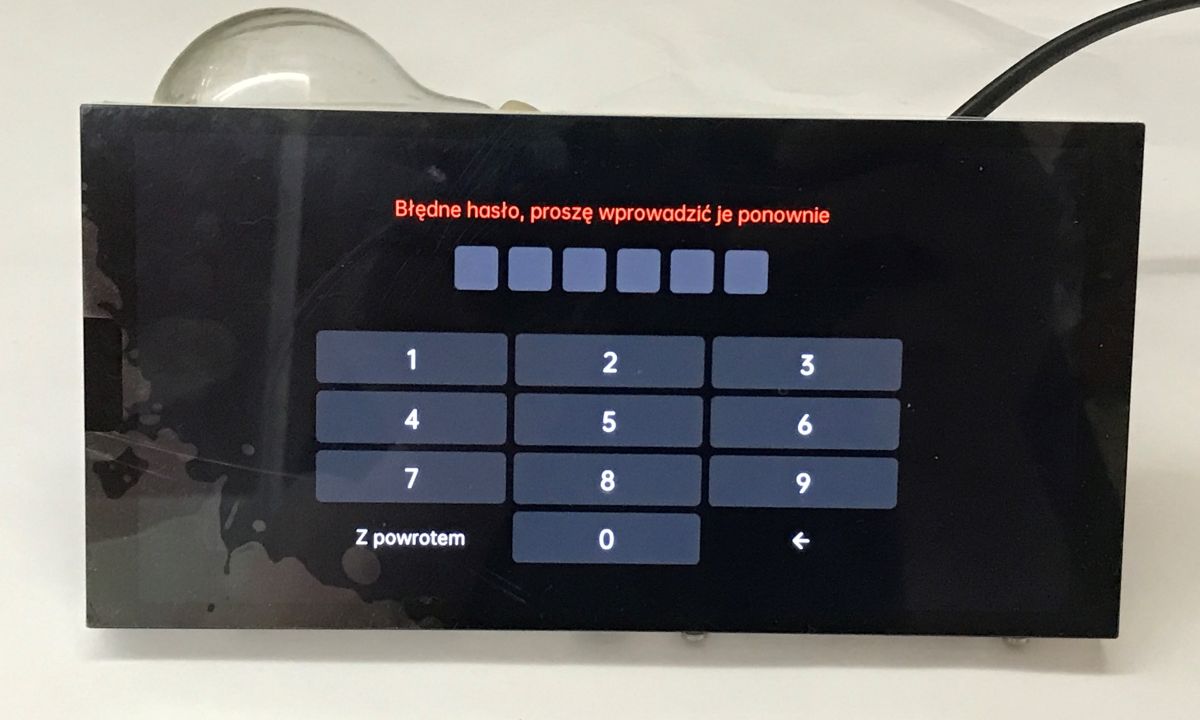

    The password is set in the advanced settings - actually, there are two passwords, one for the screen and one for the settings:
    Advanced settings screen showing lock screen password and permissions toggle Security settings screen with options to enable or change a password in mobile app Security settings screen with five-digit password entry field .
    This is what it looks like in practice:
    Aqara Panel S1 Plus showing wrong password message and numeric keypad .
    Aqara panel shows lock screen with number pad to enter access code .
    Power consumption measurements .
    When powered from the mains, approximately 3.7W is consumed. Interestingly, switching on two relays does not seem to significantly affect the power consumed. Could it be that these are bistable relays?
    Aqara S1 Plus panel with touch screen and power meter showing 3.7W .
    When the screen is turned off, the consumption drops to about 2W:
    Aqara panel with screen off and power meter showing 1.9W consumption .
    Similarly for the USB power supply. At 5V, approximately 0.5A, making 2.5W, with this not including the inverter in the power supply.
    Hub S1 Plus touchscreen panel with USB power meter showing 0.47A draw .
    This value halves when the screen is turned off:
    Aqara S1 Plus panel powered via USB with 0.24A current reading on meter .
    Out of curiosity, I also checked whether switching on the camera view somehow affects the current consumption? It does, but it is not a significant change:
    Aqara S1 Plus panel powered by USB with 0.52A current measurement .

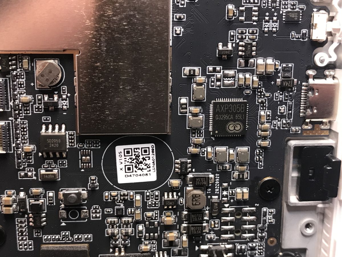

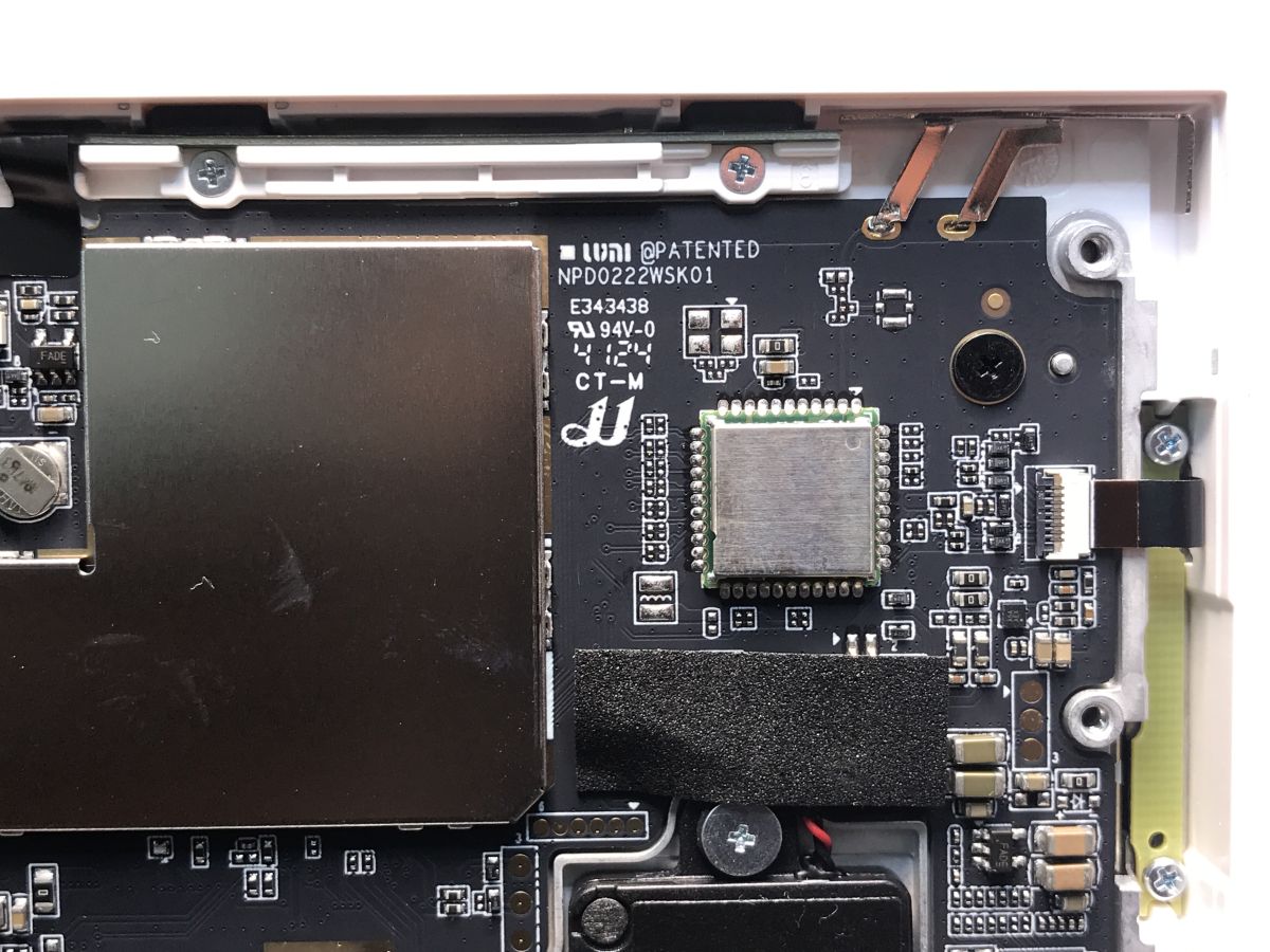

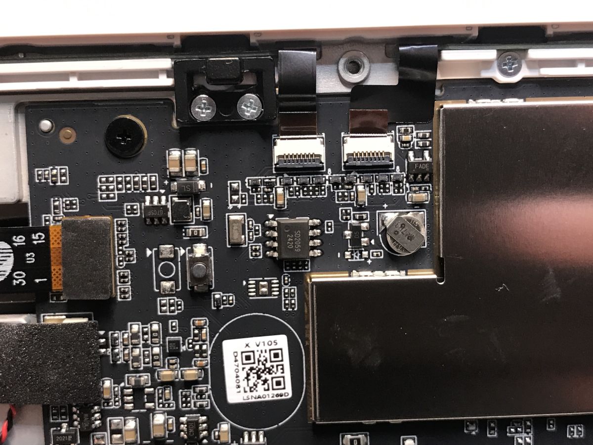

    Interior of Hub S1 Plus .
    The whole unit is made solidly and with good quality materials. There are no plastic catches like in cheaper products and the back of the case is metal. You can unscrew the screws and take a look at what's behind it.

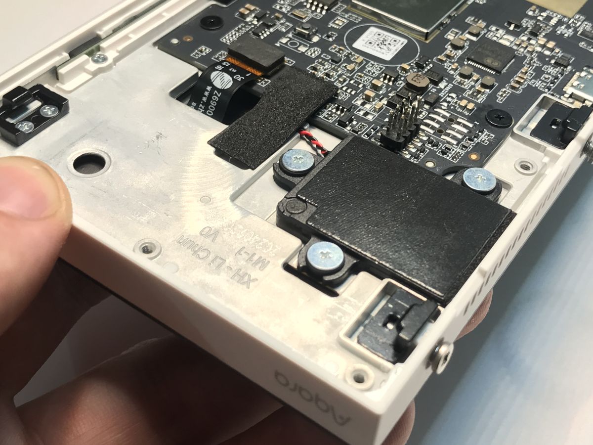

    Interior of disassembled Aqara panel showing mainboard and screen assembly. .
    What immediately catches the eye are the two large speakers that provide stereo sound. You can also see the module from wireless communication and the main CPU section, which unfortunately for observers is shielded.
    Close-up view of Aqara Hub S1 Plus interior with electronics and connectors Close-up of circuit board with labeled ICs and electronic components Close-up of Aqara S1 Plus interior with visible electronic components Close-up of Aqara S1 Plus interior with visible electronic components

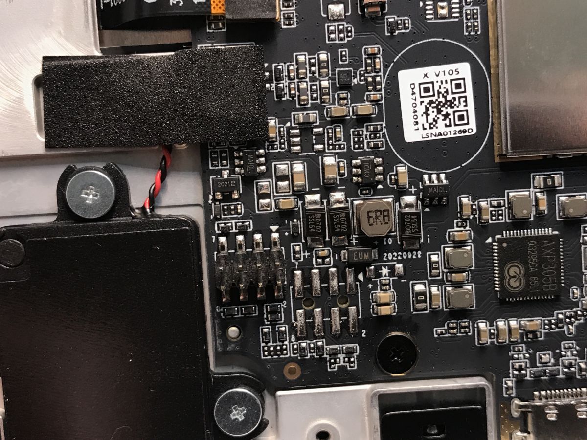

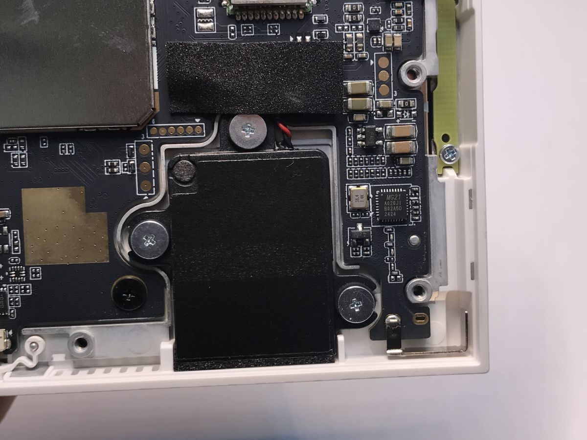

    Close-up of Aqara Hub S1 Plus PCB showing AXP305B and SD2059 chips Aqara Panel Hub S1 Plus circuit board labeled NPD0222WSK01 Close-up of Aqara Panel Hub S1 Plus interior showing circuit board and MG21 chip .
    I was interested in that battery at the SD2059. It's probably a time keeper. Will it need to be replaced sometime in there after prolonged use?
    Inside I see, among other things, AXP305B, MG21 and PCB designation NPD0222WSK01. This MG21 could be the EFR32MG21 Series 2 Multiprotocol Wireless SoC, controlling Zigbee and Bluetooth.
    I also wanted to look at the executive part (power supply and relays) but couldn't find a way to get there.
