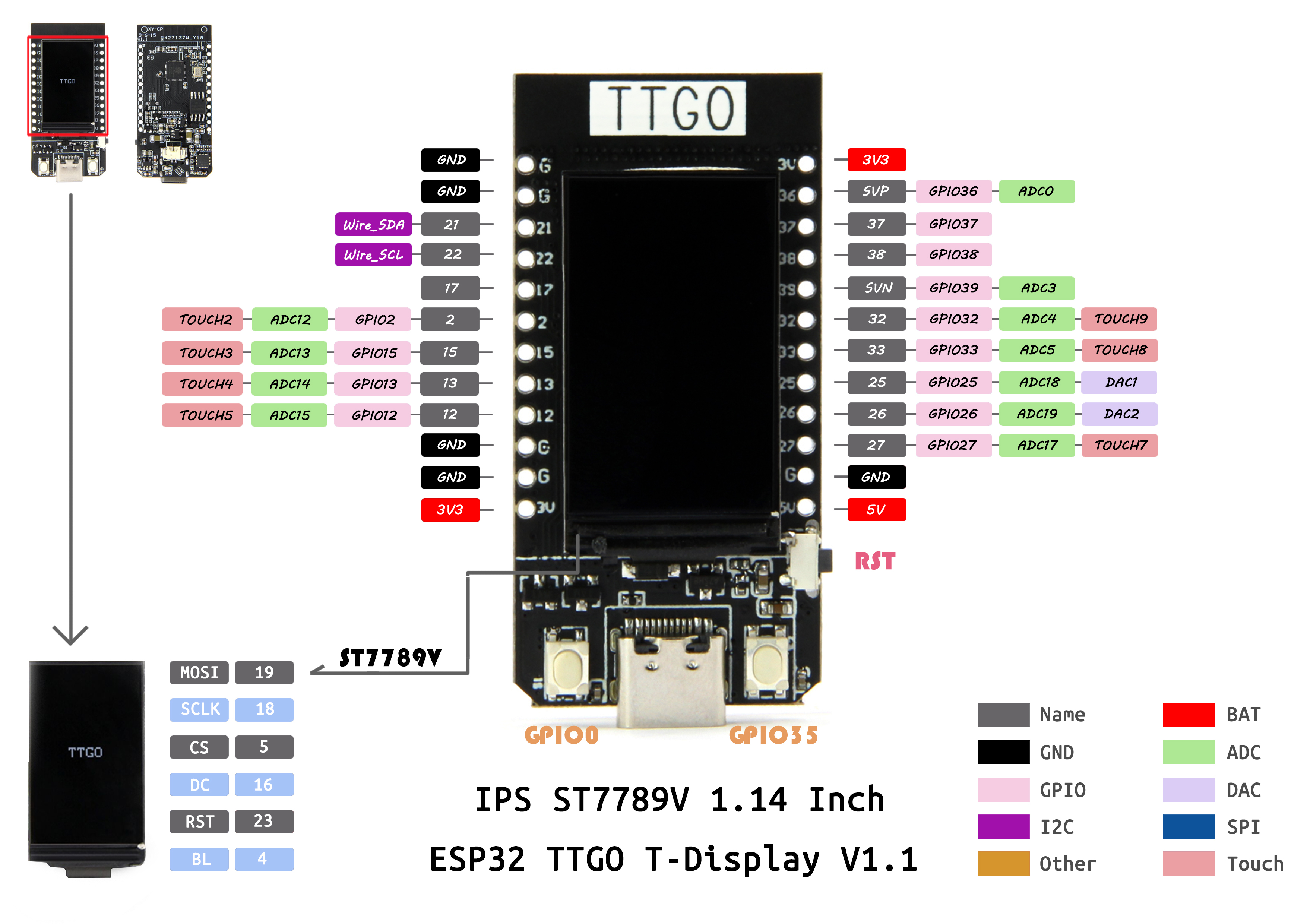

    Hi, I have been playing around with ESP32 for a while.
    I want to connect NEO6M0001 (GPS module), but it doesn't work.
    The ESP I have is exactly:
    https://ae01.alicdn.com/kf/H1a0237f07f044e30ab81df98b51245c5a.jpg
    I did the connection with the tutorial:
    https://shopofthings.ch/gy-neo6mv2-esp32-gps-beispiel/
    ESP 3.3V > GPS VCC
    ESP GND > GPS GND
    ESP RX > GPS TX
    ESP TX > GPS RX
    Question to which pin to connect RX and TX exactly? Asking for help in pointing out on the schematic of my ESP.
    There is another concern, is there an option that I soldered the goldpins wrong for example? I have medium experience in this, but I don't want to believe that this is the problem :) .
    Thanks in advance for your help!
    PS. when I'm done, I'll be happy to share the code (I'll upload to Guthub) and pictures.
    I will add that I am much stronger in programming than in electronics, hence the request for help :) .

    khoam wrote:
    I am concerned that the current capacity of the 3V3 output from the TTGO is insufficient.
    5V then?
    Will the configuration then be identical?
    SerialGPS.begin(9600, SERIAL_8N1, 13, 17);
    Does anything need to be changed here?

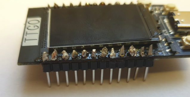

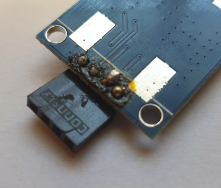

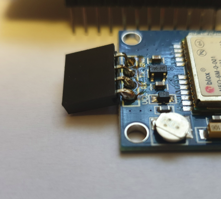

    Still coming back to the solders... I know they are far from perfect :) , but have a look please, is this by any chance the reason for not working?

    khoam wrote:
    Which solder connections I prefer not to comment on :-?
    I guess, however, I need to correct the lutes :) , because it appears that this is the reason for not working after all.
