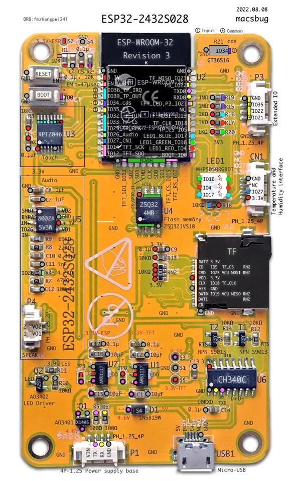

    I have ESP32-2432So35 developer boards (from China), more or less such (from this series):
    Connecting two sensors to the ExtendedIO on the ESP32-2432So35 board - Can it be done? How?
    One has inputs for a humidity/temperature sensor, speaker and ExtendedIO as a "general purpose connector".
    The question is whether it is possible, and if so, then how to use this ExtendedIO to connect simultaneously a GPS sensor and an encoder?
    I am browsing the web, there is some information about this board, mainly about its touchscreen display. I have the documentation from their Google Drive page, but nowhere stammered how to use the ExtendedIO 🙂
    Anybody know something, maybe knows this board (or similar) and is able to help?
    The ExtendedIO outputs are 4 pins:
    - GND
    - IO21
    - IO22
    - IO35
    Here are the docs - https://drive.google.com/drive/folders/1S9Joi...1zA?spm=a2g0o.detail.1000023.1.17102169vREj5d
    Directory with 35 at the end in the name. ESP32-2432So35
    Will it be possible to connect at the same time GPS and encoder under this board?
    Thanks in advance for your help!

    Encoder - P3 IO21,IO22,IO35
    a GPS - P1 RX
  • #3 20506712

    P1, pin 1 of which is the power supply and pins 2 and 3 of which are the RS232 serial communication port with a 3.3V voltage standard, just right for MATEKSYS
    and one more remark, you cannot use the USB communication and RX/TX of the P1 connector at the same time.

    One more question: those white sockets on the board are JST SH1.0-4P ? I wouldn't ask this, but I already bought the cables, they came and .... they turned out to be too small. He wants to make sure now! :) I am asking about the white ExtendedIO and Power Supply sockets.

    I know they are available to buy, but what are they called? ;) The raster is 1.25mm, 4-pin, but what is their professional name?, as there are dozens of types in the shops and several are quite similar. Probably these are the ones: JST XH 1.25mm 4pin (??)

    I bought the JST XH 1.25mm 4pin, it arrived today and is OK - finally!

    I don't know which numbers, pin designations to use in the application for TX and RX. I connected the GPS to the board and it doesn't detect it - error "check wiring".
    I use the TinyGPSPlus library: https://github.com/mikalhart/TinyGPSPlus
    What about simultaneous RX/TX communication in P1 and USB, I understand that I won't be able to view the result on the Monitor (Serial Monitor in Arduino IDE)?

    Personally, I would knock out that led1 tricolour and use two of the three ports to communicate with the GPS

    In post #4:
    P1 of which pin 1 is the power supply while pins 2 and 3 are the RS232 serial communication port with a 3.3V voltage standard just right for MATEKSYS and one more note, it is not possible to use simultaneously USB communication and RX/TX of P1 connector
    you have recommended P1 connector and I would like to use it
    . Only I don't know what pin numbers are assigned to the outputs in P1.
    U0-RXD - 35 and U0-TXD - 34?? .

    Standard, i.e. RxD - GPIO 03 and TxD - GPIO 01
