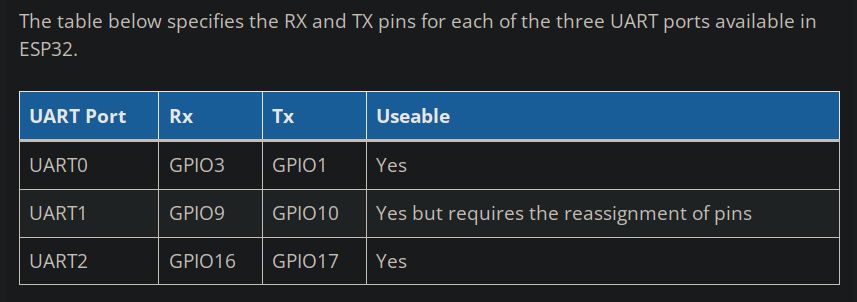

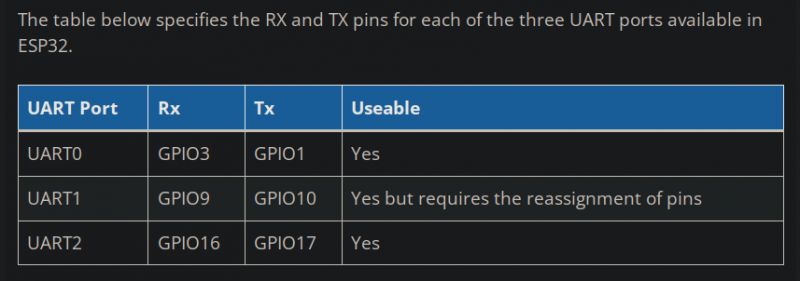

    On the ESP32 forum I got the answer that PIN 17 cannot be used.... Are they writing the truth? From the pinout of this board, it appears that this is the TX from UART2.
  • #10 20567380
  • #11 20567402
    CC_PL
    Posts: 497
    Rate: 57
    Thanks for the tables
    This is the main Esspressif forum. I think the guy was referring to some rare PSRAM memory board.
