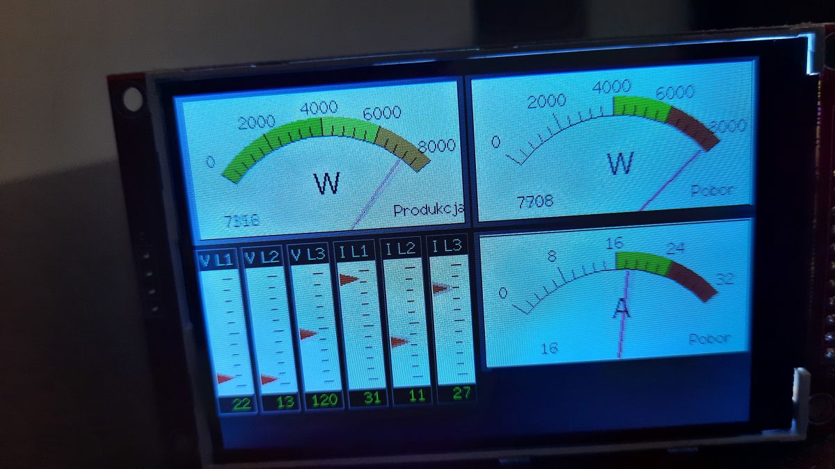

    Now I still need to embrace the 3.5" TFT
    Code: C / C++

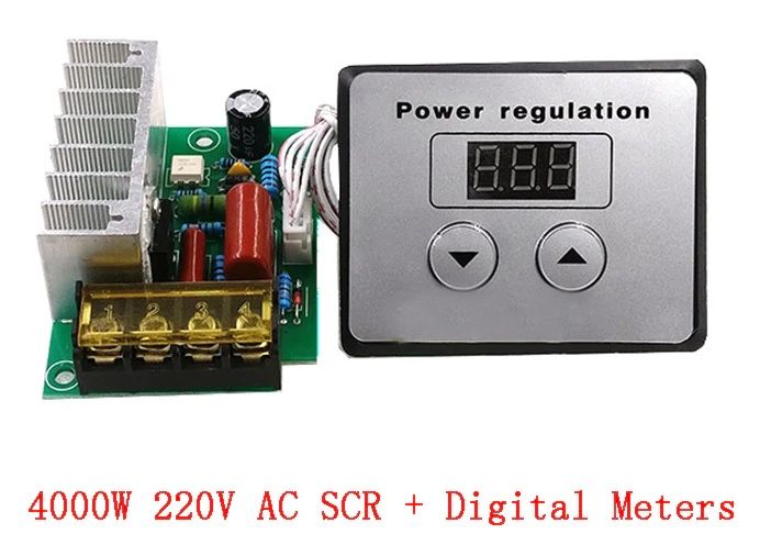

    and a power regulator with a '0' transition + four relays and a thermometer - maybe I won't run out of pins :shocked!:

    khoam wrote:
    What library are you using? what specific display is it?
    TFT_eSPI library - 3.5 inch 320*480 serial SPI TFT display with LCD optical module - IC driver ILI9341 for MCU
    ESP32 communication with PZEM-004T V3.0 via UART0 or UART1 - Guru Meditation Error .
    The display works without problem, but when I add a reading from PZEM it resets for me.
    I have changed the TFT_CS to different pins but the effect is the same.
