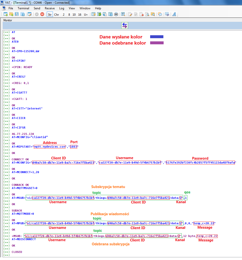

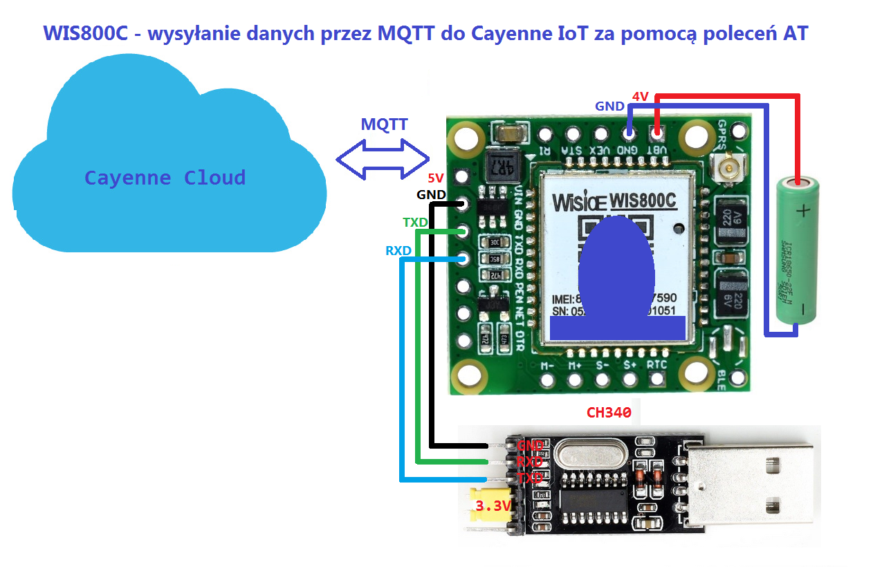

    I did a test of a cheap (about $3) GSM module WIS800c and AIR208 , which I used to send data via MQTT to the Cayenne IoT cloud. During the test, I sent AT commands to the module via the YAT terminal, and the whole process can be seen below. In summary, I will write that I posted a message "temp, c=20.22" in the subscribed topic, and then took the subscription. I will try to answer any additional questions.
    I am enclosing:
    - WIS800C_AT_Command,
    - WIS800C_MQTT,
    - WIS800C_TCP,
    - screenshots.
    Connection diagram.
    WIS800C GSM module - sending data via MQTT to Cayenne via AT commands WIS800C GSM module - sending data via MQTT to Cayenne via AT commands .
    AT commands sent.

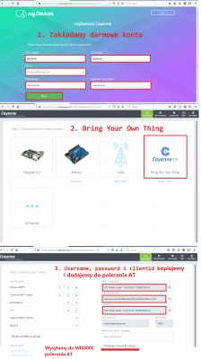

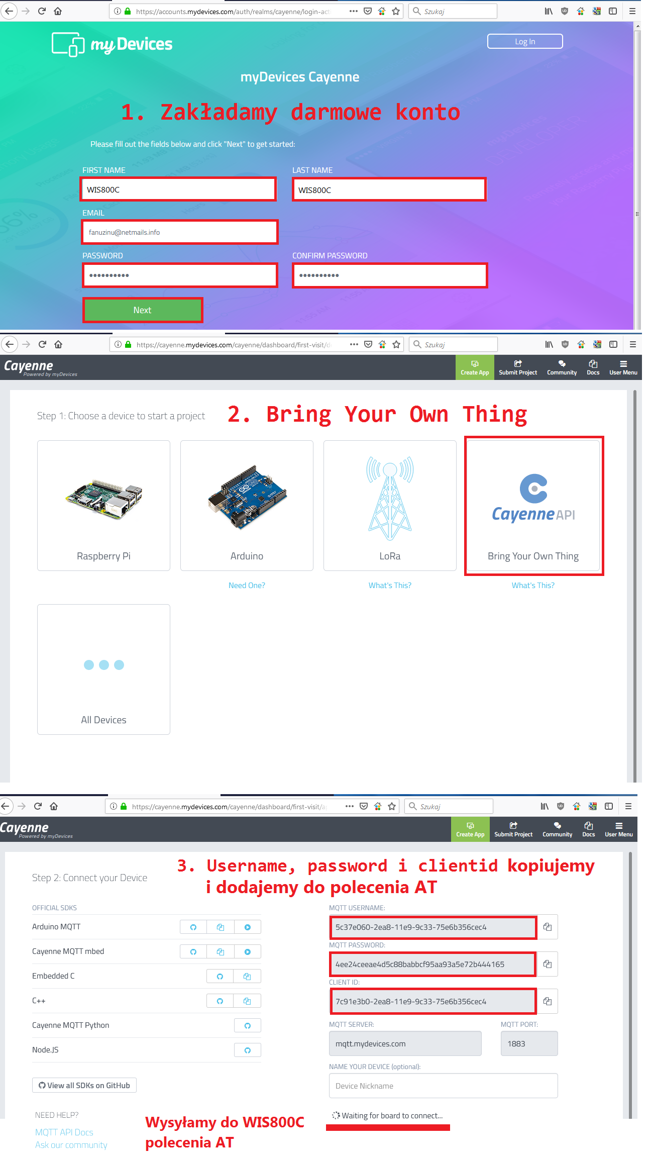

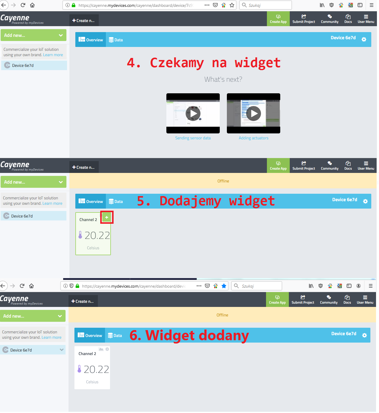

    Cayenne IoT configuration steps. This is where you will set up your myDevices Cayenne account.

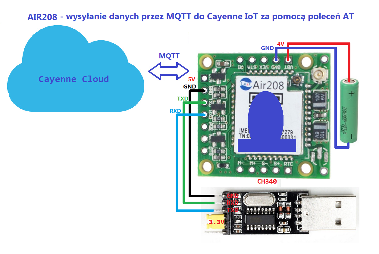

  • #7 18470217
    piotr_be
    Posts: 47
    Rate: 28
    Question about the GSM module WIS800c, available on aliexpress. It works with GSM networks in Poland without changing the firmware?
  • #8 18471288
    czasnagli
    Posts: 684
    Help: 19
    Rate: 105
    piotr_be wrote:
    Question regarding the GSM module WIS800c, available on aliexpress. Does it work with GSM networks in Poland without changing the firmware?
    Yes. The WIS800C works in Poland without changing the firmware, which is identical to the GSM module Air202T.
