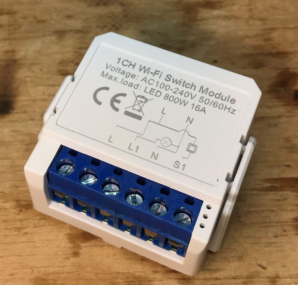

  • WSM16-W1 Wi-Fi switch module with visible connectors and technical markings.
    Today we are modifying another relay module for the box so that it works 100% locally, regardless of the manufacturer`s servers. Then we will also pair it with Home Assistant. This modification was made for a reader who sent me a set of gadgets that I haven`t described yet so that we could expand our electrode list of IoT device interiors .

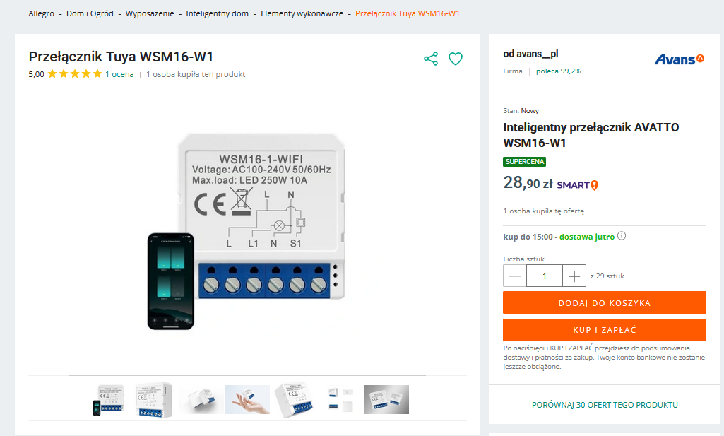

    Purchase of WSM16-W1
    The module was purchased quite cheaply - less than PLN 30:

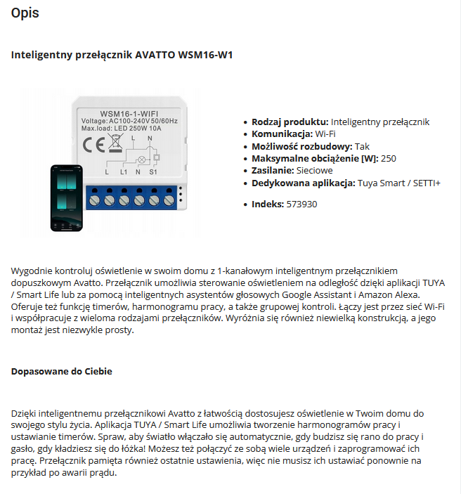

    Product page of Tuya WSM16-W1 switch showing the device and a smartphone.
    The description has standard Tuya talk:
    Image of the AVATTO WSM16-W1 smart switch and a phone with an app.
    What also catches my eye is that the description includes the version 250W and we got the versions 800W , I wonder if both versions have the same interior?

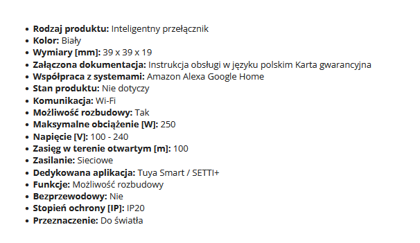

    Parameters:
    Table with parameters of a smart switch.

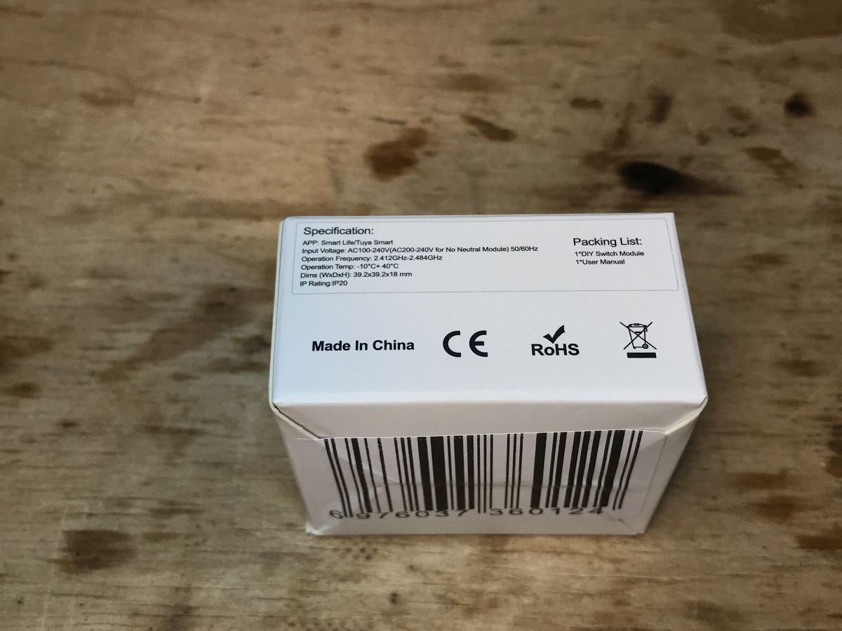

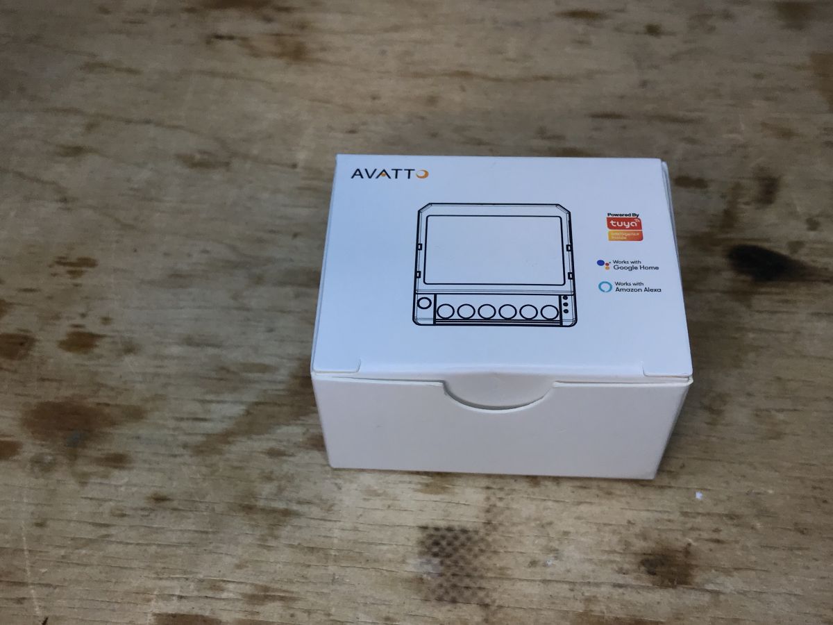

    Packaging:
    Packaging of WSM16-W1 relay module on a wooden background Box of AVATTO WSM16-W1 module on a wooden surface.

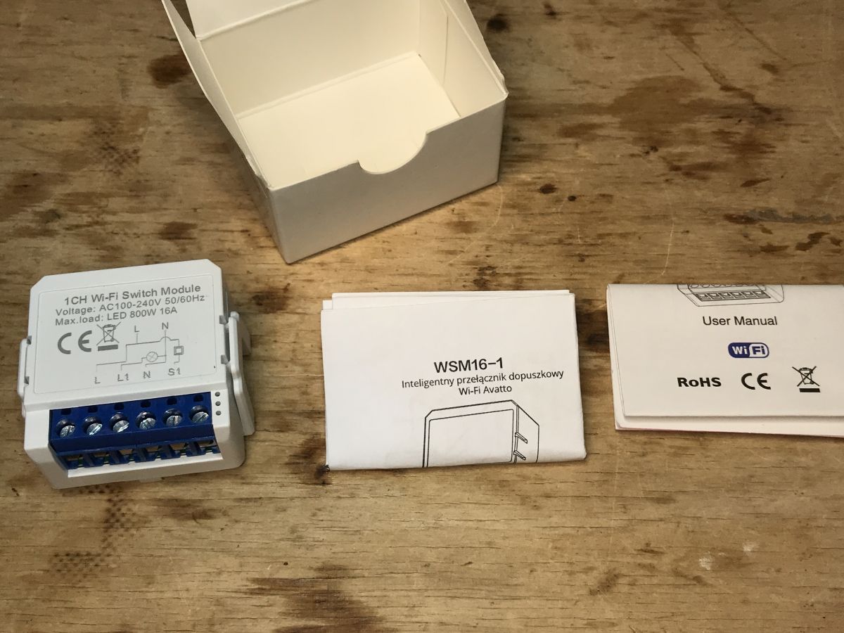

    The contents of the set (well, there is a plastic mounting with hooks):
    WSM16-W1 Wi-Fi switch module, manuals, and packaging on a wooden surface.
    Instruction:
    Smart module user manual with illustrations and QR codes. User manual for WSM16-1 module showing technical specifications. User manual for Avatto WSM16-W1 smart Wi-Fi switch. WSM16-W1 module instruction manual with diagrams and text.

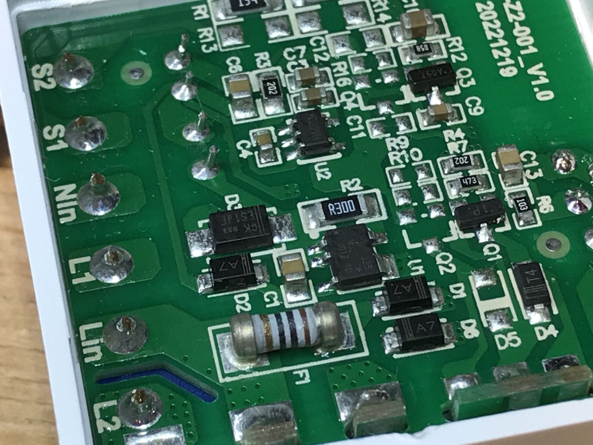

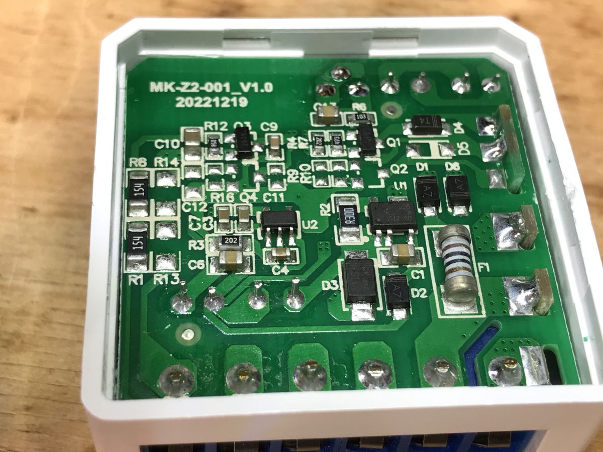

    Interior view of the WSM16-W1 electronic module with electronic components on a green PCB.

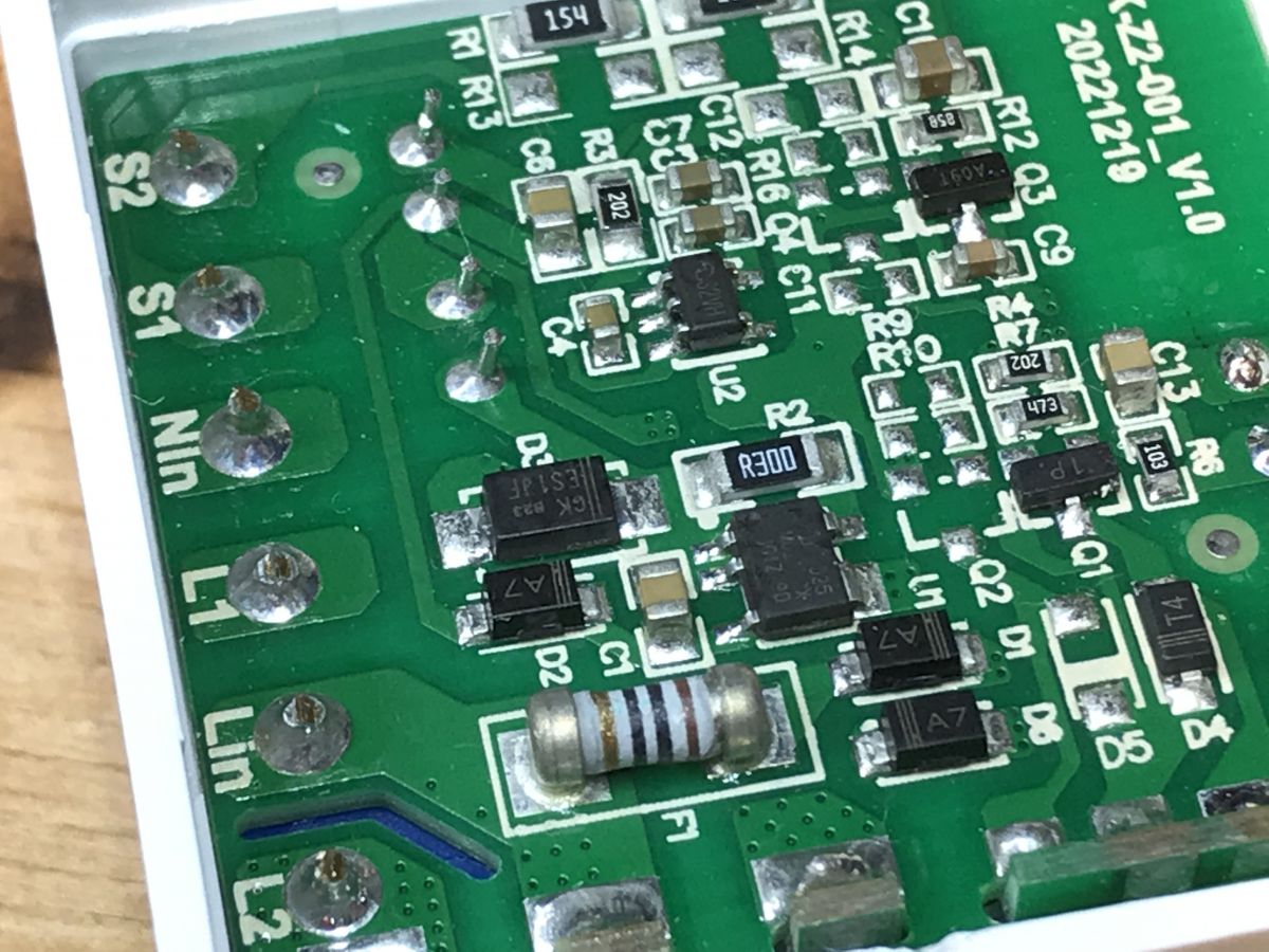

    Inside there is again a non-isolated converter based on OB2525. I also see a fuse resistor and a step down converter (U2), because OB2525 only provides 5V, and I need to generate another 3.3V for the WiFi module:
    Close-up of the PCB of the WSM16-W1 module showing electronic components. Close-up of a circuit board with electronic components.
    In this case, it was extremely difficult to remove the PCB from the other half of the housing. I had to gradually pry from each side.

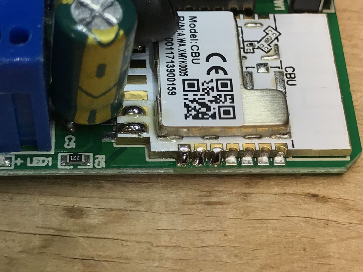

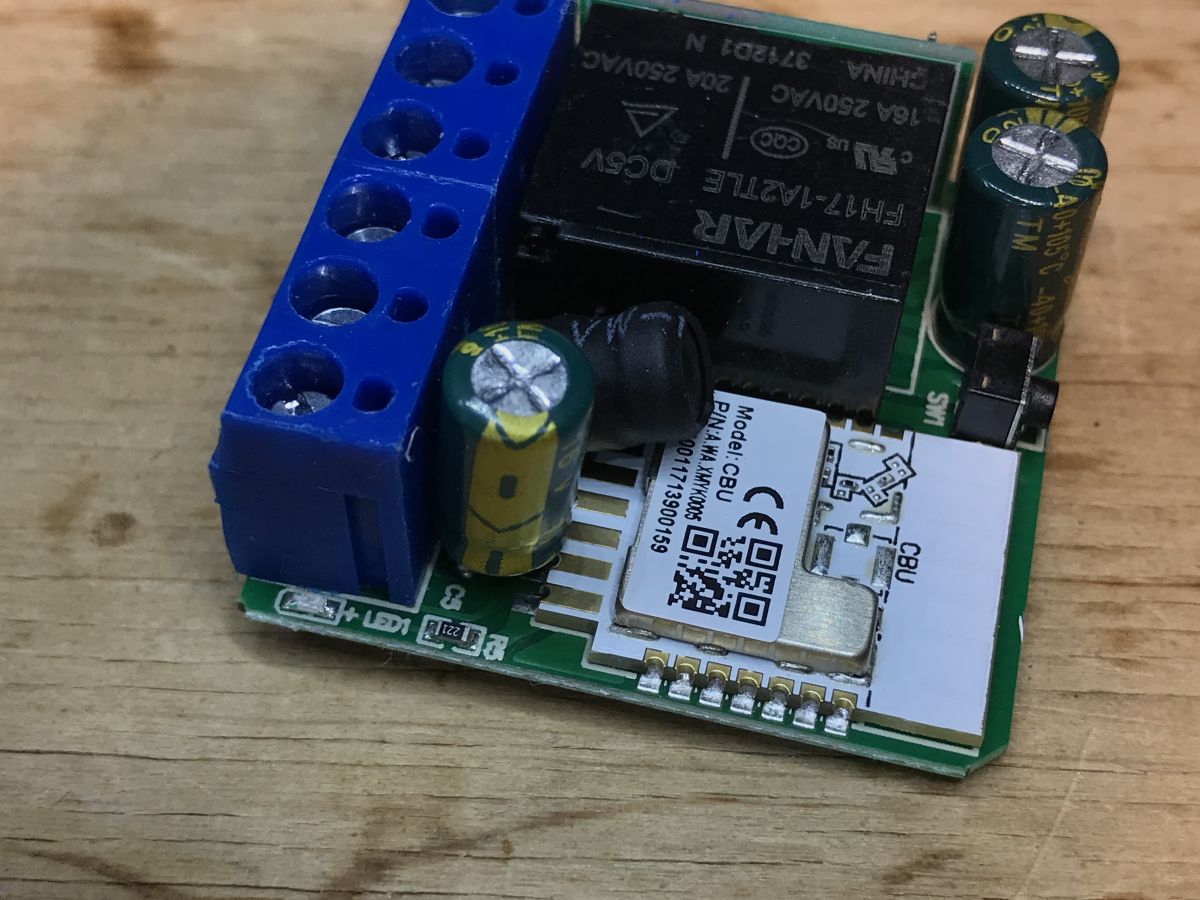

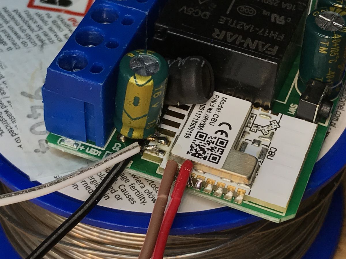

    Inside is the CBU module:
    https://developer.tuya.com/en/docs/iot/cbu-module-datasheet?id=Ka07pykl5dk4u
    You can upload:

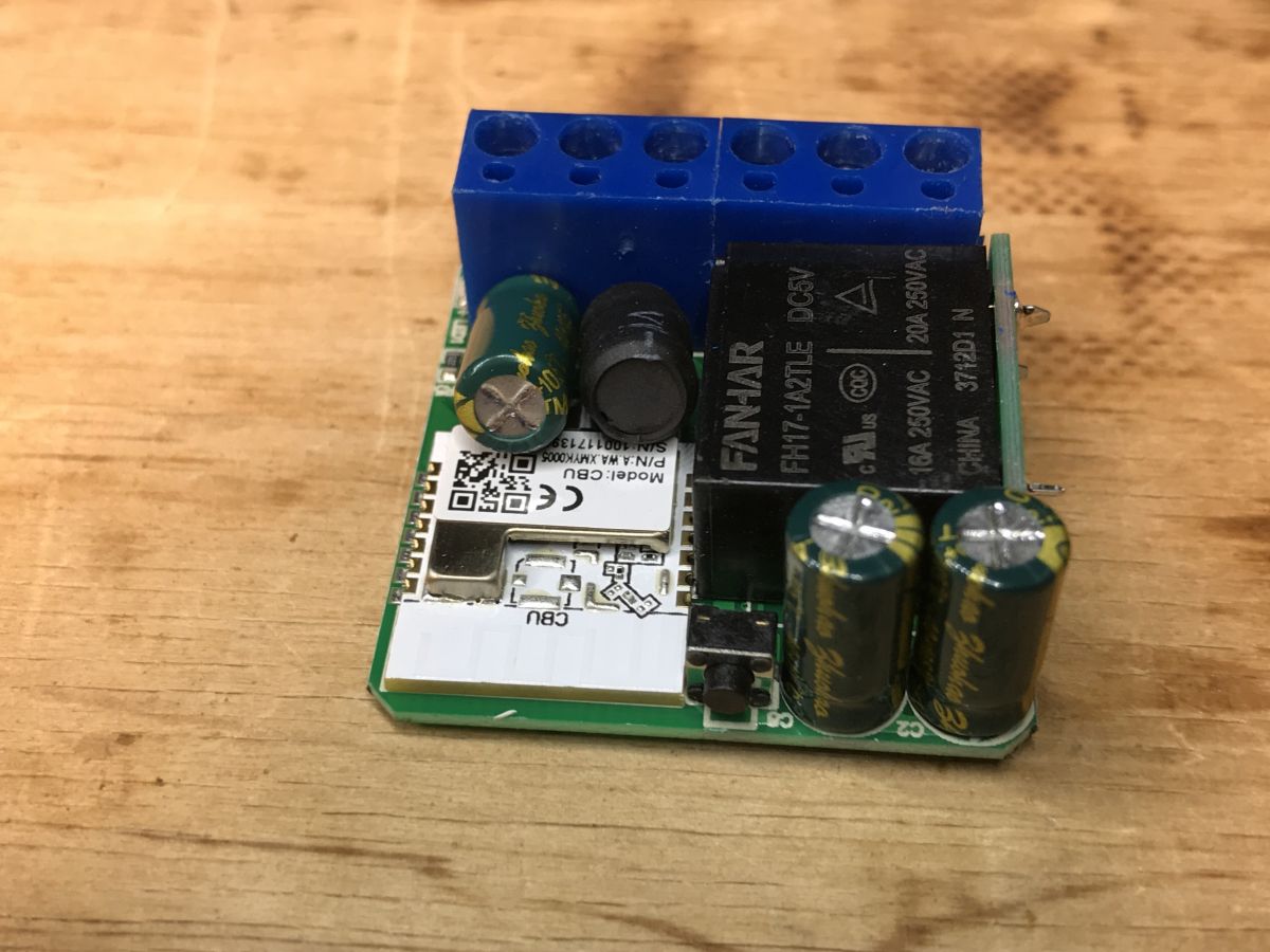

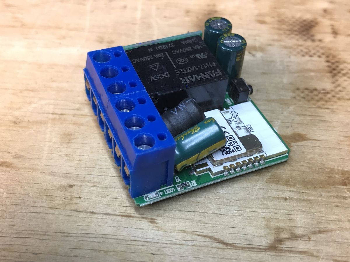

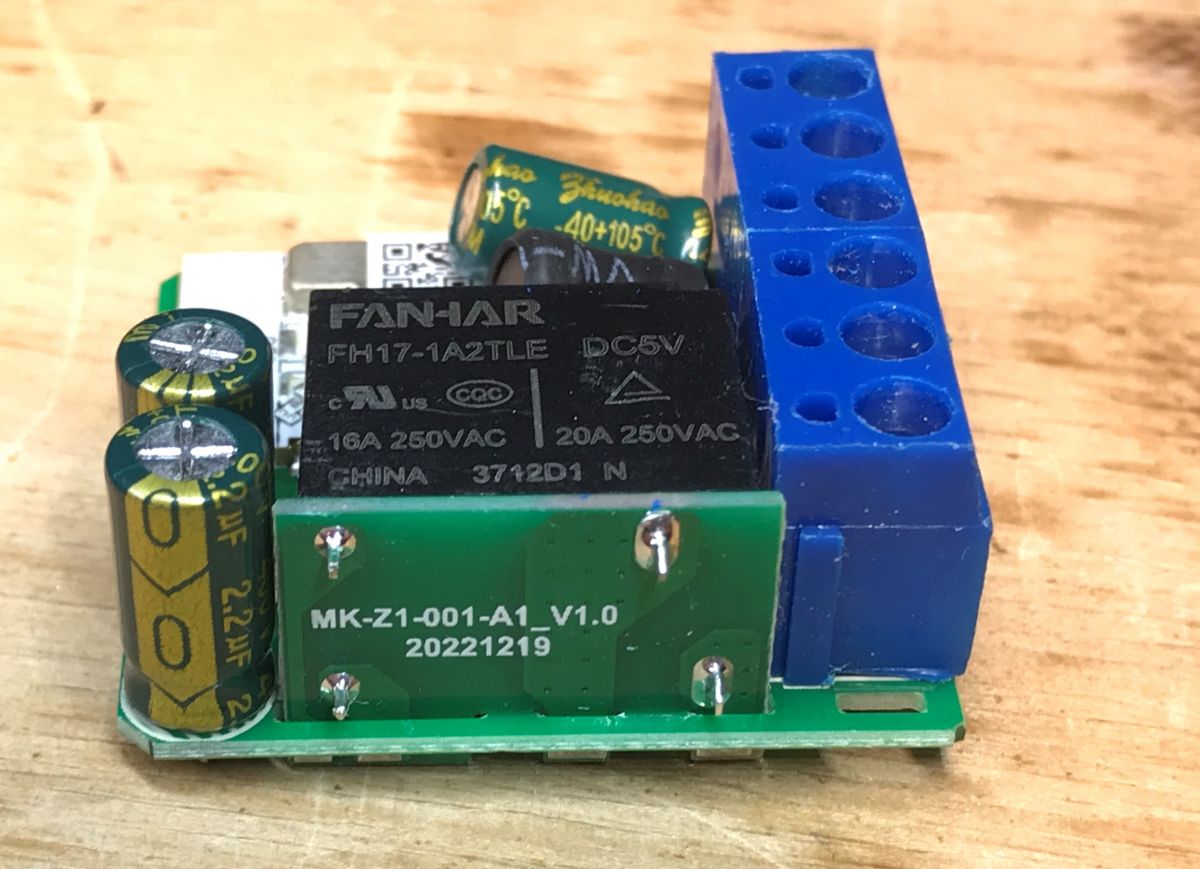

    The whole thing is packed very tightly, the capacitor and the coil are specially placed:
    Close-up of the WSM16-W1 module with electronic components on a wooden background.
    In order to reduce the thickness of the module, the clever manufacturer placed the relay on its side:
    Close-up view of an electronic relay module with FANHAR markings.

    We solder four wires, first whiten the pads:
    Close-up of the CBU electronic module with soldered components on the PCB. Close-up of the WSM16-W1 module with visible electronic components on the PCB.
    Soldered:
    Close-up of the interior of the WSM16-W1 module with connected wires.

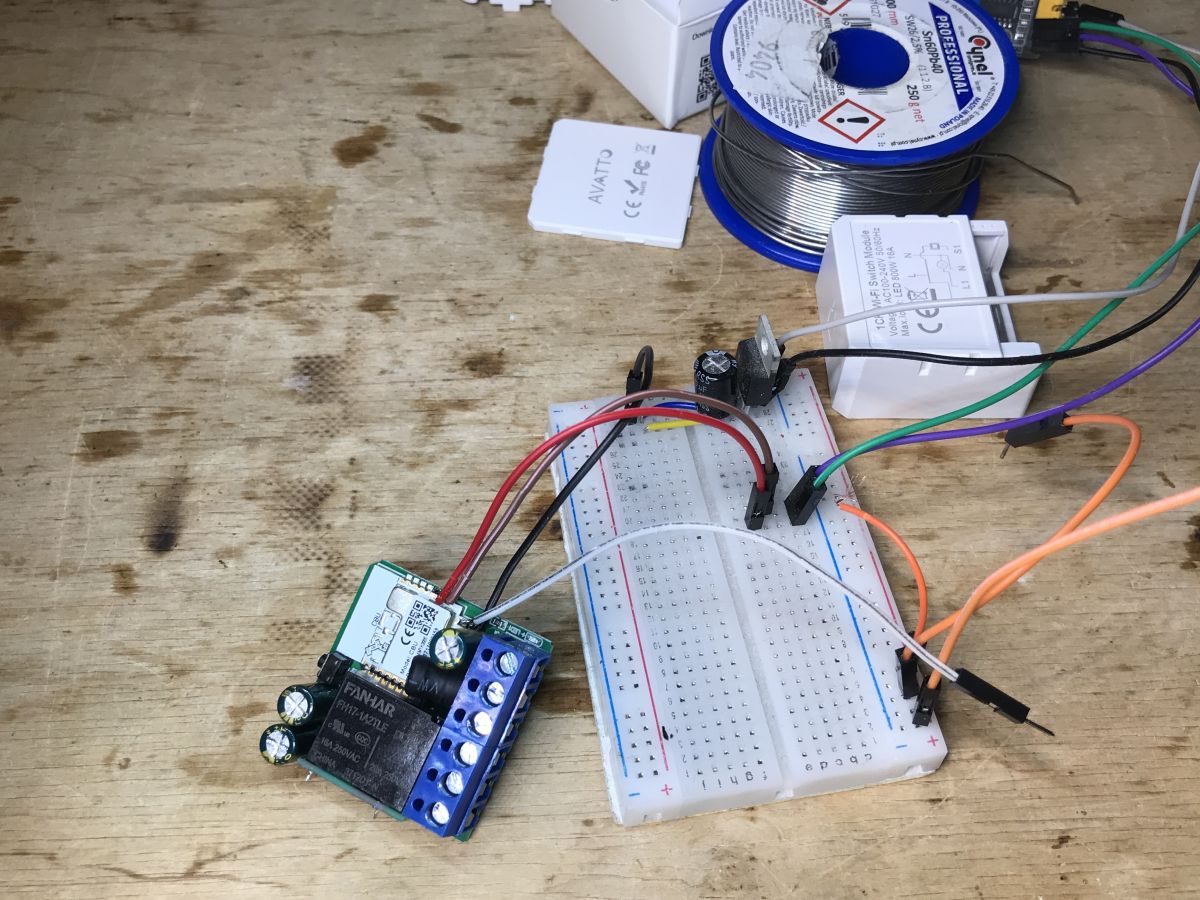

    Whole flashing system:
    WSM16-W1 module connected to a breadboard with several wires.

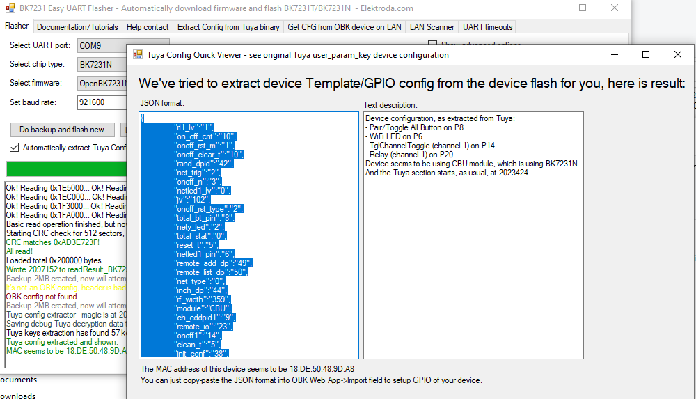

    Flasher correctly detects Tuya configuration:
    Screenshot showing the BK7231 Easy UART Flasher interface extracting JSON configuration for a device module.
    JSON:
    Verbal description:
    - Pair/Toggle All Button on P8
    - WiFi LED on P6
    - TglChannelToggle (channel 1) on P14
    - Relay (channel 1) on P20
    Device seems to be using CBU module, which is using BK7231N.
    OBK template:
    Uploading a template:
    Configuration with HA:
    This device probably needs to be entered as well PowerSave 1 to short startup command, otherwise we will have to replace the capacitor after a few months, as in this topic: https://www.elektroda.pl/rtvforum/topic3898805.html

    Changing the firmware was, as usual, hassle-free, just solder four cables and the configuration was automatically detected by my flasher again.

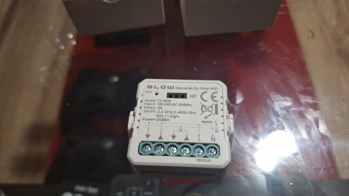

    interesting your extraction seems to suggest there's an RF version. I don't see evidence yours have an RF chip
    "remote_io":"23",
  • 3-pin connector version may support RF receiver addon
    #3 21782134
    Posts: 14768
    Rate: 12910
    Nice finding. I seem to remember that there was some other version of this device around, it had a 3 pin female connector for external RF receiver.... maybe this?
    Wi-Fi Tuya RF smart controllers for blinds and shutters with prices shown
    BLOW WiFi roller shutter controller with Tuya app on smartphones
    BLOW WiFi roller shutter controller on a glass surface
    but I haven't found how the RF module addon for that looks like.
