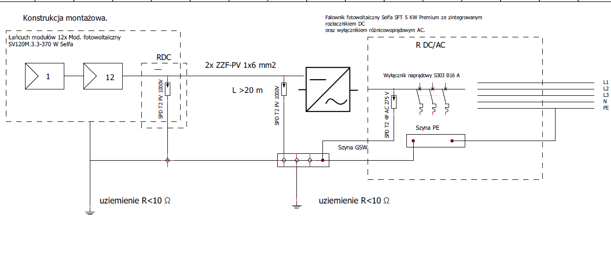

How should I complete the wiring diagram for my 6 kWp PV installation so PGE will accept the notification, and are SEP qualifications up to 1 kV enough to report it myself?
Not quite: the replies said your diagram is missing DC-side protection and AC-side overcurrent protection, and it should also show the ZE energy meter; one answer specifically mentioned 10x38 fuse bases on the DC side [#18186434] [#18186488] [#18186888] A later reply added that you lack overcurrent protection on both sides, so the single-line drawing should include that protection set rather than just the inverter switch [#18186488] For the grid notification itself, SEP operation qualifications were said to be sufficient for PGE [#18186488] [#18186491] One commenter also noted that in some branches they additionally ask for supervision permissions, but the general answer in the thread was that SEP is enough [#18186501] [#18186491]

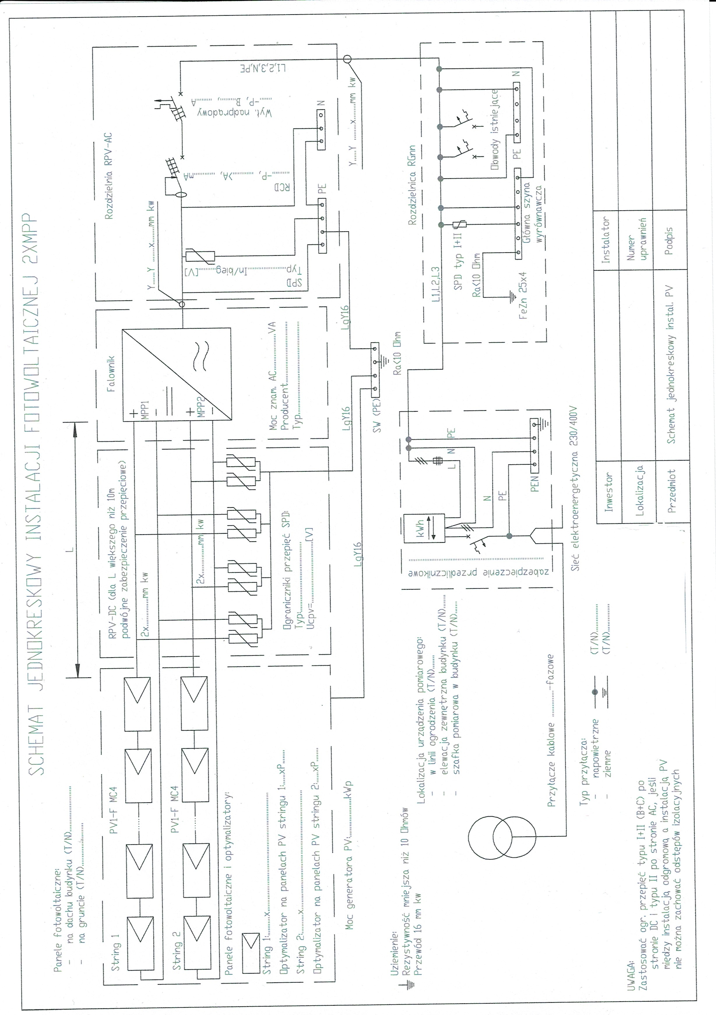

    paweldre wrote:
    I have such a scheme, will it pass in Tauron?
    6 KWp photovoltaic installation - diagram and connection method
    Recently, I reported a micro-installation in Tauron on line and it says that the reporting scheme is unnecessary.
    Without a schematic it passed. On October 19, I submitted and on October 20 they issued an order to establish a meter. For now, I’m waiting for the installer.
  • #122 19681810
    lary504
    Posts: 35
    For Tauron, only the installer's statement is needed. Unless you have an exotic inverter and it's not listed.

    You do not even need a scheme for energy :) .. and fine, but can anyone explain to me what, according to the act (that above 6.5 kW), we need to agree on the project, etc .. Who needs it, then who needs it? the fire brigade? and the diagram too? They don't even know it. So why these agreements and projects? Anyone know? Or maybe it's just unnecessary :)
    regards
    And one more thing. If someone would like to take the project and the photovoltaic notification personally to the power industry, unfortunately they have to submit all documents including the diagram (and not on-line) ? such a trick ... :)

    Hello colleagues, tell me whether the grounding for photovoltaic panels and from the power grid is to be connected to each other or separately to the panels and separately from the power grid
  • #132 20512540
    madart
    Level 26  
    Posts: 892
    Help: 79
    Rate: 65
    It is to be connected to each other, it is called equipotentialization, the minimum connection cross-section is probably 6mm2

    >>18488627
    What happens if I add 3 panels to one string, whilst leaving the rest unchanged? What are Energa’s requirements for the upgrade?
