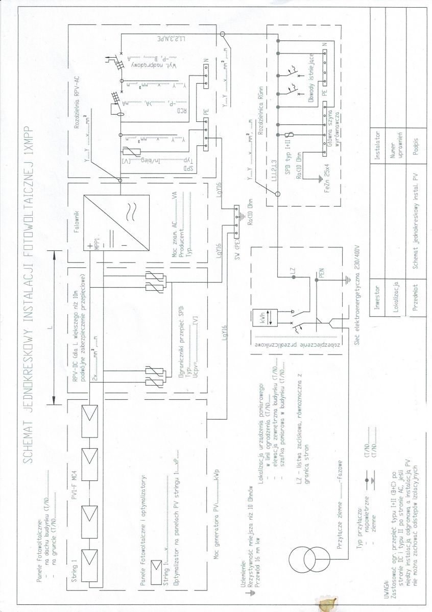

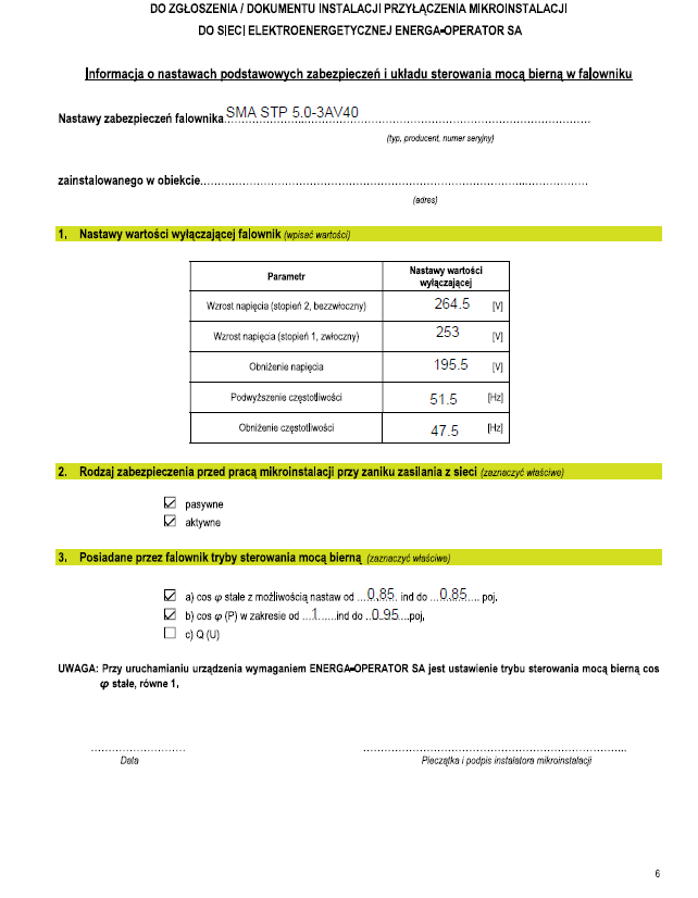

    Recently, when I wrote it down, I had these parameters entered, it was just in the SMA inverter
    but also look for the declaration of settings of this inverter in Polish
    • 6 KWp photovoltaic installation - diagram and connection method Bez tytułu.png (46.08 KB) You must be logged in to download this attachment.

    From point 9.2
    • Instrukcja_montazu_SOFAR_KTX.pdf (1.36 MB) You must be logged in to download this attachment.

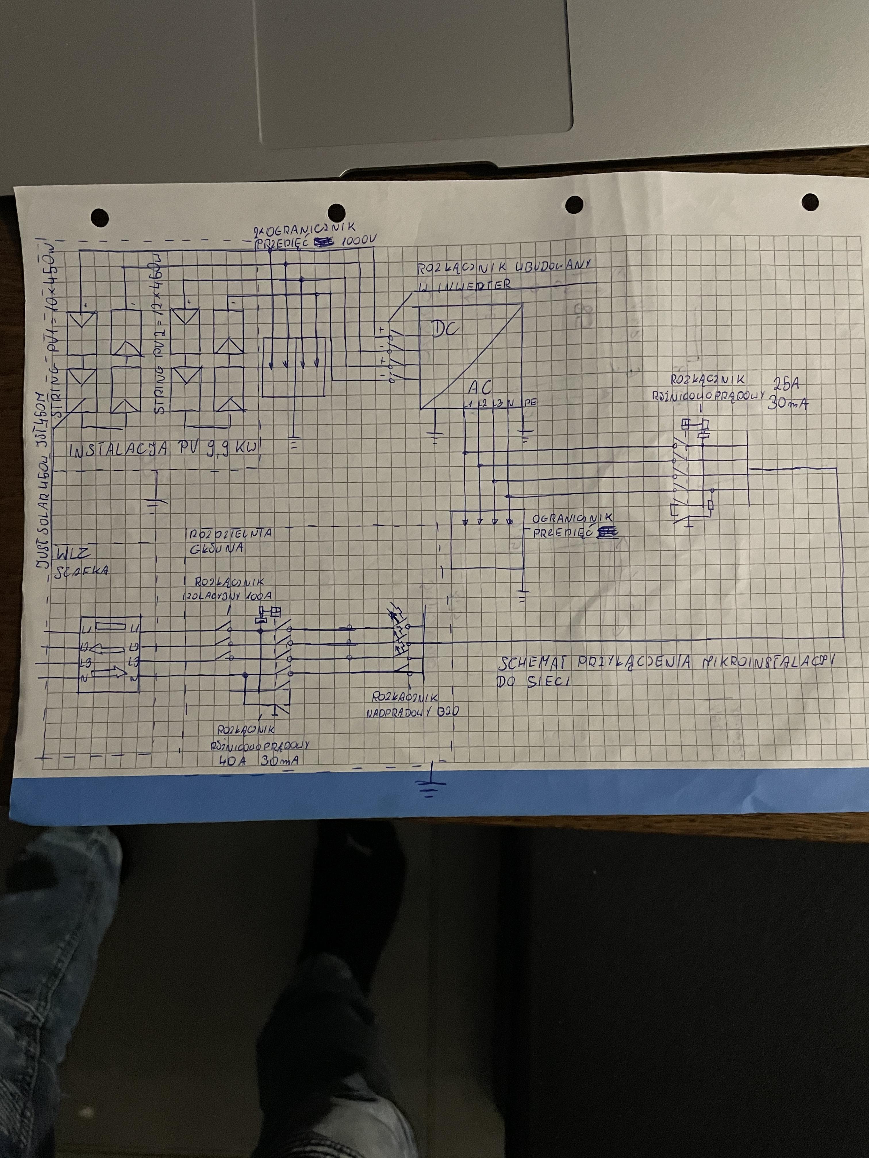

    I have another question, could you please take a look at the diagram below? will such a drawing pass in Energa?
    3-phase installation, contracted power 11kW, pre-meter protection 25A

    There may be such a diagram, but it is not necessary to draw the installation so accurately you draw one line, you mark that it is a 3F connection and that's enough.
    I look at it still and see that the protection on the DC side has 15A, I think it's a bit too high, see what the short-circuit current for these panels is definitely not 15A.
    In fact, with one string, there is no need to use such protection, the fewer connections the better and one more security issue on the AC side, I see that you have C40 and C60 written, I don't think you have such.
    One more thing I do not know if you will be expanding this installation, but in this situation the power of the inverter is too high
    on the DC side, the circuit should always be oversized at least 20% in our conditions, I prefer approx
    25-30%

  • #95 19012554
    luki2099
    Thanks for the advice,
    The inverter is in stock, as panels will be added (probably next year).
    The fact disconnectors I have not had to be changed. I will also reduce the protection on the DC side to 12A
    In general, we agreed with the electrician today that the meter will nevertheless be in the switchboard outside the building.
    The diagram will be drawn again, on Monday I will post the correct one - if someone wants to look,
    best regards
    Luke

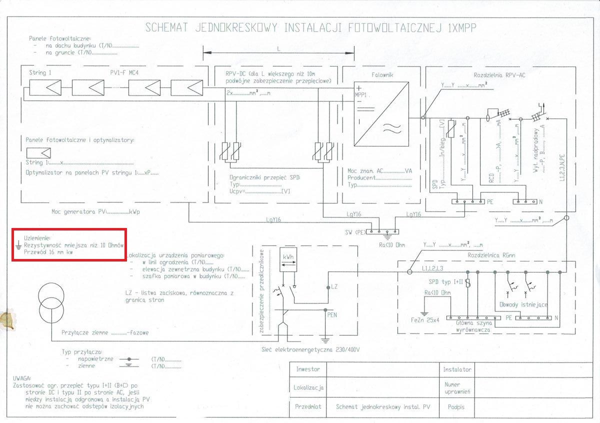

  • #102 19070543

    But how do I get the "Earth Resistivity" lower than 10Ohms? 6 KWp photovoltaic installation - diagram and connection method
    In most earth electrode locations, the soil would have to be replaced with one with good resistivity....

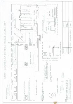

    I have such a scheme, will it pass in Tauron?
