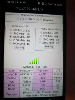

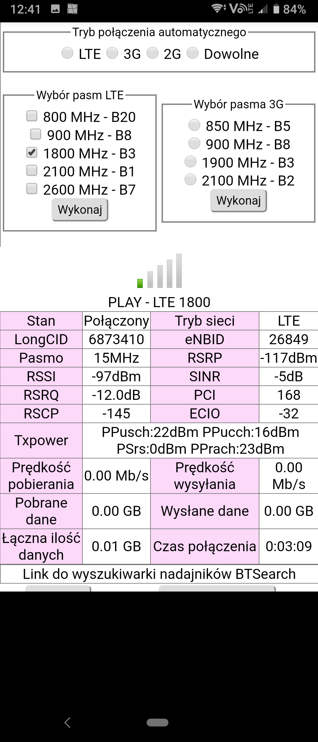

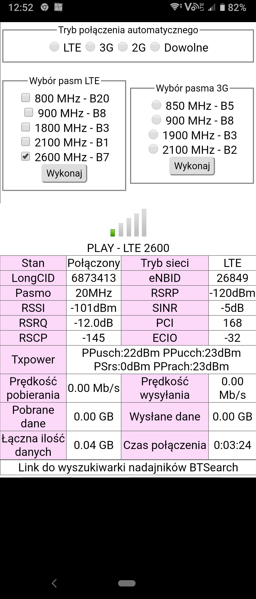

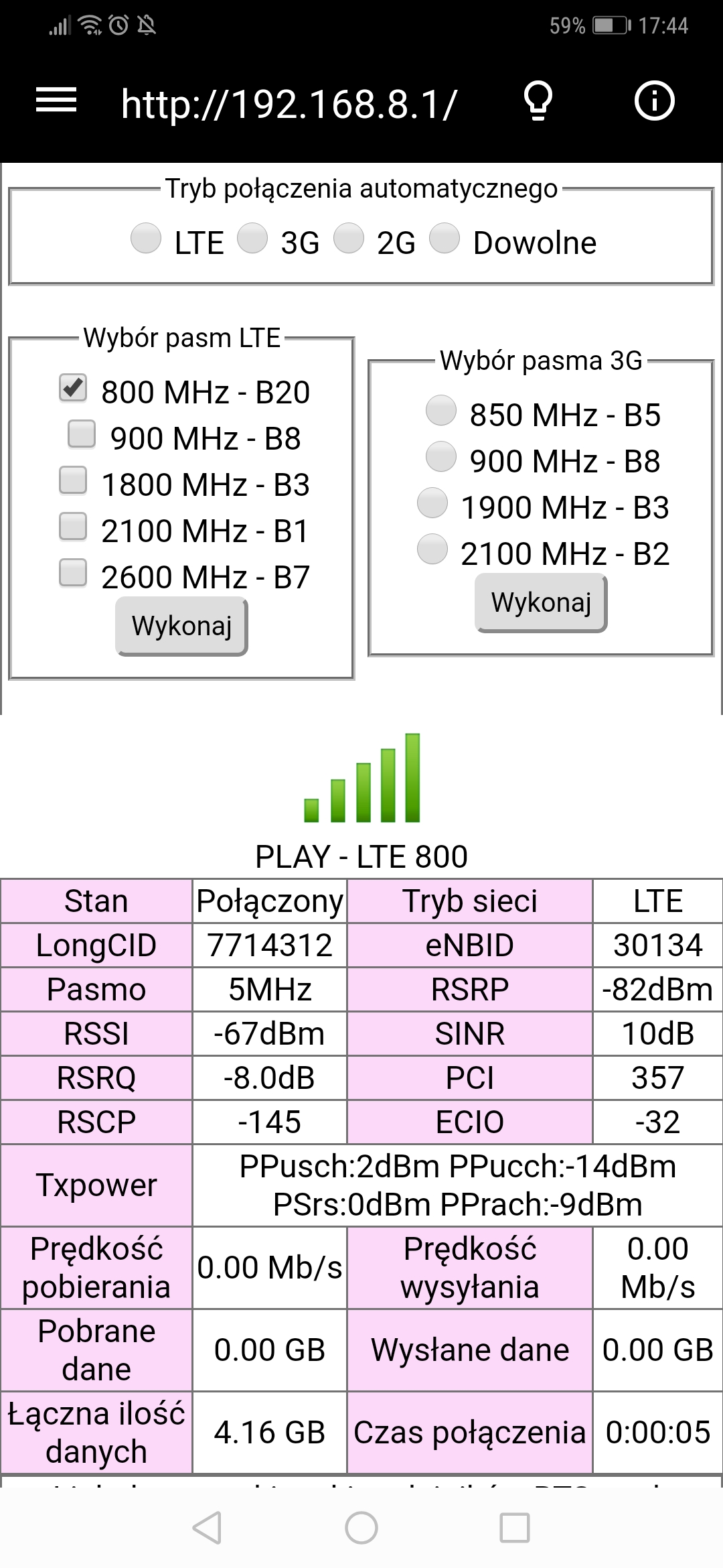

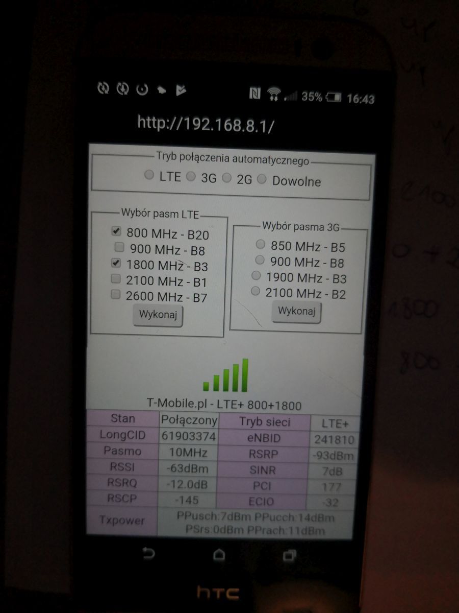

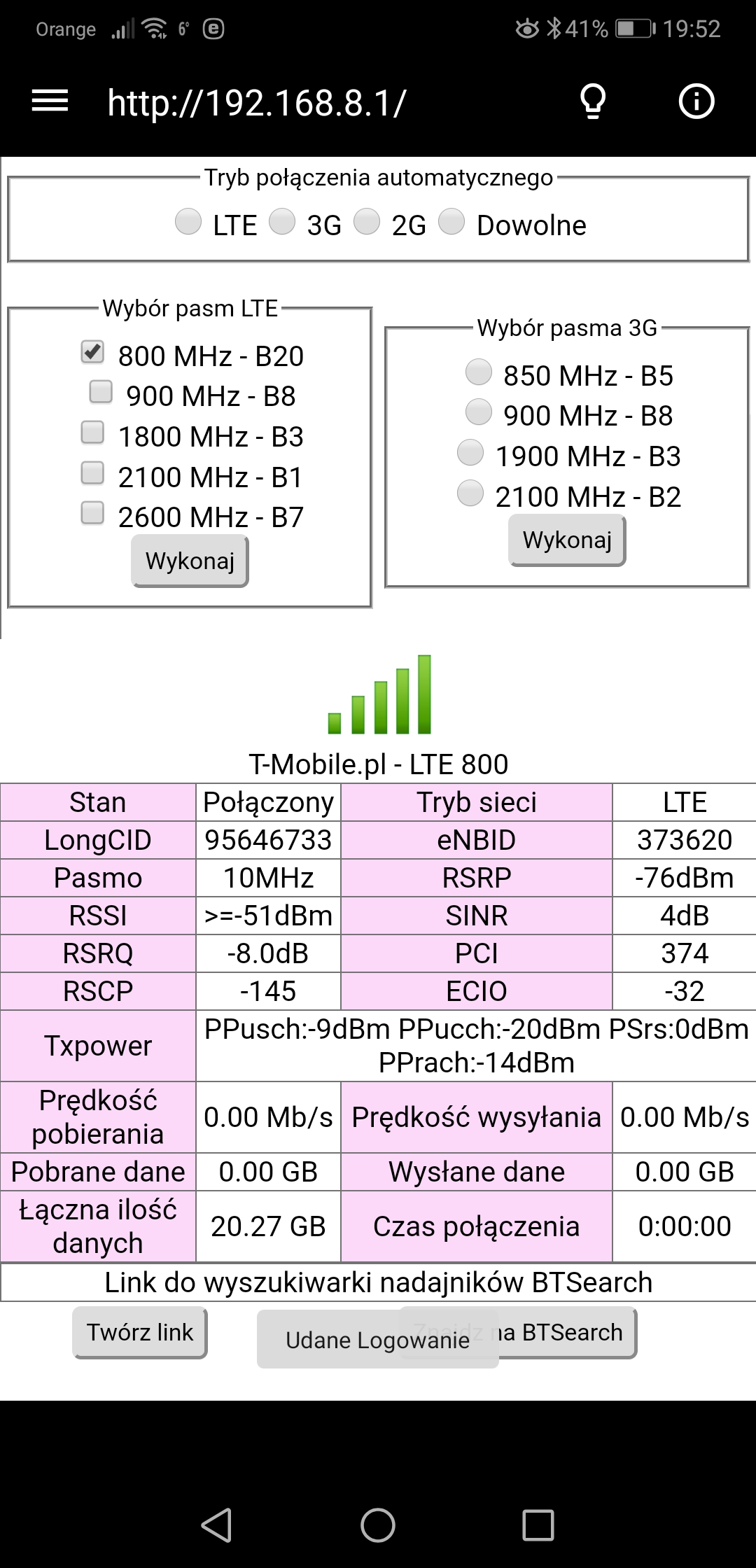

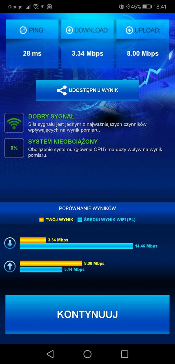

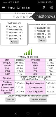

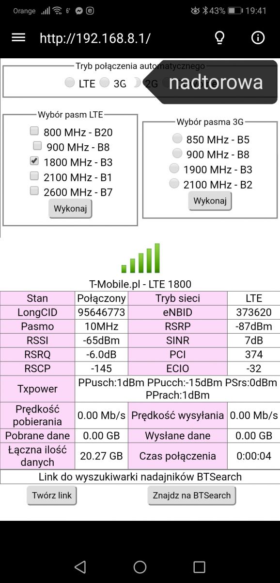

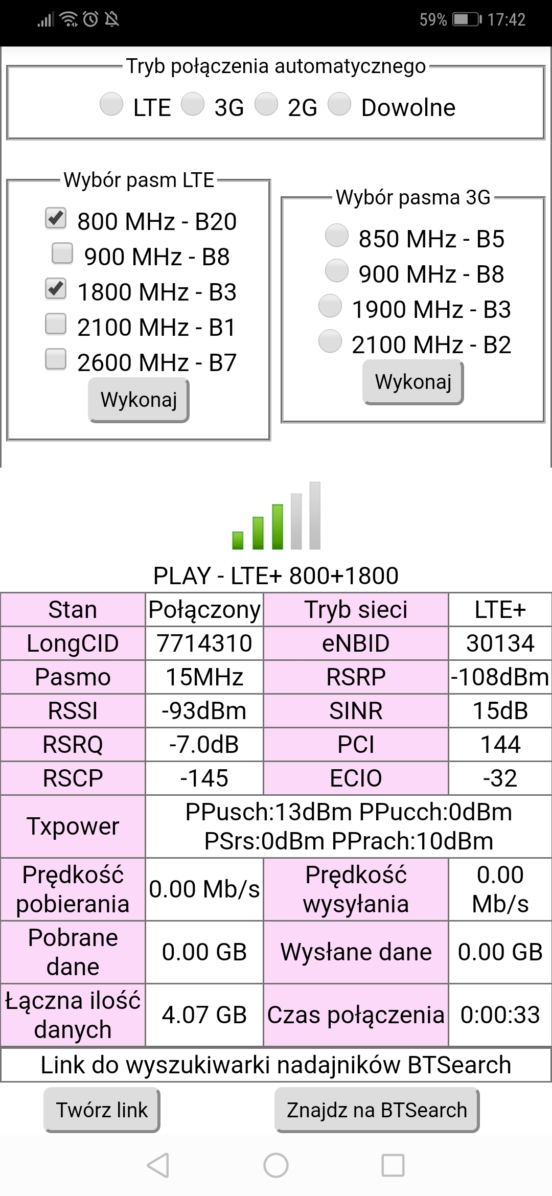

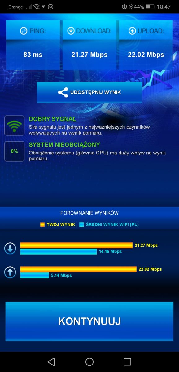

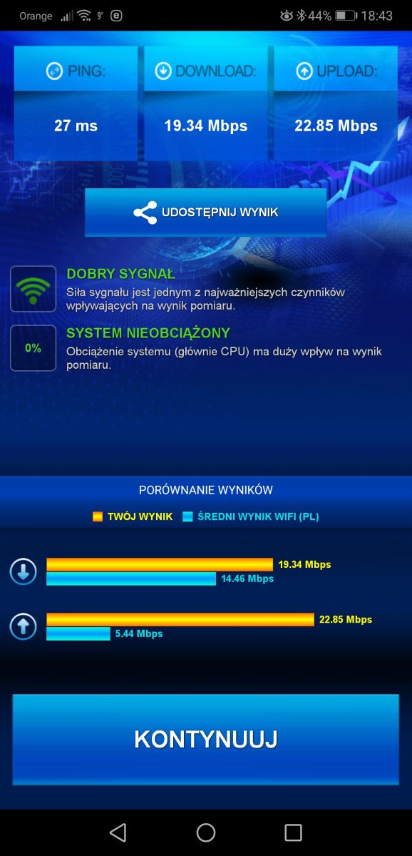

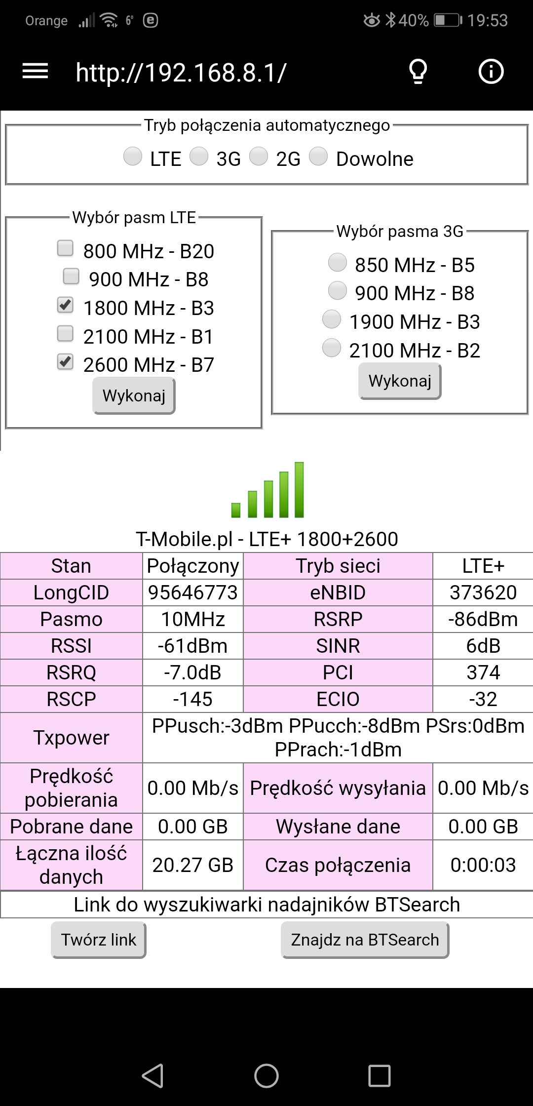

    Measure the signal parameters on LTE1800 and LTE800 and s LTE1800 + 800 and show screenshots and speed tests for them.

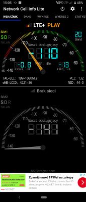

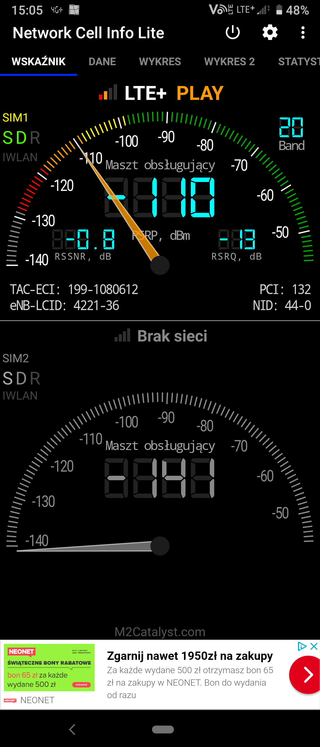

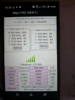

  • #34 18287964
    WarHawk480

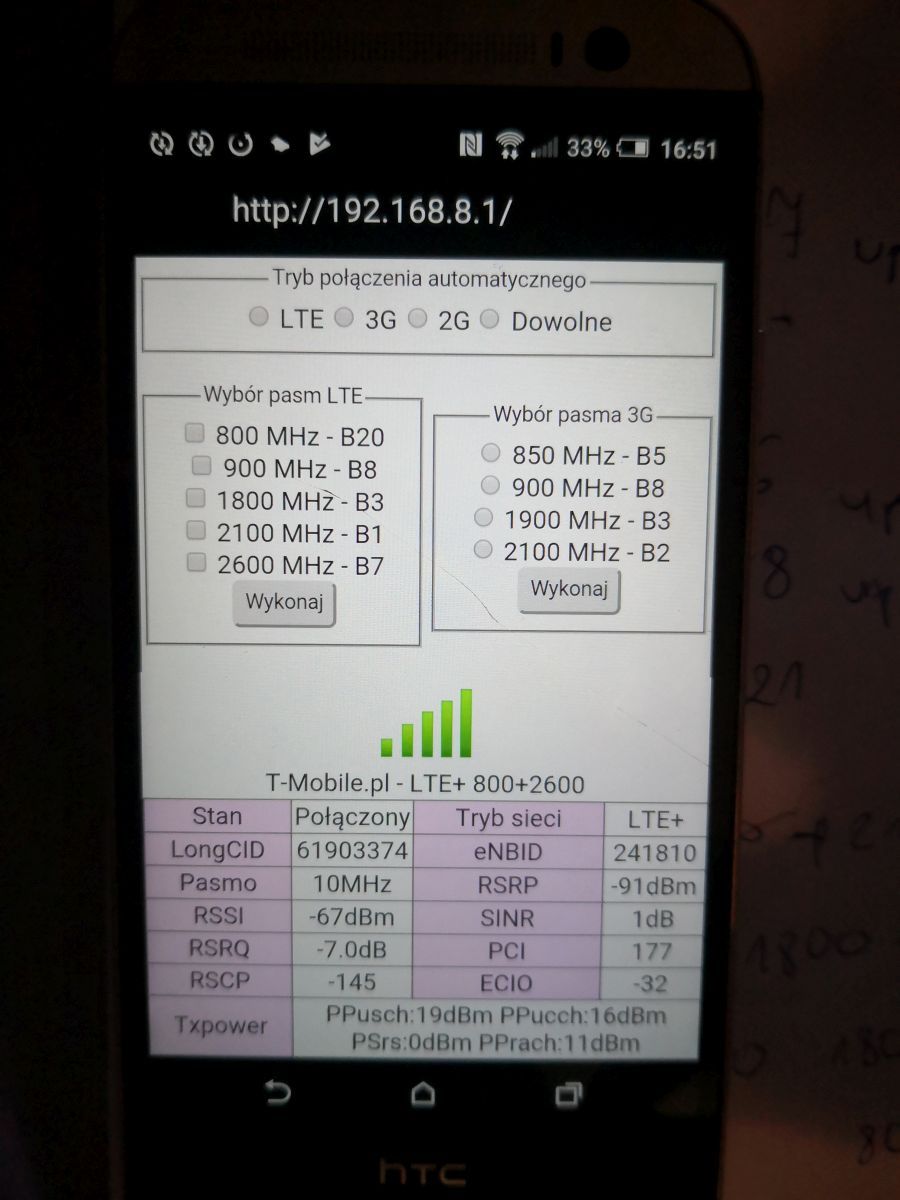

    1800 + 800 : 49 /12
    1800 : 43 / 8
    800 : 10 / 8
    • Searching for Huawei B535-232 Antenna - Need Help Finding a Compatible Model Screenshot_20191119_174534_com.nasser.huaweimanager.jpg (581.67 KB) You must be logged in to download this attachment.
    • Searching for Huawei B535-232 Antenna - Need Help Finding a Compatible Model Screenshot_20191119_174419_com.nasser.huaweimanager.jpg (559.41 KB) You must be logged in to download this attachment.
    • Searching for Huawei B535-232 Antenna - Need Help Finding a Compatible Model Screenshot_20191119_174255_com.nasser.huaweimanager.jpg (587.85 KB) You must be logged in to download this attachment.
  • #35 18288032
    matek451
    Posts: 31263
    Help: 4352
    Rate: 5810
    Signal parameters at 800MHz inside good, shown earlier n this band outside has a very good signal. to sum up, you need an antenna working at 1800-2100MHz, at 800MHz it will transfer the signal consumption to the outside, but it will be enough. it will amplify the signal on LTE1800, you will use it with LTE1800 + 800 and in the future also with LTE2100 and LTE1800 + 2100 aggregation when LTE2100 band appears on BTS. B535 supports LTE1800 + 2100 aggregation. on LTE2600, you do not have to count on such a station, it is a typical rural PLay station, so ultimately it should receive LTE1800, LTE2100 and LTE800. Antenna https://www.cybertech.com.pl/p188,antena-dualna-lte-4g-15dbi-mimo-do-huawei-b535.html, or if you want to use LTE2600 too, this is https: // www .cybertech.com.pl / p173, antenna-dualna-lte-a-4g-17dbi-despite-1800-2600mhz.html, has the highest gain at 2600MHz, lower at 1800 / 2100MHz and at 800MHz it will transfer the signal consumption outside. cables up to 10m, SMA connectors on the cable.

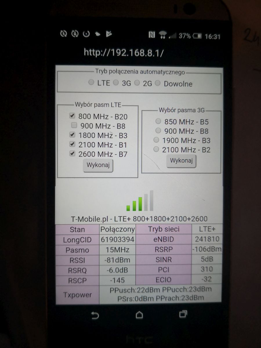

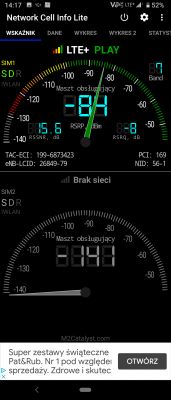

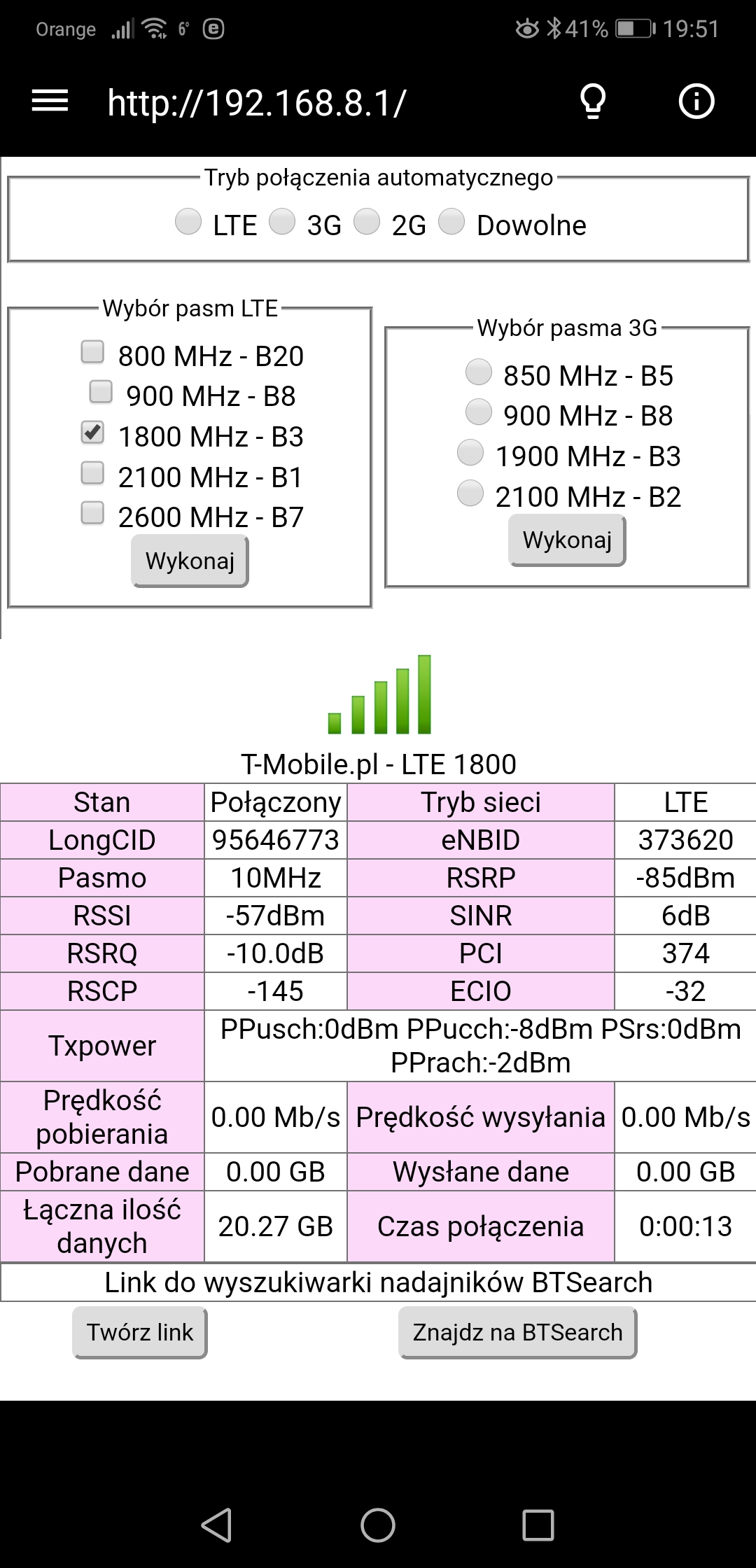

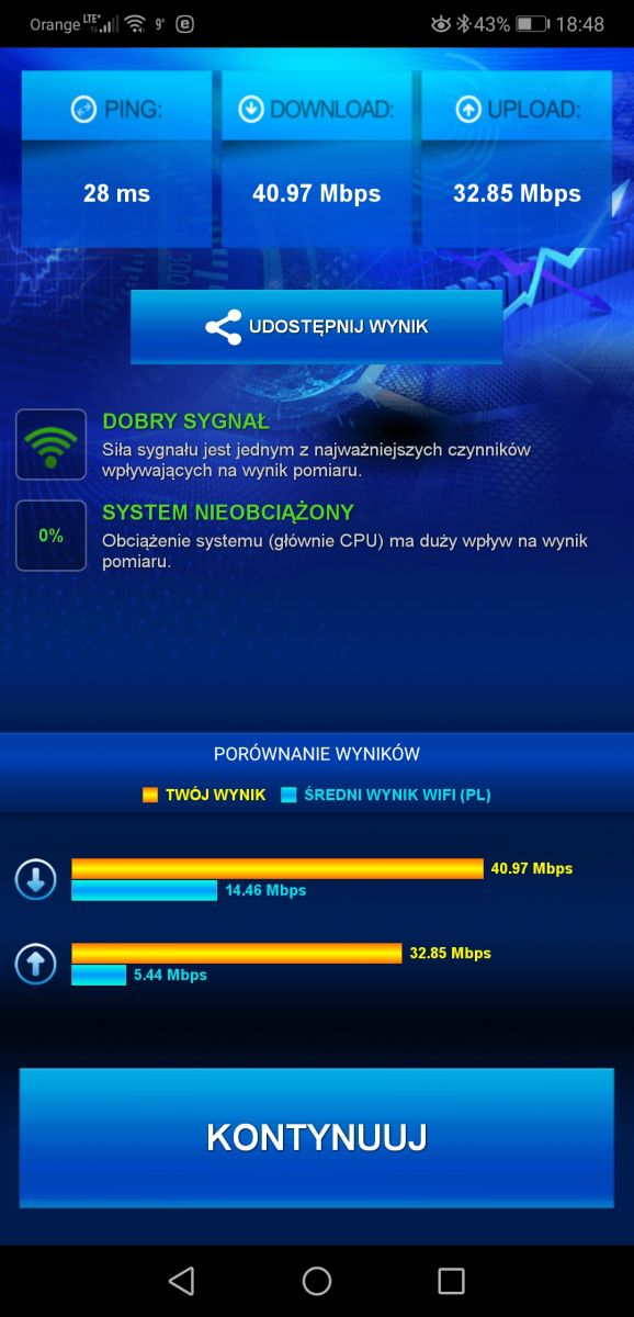

  • #36 18307886
    kast23

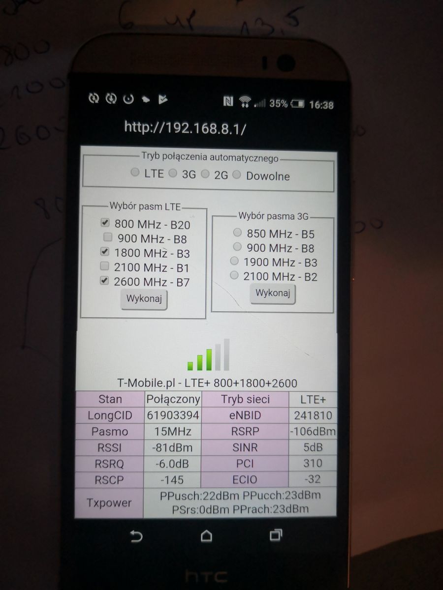

    So the address: Przewłoka ul. Prusa
    800 - 7/10
    1800 - 6/6
    2100 - 8/14
    2600 - 21/1
    1800 + 2600 - 22 / 1.5
    800 + 1800 + 2600 - 26/2
    800 + 1800 - 16/12
    800 + 2600 - 20/5
    Searching for Huawei B535-232 Antenna - Need Help Finding a Compatible Model Searching for Huawei B535-232 Antenna - Need Help Finding a Compatible Model Searching for Huawei B535-232 Antenna - Need Help Finding a Compatible Model Searching for Huawei B535-232 Antenna - Need Help Finding a Compatible Model Searching for Huawei B535-232 Antenna - Need Help Finding a Compatible Model Searching for Huawei B535-232 Antenna - Need Help Finding a Compatible Model Searching for Huawei B535-232 Antenna - Need Help Finding a Compatible Model Searching for Huawei B535-232 Antenna - Need Help Finding a Compatible Model
    What bandwidth and what to do for this internet to get normal speeds as for LTE with Tmobile
    Huawei 4G Router 3 Pro B535 - I have no idea why it connects to a further BTS

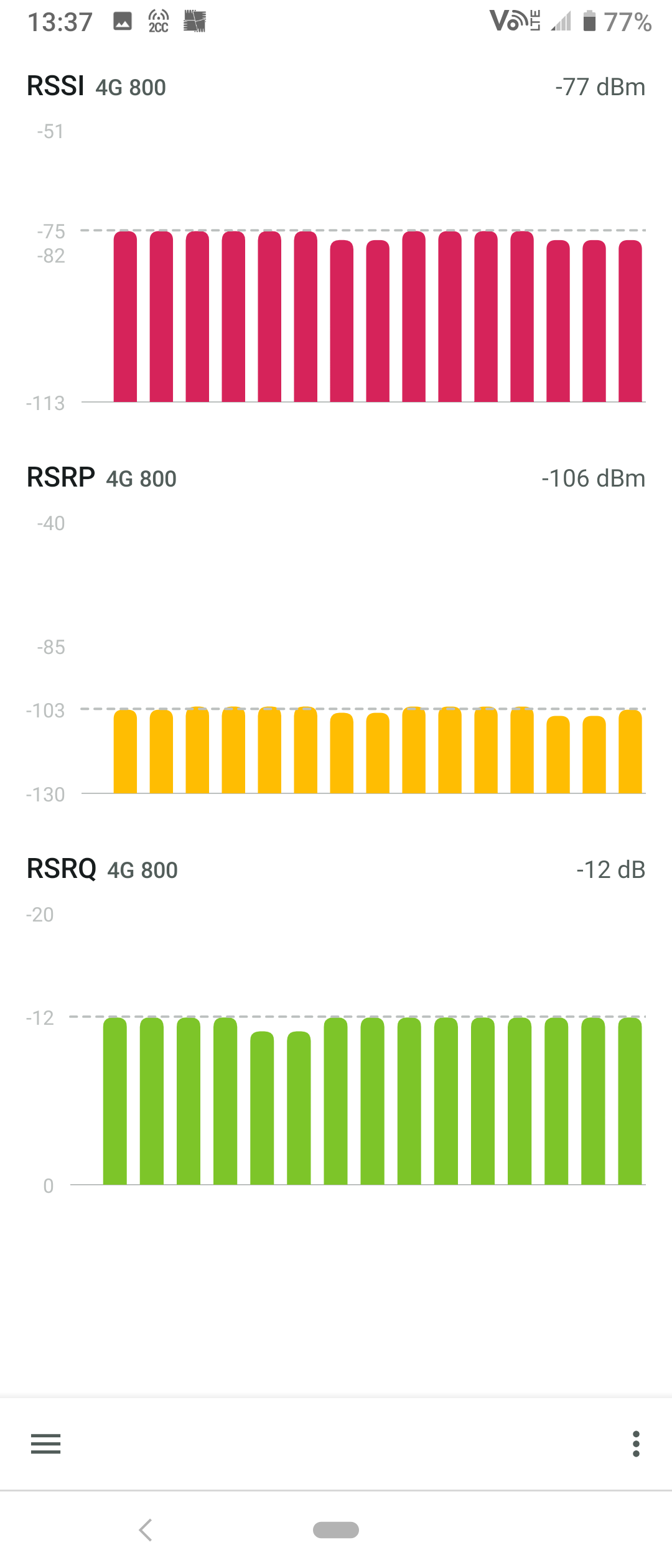

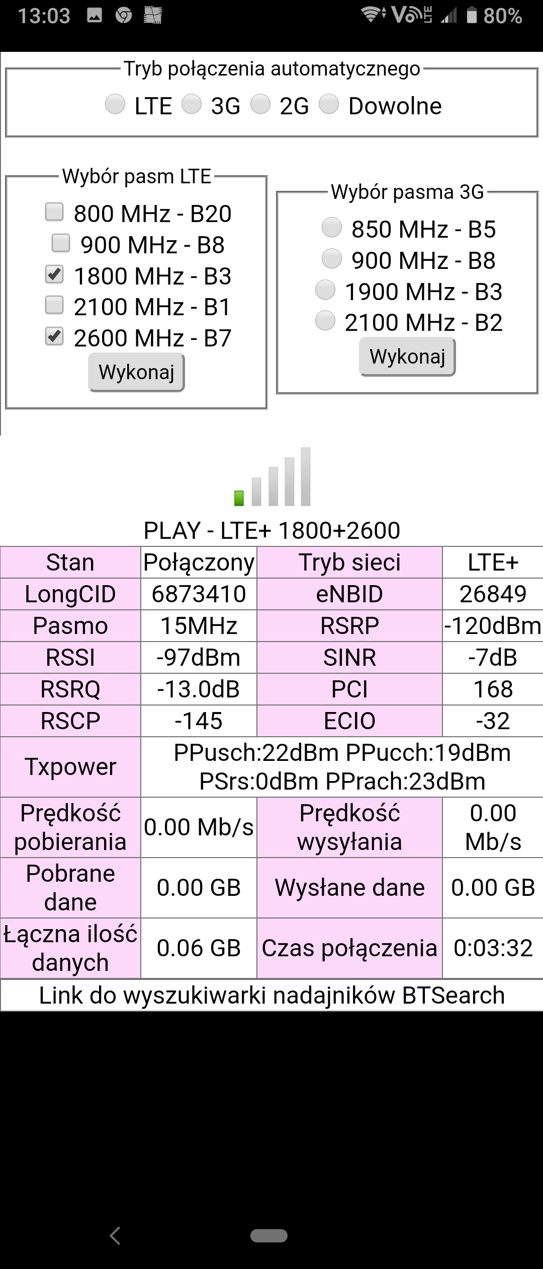

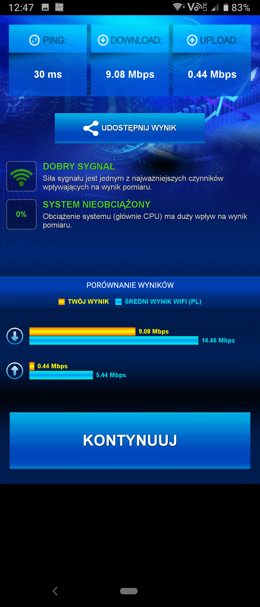

  • #37 18336879
    Driversix
    Posts: 6
    Hello. I have a huawei b535-7bdb router and I would like to know what band to choose the external antenna for. Location Łosice province. Mazowieckie, there are two transmitters at ul. Bialska 67b, the mast at the cemetery and ul. Czarkowskiego 8 on the chimney of a dairy plant. Below are screenshots of Network Cellem and SpeedTestem measurements.
    The first two drops are Bialska Street, the next two are Czarkowskiego Street and the last two are inside the house, looking from the left.
  • #38 18336955
    matek451
    Posts: 31263
    Help: 4352
    Rate: 5810
    Tests should be performed using https://play.google.com/store/apps/details?id=cz.mroczis.netmonster&hl=pl and show screenshots, under BTS, the connection in the aggregation of LTE bands with LTE2600 as basic plus others. Speeds from Czarkowski better. At home, connection from Czarkowski but weak signal on LTE800 plus other aggregation but probably with a residual signal. Wrong choice of B535, apparent savings of PLN 200, i.e. not choosing b715 results in the inability to use 3 CC CA from BTSs operating on 4 LTE bands. In such a location, where there is LTE2600 on BTS, B715 is selected. BTS Czarkowski is a 5g Ready node on optical fiber, from it a 1107Mb / s radio link to the one at Bialska. Take a test outside at home and show the results. B535 should work with Hmanager, LTE2600, LTE1800 and LTE2100 band tests and then 2 CC CA LTE2600 + 1800 and LTE2600 + 2100. On the B535 you will not fully use the BTS's capabilities, on the B715 you would aggregate LTE2600 + 1800 + 2100. Antenna probably at 1800-2600MHz, how far are you from BTS Czarkowski?

    Show Netmonster screen on phone, test outside. It will show what bands are available and what signal parameters on LTE capacitive bands. Plus speedtest. Who recommended this B535 to you?

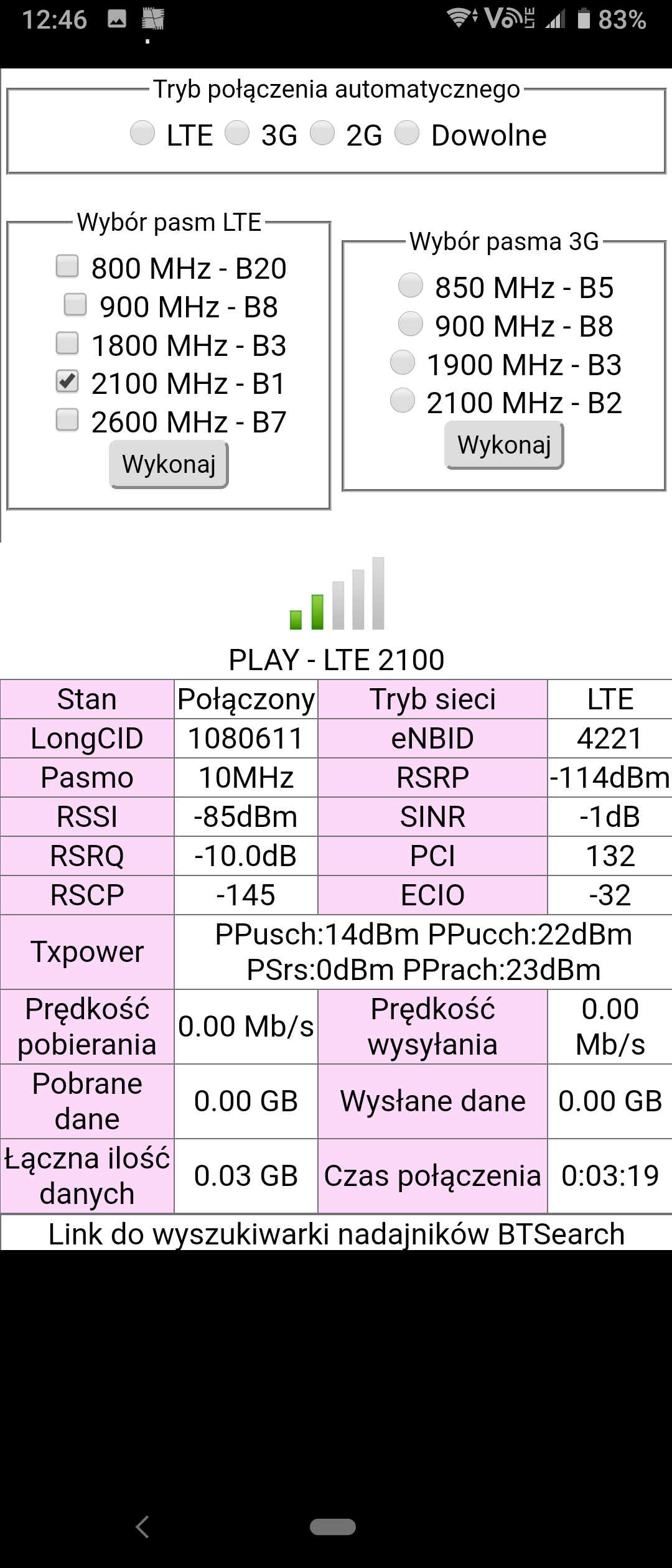

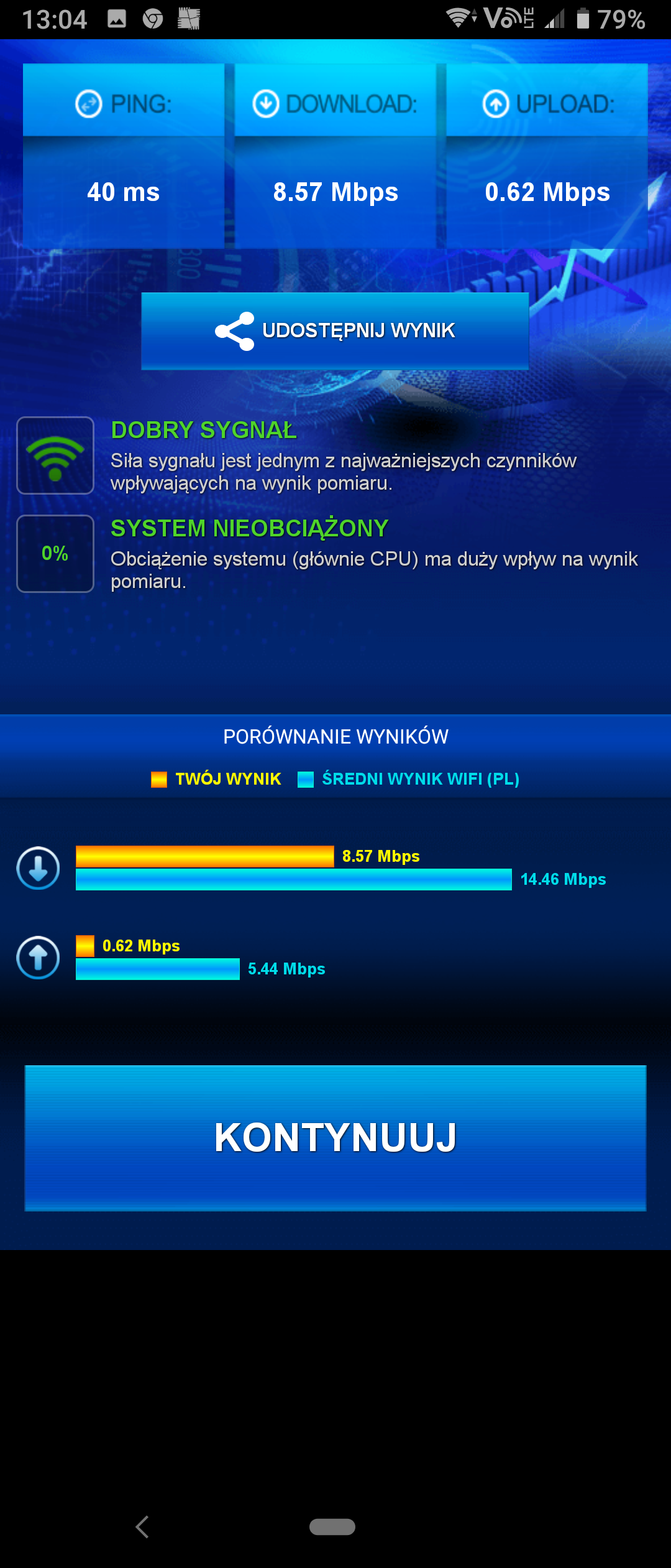

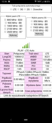

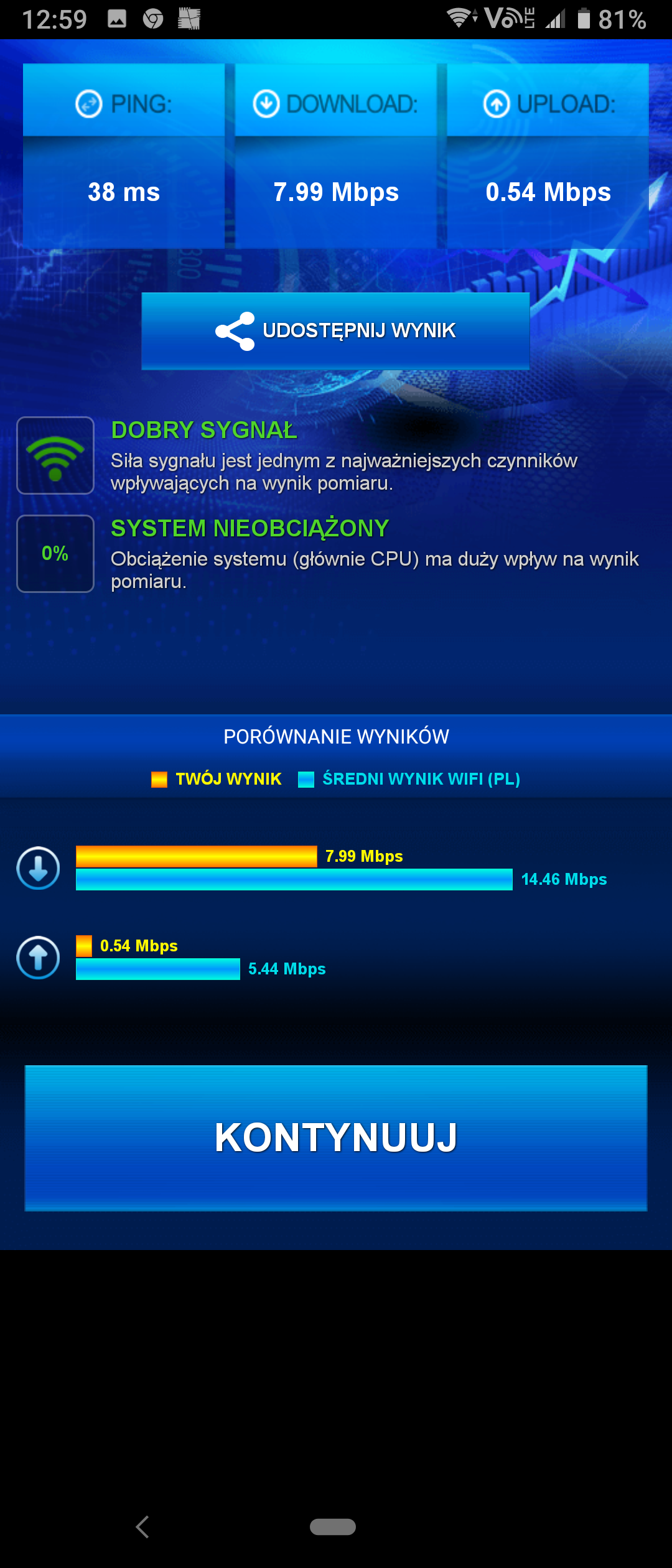

  • #43 18338922
    Driversix

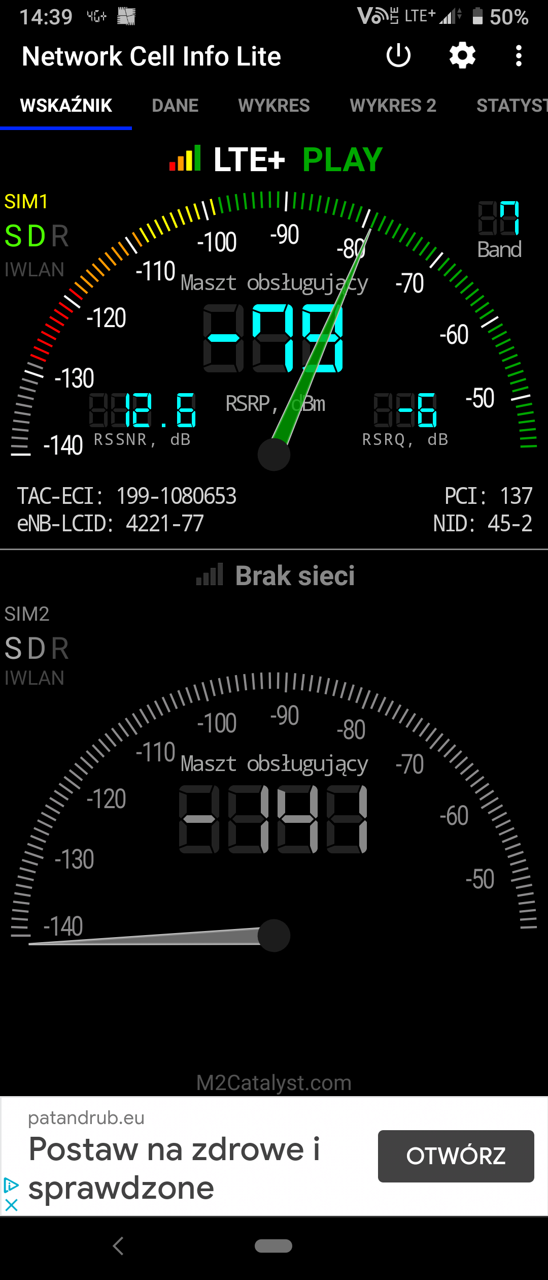

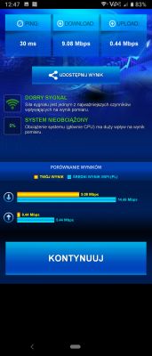

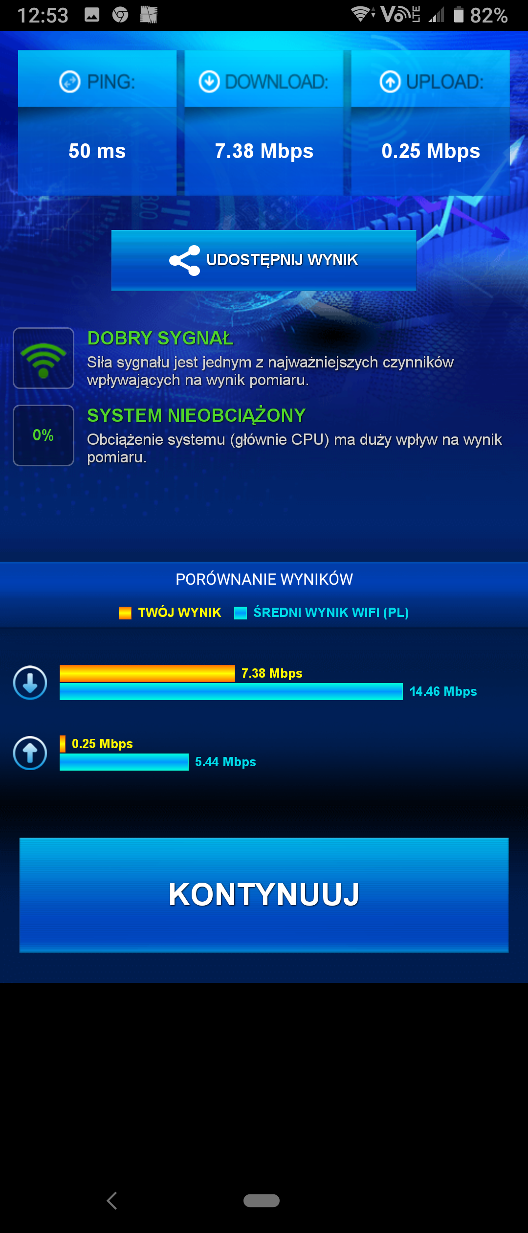

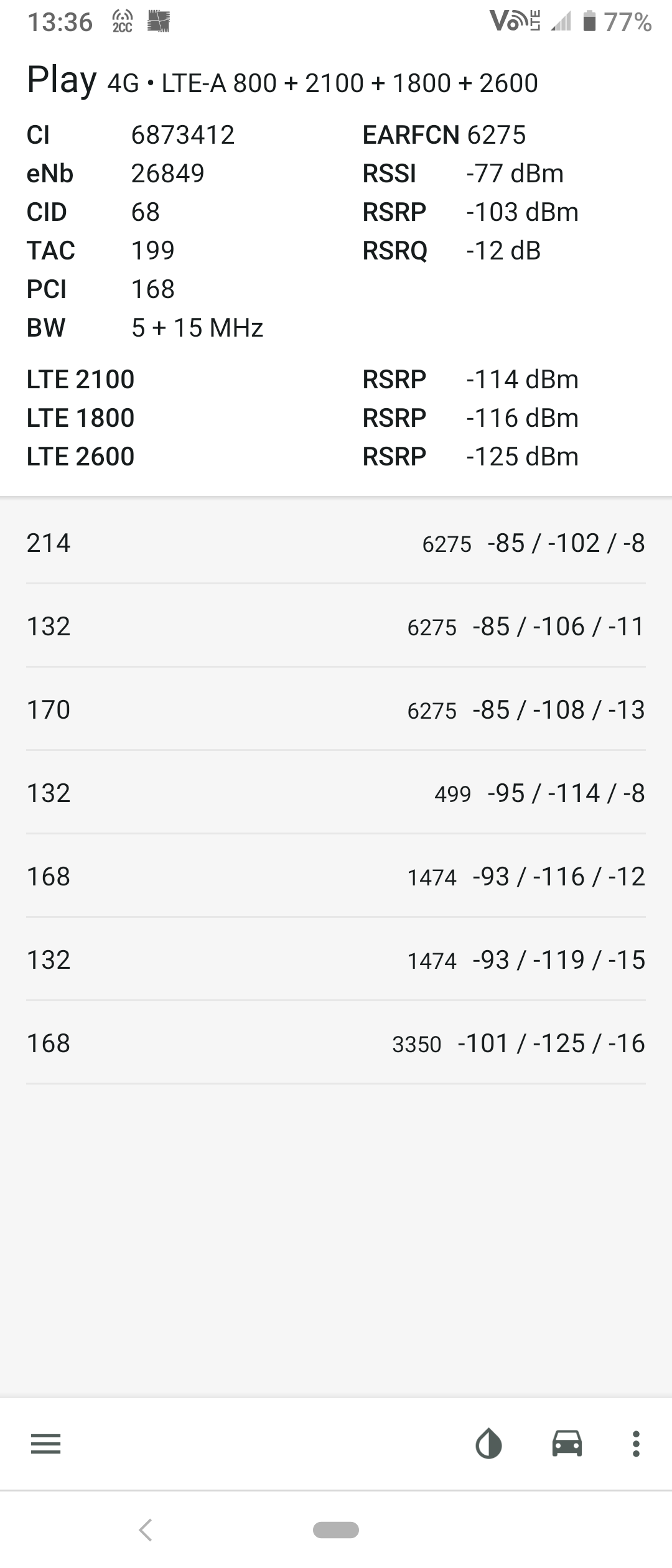

    Posts: 6

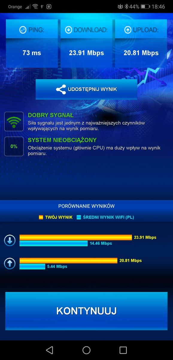

    Tests with net monstera hmamager and speedtest

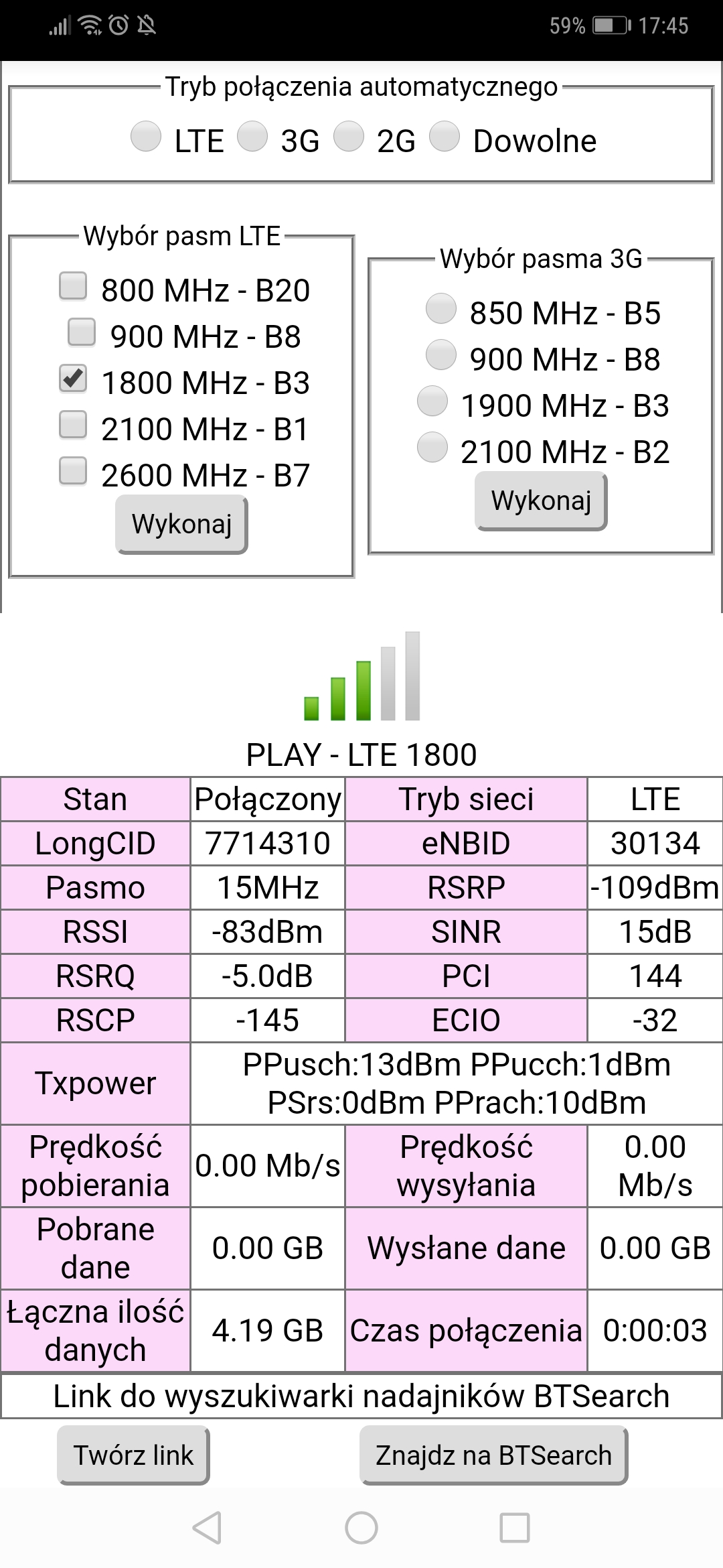

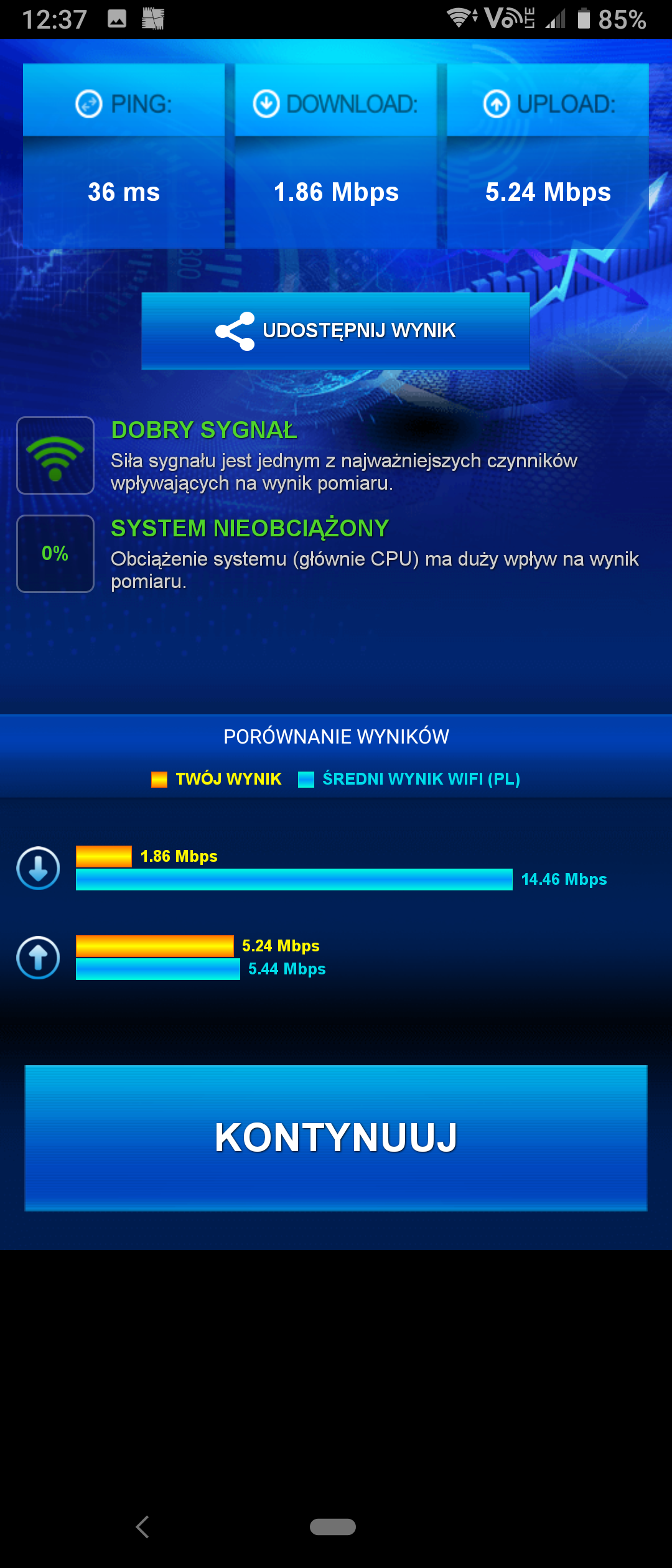

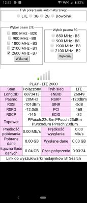

    Searching for Huawei B535-232 Antenna - Need Help Finding a Compatible Model Searching for Huawei B535-232 Antenna - Need Help Finding a Compatible Model Searching for Huawei B535-232 Antenna - Need Help Finding a Compatible Model Searching for Huawei B535-232 Antenna - Need Help Finding a Compatible Model Searching for Huawei B535-232 Antenna - Need Help Finding a Compatible Model Searching for Huawei B535-232 Antenna - Need Help Finding a Compatible Model Searching for Huawei B535-232 Antenna - Need Help Finding a Compatible Model Searching for Huawei B535-232 Antenna - Need Help Finding a Compatible Model Searching for Huawei B535-232 Antenna - Need Help Finding a Compatible Model Searching for Huawei B535-232 Antenna - Need Help Finding a Compatible Model Searching for Huawei B535-232 Antenna - Need Help Finding a Compatible Model Searching for Huawei B535-232 Antenna - Need Help Finding a Compatible Model Searching for Huawei B535-232 Antenna - Need Help Finding a Compatible Model Searching for Huawei B535-232 Antenna - Need Help Finding a Compatible Model
    I am sorry that the screens are not separated, the diagram is from the left the screen from hmamager + speedtest

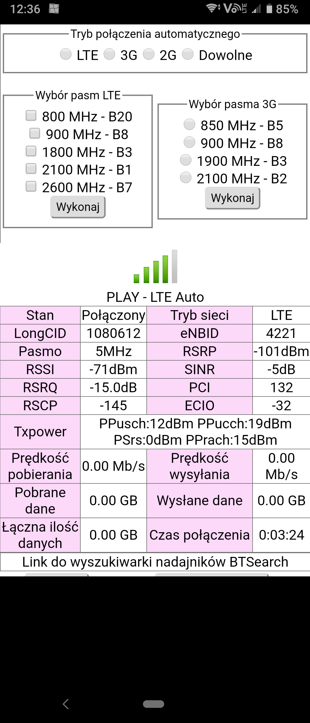

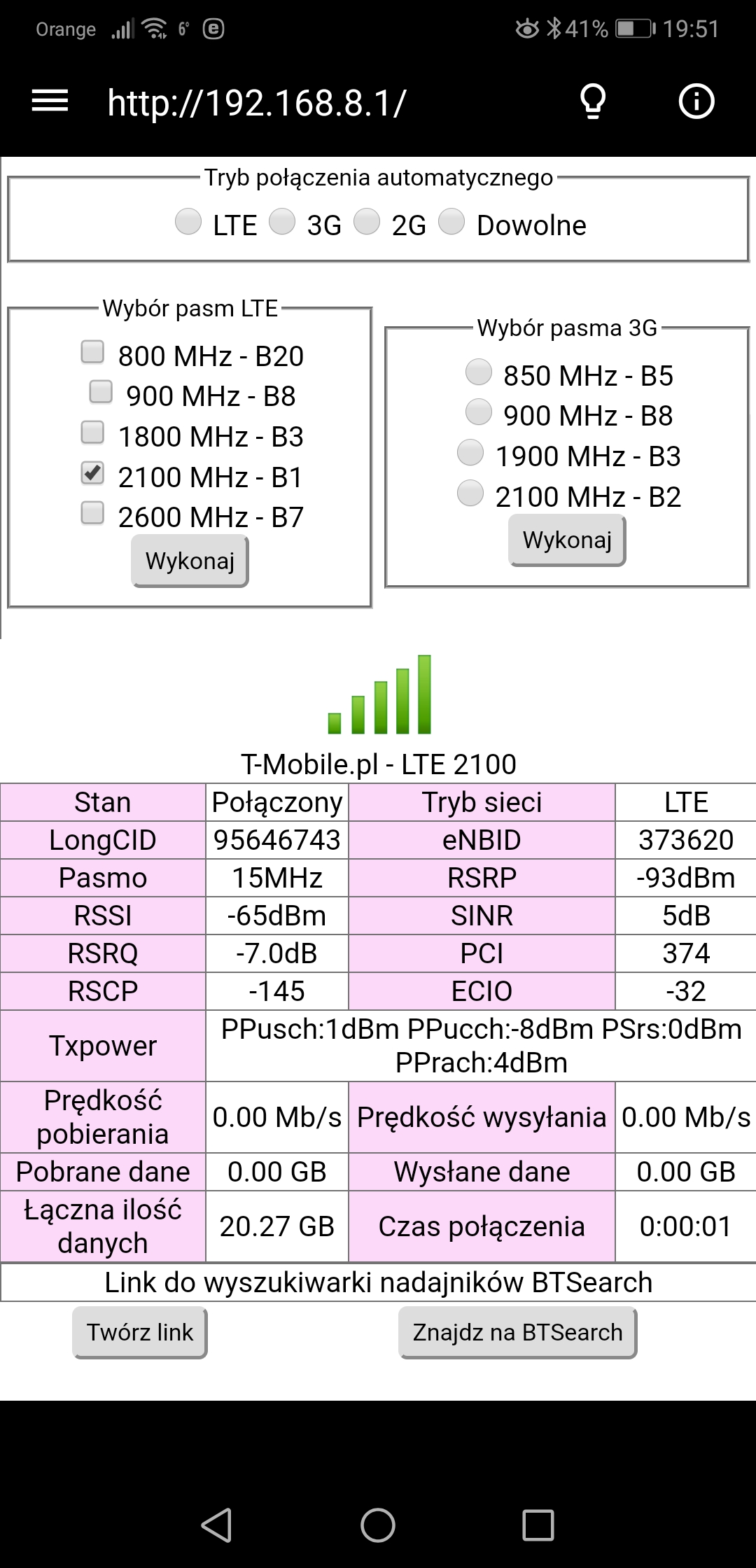

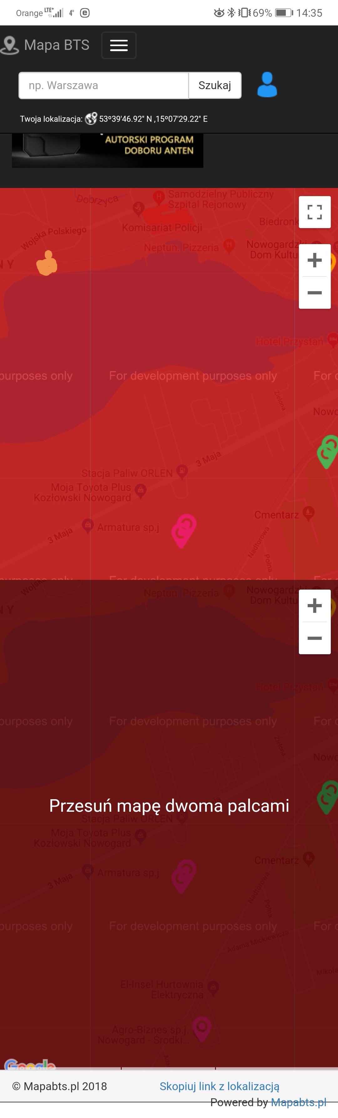

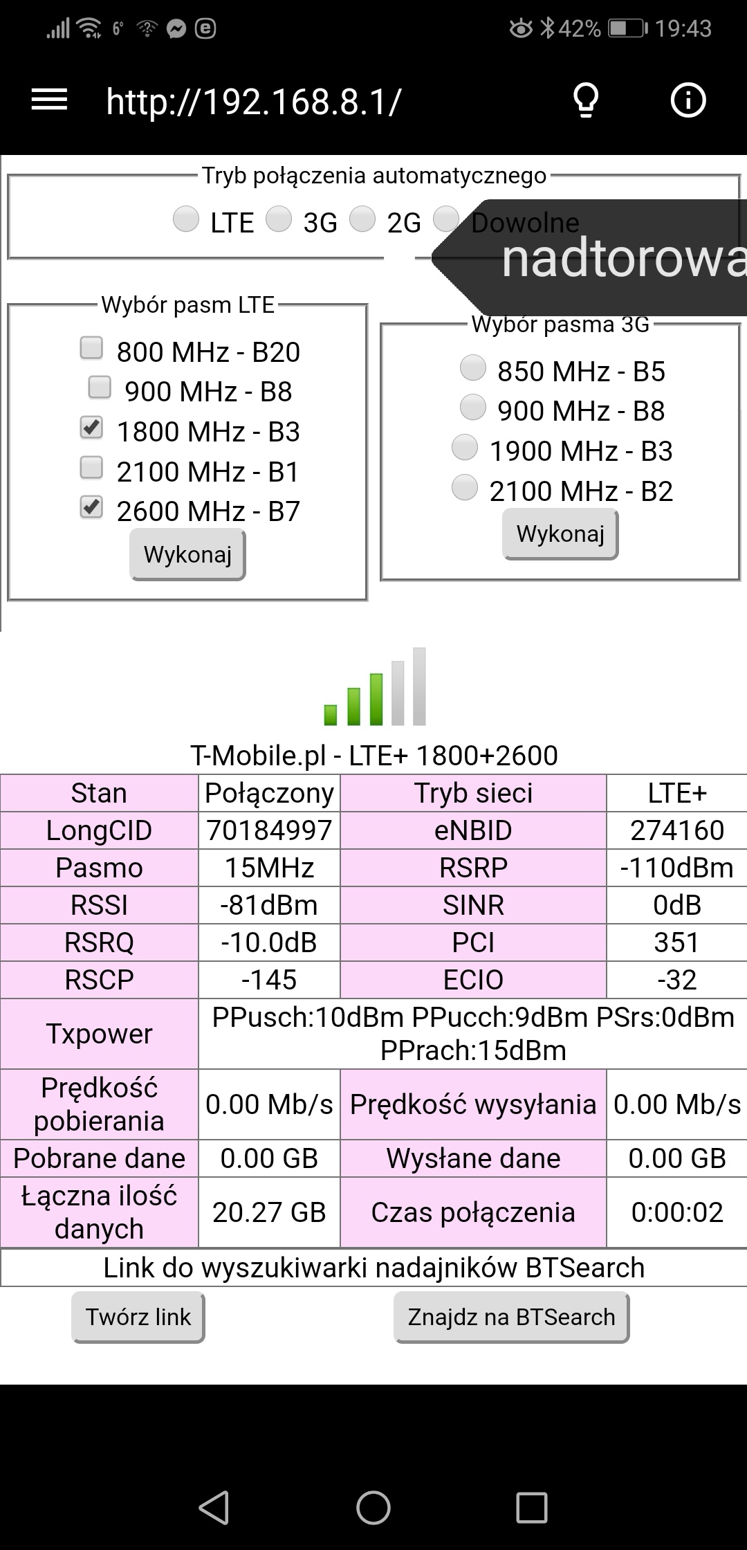

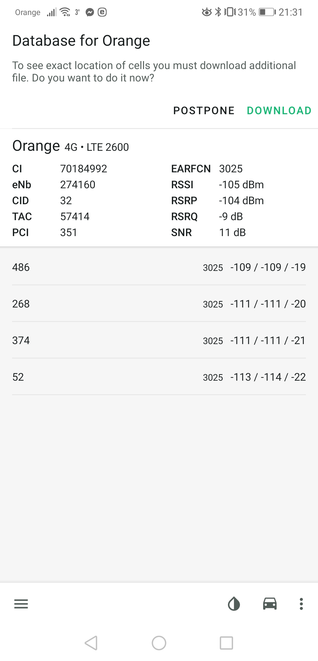

    Gentlemen, colleagues! I need help from you guys. Well, I have a router like in the description and I have a few questions. Well, I use it in an apartment in a block of flats and it's great (range). I have Internet from T-Mobile, magenta business offer - no data limit, with a speed of up to 60 Mbps. In the block, the range and speed range from 35 to 60. But soon I will move home and there the range is 2.3 lines, while the speed varies between 30-50. I have the following inquiries:
    1. What kind of external antenna could I use?
    2. Could I improve the range of my home wifi antenna?
    I am asking for such simple answers, because I am a bit of a layman in this field.
    Attached I am sending a map where BTS is, and I live on Wojska Polskiego Street, where there is an orange dot. My zip code is 72-200, Nowogard. [url=https://obrazki.elektroda.pl/9392702000_1576331133.jpg]
    • Searching for Huawei B535-232 Antenna - Need Help Finding a Compatible Model Screenshot_20191214_144441.jpg (334.32 KB) You must be logged in to download this attachment.
  • #45 18339059
    matek451
    Posts: 31263
    Help: 4352
    Rate: 5810
    You clicked on the topic in which you described what to use and how to perform tests on the B535 and such information is needed, not dashes, and this stupid map from an electro-waste dealer pretending to be antennas. BTS Networks at PL. Wolności 3 should be modernized and refarmed 1800 / 2100MHz and LTE2600, LTE2100, LTE1800 and LTE800 T-mobile on it. But what matters is where you want to move and the tests there.

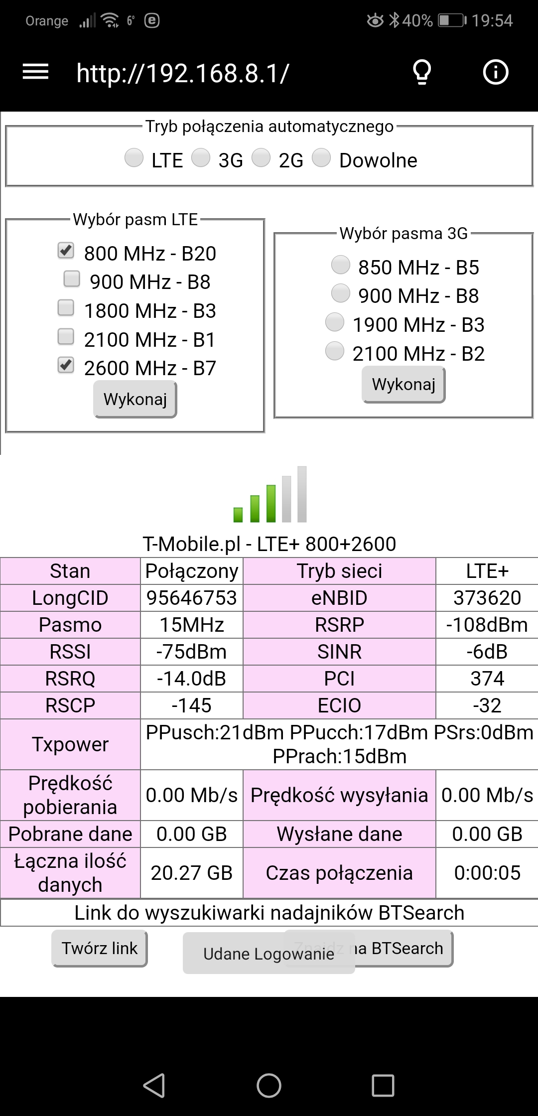

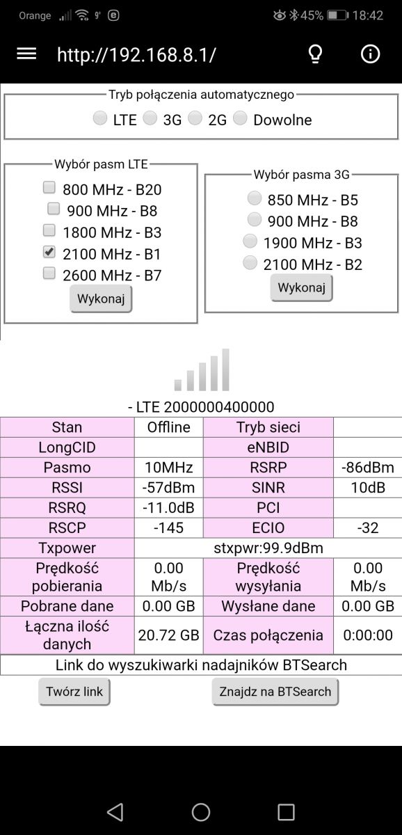

  • #46 18339313
    john.fred
    Posts: 105
    Rate: 26

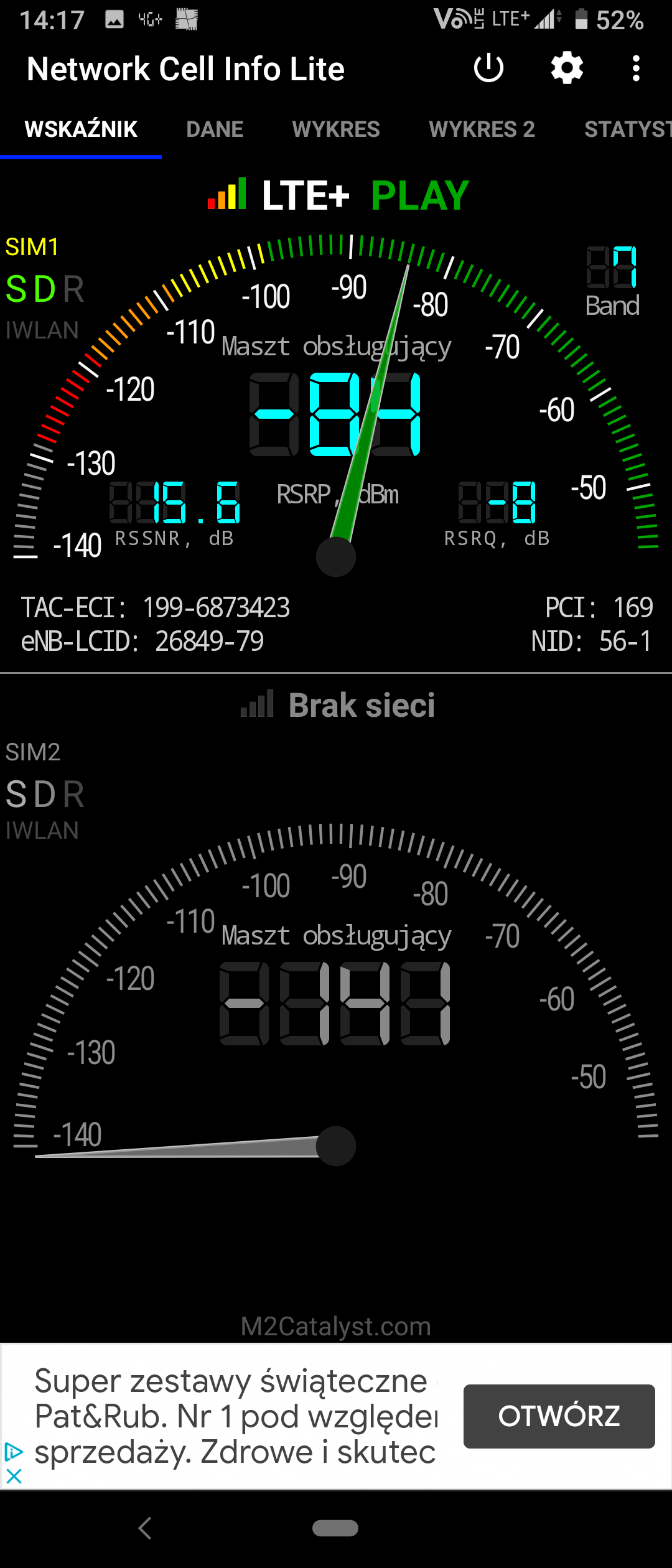

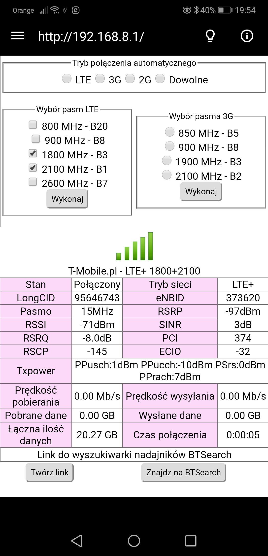

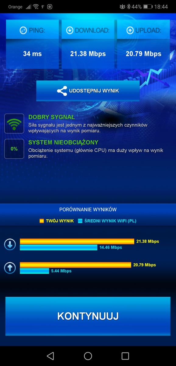

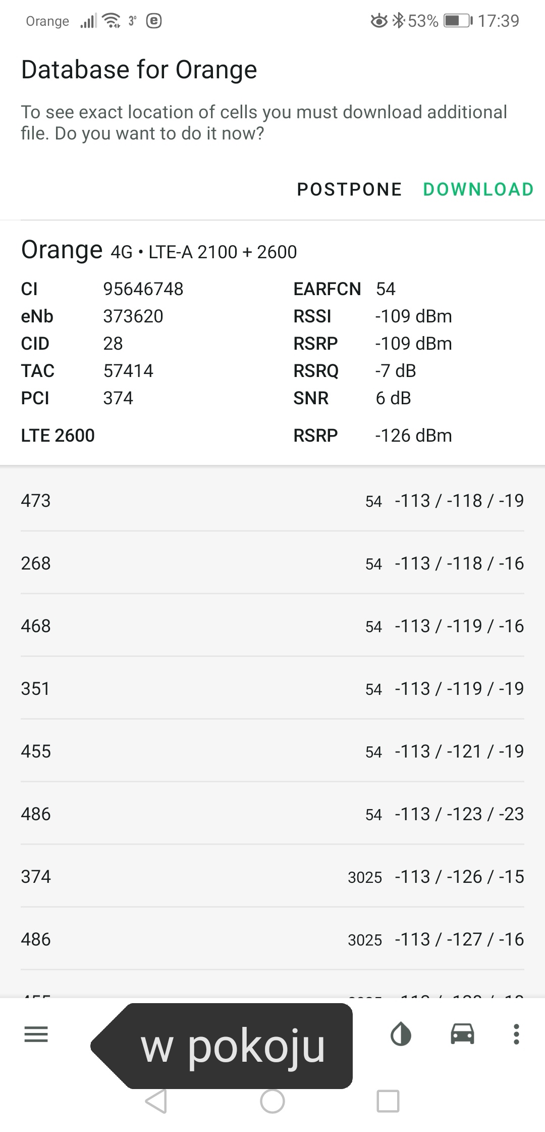

    I did two tests of the Netmonster app. Pictures attached. One is made indoors and the other is outside the window.
    • Searching for Huawei B535-232 Antenna - Need Help Finding a Compatible Model Screenshot_20191214_174436.jpg (230.59 KB) You must be logged in to download this attachment.
    • Searching for Huawei B535-232 Antenna - Need Help Finding a Compatible Model Screenshot_20191214_174402.jpg (189.88 KB) You must be logged in to download this attachment.
  • #47 18339729
    matek451
    Posts: 31263
    Help: 4352
    Rate: 5810
    The phone connects to LTE2100 + 2600 from the BTS at Nadtorowa 12, the signal inside on the LTE210 is very weak and on the LTE2600 it is residual. The same LTE2600 outside, but the signal is better. What are the speeds in this situation?
    @Driversix, LTE80 not worth attention, Play uses capacitive bands, LTE2600 is 20MHz wide, LTE1800 is 15MHz and LTE2100 is 10MHz. Directional antenna working at 1800-2600MHz will allow you to use each of them and aggregation LTE2600 + 1800, LTE2600 + 2100 or LTE2100 + 1800. There are two BTSs with these bands, so you will force each of them one by one by setting the antenna to them, as long as they are in different directions from you. You will choose a better and optimal 2 lte bands for aggregation from it.

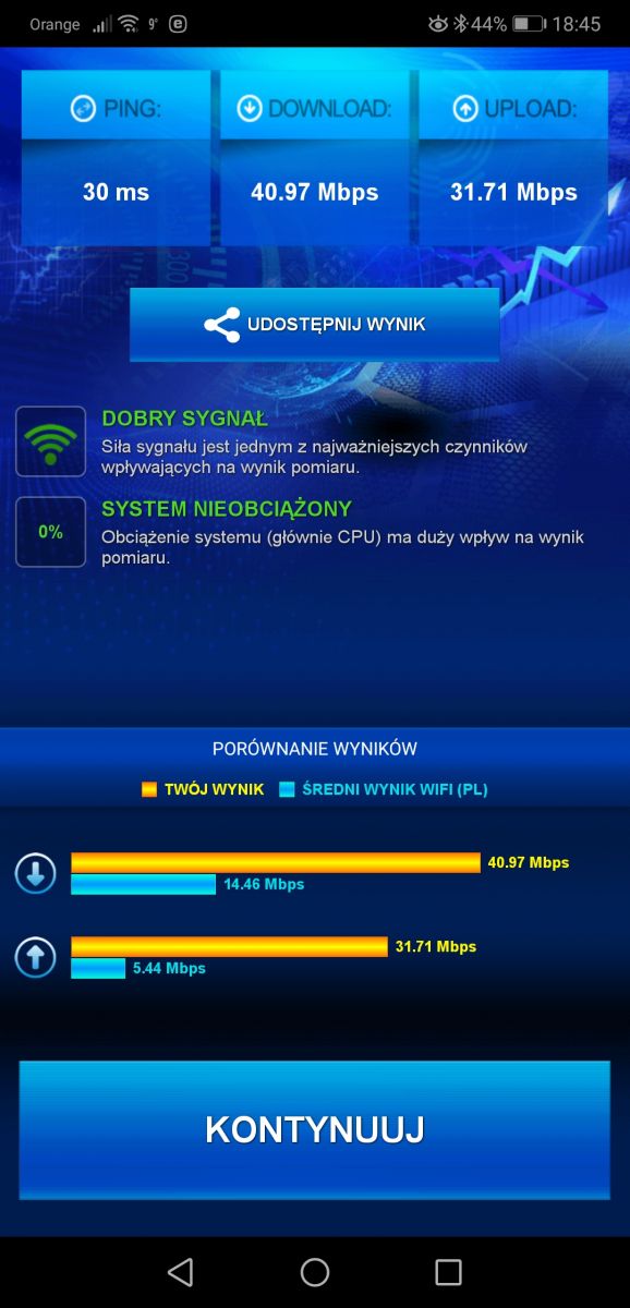

    Outdoor: 38 to 45 Mbps
    Inside: 31 to 35 Mbps
    I took a few measurements, they stayed in this discrepancy.

    These were tests carried out at the future location of the Polish Army. The town of Nowogard, 72-200.
    Now he is in a block of flats, in an apartment. I do not know if it will do anything, but I am sending a screen from the tests in the apartment (in the old place) in Nowogard a bit further on Kościuszko Street.
    Speed 55 Mbps.

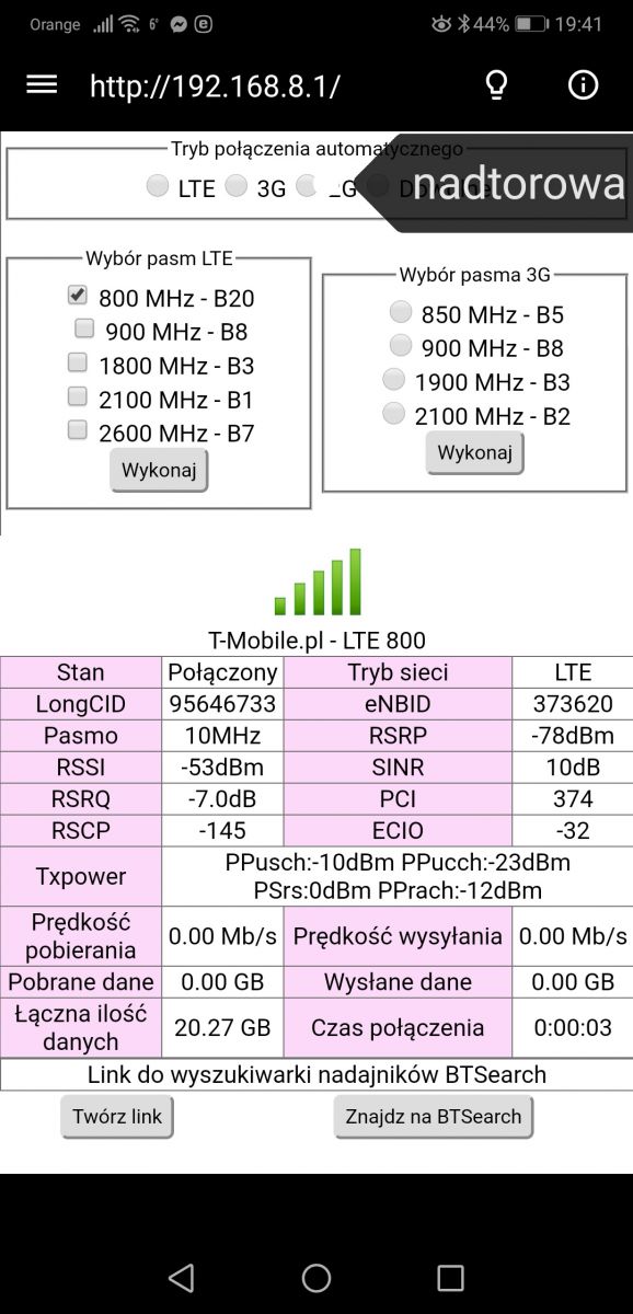

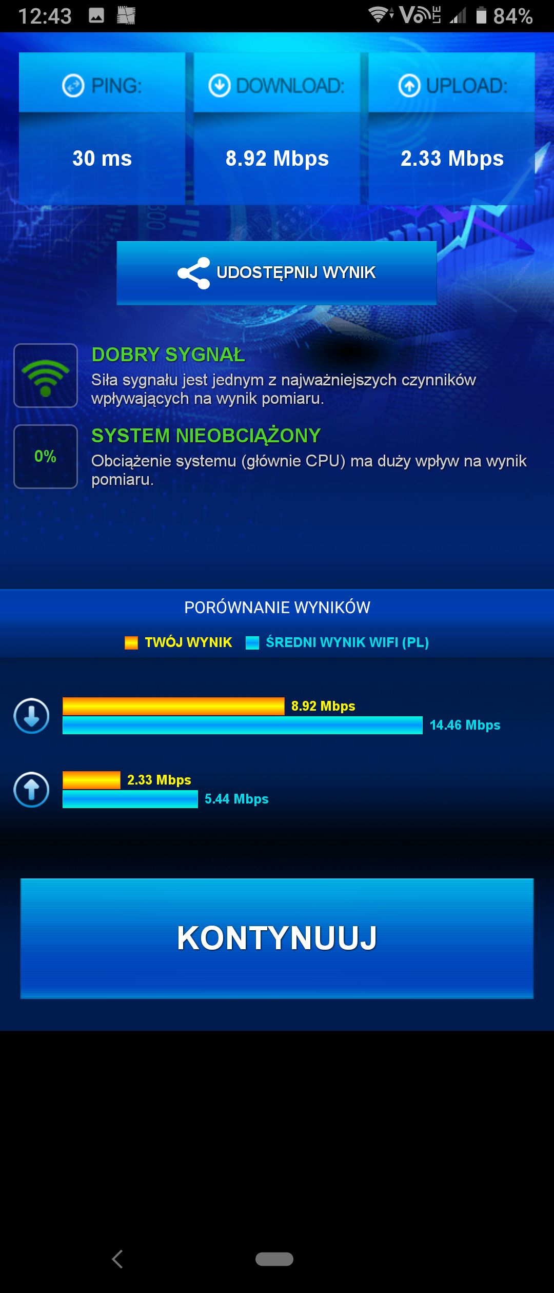

    The router will allow you to choose LTE bands and two for aggregation, but you will not choose BTS, at the beginning such tests are enough for W.Polski. router out of the window and you check LTE2600, LTE2100, LTE1800, LTE800, and then LTE2600 + 2100 and LTE2600 + 1800 aggregations. LTe2600 + 800 and LTE2100 + 1800.
  • #56 18340539
    Driversix
    Posts: 6
    Thanks to mothers451, give me a hint which antenna to choose for the 1800-2600Mhz band that works well with this router because there is a bit of it, and as you wrote earlier, I will not buy scrap metal on aledrogly.

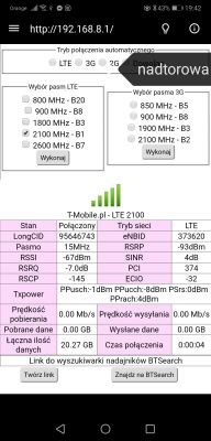

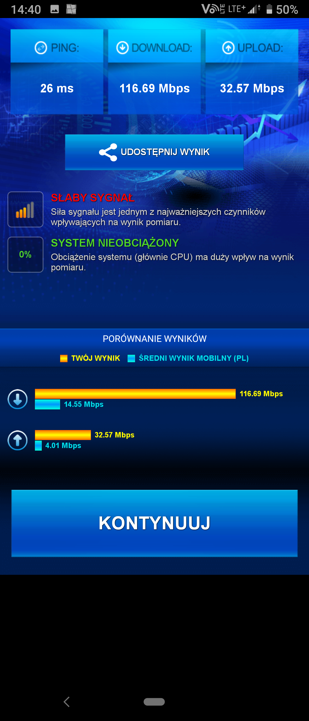

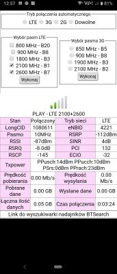

  • #58 18343609
    john.fred
    Posts: 105

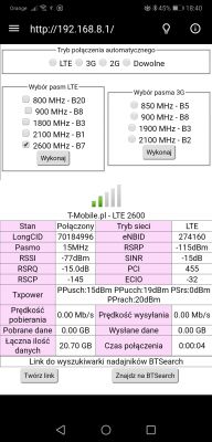

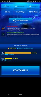

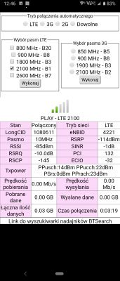

    Rate: 26

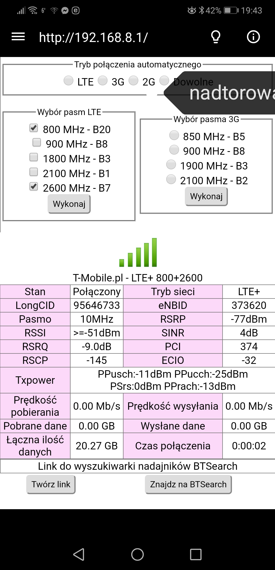

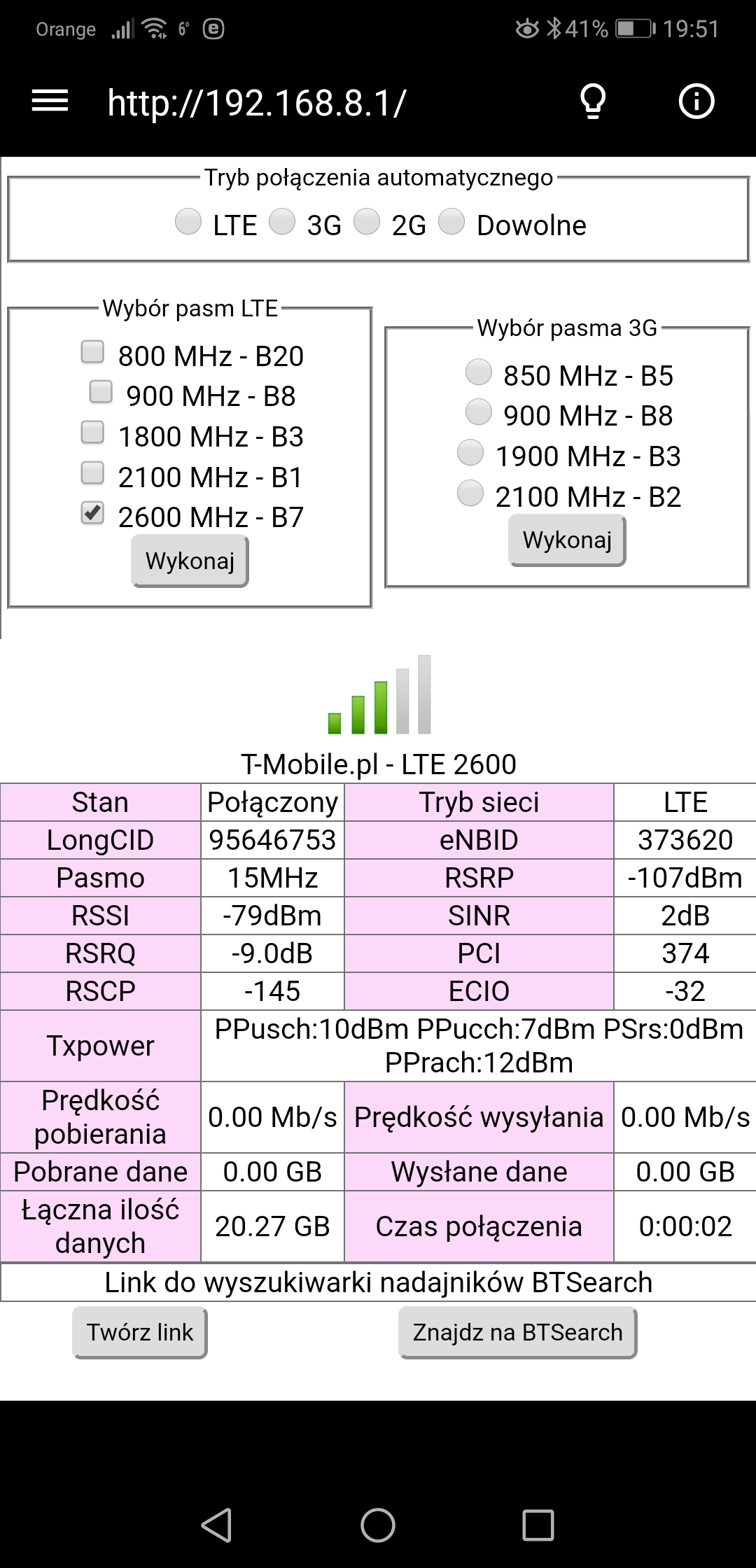

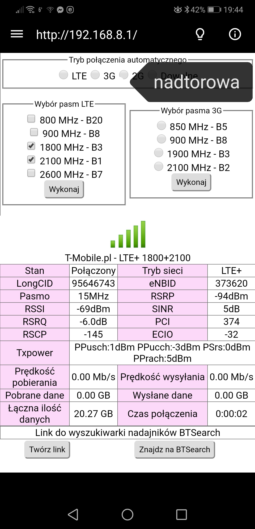

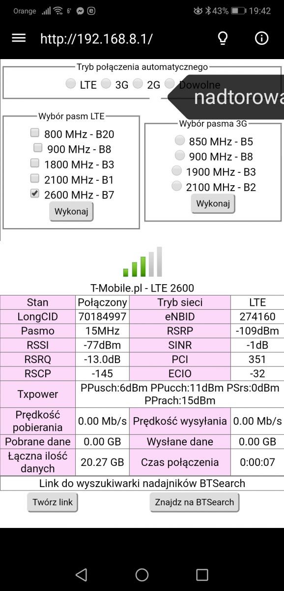

    I did the tests with the Hmanager. I attach screenshots. As instructed, I measured the direction of Nadtorowa and Plac Wolności. Pictures from Nadtorowa are described in the pictures, while those from Plac Wolności are not described. Searching for Huawei B535-232 Antenna - Need Help Finding a Compatible Model Searching for Huawei B535-232 Antenna - Need Help Finding a Compatible Model Searching for Huawei B535-232 Antenna - Need Help Finding a Compatible Model Searching for Huawei B535-232 Antenna - Need Help Finding a Compatible Model Searching for Huawei B535-232 Antenna - Need Help Finding a Compatible Model
    • Searching for Huawei B535-232 Antenna - Need Help Finding a Compatible Model Screenshot_20191216_195955.jpg (390.11 KB) You must be logged in to download this attachment.
    • Searching for Huawei B535-232 Antenna - Need Help Finding a Compatible Model Screenshot_20191216_195918.jpg (393.5 KB) You must be logged in to download this attachment.
    • Searching for Huawei B535-232 Antenna - Need Help Finding a Compatible Model Screenshot_20191216_195828.jpg (390.87 KB) You must be logged in to download this attachment.
    • Searching for Huawei B535-232 Antenna - Need Help Finding a Compatible Model Screenshot_20191216_195127_com.nasser.huaweimanager.jpg (491.18 KB) You must be logged in to download this attachment.
    • Searching for Huawei B535-232 Antenna - Need Help Finding a Compatible Model Screenshot_20191216_195144_com.nasser.huaweimanager.jpg (488.81 KB) You must be logged in to download this attachment.
    • Searching for Huawei B535-232 Antenna - Need Help Finding a Compatible Model Screenshot_20191216_195157_com.nasser.huaweimanager.jpg (487.9 KB) You must be logged in to download this attachment.
    • Searching for Huawei B535-232 Antenna - Need Help Finding a Compatible Model Screenshot_20191216_195212_com.nasser.huaweimanager.jpg (497.77 KB) You must be logged in to download this attachment.
    • Searching for Huawei B535-232 Antenna - Need Help Finding a Compatible Model Screenshot_20191216_195258_com.nasser.huaweimanager.jpg (493.06 KB) You must be logged in to download this attachment.
    • Searching for Huawei B535-232 Antenna - Need Help Finding a Compatible Model Screenshot_20191216_195319_com.nasser.huaweimanager.jpg (493.44 KB) You must be logged in to download this attachment.
    • Searching for Huawei B535-232 Antenna - Need Help Finding a Compatible Model Screenshot_20191216_195406_com.nasser.huaweimanager.jpg (499.15 KB) You must be logged in to download this attachment.
    • Searching for Huawei B535-232 Antenna - Need Help Finding a Compatible Model Screenshot_20191216_195426_com.nasser.huaweimanager.jpg (492.59 KB) You must be logged in to download this attachment.

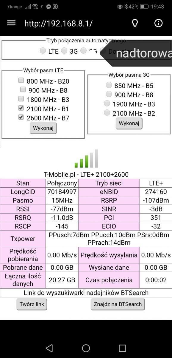

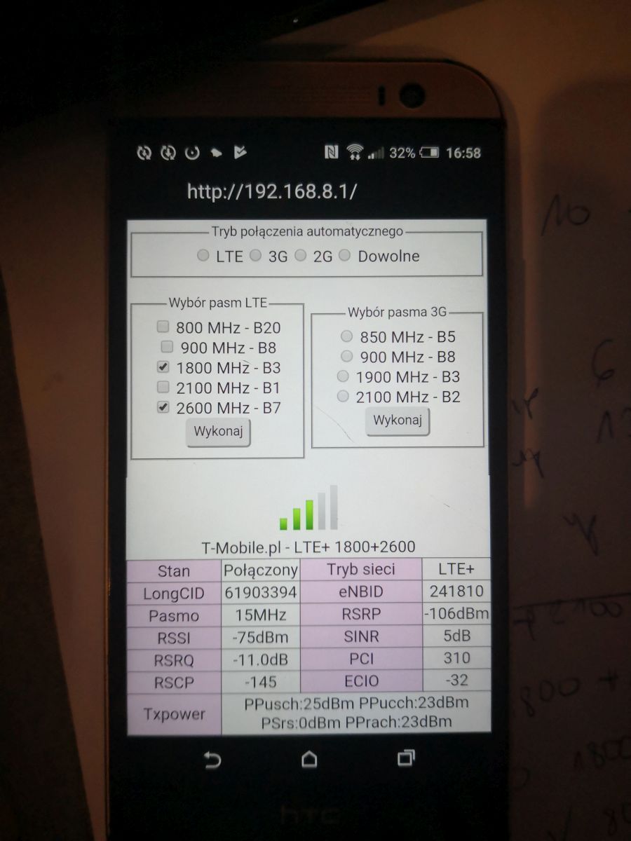

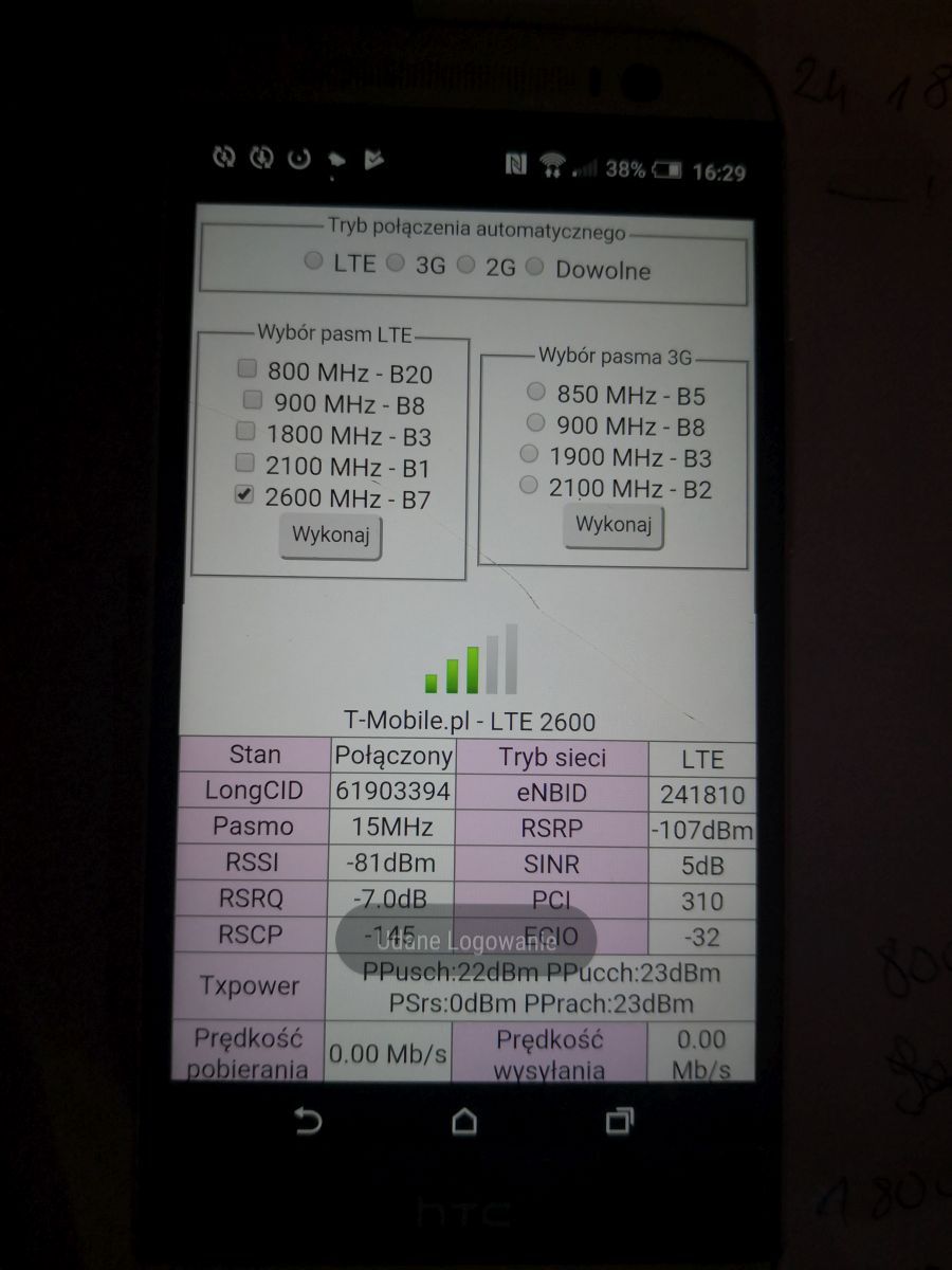

  • #59 18343744
    matek451
    Posts: 31263
    Help: 4352
    Rate: 5810
    The first two with lte2600 + 2100 and LTE2600 itself as Nadtorowa is pl. Freedom. Signal at 2600MHz quite weak. The remaining 3 are Nadtorowa, the signal on LTE800 is very good and on LTE1800 and LTE2100 it is worse. No speed tests in these conditions. The next two, i.e. aggregations lte2600 + 1800 and LTE2600 + 800 are Pl. Freedom. Another is the aggregation of lte2100 = 1800 from the trackside and the bands individually from it. The last 6 are different combinations of the bands from the trackside, with the signal on the lte2600 comparable to Freedom. generally it is on lte800 signal from both ok, medium on lte1800 and lte2100 and quite weak on lte2600. In general, as I wrote, you have the comfort of choosing bts. eNB from 73620 is always Nadtorowa and the one from 74160 is Wolności Square. Come back speed, because they will decide on the choice of bts.
  • Speed test limited to Nadtorowa location

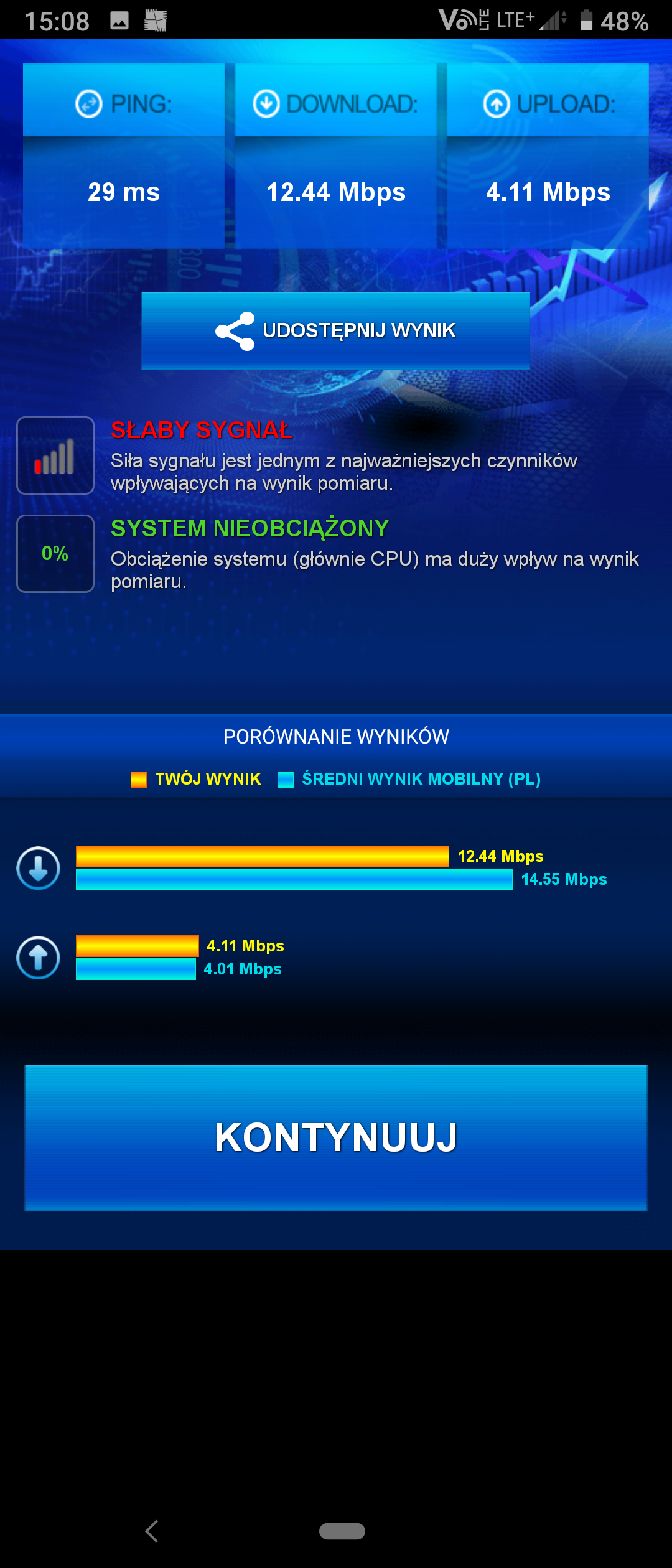

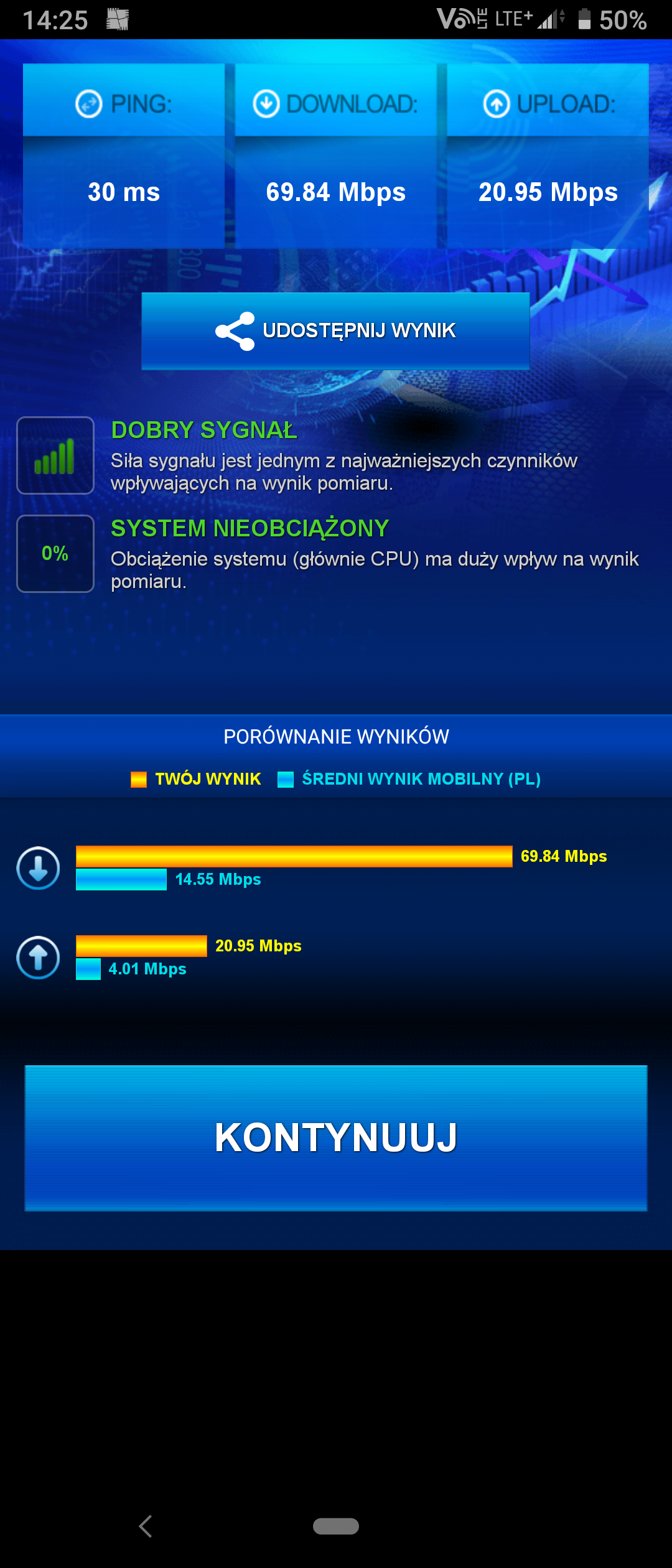

    I did Hmanaga and speed test today. I was able to do the test only from Nadtorowa, because Plac Wolności was inaccessible today, I couldn't catch the signal.
