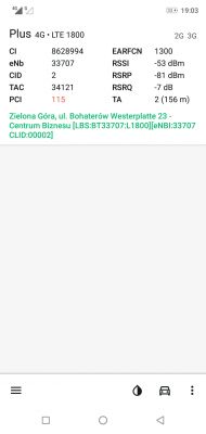

    Searching for Huawei B535-232 Antenna - Need Help Finding a Compatible Model

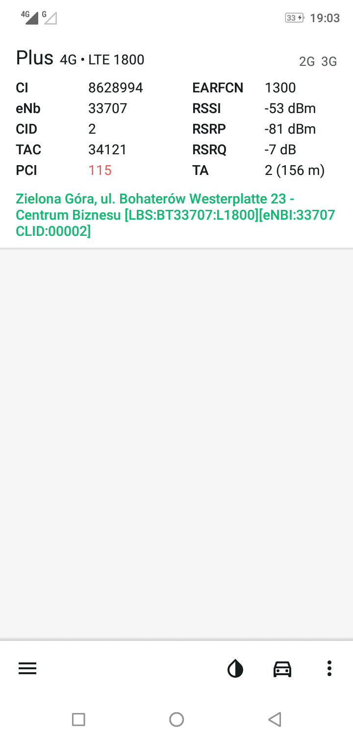

    This is what it looks like on the PLUS card at 19.00.
    Leave it like that and do anything?
    OK, I'll do the tests at a later time.
    edit1

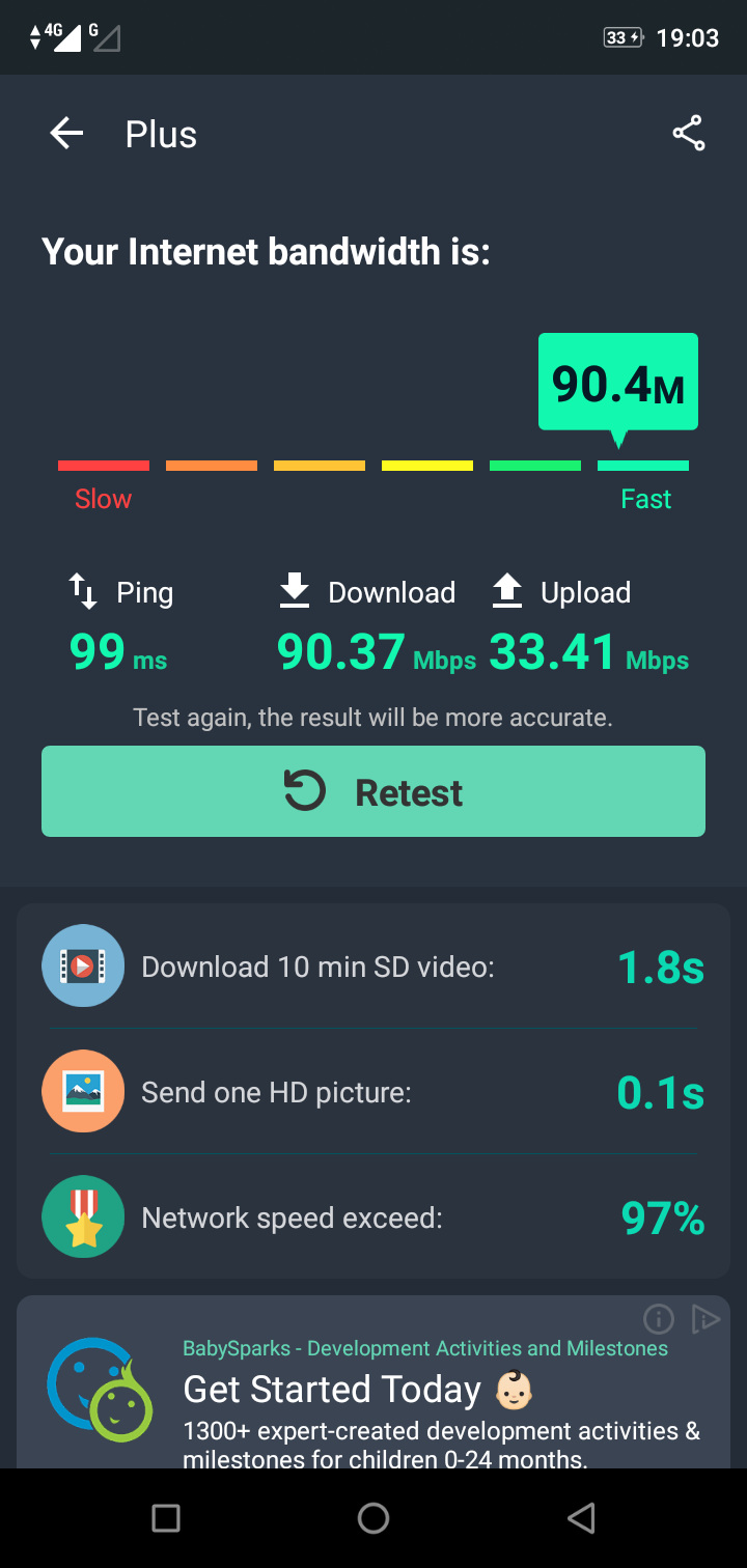

    I click every now and then as the results:
    20:13 84.66Mb / s / 18.16Mb / s 25ms
    20:17 79.42Mb / s / 36.02Mb / s 38ms
    20:20 89.94Mb / s / 31.95Mb / s 46ms
    I checked PLAY, I have 250m to the transmitter with many bands (Galeria GRAFIT), but the speeds are much slower.
    Orange is a total bowel, Tmobile for the company has an offer with a subscription to the phone, so I do not even check.
    This plus nolimit is actually 100GB on the plus transmitter, which gives a total of 135GB at the maximum speed for PLN 20 net (promotion for those who already have a subscription for at least PLN 50). So far, I had about 100GB of download, so I think it's enough with sending inquiries. I have no idea why, but LTE offers for the company are much better than for individuals.
  • #93 18485216
    matek451
    Posts: 31263
    Help: 4352
    Rate: 5810
    The result is surprisingly good for Plus from the bare LTE1800aero2, the wind is blowing at 19 on the BTS, there are no users yet, but test it. Maybe you got BTS Plus that few use. There are times like this.

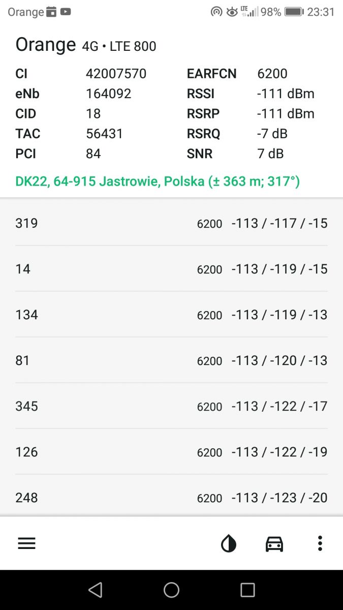

    I do not have the equipment, I only have an offer, I only have a telephone, and in the case of a company offer there is no test period to possibly resign
  • #98 18502623
    matek451
    Posts: 31263
    Help: 4352
    Rate: 5810
    Make a test on the Orange card outside on an LTE Android phone with the application https://play.google.com/store/apps/details?id=cz.mroczis.netmonster&hl=pl and show a screen from it and speedtest. The location is difficult, only BTS Jastrowie-Roosevelta gives you some chances for faster internet, LTE capacitive bands work on it, i.e. LTE1800 / LTE2600 possible with LTE2100 and LTE800 range. BTS's Currents, Byszki and Sypniewo are golce with only 800 / 900MHz, i.e. nedza on LTE800 only with 10MHz band, usually jammed.
  • #99 18514544
    top69
    Posts: 9
    Searching for Huawei B535-232 Antenna - Need Help Finding a Compatible Model Searching for Huawei B535-232 Antenna - Need Help Finding a Compatible Model Searching for Huawei B535-232 Antenna - Need Help Finding a Compatible Model
    just that, nothing else to catch
    CURRENT transmitter
    and here the question is what is possible to obtain by taking a router with an external antenna. (here is also the question what)
    does it make sense to take this offer with orange
    I didn't do the speed test
  • #100 18514616
    matek451
    Posts: 31263
    Help: 4352
    Rate: 5810
    This LTE1800 is doubtful and the signal is some debris, only on LTE800 it is quite correct, but still weak. The 800mHz antenna will probably improve it, but you would have to check near BTS-A Currents if they actually added LTE1800 there. And do some speedtest.

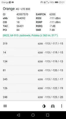

  • #101 18526442
    froggie

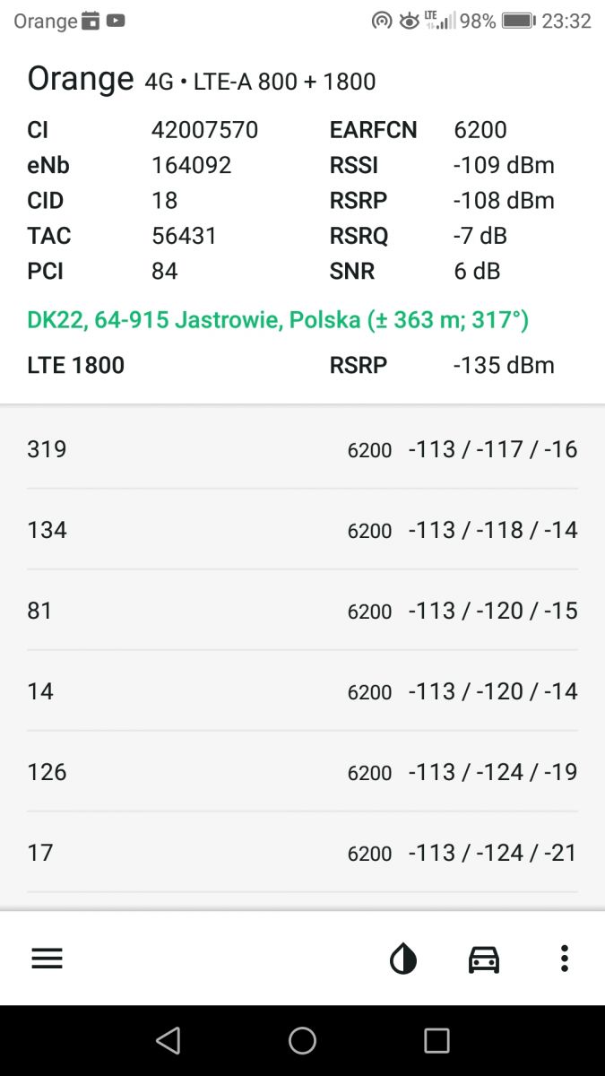

    Could my mothers friend451 advise me?
    I was called from Orange to extend the contract for tel + internet. Currently, I am dissatisfied with my home WiFi coverage. In fact, the router is in the attic, but in one of the rooms on the ground floor there is an ASUS RP-AC52 signal extender. The current ZTE MF283 + router often loses coverage and disconnects. Then I have to log into the router and then it is quiet for a while. In connection with these problems, they offered me a new router that should work better blah blah blah - the Huawei 4G Router 3 Pro router. My location is Borowa in the Koluszki commune. I know that the nearest base station to me is at ul. Spatial and this is the T-Mobile station.
    I am asking for advice whether to change the router and stay in Orange, or it is better to change to another network with better coverage in my area.
    best regards
  • #102 18526544
    matek451
    Posts: 31263
    Help: 4352
    Rate: 5810
    And how miraculously this B535 will improve coverage at this location for Orange is mega crap. In this location, regardless of the operator, an external antenna is necessary, now it is probably nedza, i.e. LTE800 on MF283 from one of the BTS NetWorks, Kurowice or Gałków Duzy. These BTSs are refarmed and LTE2100 and LTE1800 should also work on them. What is the offer from Orange and for how much this B535? Orange has poor equipment on offer, not Play.

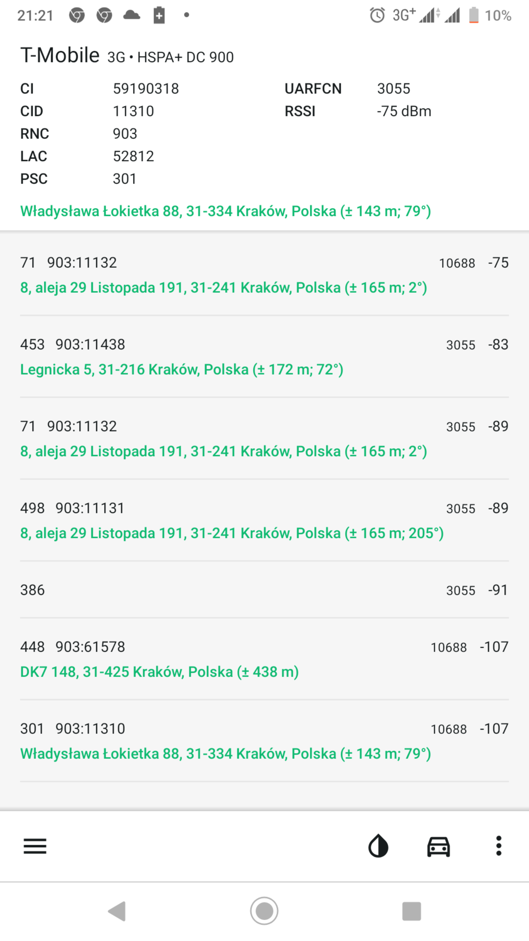

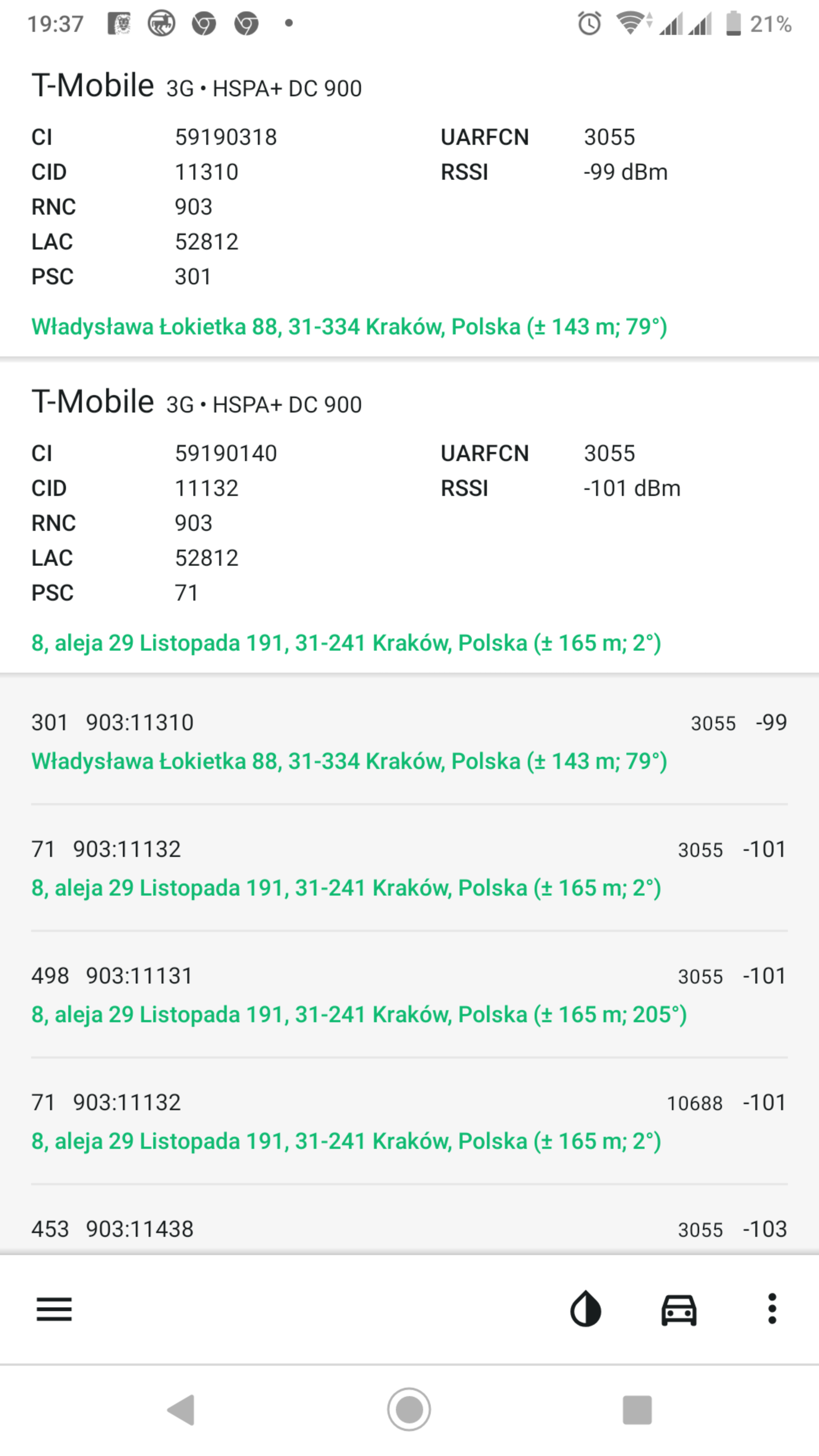

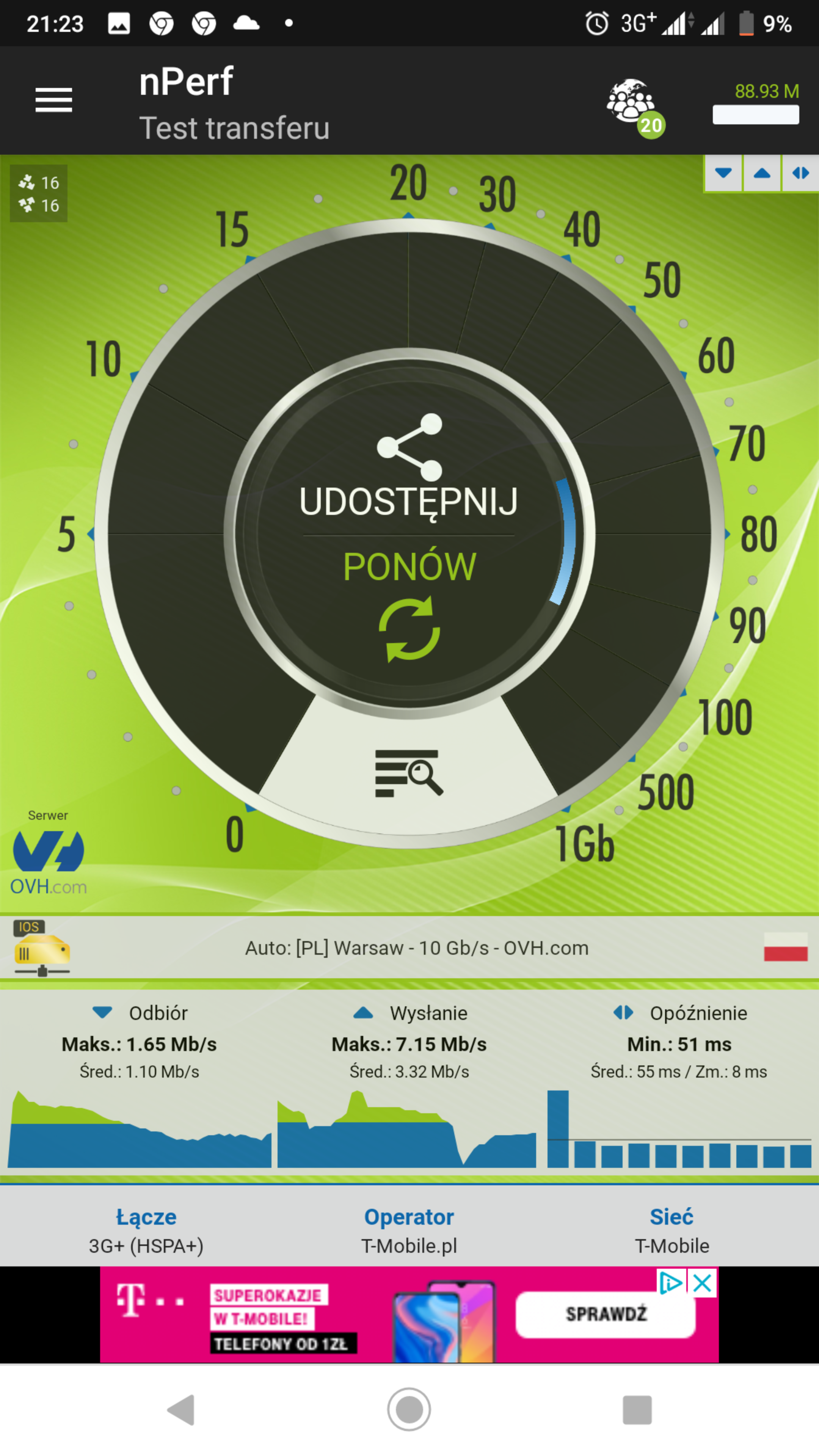

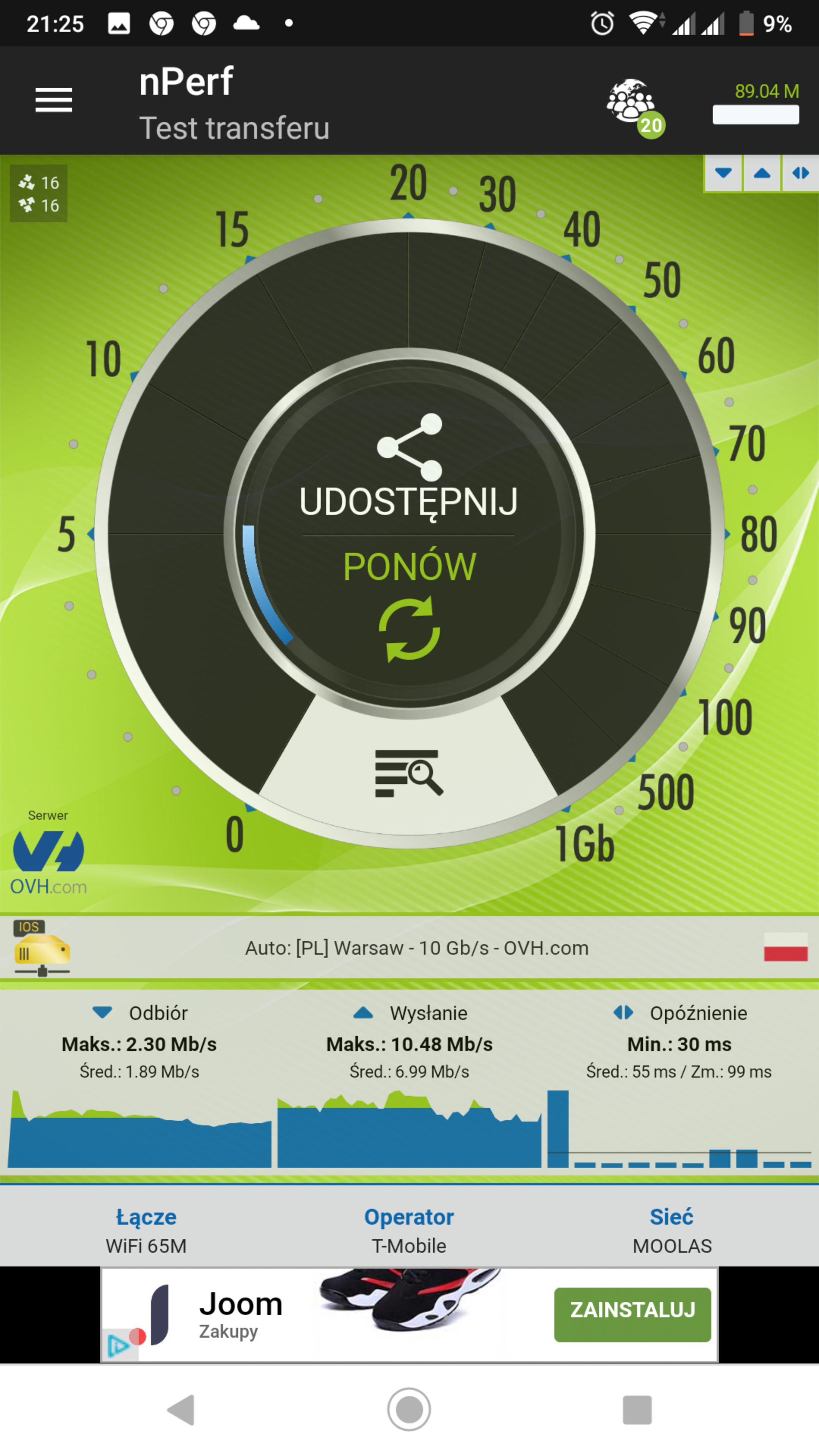

    Hi, I am asking you to analyze my area in terms of btsow, is there a chance for LTE. Krakow area, 37 Banacha Street. I'm waiting for the router from the topic of the post, and so far it looks like the attachments. I am asking you for help. Certainly, when the router arrives, I will need help with selecting channels and antennas. best regards
    • Searching for Huawei B535-232 Antenna - Need Help Finding a Compatible Model Screenshot_20200319-193743.png (719.28 KB) You must be logged in to download this attachment.
  • #107 18543576
    matek451
    Posts: 31263
    Help: 4352
    Rate: 5810
    BTS NetWorks is on the hotel. The system runs LTE2600, LTE2100 and LTE1800 T-mobile and their aggregation. Make a test with the phone outside, the card has access to LTE because it is different in T-mobile, plus speedtest. In general, did you check this operator on LTE in this area?
  • #108 18543658
    Molaswisla
    The two earliest screenshots are from the outside, phone tests. The last and the latest is the WiFi speedtest at home on dwr116. Hope the new router helps. As soon as there are any suggestions, I will be happy to learn something new. best regards
    PS This bts on the hotel is relatively low in relation to the overall build-up around it. And I have an apartment on the ground floor ... I have had T Mobile for a long time, because it's best to have coverage here after all.

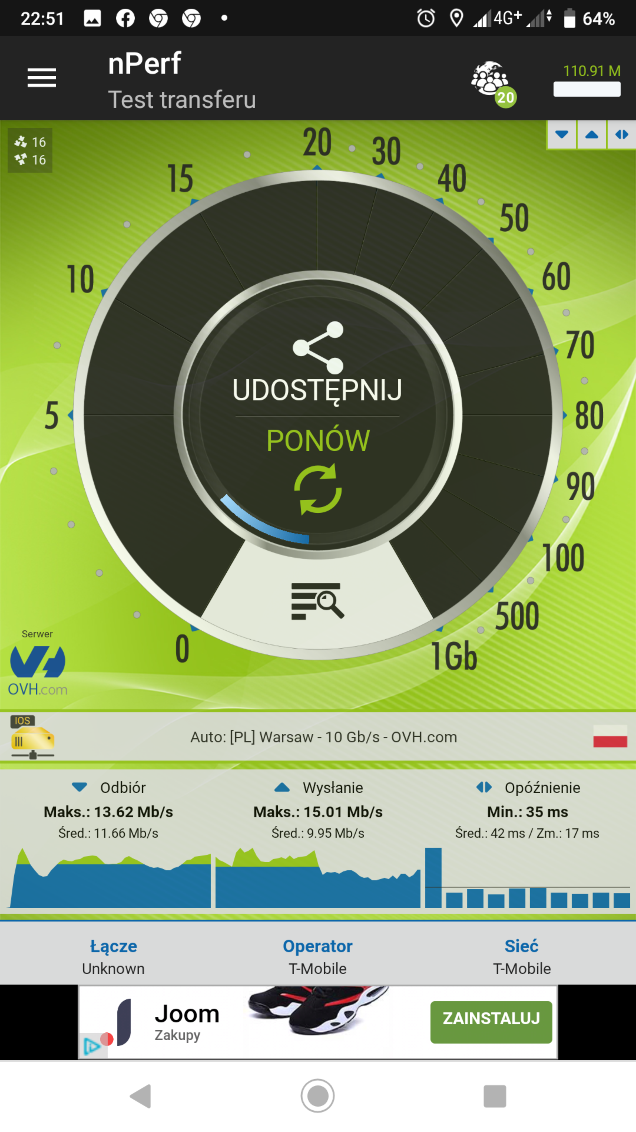

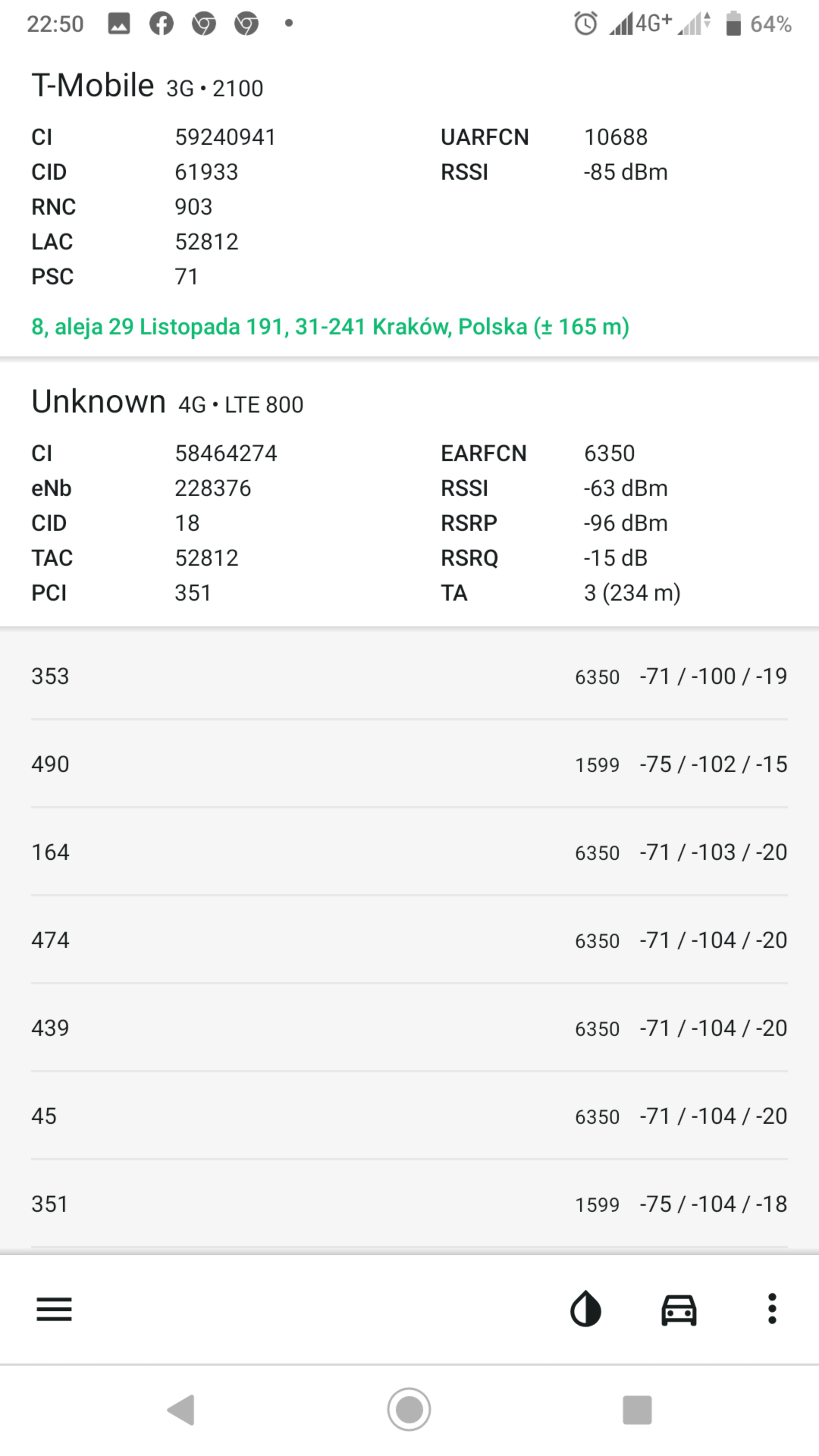

  • #110 18543877
    Molaswisla

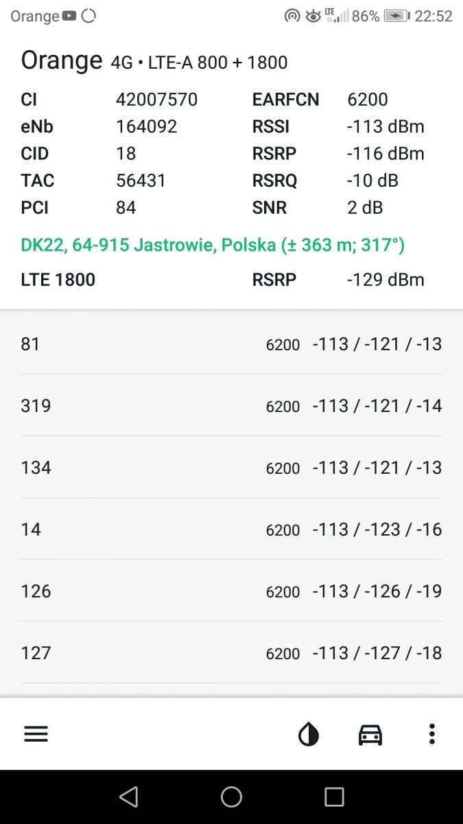

    I don't know how it happened but I had LTE turned off on the phone. This is what the current charts look like .. Something better?

    @Molaswisla now aggregation with LTE800 as the baseband, signal sufficient, aggregation with it another LTE band, traffic decreases by 23, hence better speeds but still BTS overloaded DL
