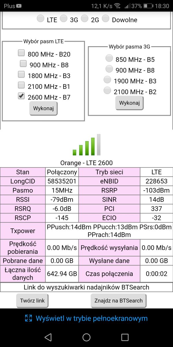

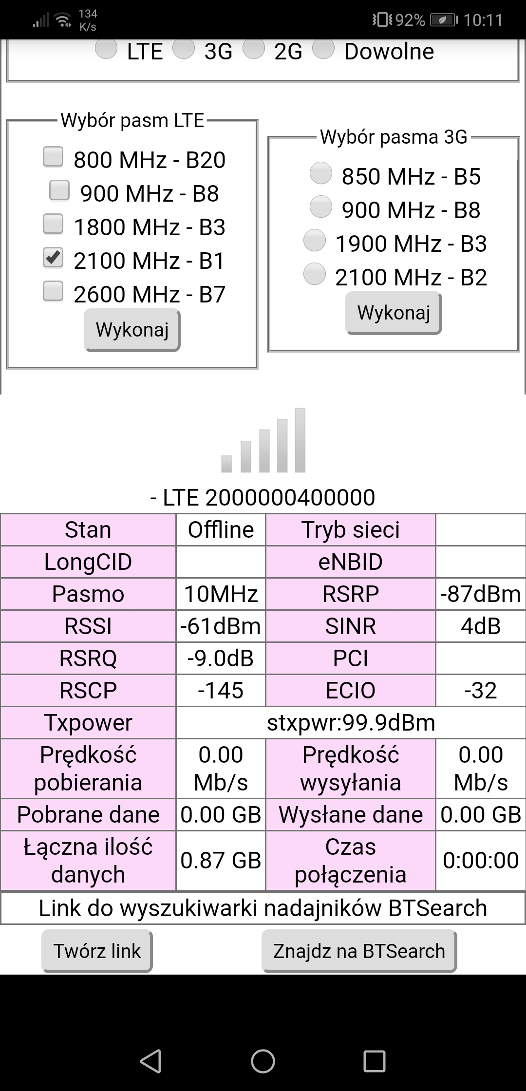

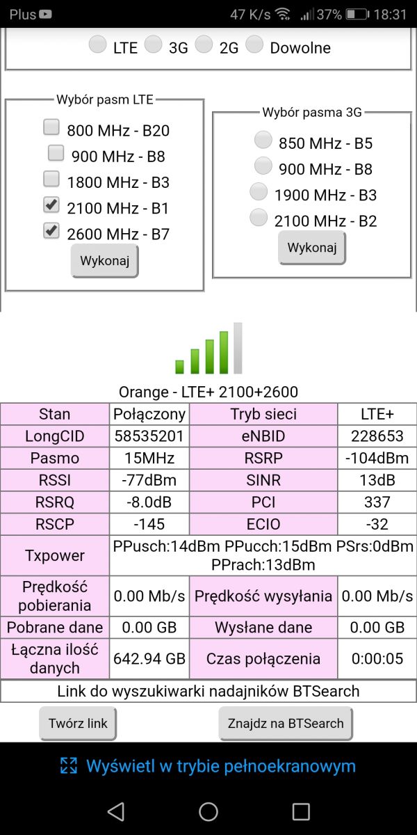

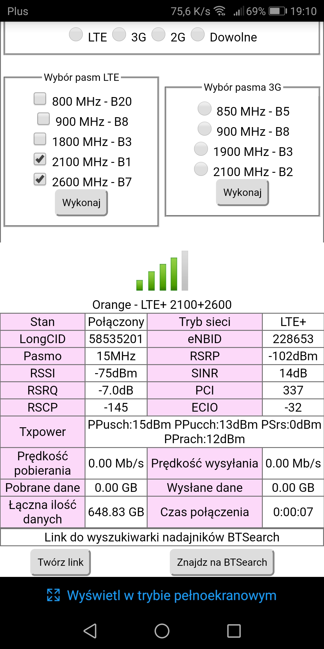

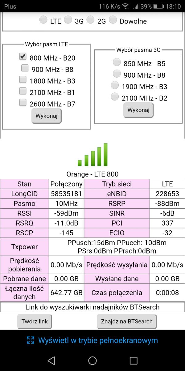

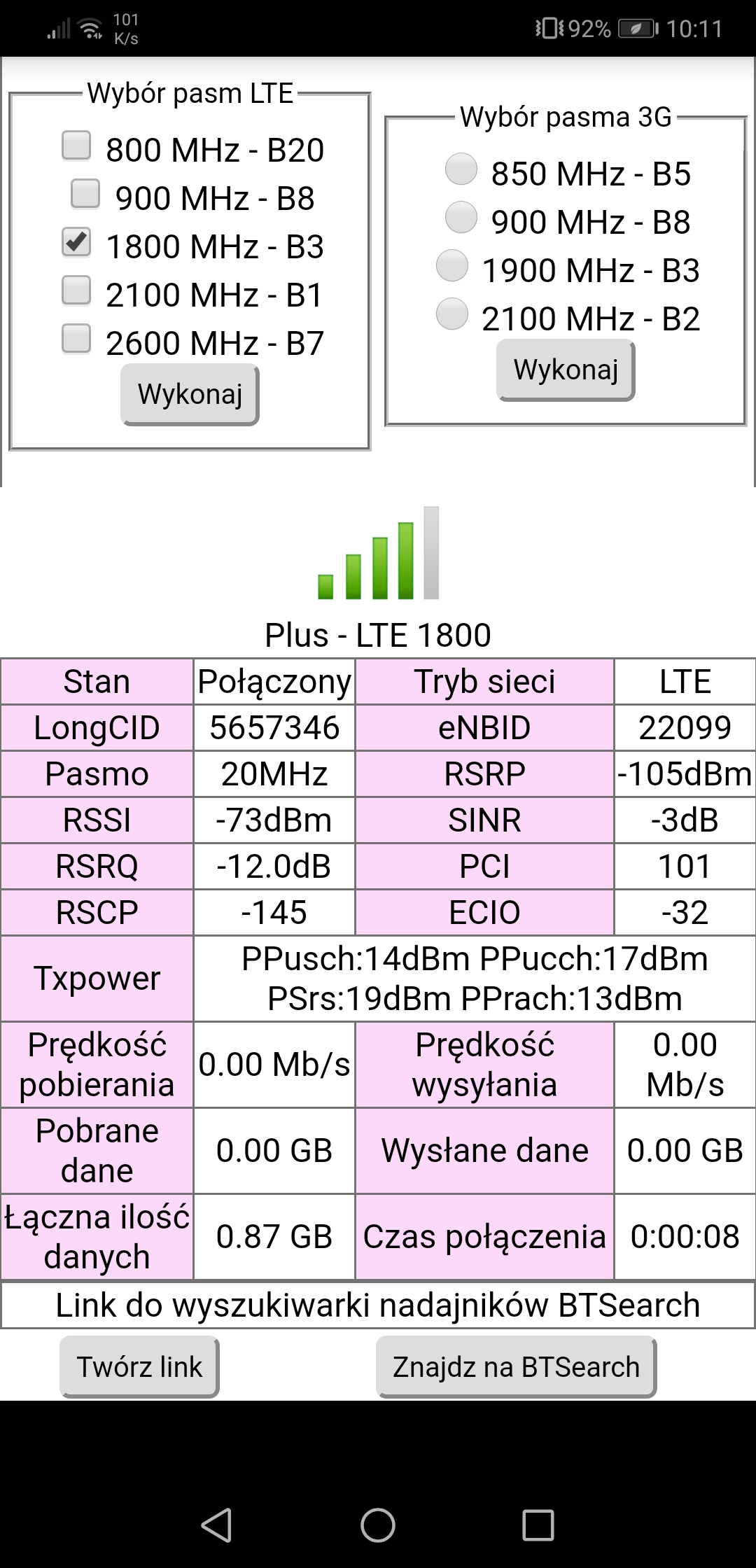

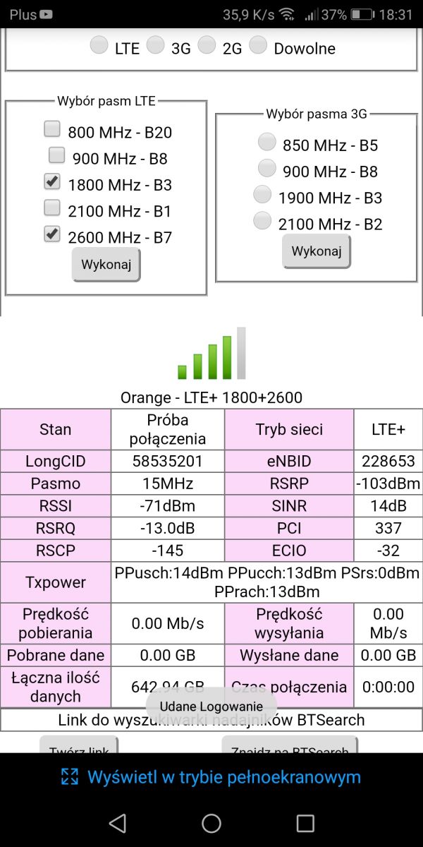

    Krzysztof. 87
    I warmly welcome. I have a Huawei b535 router shines plus I would like to increase its possibility in the attachment I attach screenshots, maybe someone will advise something. best regards
    • Searching for Huawei B535-232 Antenna - Need Help Finding a Compatible Model Screenshot_20191225_105802_com.nasser.huaweimanager.jpg (543.88 KB) You must be logged in to download this attachment.
    • Searching for Huawei B535-232 Antenna - Need Help Finding a Compatible Model Screenshot_20191225_101118_com.nasser.huaweimanager.jpg (544.6 KB) You must be logged in to download this attachment.
    • Searching for Huawei B535-232 Antenna - Need Help Finding a Compatible Model Screenshot_20191225_101154_com.nasser.huaweimanager.jpg (525.95 KB) You must be logged in to download this attachment.
    • Searching for Huawei B535-232 Antenna - Need Help Finding a Compatible Model Screenshot_20191225_101227_com.nasser.huaweimanager.jpg (545.83 KB) You must be logged in to download this attachment.
  • #67 18359388
    matek451
    Posts: 31263
    Help: 4352
    Rate: 5810
    But what do you want to increase? The car is connected to the BTS Żwakowska 8-2 LTE2600 as the baseband plus probably LTE1800 as an additional signal, sufficient signal. LTE900 from it, not worth attention, works only on 5MHz band, slow and clogged by definition. LTE1800 from BTS at Sadowa, LTE900 and LTE1800 + 900 aggregation on it, signal at 1800MHz weak. You have not provided a location.

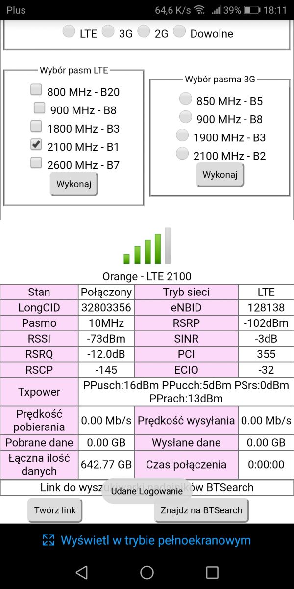

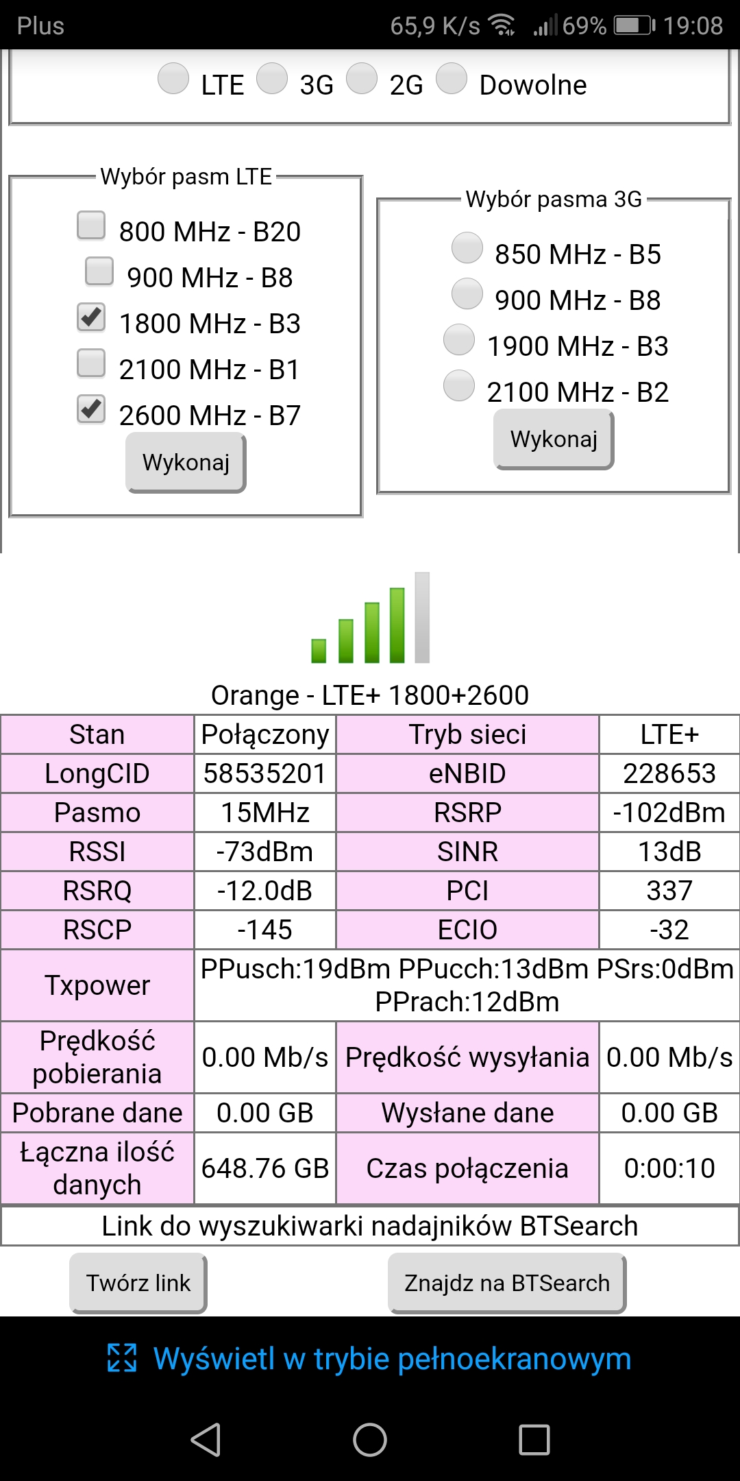

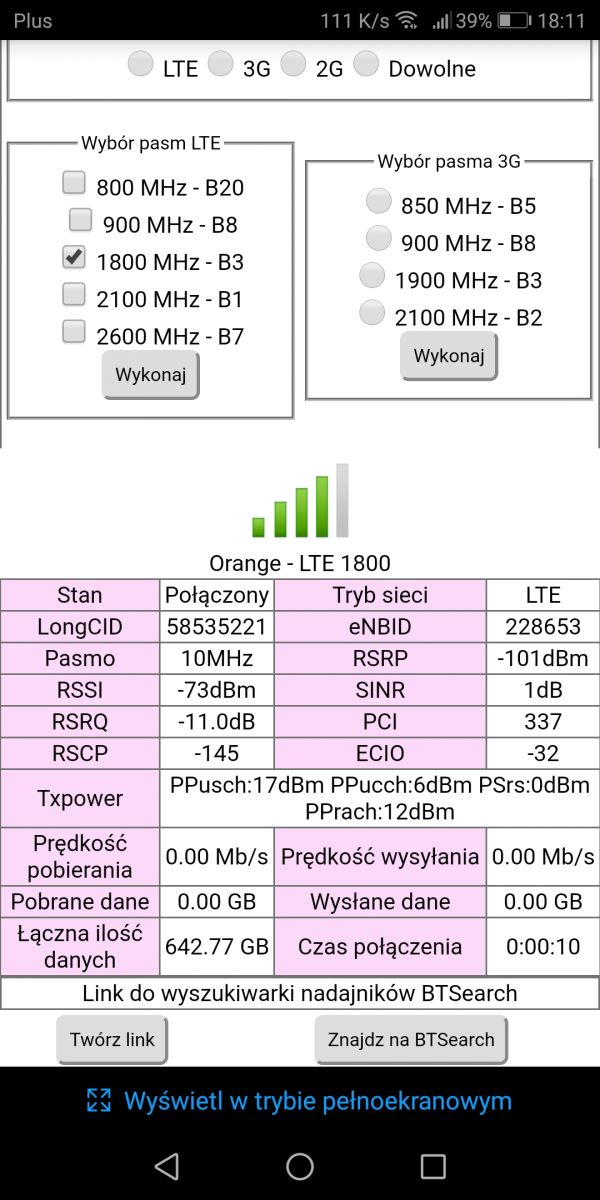

  • Inconsistent speedtest results across 2600/1800 and 2600/2100
    #85 18479118
    ajku
    Posts: 12
    Speedtests came out very ... Randomly ... That's why I beat them for almost an hour to see some regularities, but nothing like that. Results of the last 8:
    2600 + 1800
    1. Download: 26.58 Mb / s
    Upload: 4.44 Mb / s
    Ping: 22 ms
    Jitter: 5 ms
    2. Download: 28.52 Mb / s
    Upload: 4.75 Mb / s
    Ping: 19 ms
    Jitter: 5 ms
    3. Download: 28.41 Mb / s
    Upload: 5.22 Mb / s
    Ping: 18 ms
    Jitter: 9 ms
    4. Download: 30.33 Mb / s
    Upload: 3.68 Mb / s
    Ping: 19 ms
    Jitter: 6 ms
    2600-2100:
    1. Download: 26.11 Mb / s
    Upload: 4.09 Mb / s
    Ping: 16 ms
    Jitter: 10 ms
    2. Download: 40.60 Mb / s
    Upload: 3.18 Mb / s
    Ping: 19 ms
    Jitter: 9 ms
    3. Download: 16.97 Mb / s
    Upload: 6.20 Mb / s
    Ping: 20 ms
    Jitter: 2 ms
    4. Download: 39.33 Mb / s
    Upload: 3.46 Mb / s
    Ping: 19 ms
    Jitter: 2 ms
    What do you think? :)
    • Searching for Huawei B535-232 Antenna - Need Help Finding a Compatible Model Screenshot_20200218-191002.jpg (533.21 KB) You must be logged in to download this attachment.
    • Searching for Huawei B535-232 Antenna - Need Help Finding a Compatible Model Screenshot_20200218-190825.jpg (533.85 KB) You must be logged in to download this attachment.
  • #86 18479383
    matek451
    Posts: 31263
    Help: 4352
    Rate: 5810
    And what do these ping spikes look like now with these band settings? Overall, the speeds are good, the LTE2600 signal is sufficient, the LTE1800 / LTE2100 signal is similar. Improving the signal should translate into an increase in speed, UL will definitely increase. You can see that the base station has potential, you won't use it on the B535. It's just a router with 2 CC CA.
  • #87 18479504
    ajku
    Posts: 12
    I have the impression that it is more stable, in the last hour it happened once that the pings went crazy. I will be watching. Thank you for your help.
