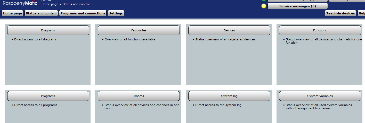

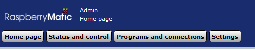

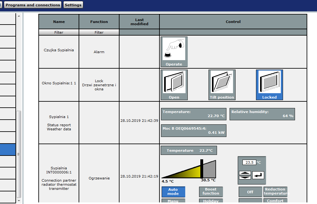

    Ok, and what is the Homematic interface like in terms of clarity and user friendliness ? If you perhaps have a comparison with some other system, please write a few words about it.
    Is a new user without experience in the area of smart-home capable of setting up a system like the one presented in the first post without the help of experts/services?
    Is it possible to have a mix of homematic IP devices and "normal" homematic devices in such a system (under the CCU3 control unit, which I am considering)?
