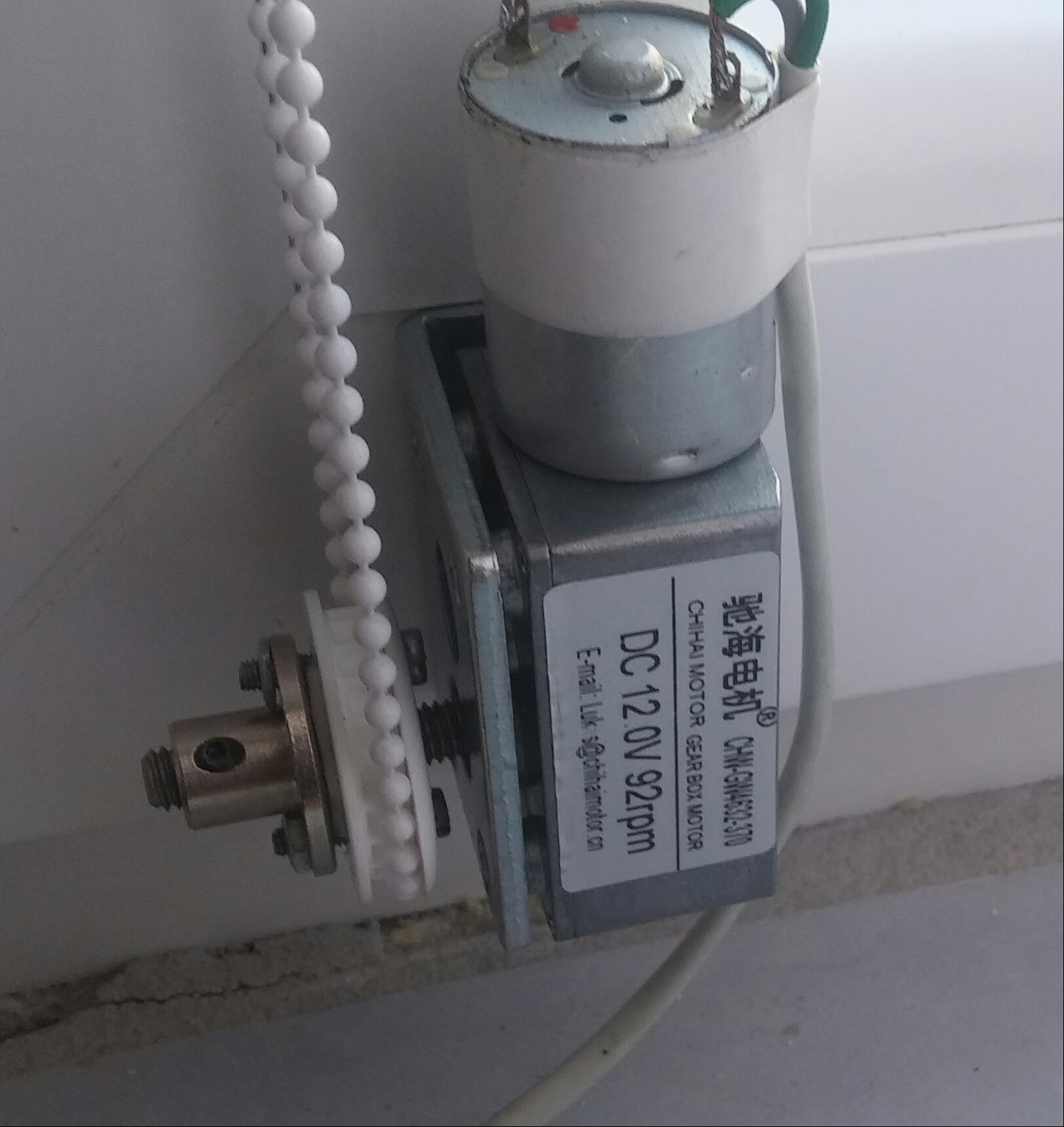

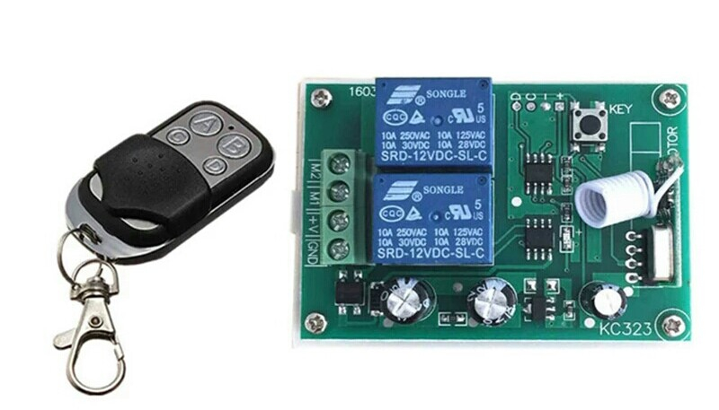

    Hello, I would like to present an idea for a quick installation of a remote control window blind control. The control itself and the motor bought as ready-made components. Everything is visible in the pictures. Time to open the roller shutter on a large window about 5 seconds. The remote control works in several modes, but I chose this one: pressing the first button causes the roller shutter to close, releasing it stops it. The second button (same principle) opens the roller shutter. The motor and control were bought at a foreign auction. The advantage of this solution is that the original mechanism is not interfered with and in case of power failure you can always disconnect the ball chain from the motor and open it manually. The whole cost is about 110 PLN plus one hour of work

    The gear works quite quietly even at night. The link may come in handy as this auction only comes with a threaded sleeve to which the white plastic pinion is attached and a piece - an angle bracket - that fixes the motor to the window.

    The cogs inside are metal. And the speed? Judge for yourself.

    The opening time is not adjustable. You can order a motor with 38rpm then it will be slower. There are no limit switches. As I described in the first post, the motor is switched on by pressing a button and off by releasing it. It is a simple mechanism.

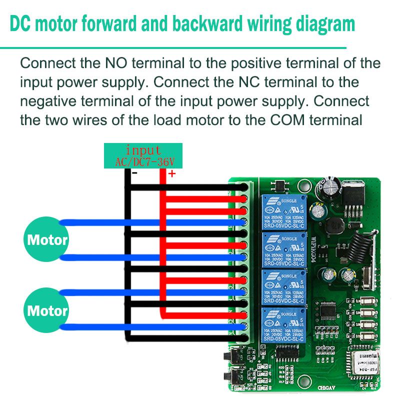

    Hello again. I have extended the roller shutter control with another controller. For two motors, both controlled separately from one remote control or from the phone via WiFi. And it turned out that the new controller, in addition to several others, has a timer programming function, so the limiters are not needed because you determine how many seconds the roller shutter opens or closes and program it with an accuracy of 0.5 seconds. The operating software is eWeLink for Android.

    aleks-1967 wrote:
    I found out that the new controller, in addition to several others, has a timer programming function so the limiters are not needed because you determine how many seconds you open or close the roller shutter and program it with an accuracy of 0.5 seconds.
    Everything is correct if we write always about full opening and closing, but what if we stop in the middle?
    As you can see, however, position sensors are needed.
    Regards.
