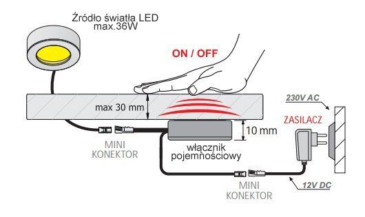

    A simpler solution is motion sensors, e.g. a capacitive one mounted under the countertop (unless it is metal, since it's catering), or infrared sensors:

    sk1977 wrote:
    in this case, the movement of the blinds would involve holding a hand on the sensor for the duration of the blind movement and part of the countertop would be out of service.
    2x no :) .
    A bistable capacitive sensor such as the one pictured in #2 can be used. The sensor can operate up to 3cm of countertop thickness (it calibrates itself depending on the thickness of the countertop), and if there is little space on the countertop, it can be placed at the bottom behind the pedestal and actuated with the foot.
