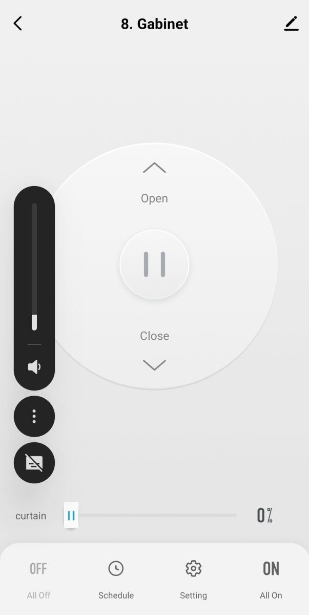

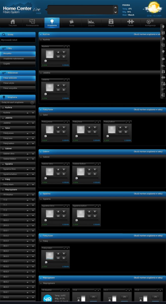

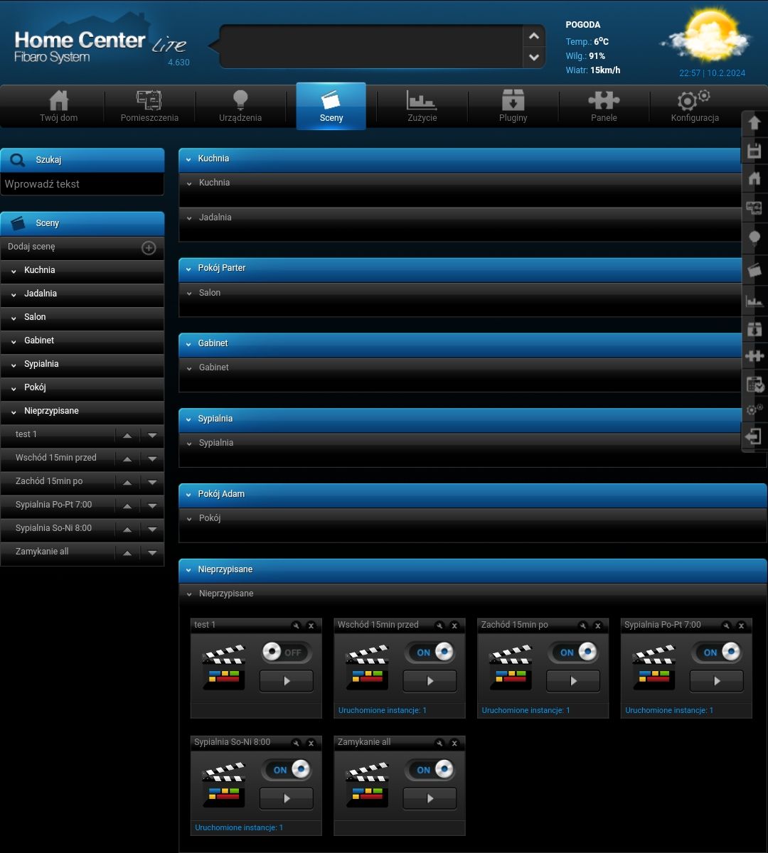

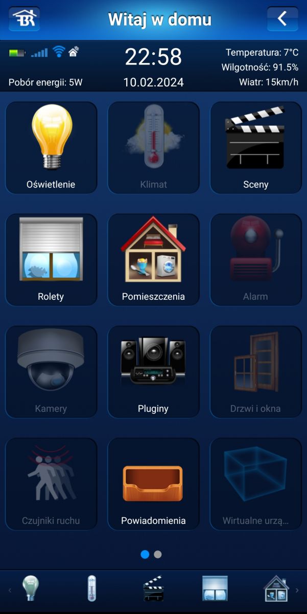

  • Examples of Zigbee and Z-Wave shutter controls
    #21 20955313
    kkknc
    Posts: 23749
    Help: 1915
    Rate: 6702

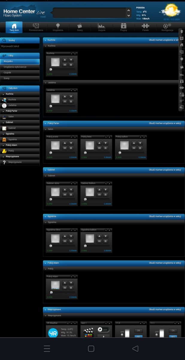

    Here you have a house with blinds on zigbe.
    Home device control panel with a list of blinds and a gateway.
    Control panel for blinds and lighting in a smart home app.
    Here you have zwave and fibaro control panel. Also just blinds.
    And here you have already more advanced functions.
    Control panel of Fibaro system with blinds and lighting functions. Fibaro home management system interface displaying options for controlling blinds and lighting. Fibaro Home Center interface showing scene settings for lighting and shutters.
    This is a panel for home users. Roller shutters and lighting.
    Smart home system management app interface with main menu.
  • Recommend switching from old HC2 app to Yubii
    #22 20955662
    GanzConrad
    Level 25  
    Posts: 934
    Help: 67
    Rate: 203
    kkknc wrote:
    And here you have already a more advanced function.
    The colleague did not mention that this visualisation comes from an old control panel, which the author of the post will certainly not buy because it makes no sense. In the new one it looks different, but of course the basic functionality will be the same, only in the new one there will be more functions "at hand" e.g.: in the old HC2 you need to program in LUA in order to open the blinds with the sunrise, while in the new one it is available immediately.
    Another thing: in zigbee it will certainly be cheaper, and if it leads the author on a path related to home assistant then praise him for that ;-)
    Added after 14 [minutes]:

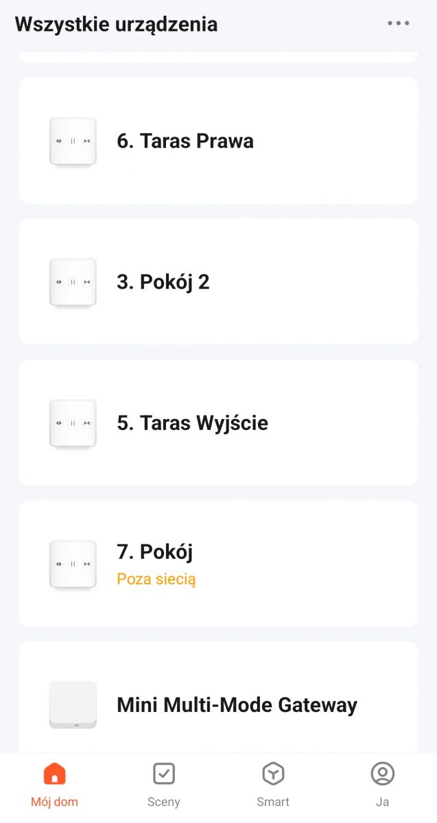

    kkknc wrote:
    This is a panel for domestic users. Roller shutters and lighting.
    This app is probably not even available in shops anymore, so when changing phones will be a problem, besides I recommend switching to Yubii.

    It is, also for others on the screen you can see that one of the controllers is offline. And it is zigbe that doesn't have this implemented.

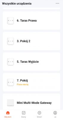

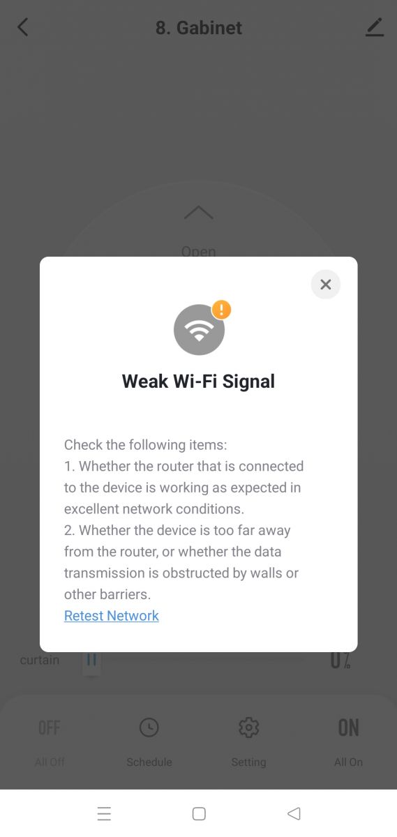

  • Gateway placement needed for end-of-house communication issues

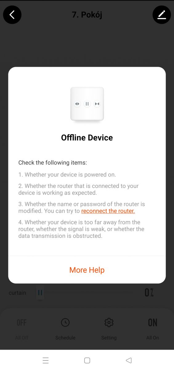

    #28 20955933
    kkknc
    Posts: 23749
    Help: 1915
    Rate: 6702
    Theoretically this is supposed to be implemented in the protocol unfortunately I don't see it. Controllers that are at the end of the house have communication problems and even though the previous one is visible 1 or 2 m away. That's why sometimes you have to fly with a gateway and install it in a good place.
    Weak Wi-Fi signal notification on an app screen. Screenshot showing an Offline Device message with troubleshooting instructions.
    You won't see something like that with zwave. Well, unless the distances are really great, but then you always give some module for retransmission.
    What's more, most exchanges will show you the way which with what and through what it communicates whether directly or uses mesh.

    kkknc wrote:
    the app you mentioned is for zigbee
    The Yubii app, is a new (maybe two years, maybe more) app for Fibaro:
    https://play.google.com/store/search?q=yubii+home+center&c=apps
    https://www.fibaro.com/en/application-intelligent-home/
    the old app is no longer being developed and on some phones it cannot even be installed (e.g. mine...)-it is invisible for some iphones etc.
    https://play.google.com/store/apps/details?id=com.fibaro
    generally there is no need to stick to the old one, because corrections and improvements only appear in the new one.
