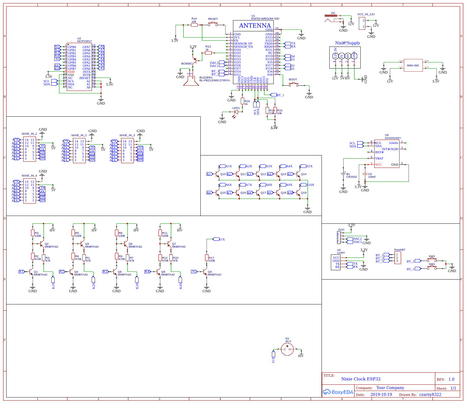

    Another problem appeared on the horizon. In addition to the radio, the ESP is supposed to control the NIXIE tubes.
    After connecting the power supply, the 470K resistors - R2, R6, R9, R12 that control the cathodes - were literally fried. Currently a voltage of 170V is deposited on them.
    This is a well known and duplicated schematic on mmbta42/92 transistors. Can you perhaps see the cause of the burned resistors?

    czarny8322 wrote:
    After connecting the power supply, the 470K resistors - R2, R6, R9, R12 controlling the cathodes - were literally fried. Currently a voltage of 170V is deposited on them.
    170²/470000=61mW
    My bet is that these are not 470k resistors.

    czarny8322
    Posts: 81
    Rate: 14
    You were right - it couldn't be 470K - I must have soldered 470 Ohms in a hurry....
    Yes, that 170V value was already after the resistors were evaporated.
    I've eliminated most of the problems for now, unfortunately the PCB is up for rework, but at least it's going in the right direction.
    Many thanks for all the advice.
