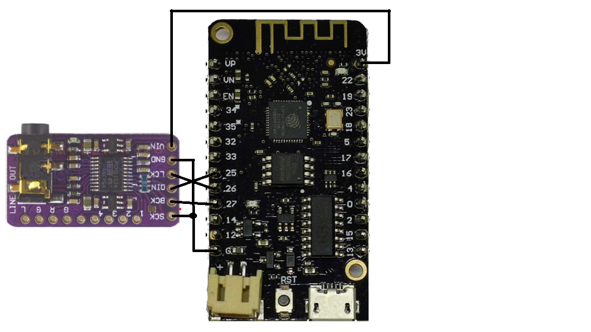

    I am trying to make a simple internet radio player. There is quite a lot on the internet about it. I, however, am struggling with the problem.
    Environment: Arduino IDE 2.2.1
    Board: WEMOS LOLIN32 LITE clone
    Audio board: PCM5102A
    Connections:
    Connection diagram between ESP32 Lolin32 Lite board and PCM5102A audio module
    Audio library: https://github.com/schreibfaul1/ESP32-audioI2S/tree/master

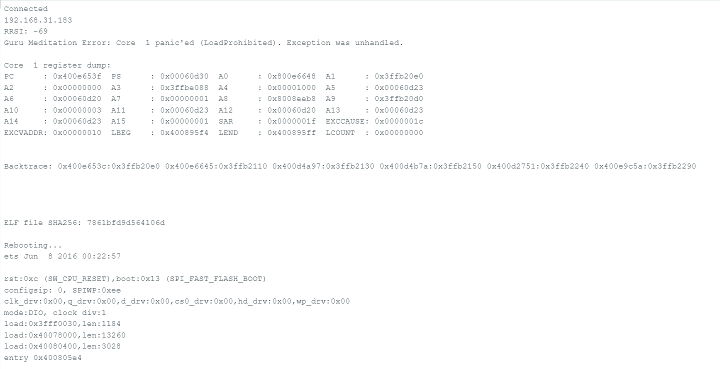

    Code compiles and uploads, but program crashes on line audio.connecttohost("http://stream.open.fm/378?type=.aac"); causing ESP to reboot:
    Screenshot showing a Guru Meditation Error message in the console while running code in Arduino IDE.
    Any suggestions what could be wrong?

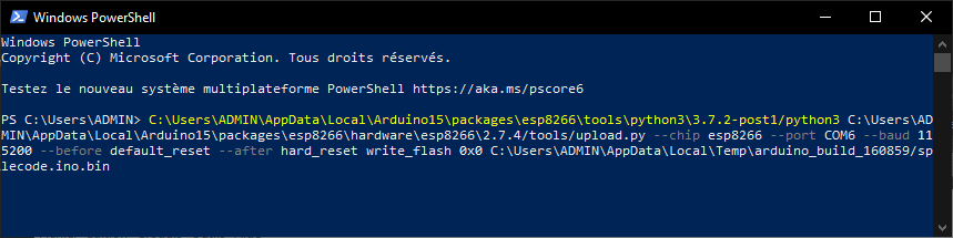

    Well, it's interesting to see what this is all about. Tell me more how I should upload the BIN to the board via the Arduino IDE?
    How about that?
    Screenshot of Windows PowerShell with a command to upload a BIN file to an ESP8266 board using Arduino IDE. .
  • #15 20732911
    inot
    Posts: 3567
    Help: 441
    Rate: 803
    This can be done as explained in the video below: Link .
  • #16 20732998
    speedy9
    Helpful for users
    Posts: 12032
    Help: 1233
    Rate: 2421
    Well, it's the same as far as I can see.
  • #17 20733033
    inot
    Posts: 3567
    Help: 441
    Rate: 803
    speedy9 wrote:
    the same thing as far as I can see
    Like that. The conclusion is that you thought right.

    Menuet wrote:
    For the possibility of testing your hardware, a compiled file with this exact code is also attached. You can make a WiFi hotspot on your phone
    I uploaded it and.... it works! I made a new sketch, pasted your code, compiled, uploaded to ESP and.... also works.
    I compile my code and it doesn't work (reboot loop), compile and play yours again and it works.
    The two sketches differ in total only in the presence of:
    void audio_info(const char *info){
        Serial.println(info);
    Why doesn't my program work? I have a fresh Arduino IDE and only installed this Audio library from the ZIP file.

    Adding the function at the end of the programme:
    resolved the problem.
