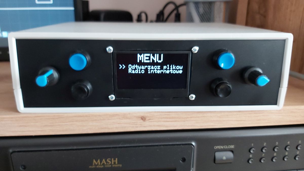

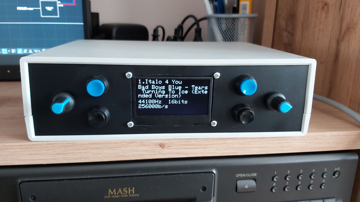

  • Hello everyone,
    for a long time I've wanted to make something cool that could be used basically every day - i.e. a useful computer desk accessory. So I came up with an internet radio with a file player on a cool OLED display. As I don't program microcontrollers every day, there are sometimes small errors in the code. The project will still be developed and the code fixed / optimised. Initially I built everything on a contact board, but I was constrained by the fact that the ESP32 module just happened to have one side of the pins unused, and I didn't want to keep messing it up with soldering, so I designed a new board - hereafter referred to as a prototype board, because everything on it is still on goldpin bases and sockets. Unfortunately I missed one mistake, downloading the ESP32-S3-WROOM-1 pad from the EasyEDA base it turned out that there was a difference in pin spacing across the width of the module. There may have been different versions, but in the end, after slightly bending the pins, I managed to get it to fit on the base board. I have posted all the actual code, PCB view, gerber files for PCB fabrication and pictures on my github. I encourage you to make yourself such a kit to start with on a contactor, the learning and fun of an interesting device is priceless. Feel free to comment.
    https://github.com/sarunia/ESP32_radio_player
    Following the topic: on the next pages you will find a description of my v2 version of the radio with file player, which was based on v1 version. v2 version was equipped with a higher resolution display and more refined in terms of source code.
    I've included a link to my github below, where you can find the project documentation and all the source code:
    https://github.com/sarunia/ESP32_radio_player_v2
    edit. XI.2025 - then appeared my new version v3 with a colour screen enriched with a weatherman, calendar sheet, news from RSS channel Polsat News Polska, version v3 is deprived of local control, full operation from remote control, you will find all data on my repo:
    https://github.com/sarunia/ESP32_internet_radio_v3
    Based on my project a fellow forum member @robgold also made his own version of the radio:
    https://github.com/dzikakuna/ESP32_radio_evo3
    the radio stations are downloaded from github, there are switched banks - max 100 stations each, then you switch each one back and forth:
    https://github.com/sarunia/ESP32_stream
    Costs:
    OLED display 2.42" 128x64px white PLN60
    ESP32-S3-WROOM-1-N16R8 WiFi , Xtensa LX7 48zł
    PCM5102A DAC module 30zł
    enclosure, I didn't want the usual black one, unfortunately this one was also expensive GAINTA G748 56zł
    mB102 power supply module for contact boards or another similar one, because there are plenty of them everywhere, mine was for 8zł
    2 rotary encoders with pushbutton, each about 8zl
    4 switches (two PS11BBK and two PS11BBU) total about 16zl

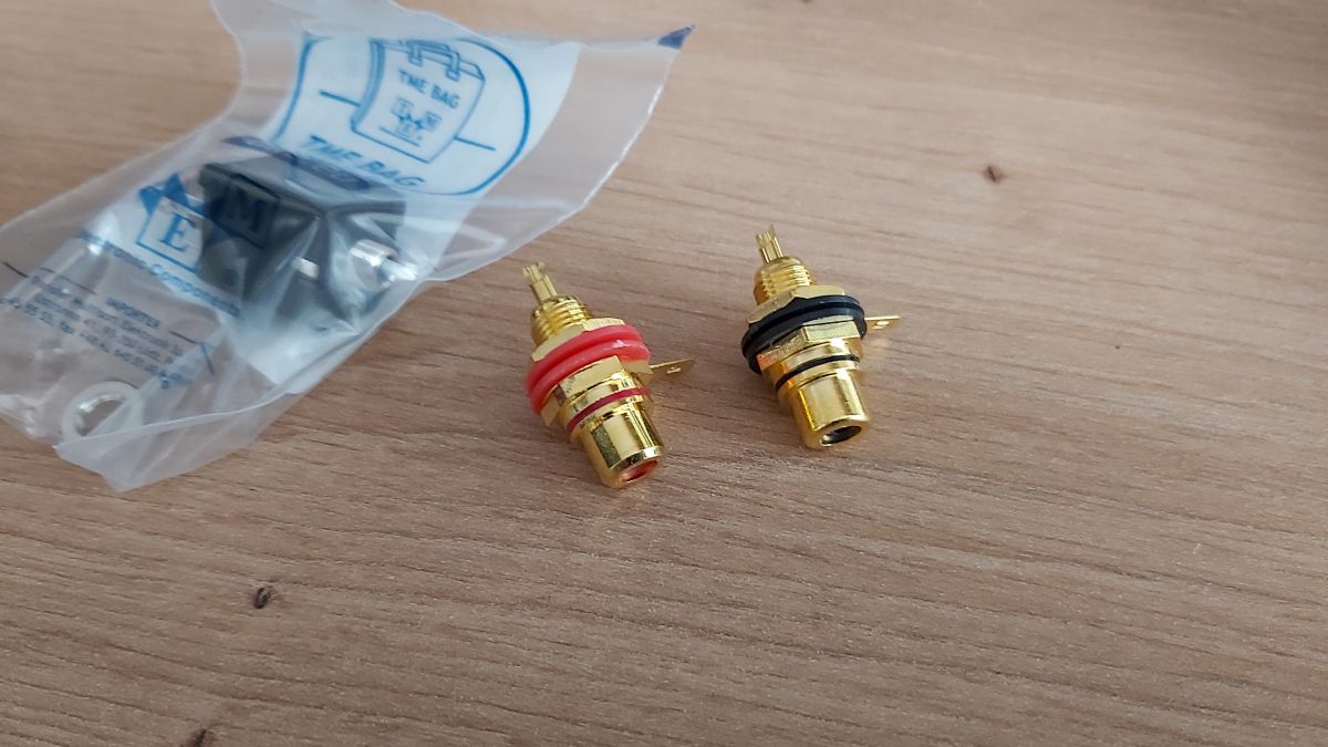

    2 gold plated RCA sockets (black marker CC-222B and red marker CC-222R) together for about 20PLN
    pCB made in Poland quite expensive, 1 piece cost me 130zl including shipping

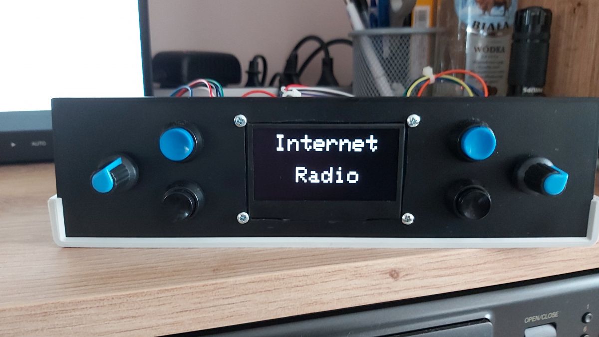

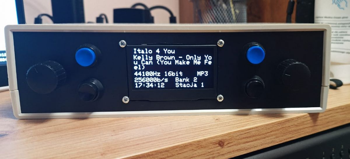

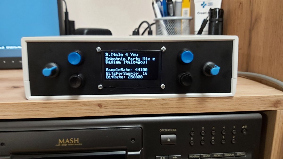

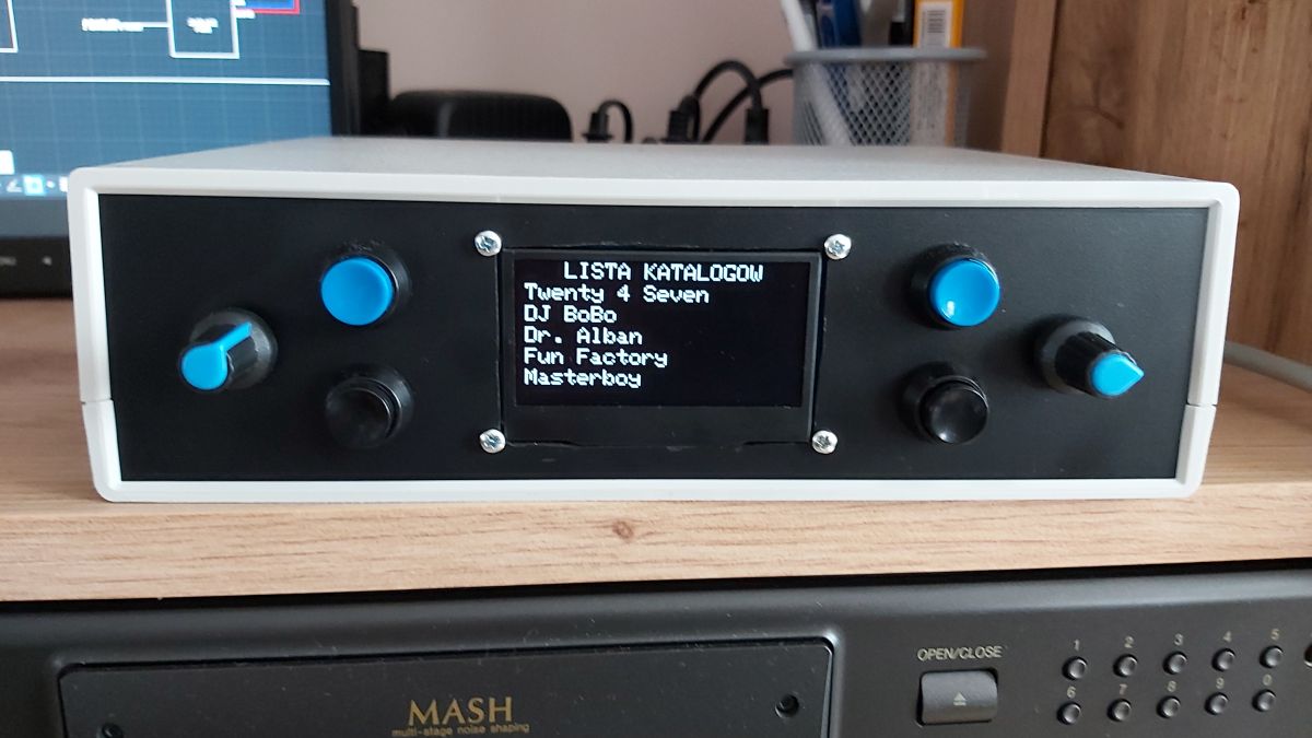

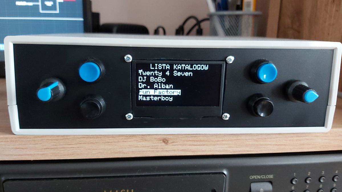

    Currently this is what the file playback and radio looks like:
    Homemade internet radio with an OLED display. Prototype of an internet radio with an OLED display on a desk.

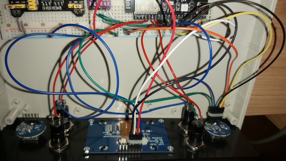

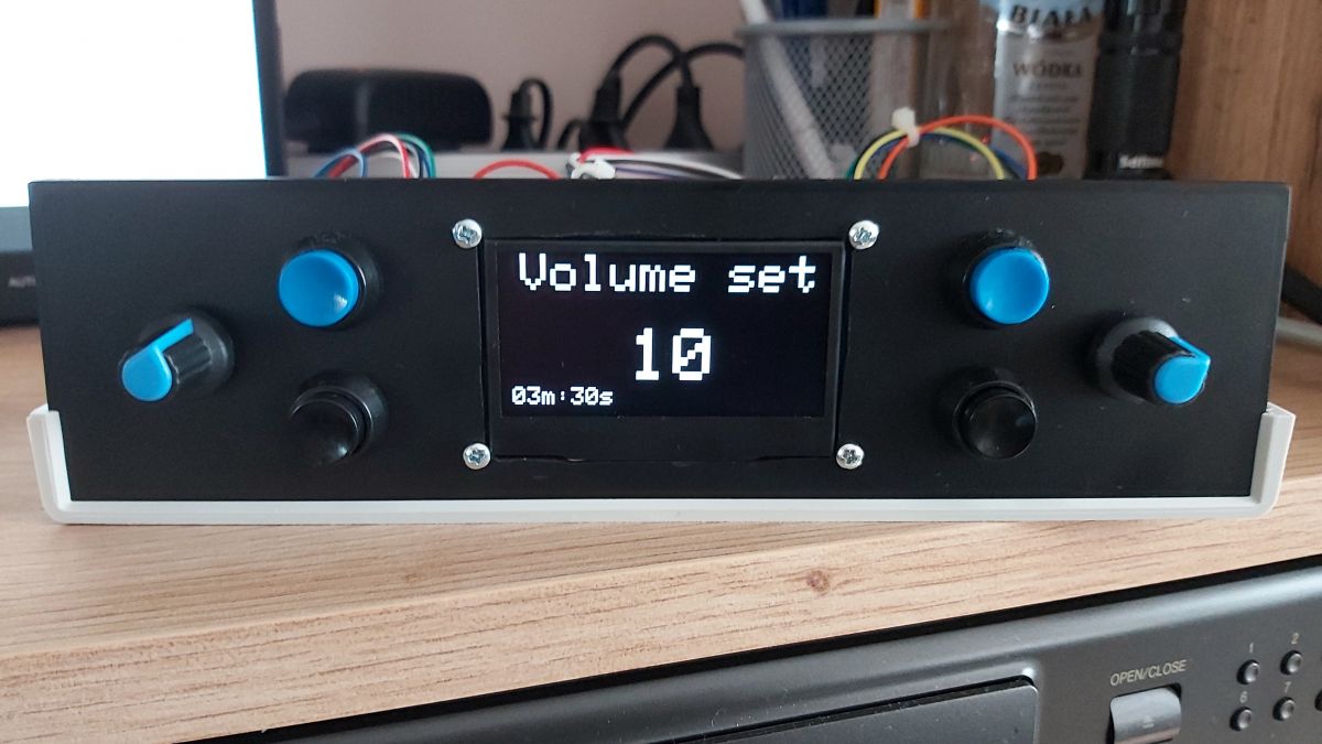

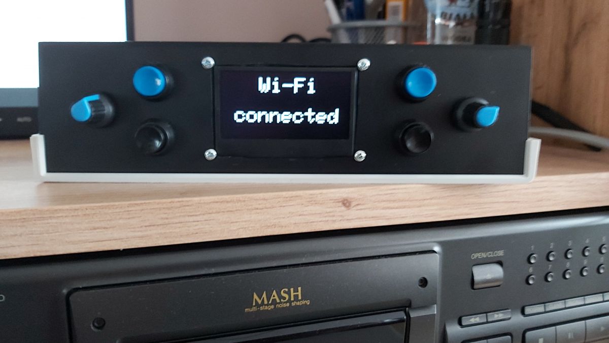

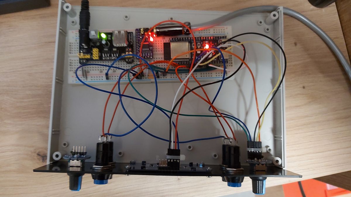

    And this is how it looked during earlier works:
    Interior of a prototype internet radio based on the ESP32 module, with colorful wires connected to a breadboard. Interior view of a prototype internet radio on a breadboard with an ESP32 module and OLED display. Prototype of an internet radio with an OLED display and buttons. Prototype internet radio with OLED display on a desk. Prototype of an internet radio with an OLED display on a desk. Prototype of an internet radio with an OLED display on a desk. DIY internet radio with OLED display and buttons. Prototype internet radio with OLED display and knobs. Prototype internet radio with OLED display and knobs.
    DIY internet radio with OLED display and knobs. Prototype of an internet radio with an OLED display. Homemade internet radio with an OLED display showing Wi-Fi connected.

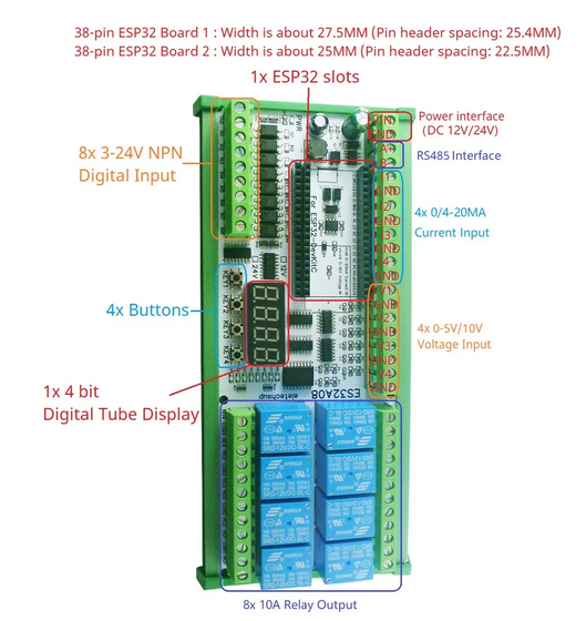

    MAJSTER XXL wrote:
    Unfortunately, I did not notice a single error. When I downloaded the ESP32-S3-WROOM-1 primer from the EasyEDA database, it turned out that there was a difference in the pin spacing across the width of the module. Perhaps there were different versions, but finally, after slightly bending the pins, it was possible to place it on the base board.
    Recently I was looking for an 8ch driver. I found this board:
    8-channel controller with various connectors and component labels.
    I was surprised that the modules come in two widths. As you can see, it is worth using 2 rows of pins (or holes) in the prototype board.

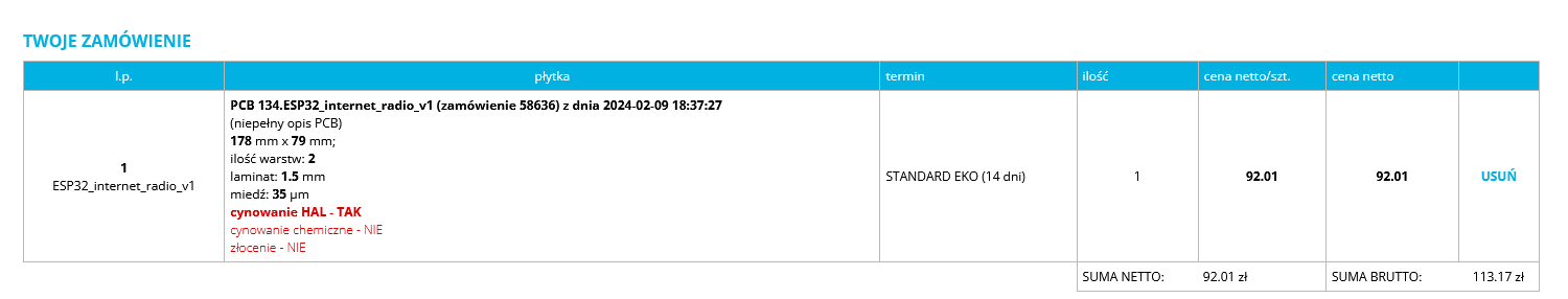

    I drew the board in EasyEDA - I will be happy to share the project, but I don`t know how to do it in this tool yet. It`s nice if someone could adjust this spacing, and then it`s worth making a smaller tile and laying it out better.
    Then I ordered a tile from Satland, and I had to wait almost a month for one piece. Probably the last time there, at that time I would also get probably 5 pieces from JLC at the same price.
    Order for PCB ESP32_internet_radio_v1.
  • #11 20999177
    ArturAVS
    Moderator
    Posts: 26233
    Help: 2297
    Rate: 7776
    Recently I ordered 5 pieces 150x80 mm from JLCPcb, they arrived in exactly two weeks. Price ~$21. To tell you the truth, you designed your board quite lavishly. :D

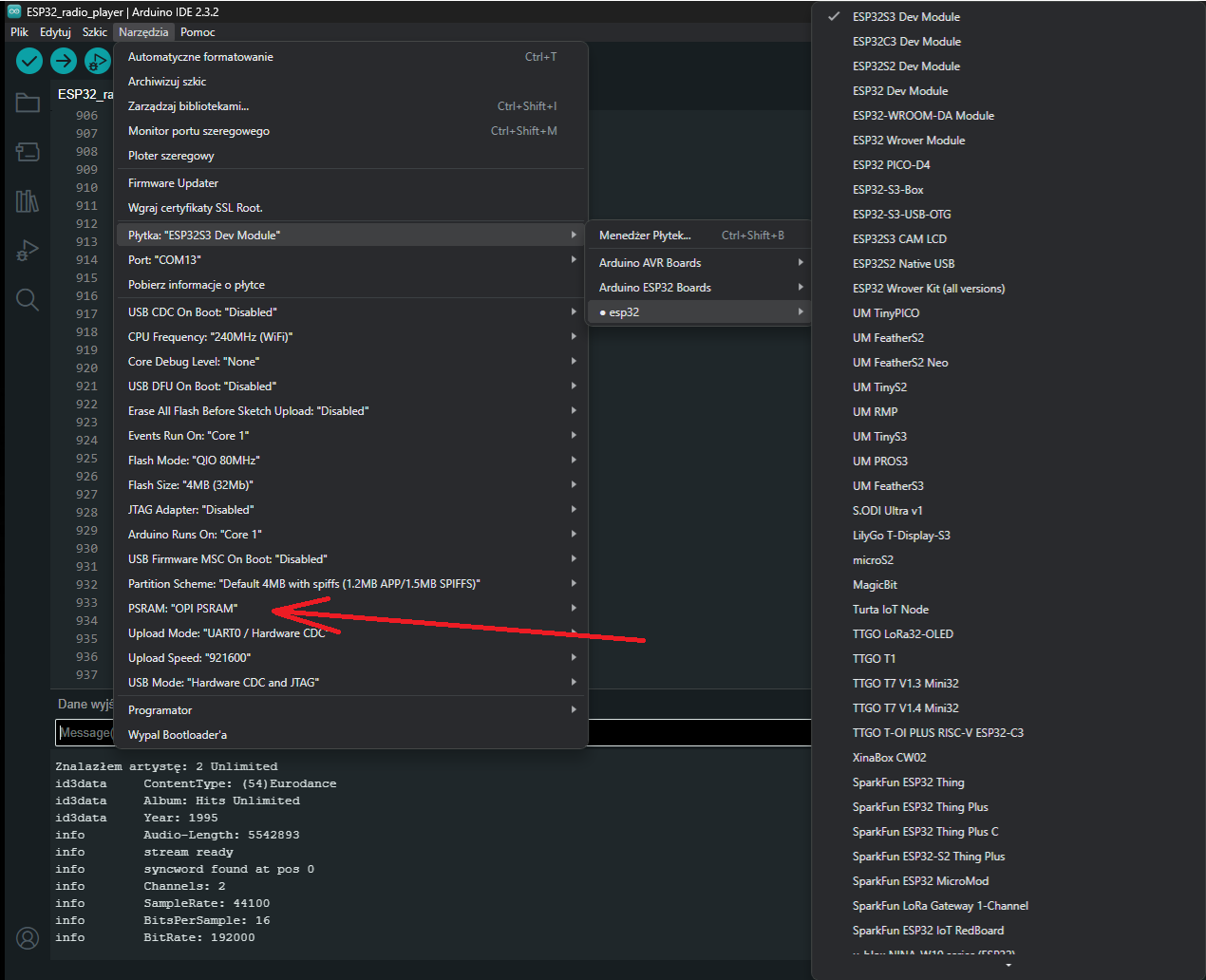

    Arduino IDE is now in version 2.3.2, you need to add a package to support Espressif devices, I used the online installer for the entire package:
    https://dl.espressif.com/dl/esp-idf/
    You also need to enable PSRAM:
    Screenshot of Arduino IDE 2.3.2 with expanded configuration menu for ESP32 highlighting PSRAM setting.
