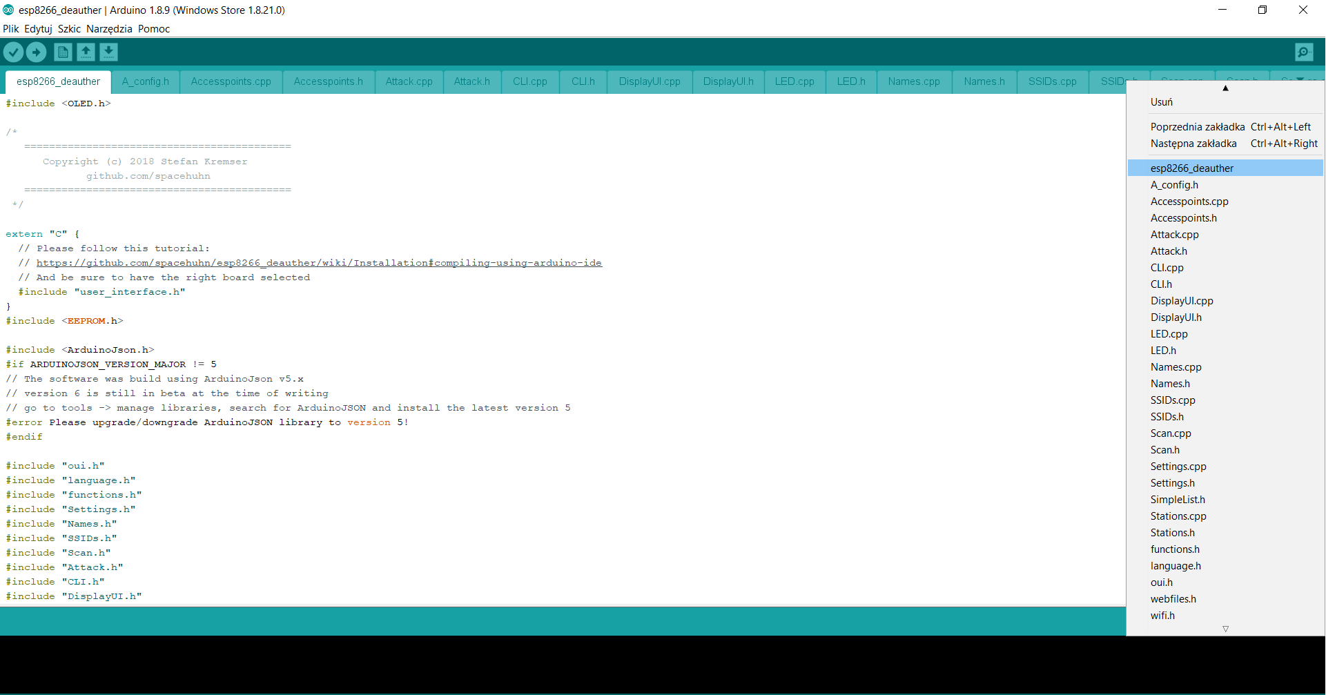

    khoam wrote:
    Ch4ist0 wrote:
    and now exit status 1
    And now you need to show what your .ino file looks like
    I don't know what you're compiling, but it looks like you're trying to compile two open .ino files at the same time, each with a setup() and a loop(). This is unlikely to work.
    Well yes actually there are two because I downloaded some Adafruit_SSD1306_esp8266_64x48 Modified libraries and tried to add that....
    How do I do it correctly on this software ? what to add and how, I have downloaded the u8g libraries ...
    my .ino file is:
    Code: C / C++

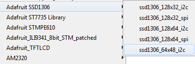

    If you go deeper into the link from #post 2 you can see an example for this screen: https://github.com/mcauser/Adafruit_SSD1306/tree/esp8266-64x48/examples. Just go back to the top, download the library, unzip it and upload it to a directory or add it as a zip library, restart the Arduino, open the example and upload it. The header file (h) defines an address of 0x3C and a screen of 64x48. For this to work, the Adafruit_GFX library must still be uploaded.
  • #16 17989272
    Ch4ist0
    Posts: 21
    Rate: 8
    kaczakat wrote:
    As you go deeper into the link from #post 2 you can see an example for this screen: https://github.com/mcauser/Adafruit_SSD1306/tree/esp8266-64x48/examples. Just go back to the top, download the library, unzip it and upload it to a directory or add it as a zip library, restart Arduino, open the example and upload it. The header file (h) defines an address of 0x3C and a screen of 64x48. For it to work the Adafruit_GFX library must still be uploaded.
    OK. so I open the file "esp8266_deauther.ino" in arduino, add the Adafruit library, save, open again, compile and that's enough ? or do I have to change something in the A_Config.h file after adding the library ???

    Ch4ist0 wrote:
    OK. i.e. i open the file "esp8266_deauther.ino" in arduino
    i don't know where you got this from. You can see on github that there are examples like this inside:
    How to configure OLED 0.66 I2C with esp8266_deauther on WeMos D1 mini? .
    Well then, after downloading this library (others from Adafruit to this screen you have to hide/replace or overwrite those for now) you are supposed to see the same thing in the examples:

    Tell me how exactly to add this library to which tab in Arduino, to A_Config.h or to the main one ? Because I don't understand...

    Where do you see this file "LEDDisplay.h/.cap" I don't see it in the project "esp8266_deauther", there is only "DisplayUI" and its contents are:
    ddbbd5eaf .
    This Deauther project in my Arduino looks like this:
    esp8266_de...-2.1.0.zip (1.28 MB)You must be logged in to download this attachment. .
    How to configure OLED 0.66 I2C with esp8266_deauther on WeMos D1 mini?Bez tyt...png (67.26 kB)You must be logged in to download this attachment. .
    Do I understand correctly the libraries I have to add to the tab/file A_Config.h ????
    How to configure OLED 0.66 I2C with esp8266_deauther on WeMos D1 mini?Bez tytu..2.png (92.36 kB)You must be logged in to download this attachment.
    Where should I change the screen geometry if I don't have the "LEDDisplay.h" file ?
