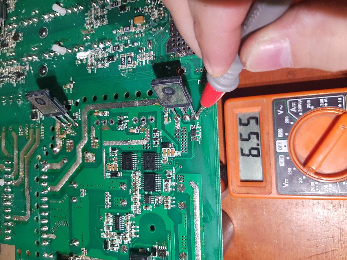

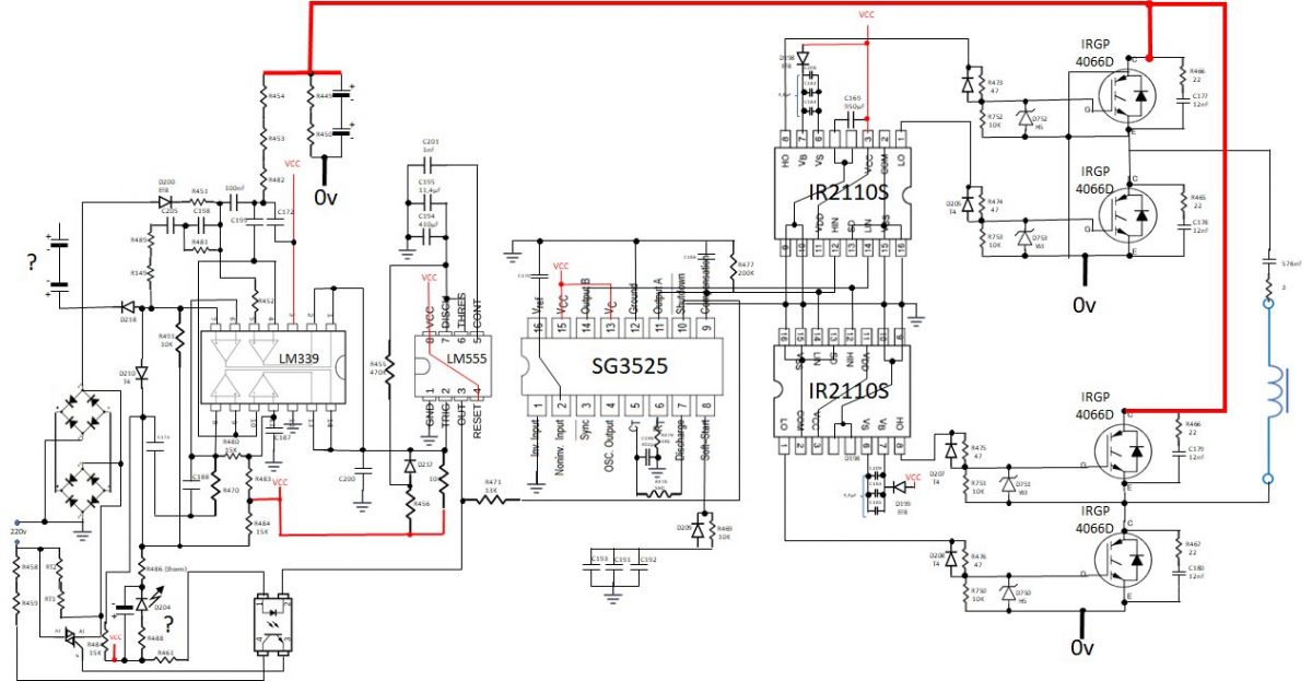

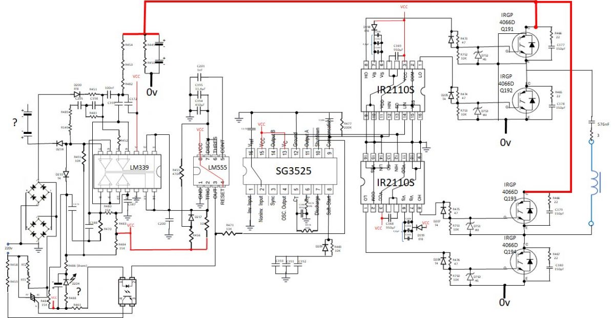

    Hi I've tried to quickly draw the IRGP command circuit - please find below my drawing - maybe there are a few errors, I did not draw all the wires, but the main purpose is there : when LM339 output is high, the LM555 pin 3 can be at 0v, the SG3525 can start oscillating providing Out A and B to the two IR2110S. PS : did not draw the viper part, providing 17v. By the way some "?" to mean "I don't know more" or "not very sure".
    So I hear the self starting then stopping every 10 sec, with my test bulb lighting quickly for each start (so once every 10s) - will check without the IRGPs ...
    Circuit sketch with LM339, LM555, SG3525, and IR2110S chips and IRGP4066D transistors.

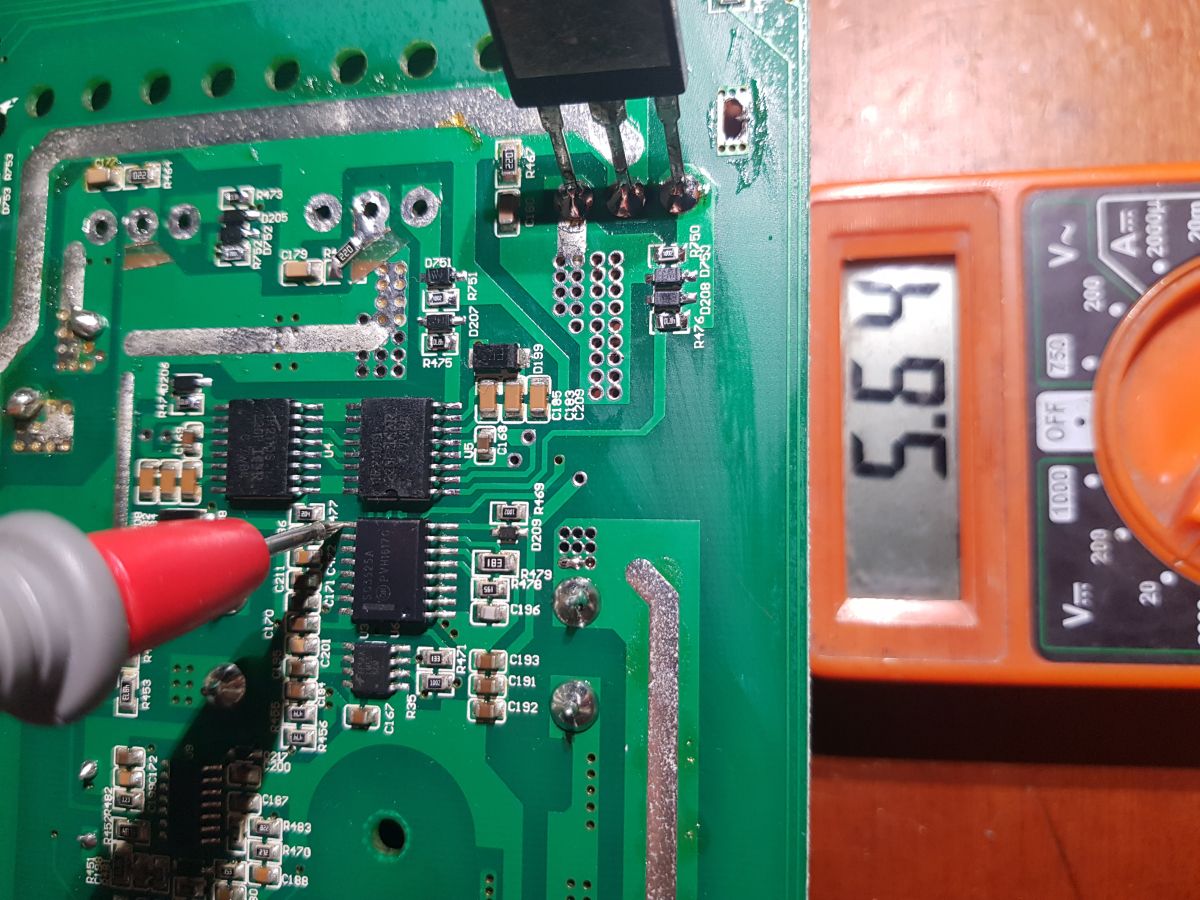

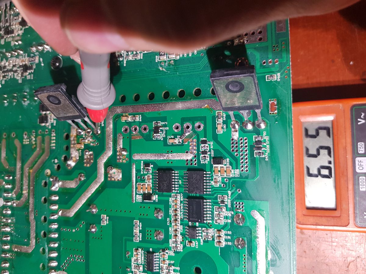

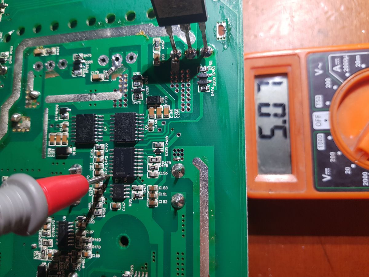

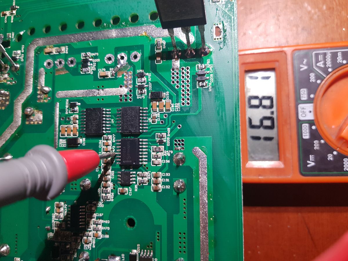

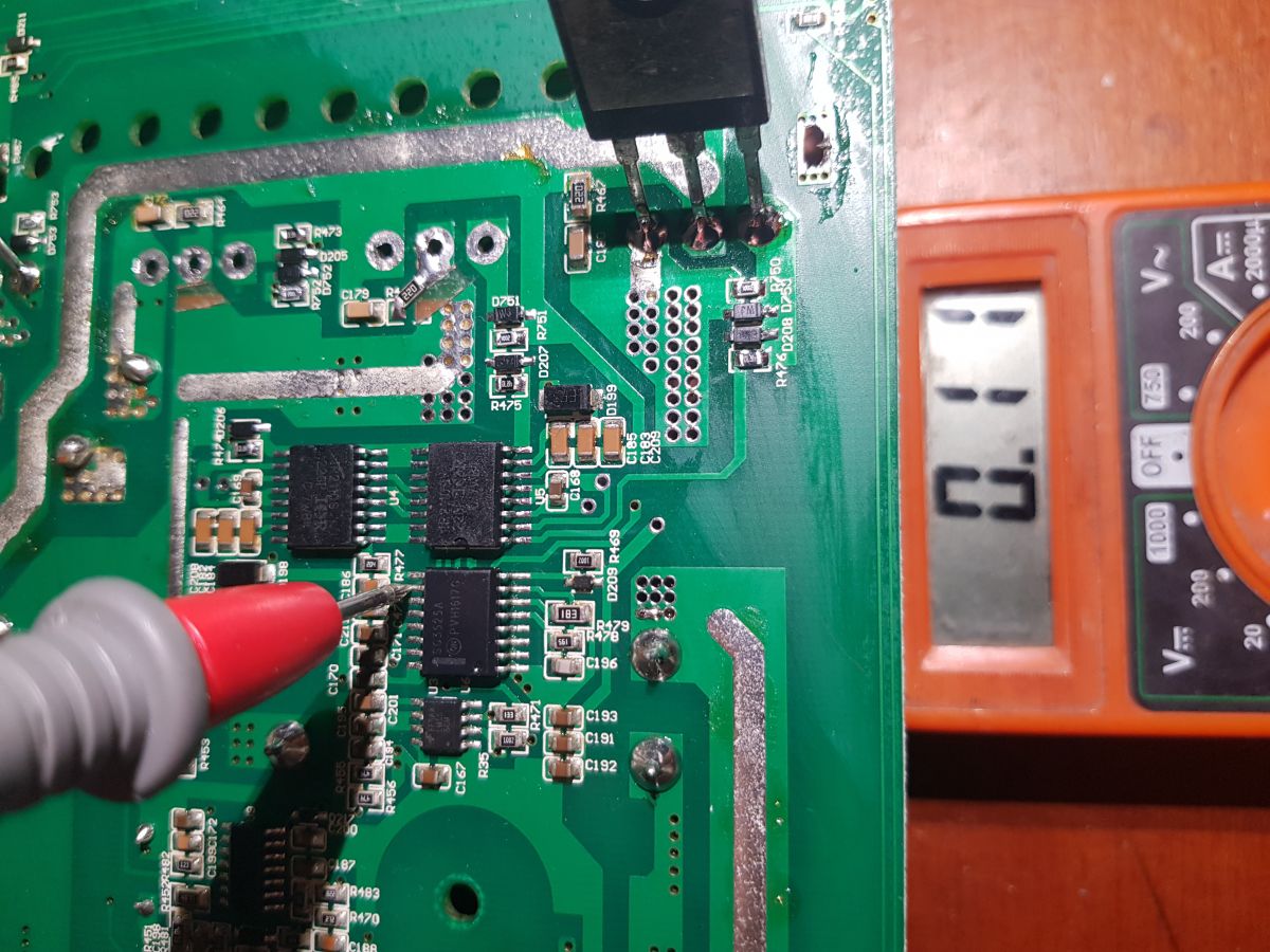

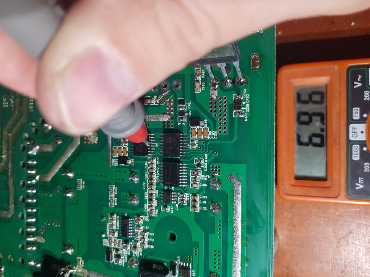

    Rate: 9

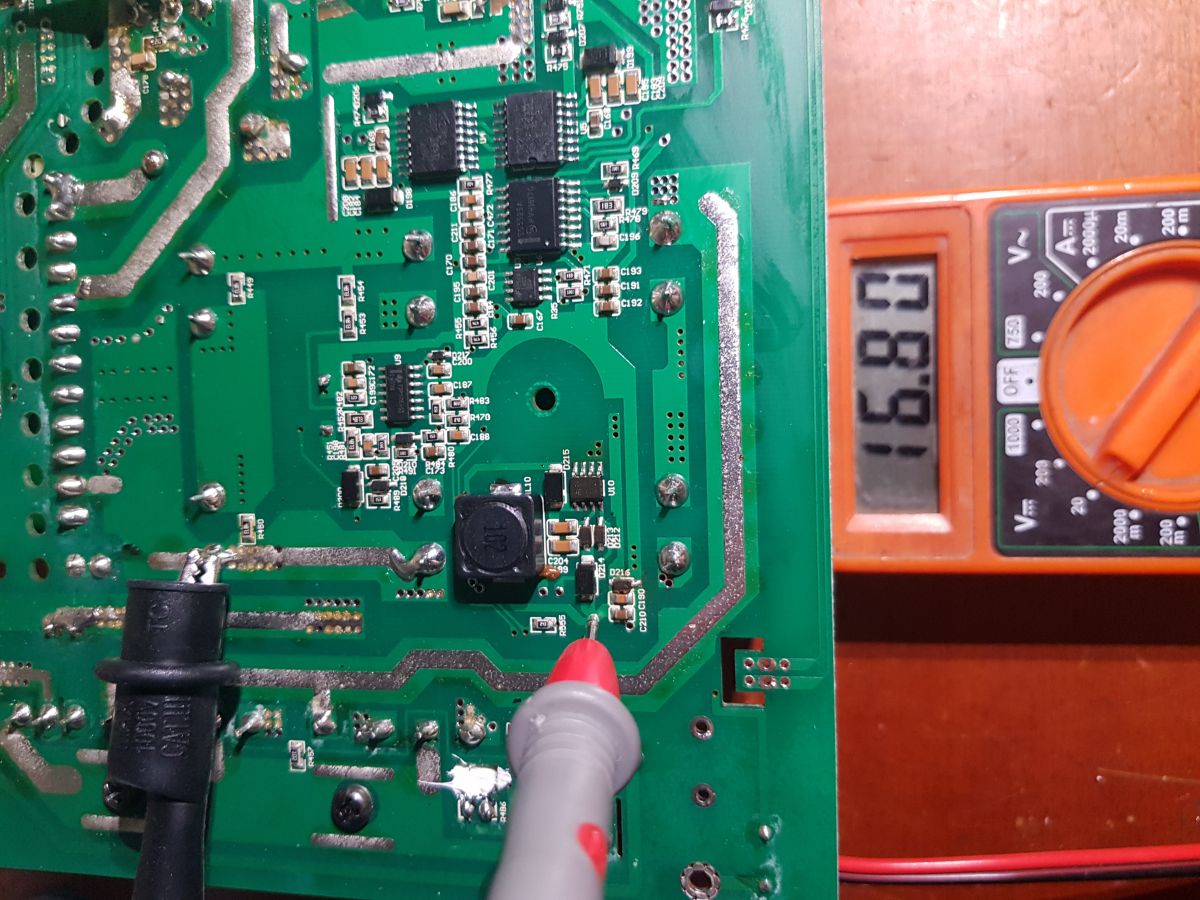

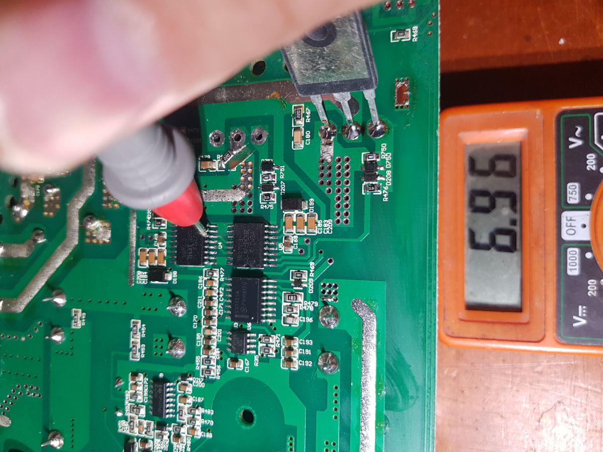

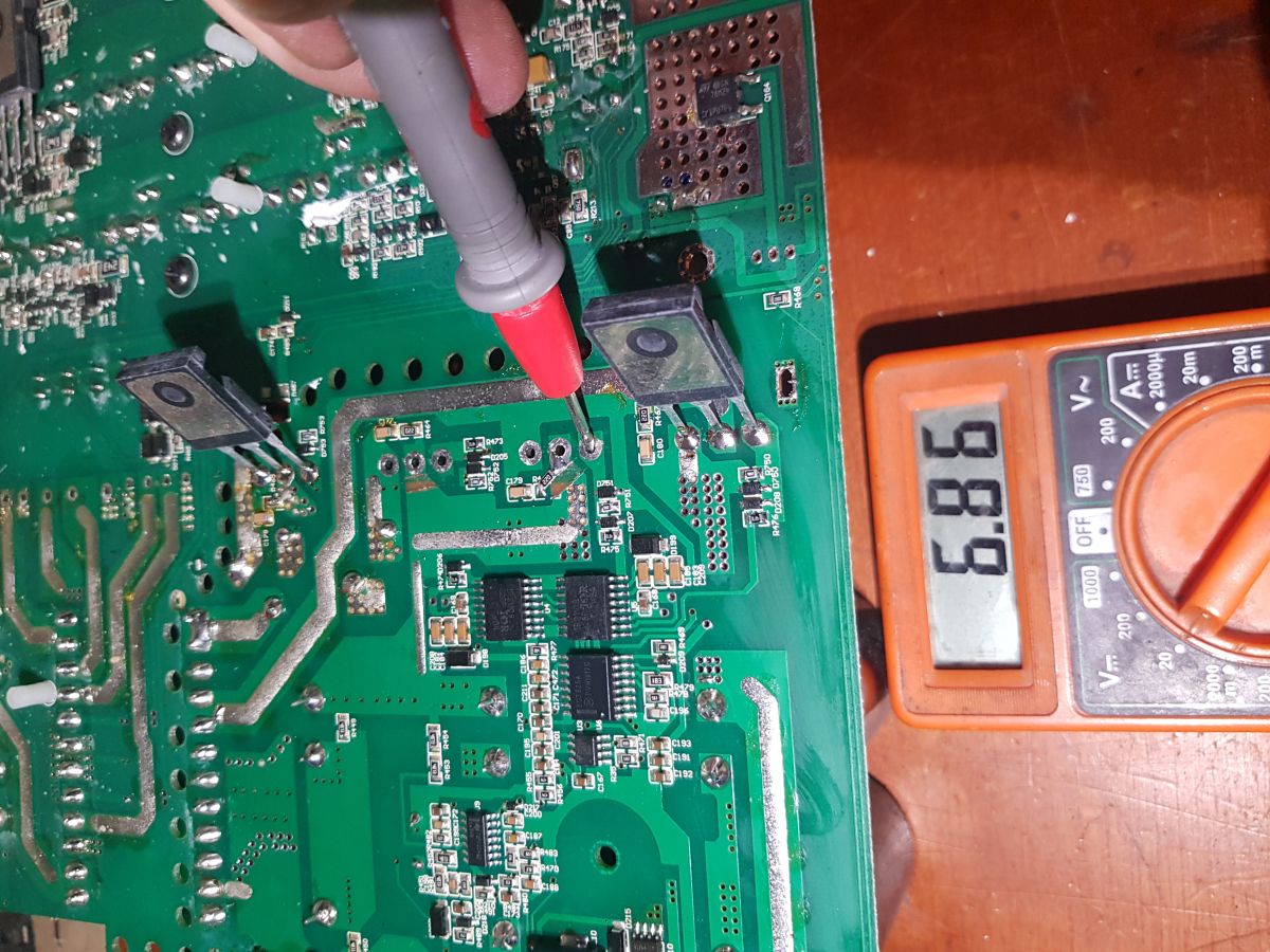

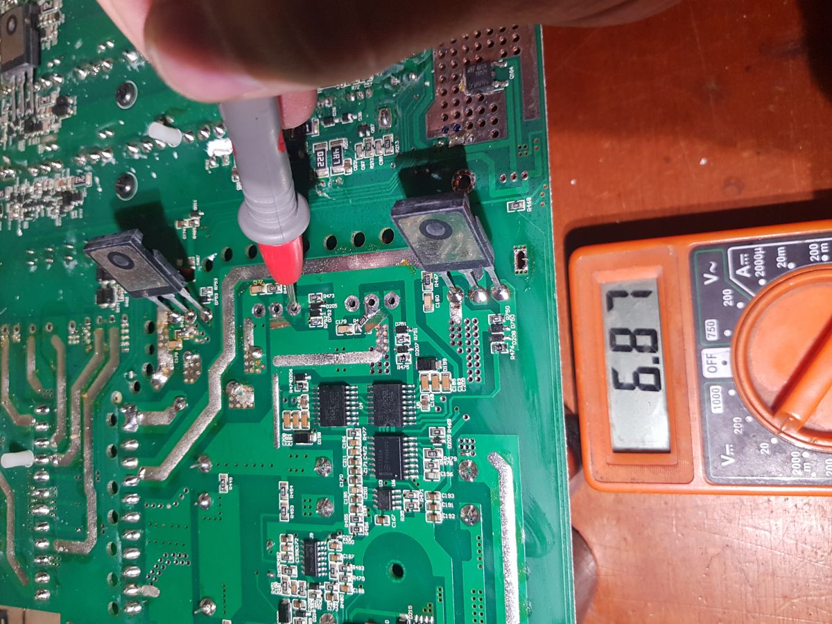

    What wattage of bulb?
    What voltage do you have on these points ?
    Multimeter measuring voltage on a PCB, displaying a reading of 6.87. .

  • #336 21390436
    Robercikxxx
    Posts: 141
    Help: 8
    Rate: 9
    On which mileage you have , take a picture and mark it.

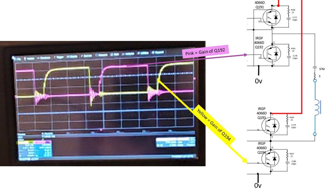

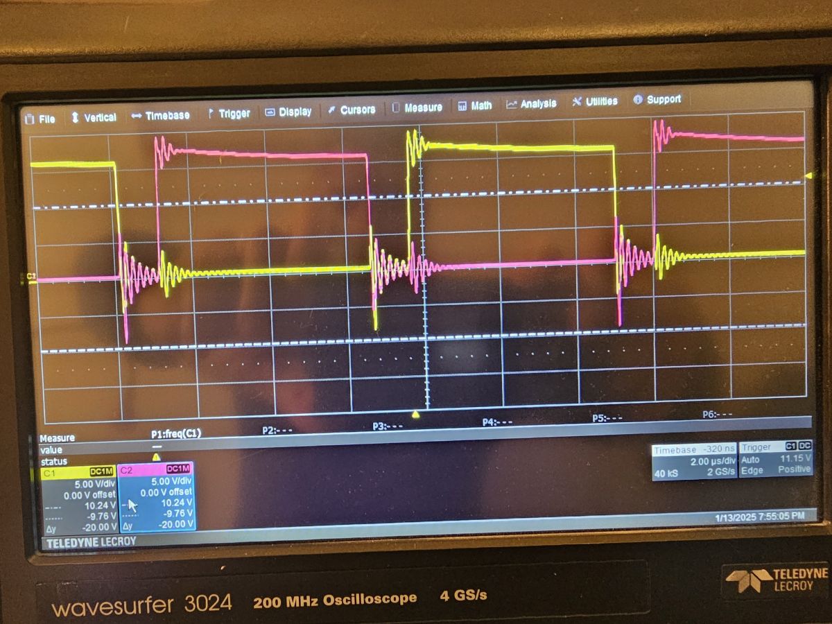

    I will try later thank you. I've changed again the two 2110 and now I have square but only on two IRGPs. On your picture, is it normal that only 2 IRGPs are soldered ?
    Can you show me the signals you have on the 4 gates of 4 IRGPs please ?
    Thanks again
    Added after 11 [hours] 25 [minutes]:
    Sorry, I did not see that your measurements were on the four gates. I've unsoldered all IRGPs - should I solder at least two IRGPs as on your picture to mes the gate voltage ?
    My bulb is 160W (actually, two bulbs : 100W + 60W).
    Added after 1 [hours] 20 [minutes]:

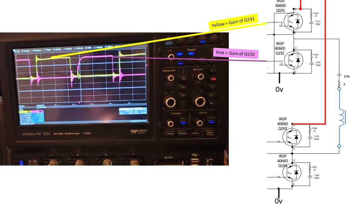

    So here is out A and out B signals
    Oscilloscope screenshot showing two square wave signals in yellow and pink.
    voltage measured :
    SG 3525 :
    - pin 16 = 5v
    - pin 13 = 17v
    pin 10 = 0,11v
    pin 9 = 5,69v
    IRGPs see picture :
    top IRGP (gate D753/R753) : squared signal in yellow (following Lo signal of IR2110 U4 )
    bottom IRGP (gate DD750 R750): opposite squared signal in pink (following Lo signal of IR2110 U5) :
    Oscilloscope display with square wave signals in yellow and pink.
    but on the two gates of the two others IRGP (from HO of the two 2110), I have a constant 14v voltage.
    Once again, the 4 IRGPs are unsoldered during these measurements.
    Any advice ?

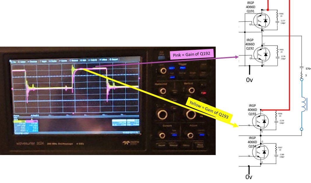

    Hi - I've modified the schema :
    Electronic circuit diagram with components LM339, LM555, SG3525, and IR2110S.
    And after having soldered only Q192 and Q194, I had the following signals :
    Oscilloscope displaying voltage signals at transistors Q192 and Q194.
    Oscilloscope screen with signal waveforms and circuit schematic.
    Oscilloscope displaying signals on transistor gates in an electronic circuit.
    So before soldering Q 191 and Q193, I wonder if those signals seem to you ok as they are not very proper square signals, with bouncing at the rising edge of Q191 and Q193, but maybe it's because Q 191 and Q193 are not soldered and so no C179 and C177 filtering cap.
    What do you think ?
