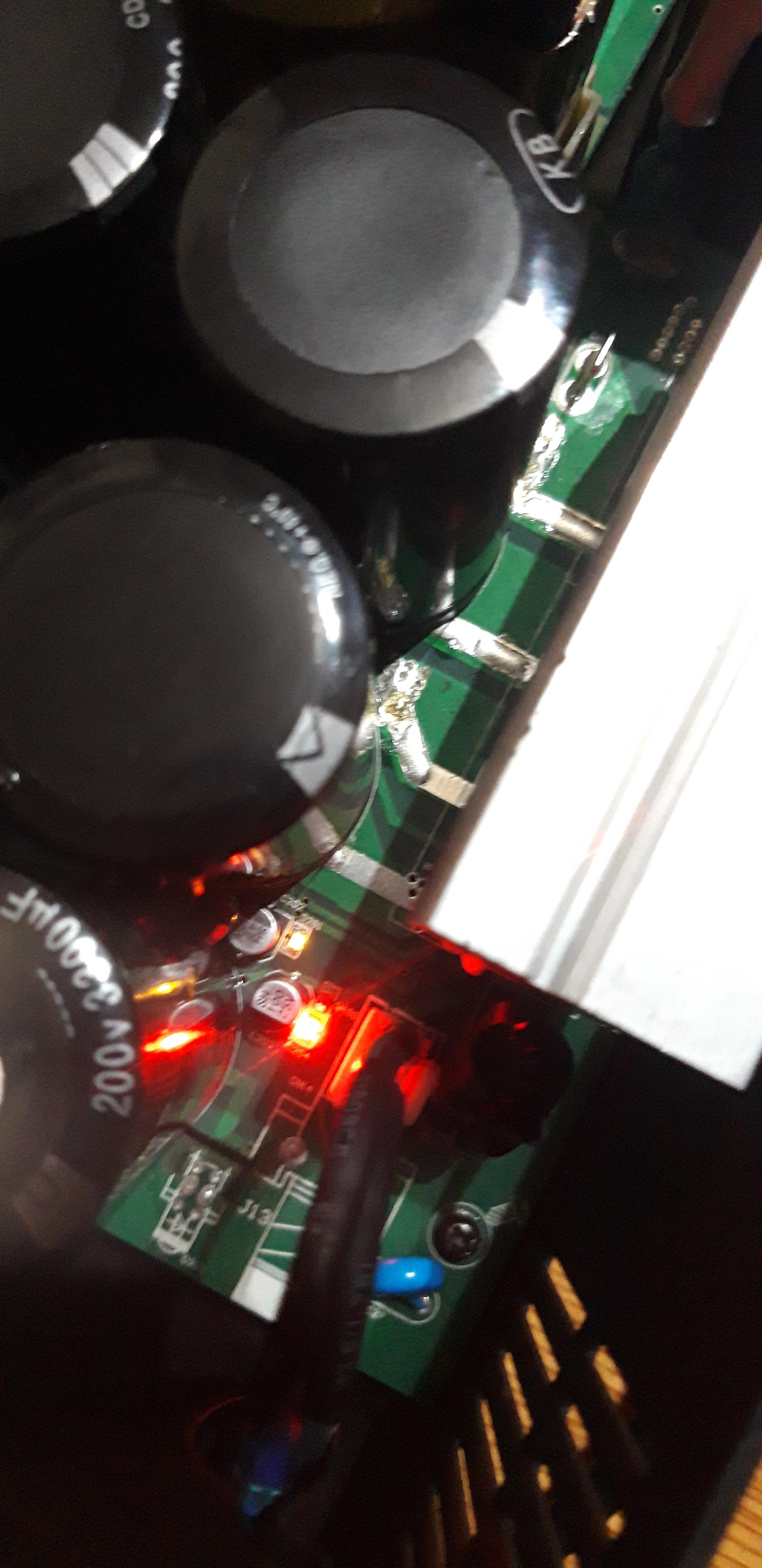

T.amp TSA 4-1300 Power Amplifier Issue: Not Turning On, Red Diode Flashing, No Visible Damage
Matek920605 85128 348
Why won’t the TSA 4-1300 power amplifier start, with the red board LED flashing and no obvious burn marks?
Most likely the flashing red LED means the small step-down supply is going into overload/restart because something in the inverter/output section is shorted [#18372738] In this model the usual root cause is blown primary-side IGBTs/IRGP4066D; one user found them “literally fired” [#18265750], and another explained that the SG3525 PWM drives the IR2110 gate drivers, which then drive those IGBTs [#18265973] Reported damaged parts in successful repairs included the IGBT pair, IR2110S drivers, SG3525A, 47Ω gate resistors, 1N4148 gate diodes, 15V zeners, and sometimes the GBU2506SF bridge/triac [#18505704][#21080060] A good diagnosis path is to check the output transistors for shorts first, then inspect the whole gate-driver and rectifier network before applying power again [#18265750][#18505704]

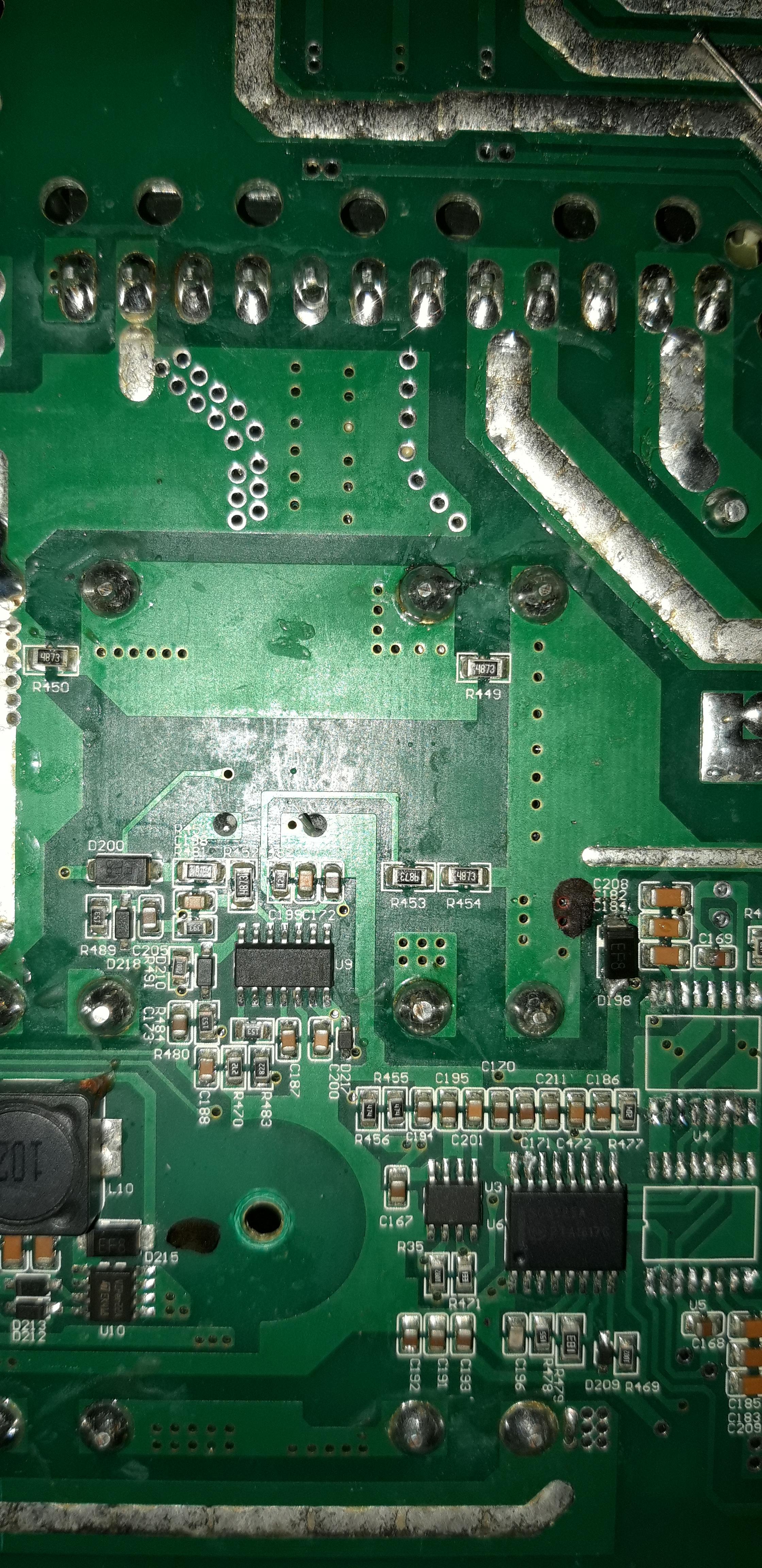

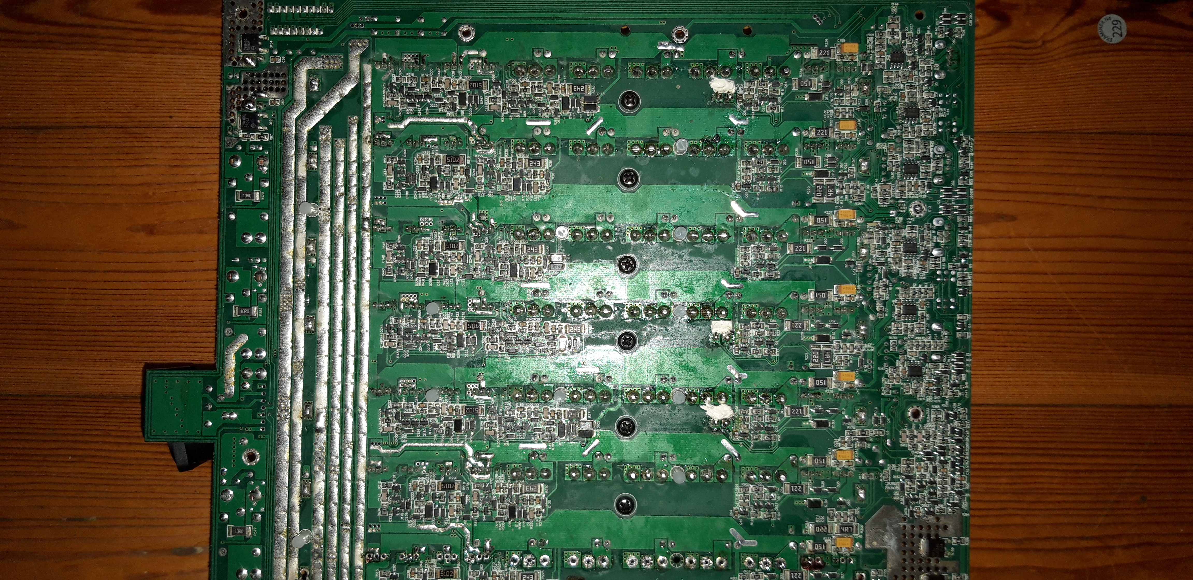

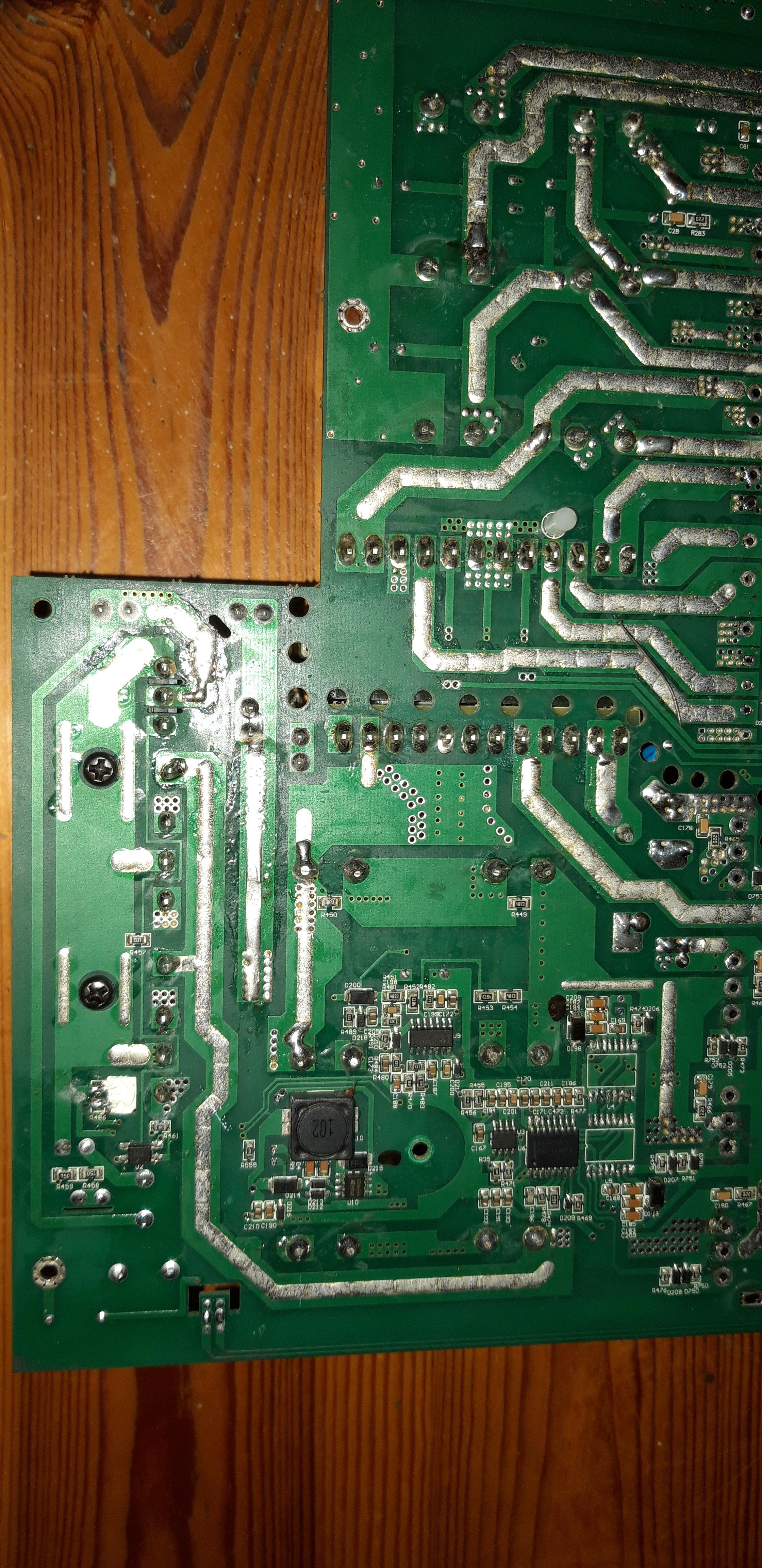

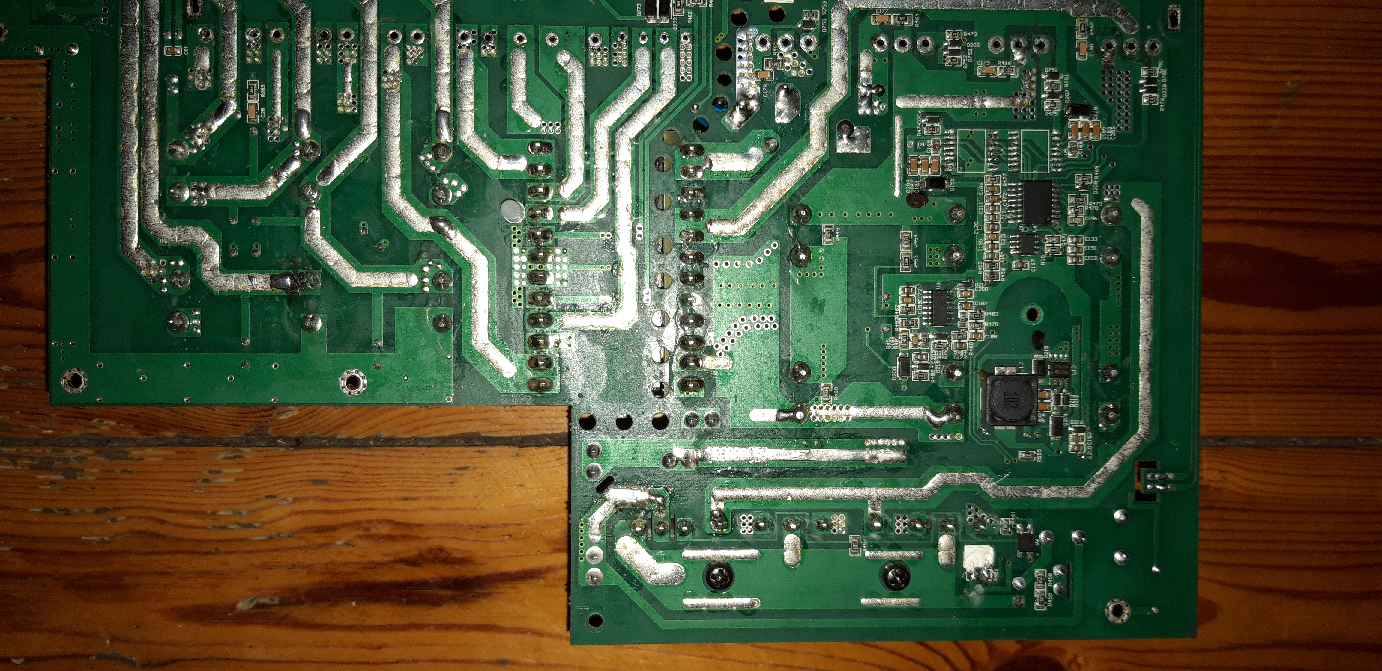

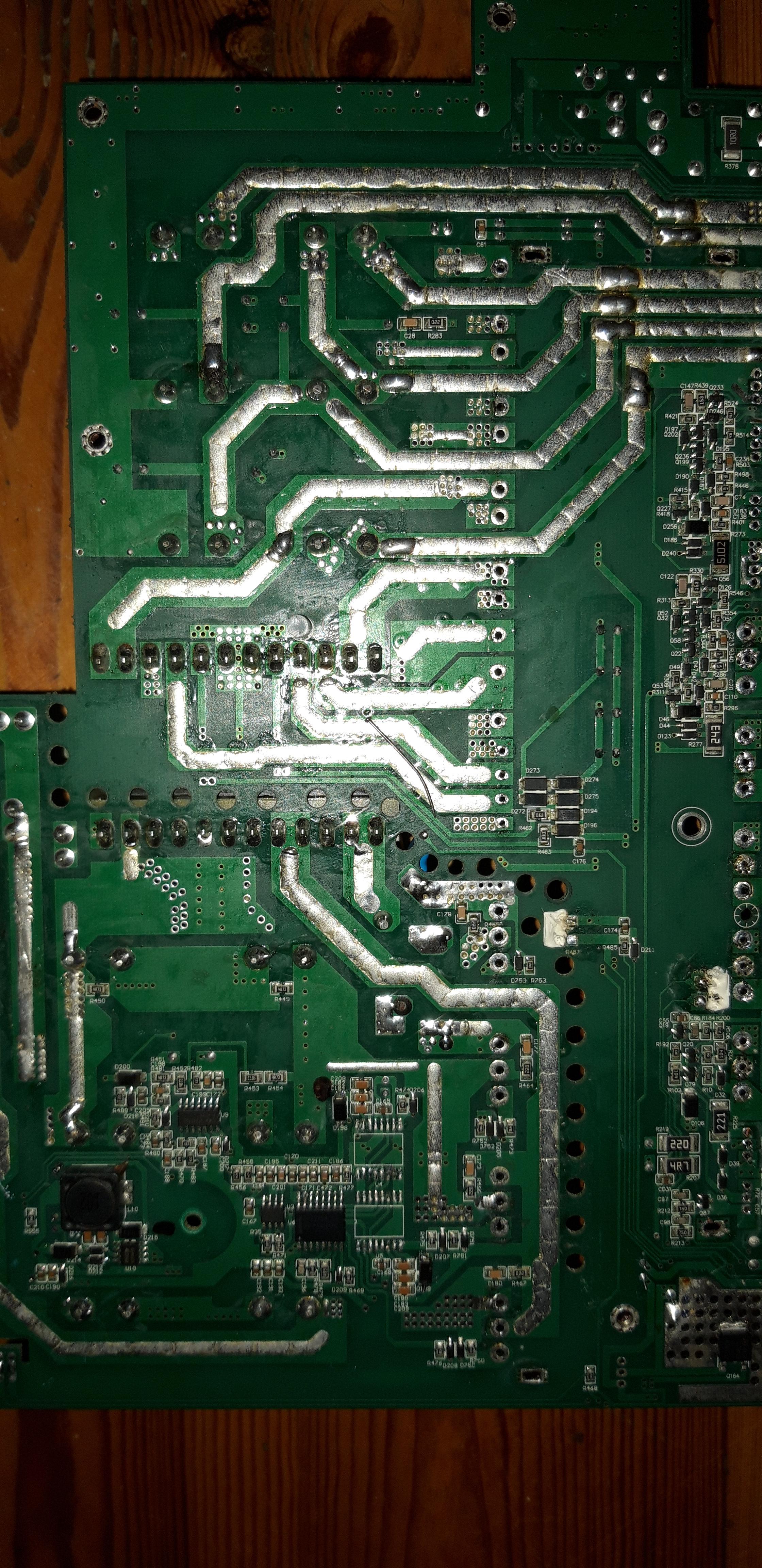

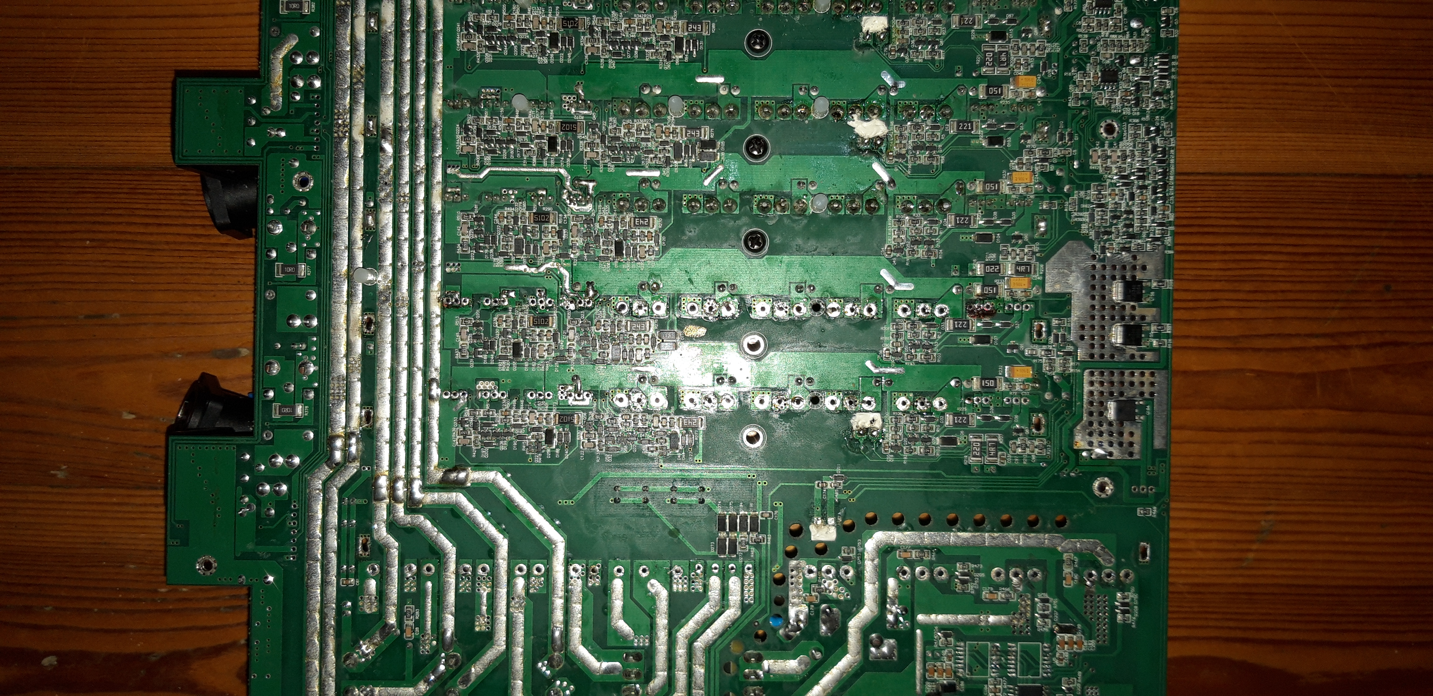

    I am sending, only IR2100S, IRGP etc. are removed

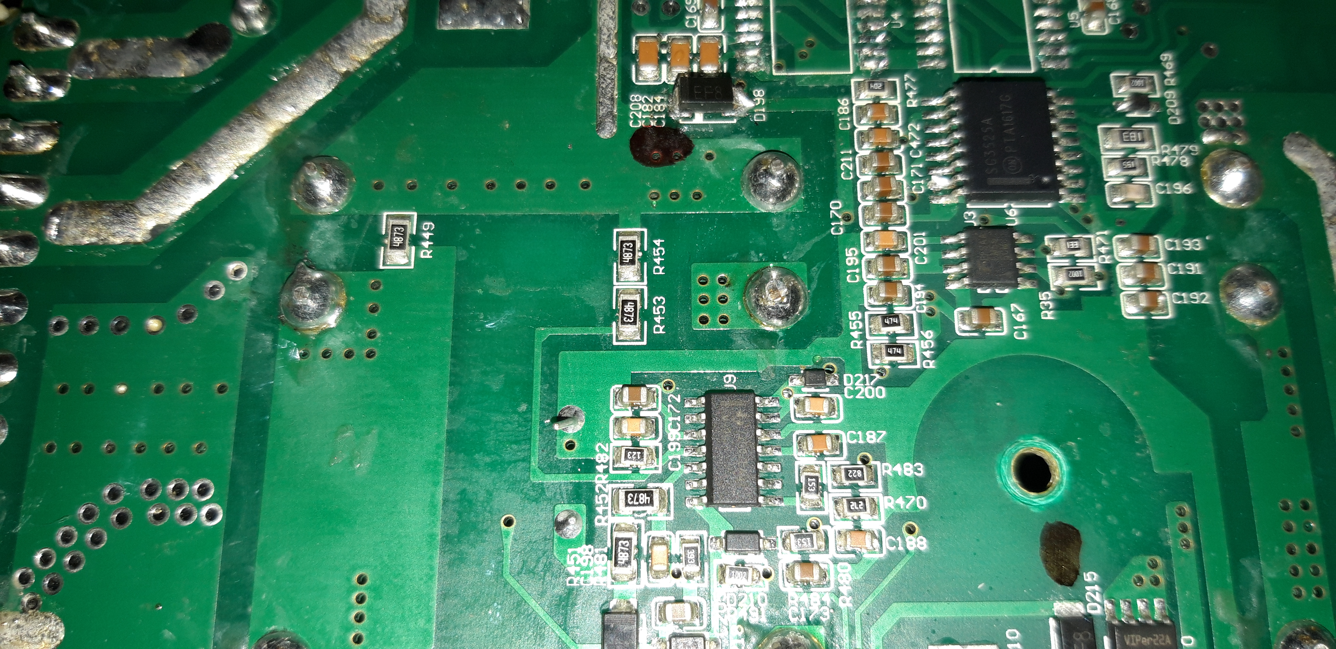

    I would like to add that after removing all damaged elements, i.e. {IR2100S x2, IRGP x4, rectifiers} - one ss heat sink
    one complete channel, I went through all the diodes marked EF8, resistors, capacitors, literally everything that is on the board - this time it turns out that everything else is working, i.e. capacitors, "EF8" diodes, etc.

    Hello, and the smaller T4 and T5 diodes with resistors are you also working? It's about this set at the output of the IR2110S, where there is key control (two sets per transistor from one IR), check, because I have lost resistors with diodes at this point.

    With these t4 diodes and these resistors, most of them, when checked with a diode meter, showed a value of about 500, on some it did not show anything, but there is also no puncture.

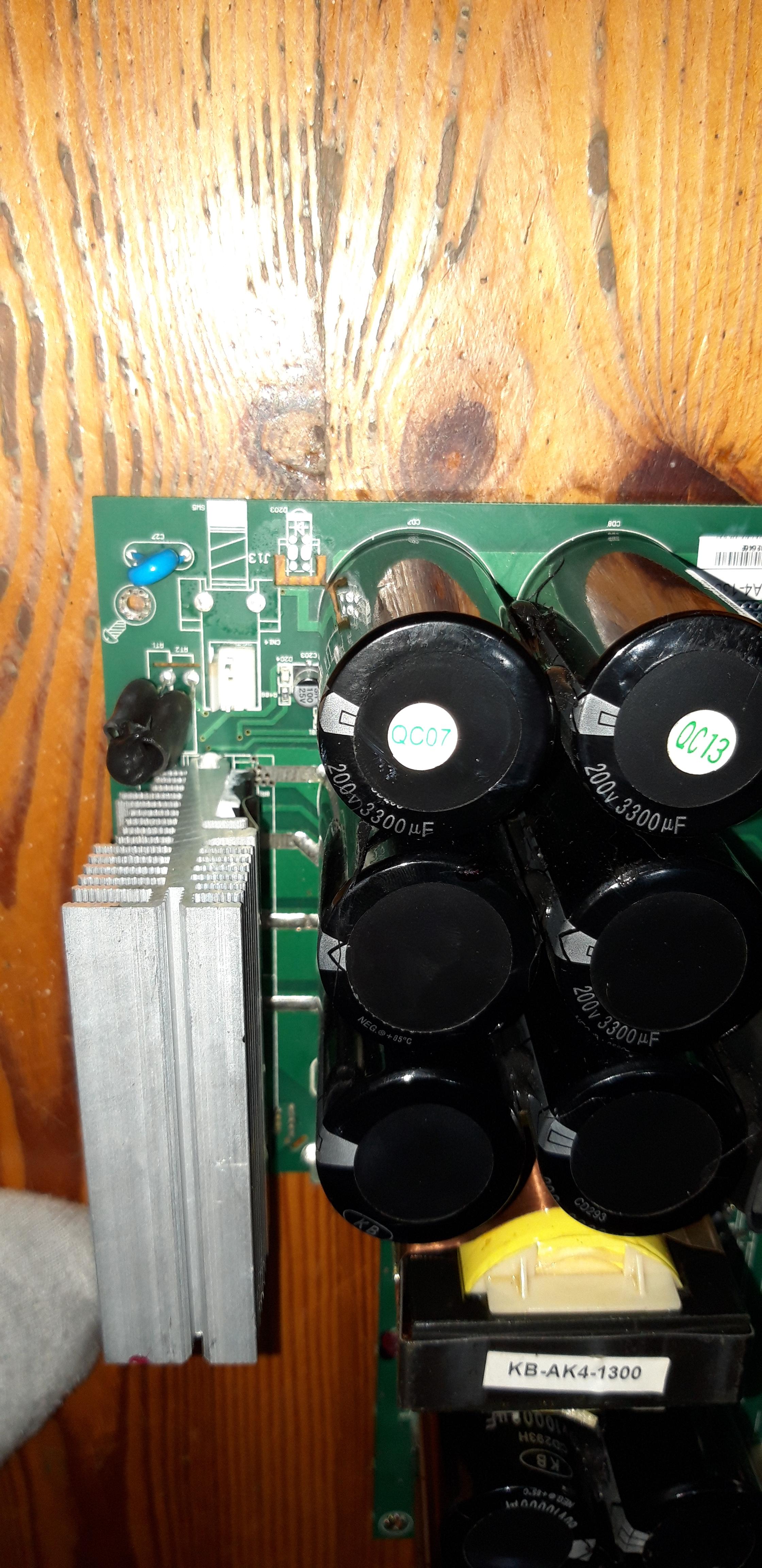

    There is a rectifier bridge under the small heat sink

    EF8 diodes are all functional, only the smaller ones marked T4 and H5 are damaged, about 8-9 pieces in total show very low values or are punctured.
    There are a lot of these small "T4" diodes on the entire board, but only those that are connected to the IRGP, ir2100s are damaged

    I am still wondering about the element marked on the board as "L10". The tester shows it as a 77.6 ohm resistor, but the meter is a breakdown

    Schottky diodes are the ones marked T4 and H5.

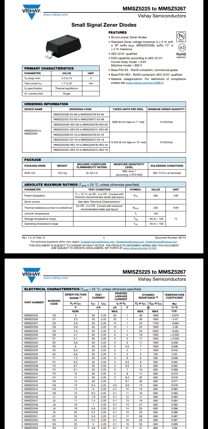

    I found a table with the markings of smd diodes, housing types, etc., the designation H5 sod123 is supposed to be 15v
    Added after 3 [minutes]:
    H5 sod-123
    • T.amp TSA 4-1300 Power Amplifier Issue: Not Turning On, Red Diode Flashing, No Visible Damage Screenshot_20191117-130147_Drive.jpg (512.44 KB) You must be logged in to download this attachment.

    The TRIAK under that little heatsink where the bridge rectifiers are is BTA41-600B, 600v 40A. I checked with the tester and it is damaged, however

    Desolder the triac to check, in the motherboard it shows as if it had a short circuit. I was the same.

    Well, I checked it under the tester, which was desoldered, it shows a resistor instead of the triac

    I just received the last parts of the amplifier. The amplifier is assembled, I fired it, luckily nothing exploded, nothing was burnt. However, the fans do not start and the LEDs on the front panel were barely lit at first, and then they began to go out slowly. it seems to me that it is the fault of the rectifier bridges, measuring them earlier as if everything was fine

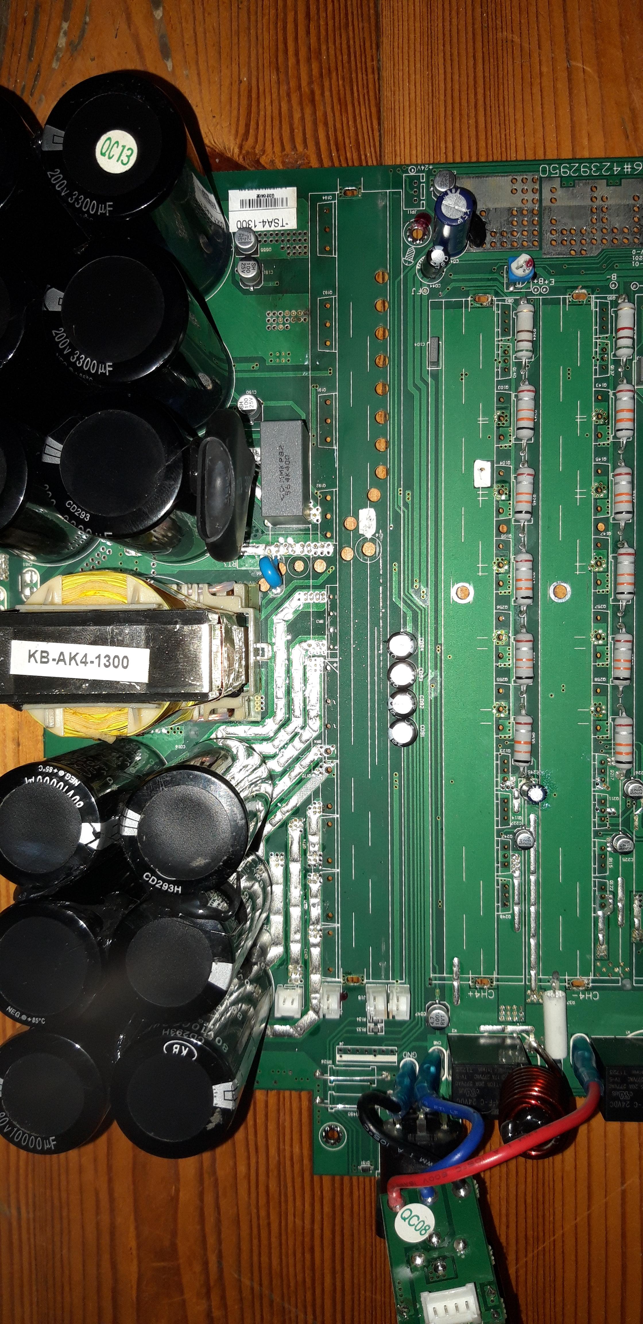

    I reviewed the replaced elements again, I corrected February on Ir2110s (one pin was not prepared. I put everything together and turned on. This time after about 4 seconds you can hear the transformer turning on, the LEDs on the front panel do not turn on. Waiting a few seconds, the LEDs shown below on the motherboard they turn off, the transformer is no longer audible, after about 2-3 seconds the diodes light up again and you hear that the transformer is also working, but after a while it turns off again and again. Nothing heats up, nothing fires.
    • T.amp TSA 4-1300 Power Amplifier Issue: Not Turning On, Red Diode Flashing, No Visible Damage 20191227_192406.jpg (1.06 MB) You must be logged in to download this attachment.
