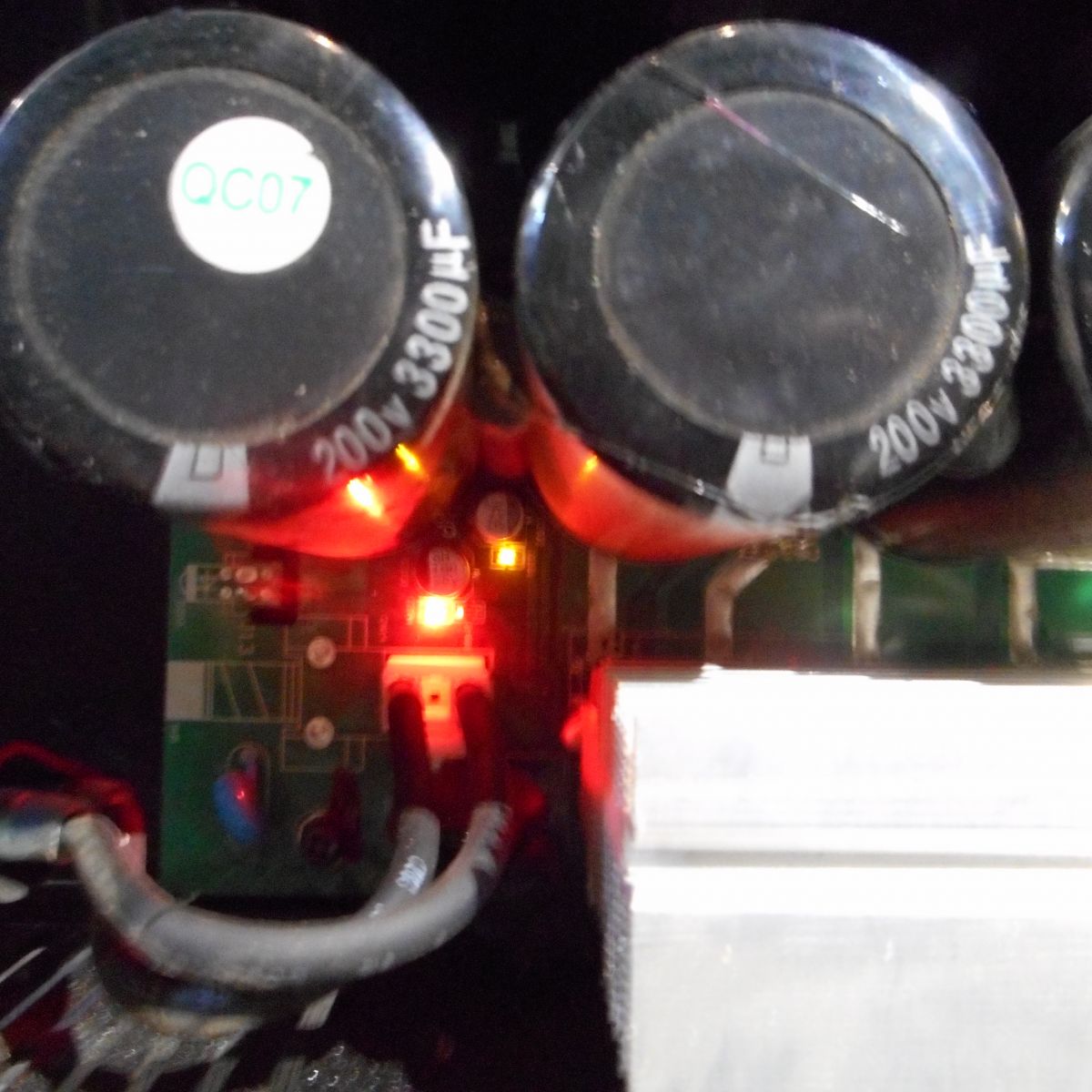

    Hello, I'm new on this forum... I have a problem with my TSA4-1300 amp, with a start failure. I had read the topic but most of the explanations are hard to understand. I'm not an electronic engineer and my English is not so good ...
    Few days ago, my amp didn't want to start, today I opened it to look inside but I didn't see something wrong. Today it randomly started 3 times and I can't explain why.
    I have 2 LEDs that turn on when it's in failure, the D201 in red, and the D281 in green
    Close-up of the interior of a TSA4-1300 amplifier with visible capacitors and LED lights.
    I have only a voltage meter to make measurements and the only measurement I took is AC 220V between CN33 and CN21 and AC 125V between CN10 and CN11
    Do you think it could be the transformer or it could be another part ?
    Thanks for your help

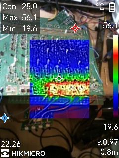

  • #306 21293625
    Kawaiito
    Level 4  
    Thermal image of TSA4-1300 amplifier showing temperature variations.
    i have a problem with the 30V from the 15+/-15 i desolder the LM24 so i mean the problem is behind him but the voltage drops to 22V and this area goe heat... all OP AMPS has the 15V on VCC and the symmetrical 15/15- works .. is to too much smd parts to find the problem. i have the solder channel 1-3 so problem was channel 1 at first there the igbt goes to fire

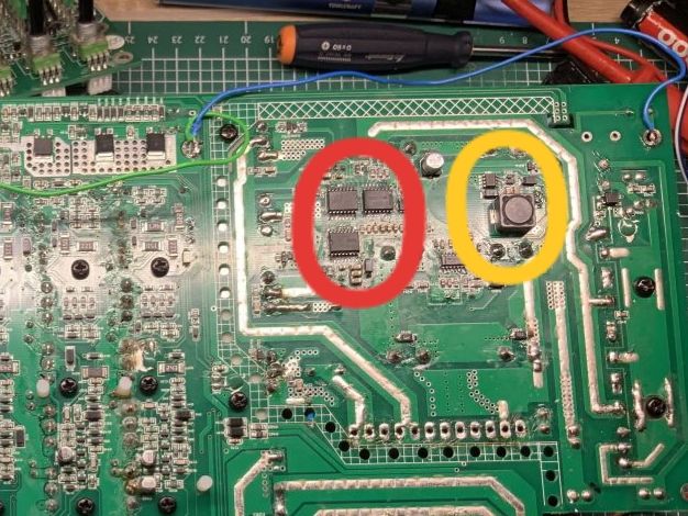

    Can somebody tell me which part gives VCC to SG3525 (pin 15), IR2110S (pin 3), LM339 (pin 3), LM555 (pin 8) please? I have high voltage on CO8 ... but no VCC on ICs and no 15V on the transformer ...
    Thank you very much for your help

    In yellow you have marked the circuit that is responsible for supplying the +17V to the inverter circuits.
    In red you have marked circuits that can be faulty and make a short circuit and for this you have no supply voltage.
    Circuit board with components marked in red and yellow. .

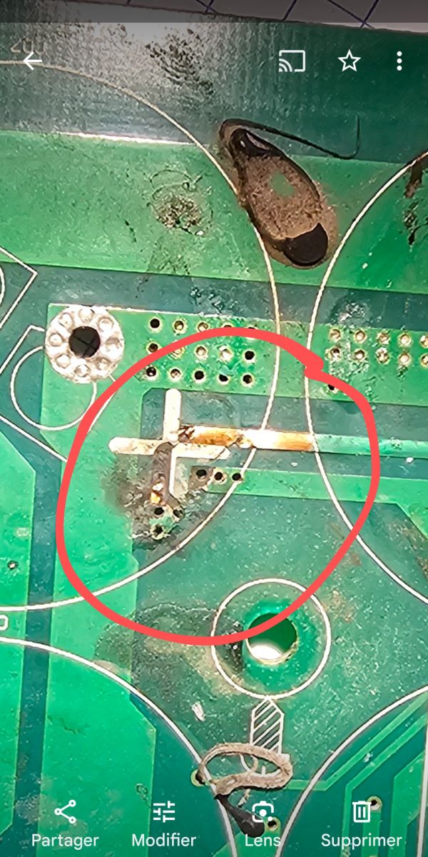

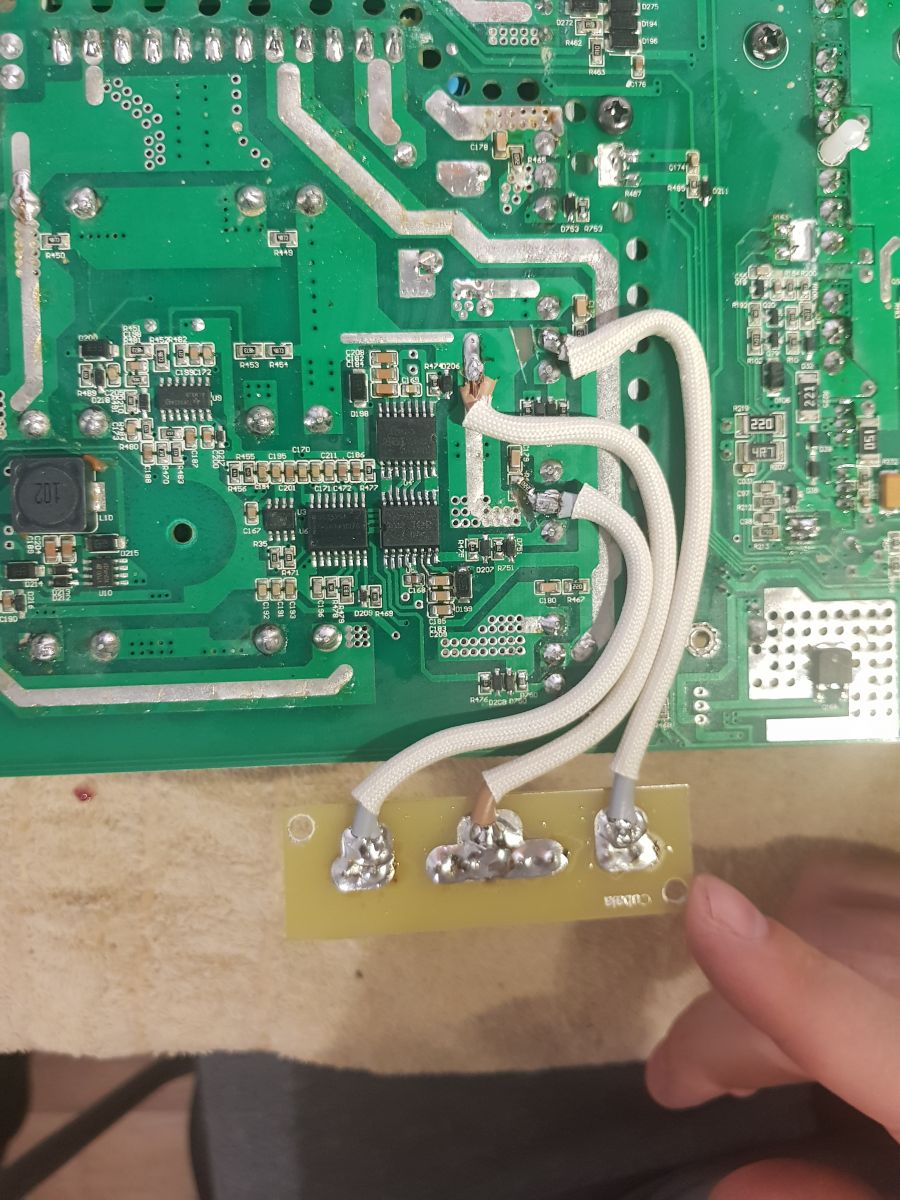

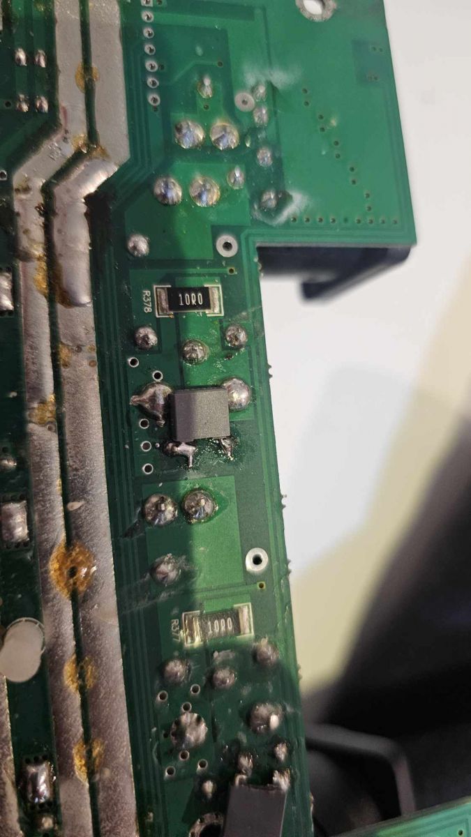

    Thanks a lot for your help and your fast reply - I found the problem: it was a broken wire under a 3300 µF capacitor (see picture).
    Now the red and yellow leds (on the board) are on (no flashing) when I power on but no led light on the front panel of the amp, no relay on, no fan on .. Got to check from where the problem comes from. I started with LM555 and I have 15v on pin 8 (VCC), pin 3 output and 10v on pin 5 (control voltage) but no oscillator wave from output - any idea?
    PS also changes 4 IRGP, the triac, two 2110S, LM339, LM555 and R 473, 474, 475V and 476.
    Thanks in advance Damaged circuit board with a broken conductor.

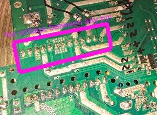

    jeanbernardsers
    Posts: 9

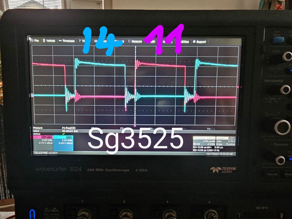

    Good news : I can see alternative signals on SG 3525 pin 11 and 14 (see picture). The yellow led turns off after a while when those signals appear (and only the red led remains on).
    But I have no voltage on any pin of the transfo (see picture). Close-up of a circuit board with a pink rectangle highlighting and the text no voltage between pins. Oscilloscope screen showing signals on pins 11 and 14 of the SG3525 with annotations.

    jeanbernardsers wrote:
    I see alternative signals on SG 3525 pin 11 and 14 (see photo)
    Explore further
    The SG 3525 is the PWM control bone
    The two ir2110 are current drayers which are controlled from the SG 3525 and they are always replaceable in this amplifier. They directly control the gates of the 4 IRGP 4066D keys.
    If you connect an oscilloscope and want to observe both waveforms at the same time, as shown in the picture, be careful not to short circuit the common ground !!! i burned one example like this :(
    Around the key transistors all those diodes, resistors, capacitors are also mostly ALWAYS to be replaced - check them meticulously !!!
    and remember - the power supply in these amplifiers fails 90% of the time due to a short circuit in the power amplifier - in the power amplifier you have more than 40 transistors to check - check them scrupulously ALL - if you don't do that and turn the amp on it will blow up again !!!
    First run the amp through e.g. a 1000 watt heater - this will protect you from a possible explosion !!! i even do tests without load this way :)
    Good luck :) .

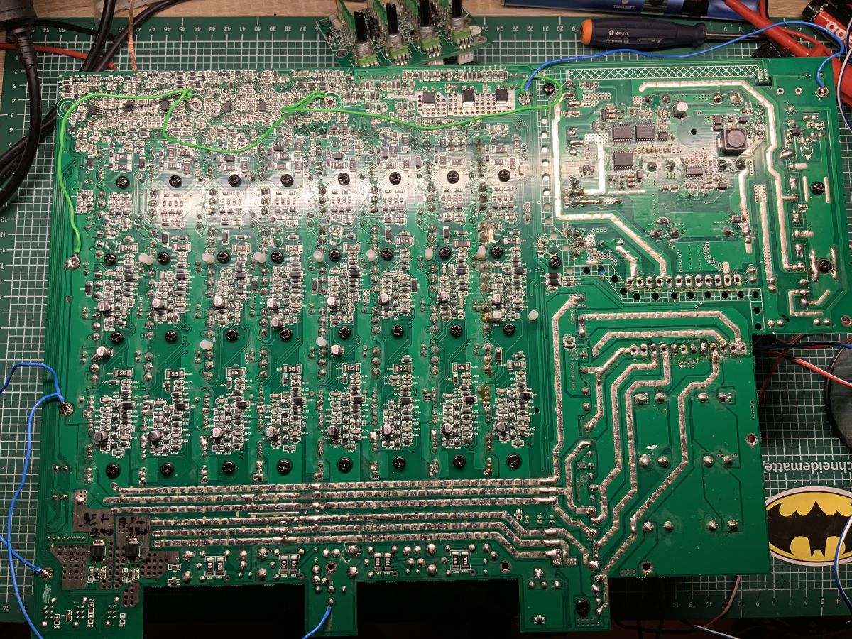

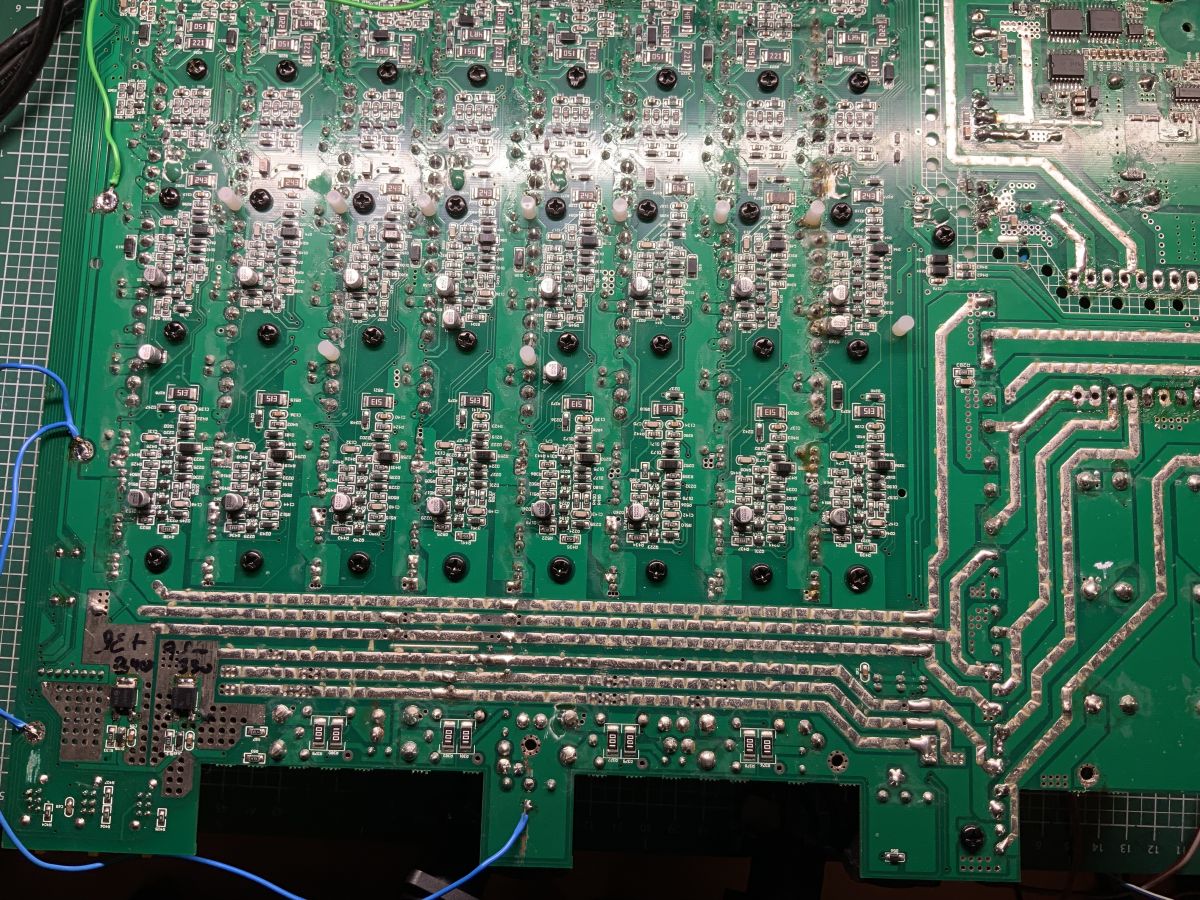

    gaspixx
    Hello all,
    I just got this amplifier in non-working condition, planned to repair it and use for mid-range speakers (100-2000Hz / 4x800W / 8ohm). Later I found a lot of negative feedback on this amplifier. Anyway, I will try to repair it and use it for this purpose.
    Thanks to this forum I saw a lot of important information about repair. Started checking the components. Based on the previous owner, the amplifier was working and after some time goes into protect mode. I didn’t start it yet due to the possible burning of the power supply. I first checked for short circuit briefly and only one possible short I can see on the rectifier bridge, but I need to desolder the complete heat sink to see if this is a real short or only the coil impedance. What I can see is some ‘upgrade’ - somebody soldered at the output parallel to the original 22nF MKT film capacitors another 4 capacitors 10nf/250V – do you know what can be the purpose? Keep them or better remove to original state?
    Circuit board with visible components like resistors and a rectifier bridge.
    I plan to check the semiconductors and resistors/capacitors mentioned in this forum first, then start it with 15VAC/24VAC external symmetrical transformer and check the functionality of all 4 channels. Next I will add also two 8FA fuses, move power resistors from the front VU panel from the front to the bottom side of the PCB to prevent issues with heat on this panel. Connect the grounding points directly with wire. I will probably also change the working components in PSU (IR2110S, SG3525, gate resistors and capacitors…) – just to be sure. Is there anything else to upgrade this board to make it more stable?
    Thank you

Quick 3-step check when PSU stays silent
  1. Confirm 5 V at SG3525 pin 16 and < 0.2 V at pin 10. 2. Scope pins 11/14 for 80 kHz square. 3. If missing, swap LM339 & NE555; they latch SG shutdown[Elektroda, Robercikxxx, post #21050982]
