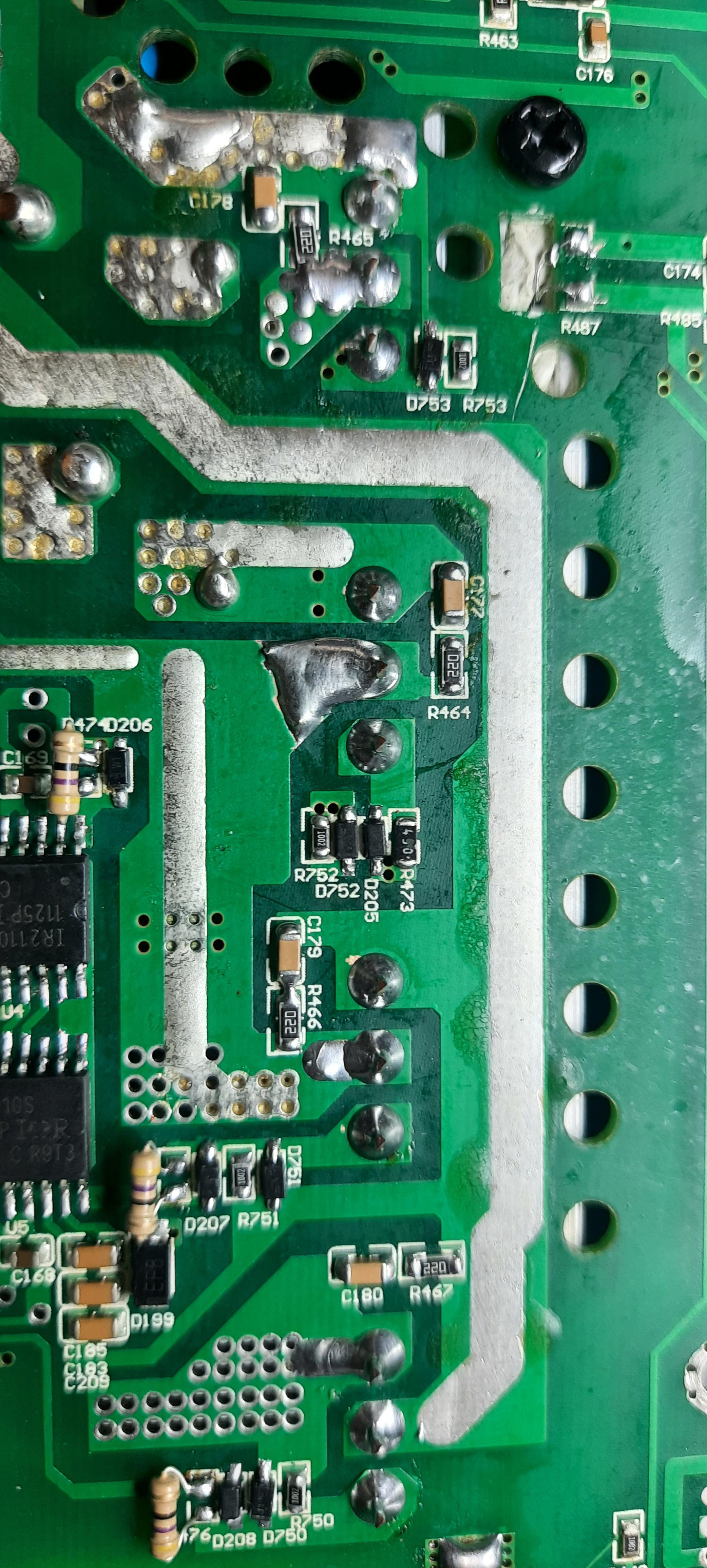

    What markings do the diodes in the IGBT gates have in this amplifier? It mainly concerns D750, D751, D752, D753, D205, D206, D207, D208 and the resistor R473. The final stages are operational, checked in the manner described on the forum, using replacement power supply from transformers, and work properly. Only the converter was wrinkled, the IGBT keys were opened so that their structures were visible, and of course the SMD diodes and a few resistors were closed and open, the rest of the elements were checked and appear to be functional. I replaced the IR2110S drivers, SG3525, and LM555 as well. I ordered the IGBT from a Chinese company. After assembling, I will see if it will stand up or explode.

    R473 is the same as the THT resistor you installed, i.e. 47 Ohm. Diode D205, D206, D207, D208 is a 1N4148 diode
    Diode D750, D751, D752, D753 is a 15V zener diode
    In all the amplifiers I have repaired, NE555 and LM393 have never been damaged. Sg3525 sometimes happened to be damaged. If you ordered transistors from China, be careful because there are many fakes of this transistor. And the chance that you will buy the original is about 35%. Immediately measure the gate capacitance in the transistor when it arrives, between the first and third legs the capacitance should be about 4nf.

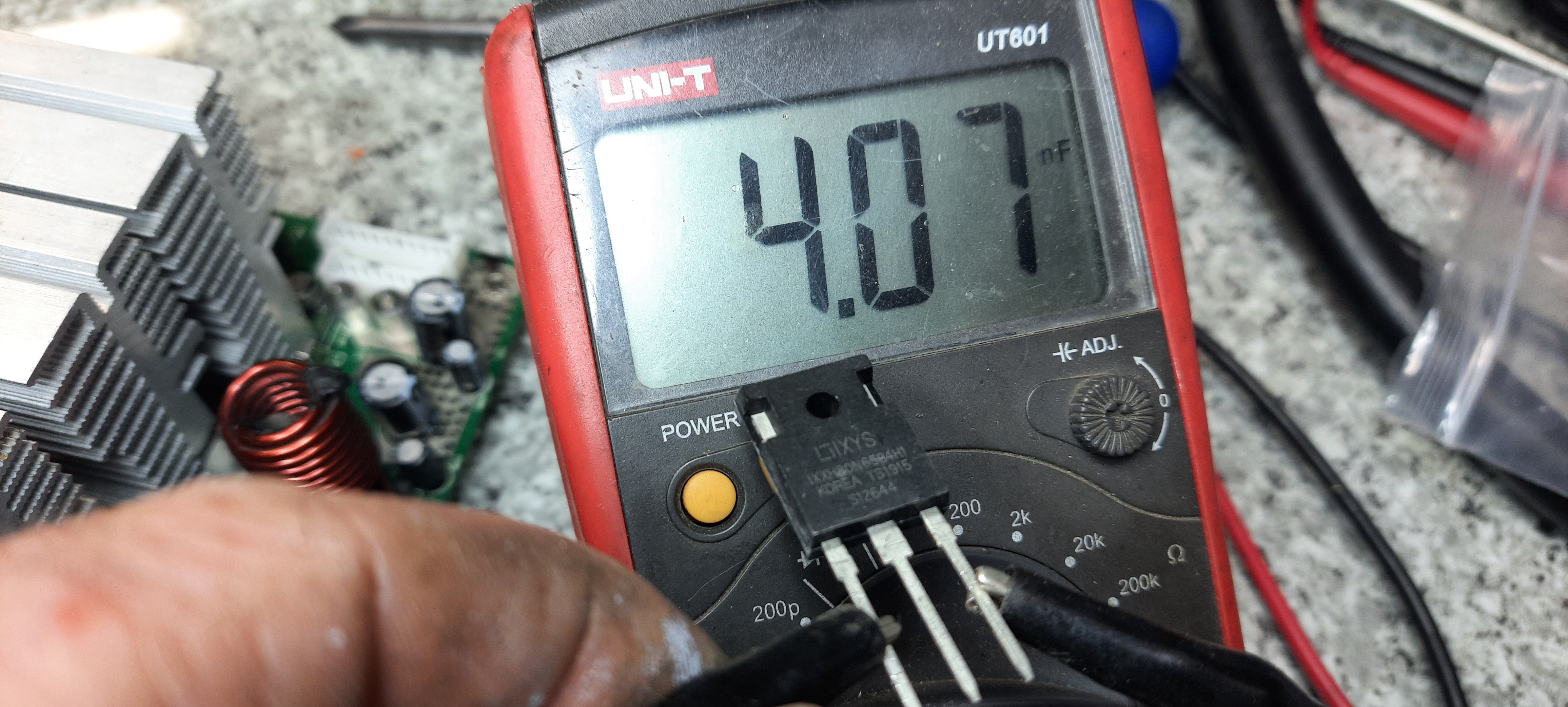

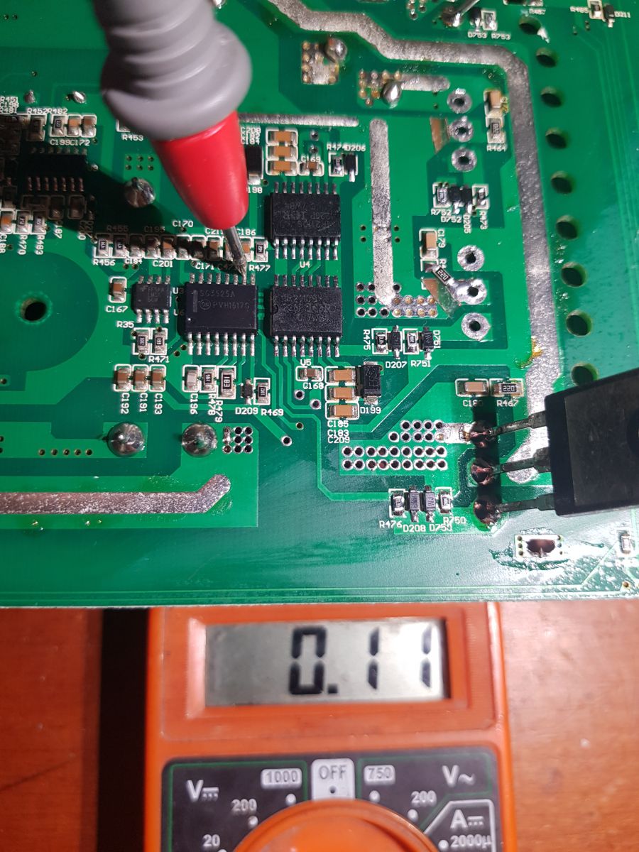

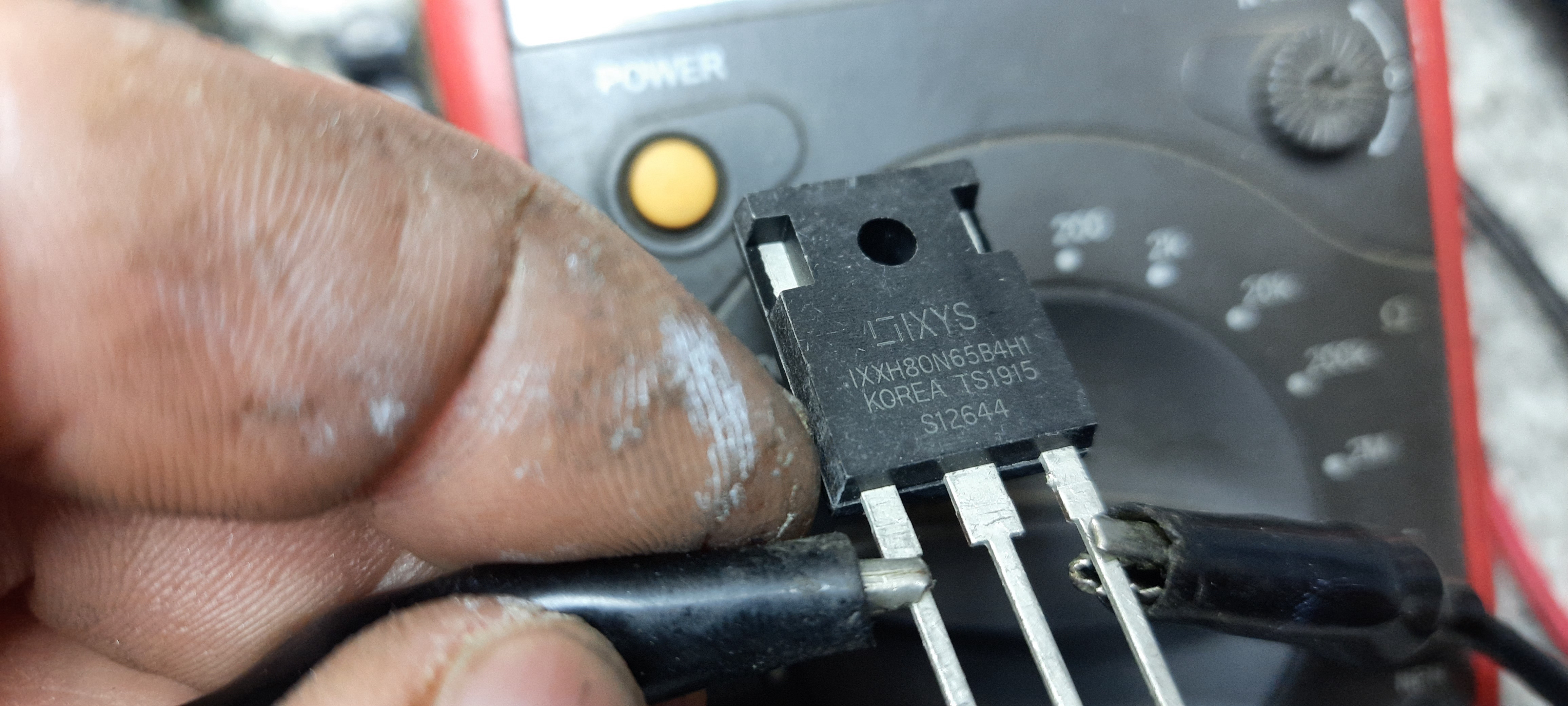

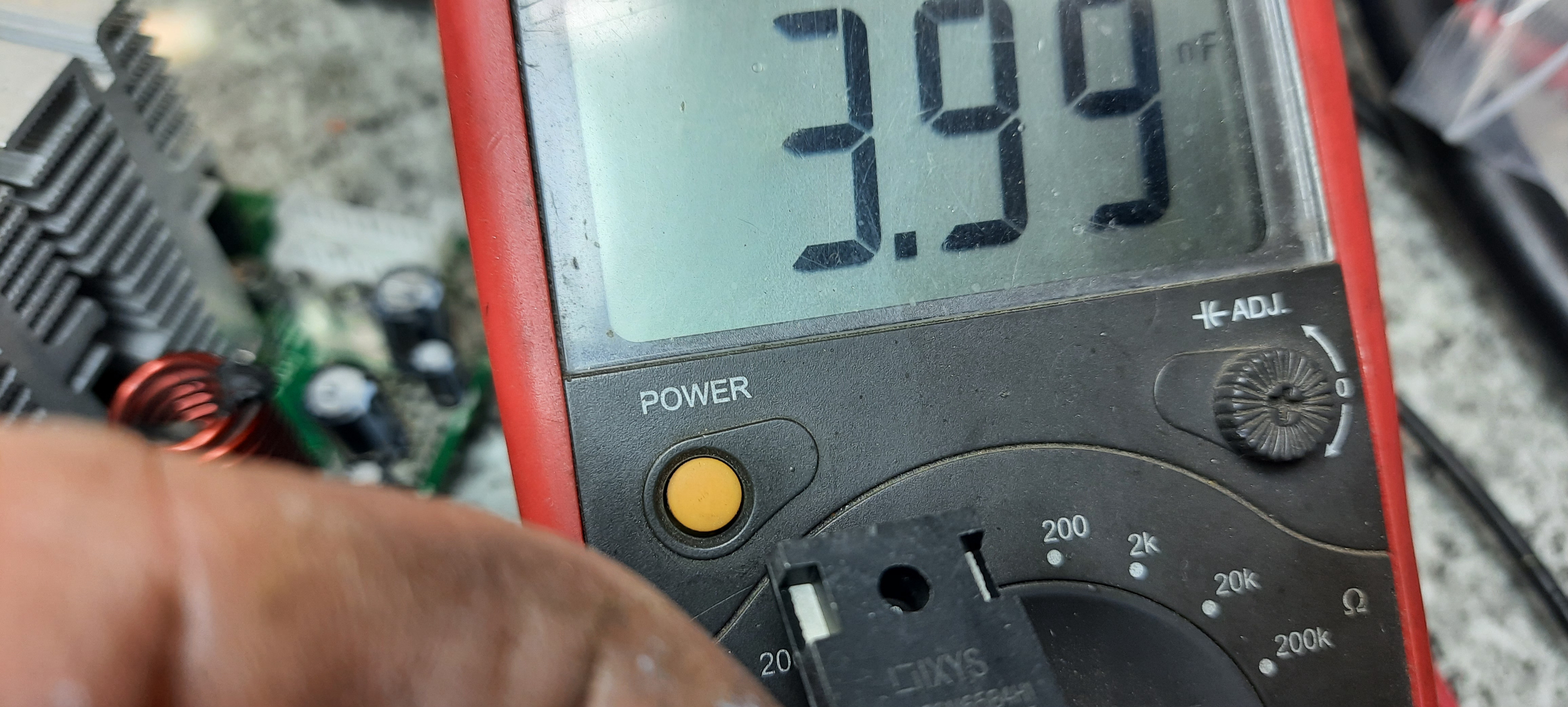

    Well, the IGBTs have just come from China and after measuring the capacitance of the gate with the emitter, the result is, as Dear Colleague Robertcikxxx wrote, about 4 nF. So it would seem ok at first glance. It will turn out after washing. I put in the transistors and nothing, complete silence. The voltage on the main electrolytes is 315V, the auxiliary converter is working, the red and orange diodes on the board next to the capacitors are lit. The supply voltages of SG3525 and IR2110S reach and are at the level of 16.5V, but there is no waveform with SG3525 with legs 11 and 14, much less with drivers. The triac was replaced as a preventive measure. What else can block this converter? I will add that I turn on the converter with three 100W bulbs connected in parallel and in series between the network and the converter, so that there are no fireworks.

  • #287 21049572
    Robercikxxx
    Posts: 141
    Help: 8
    Rate: 9

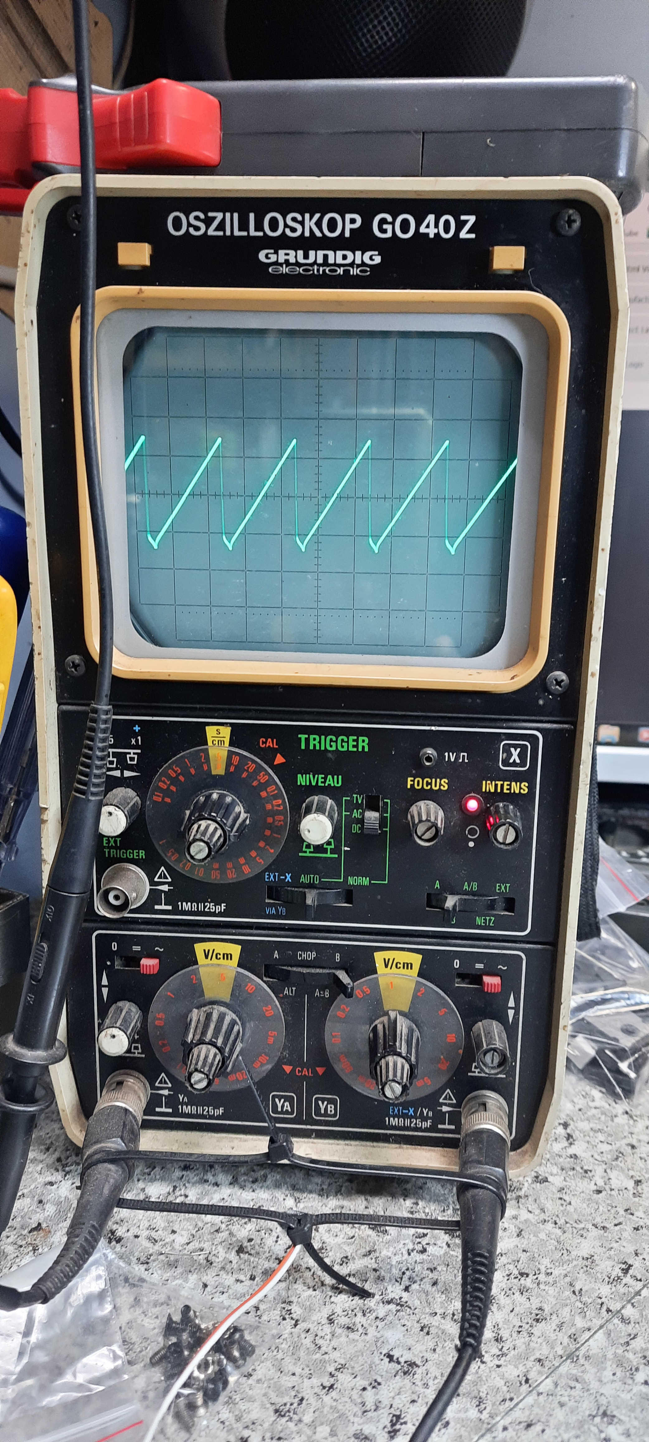

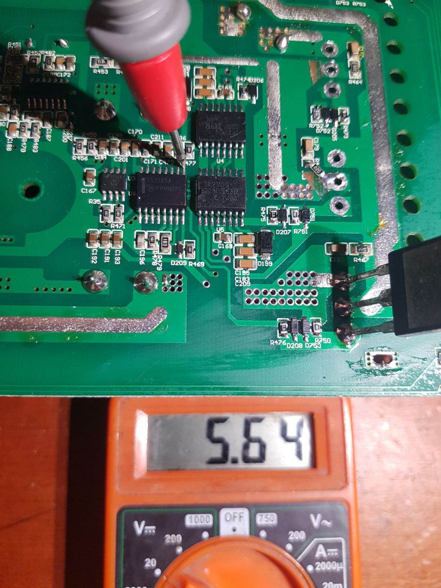

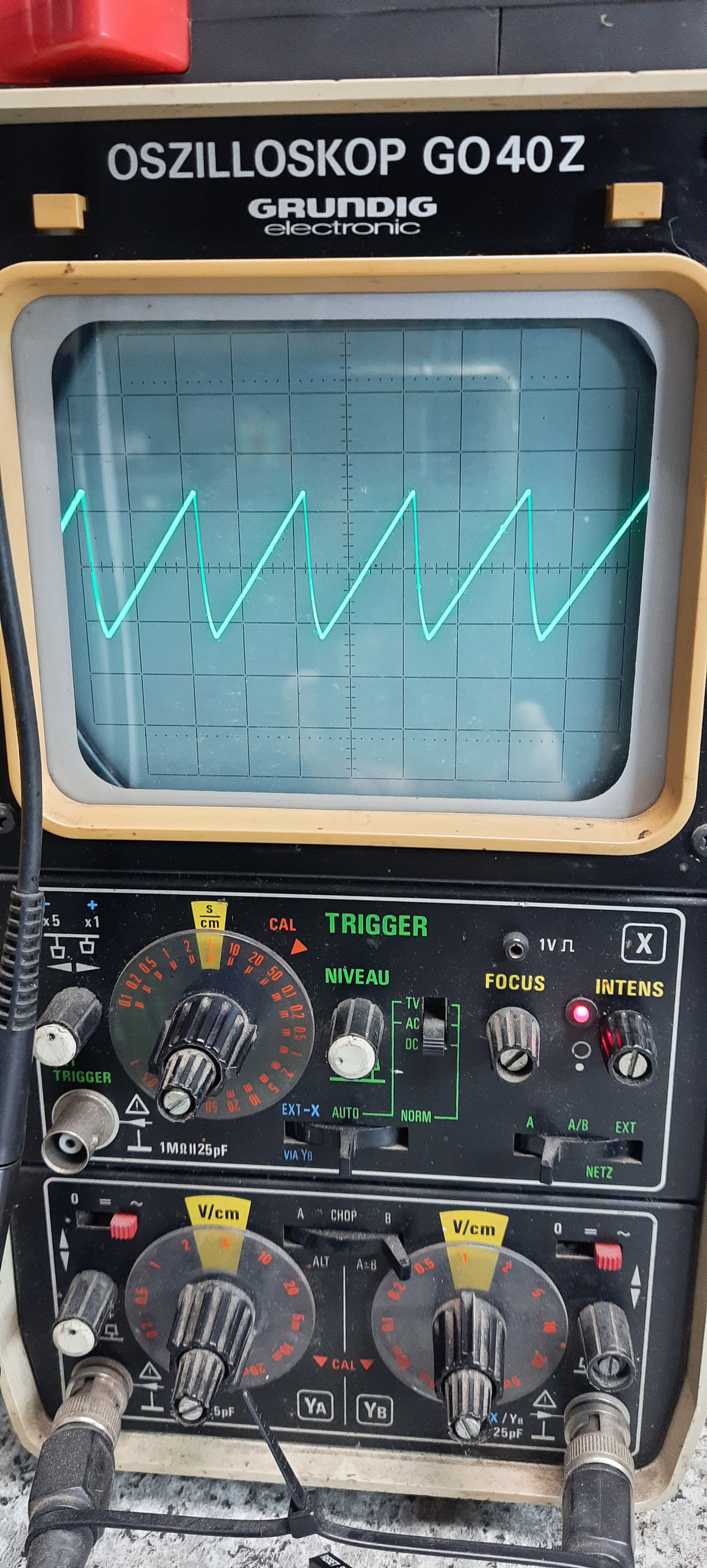

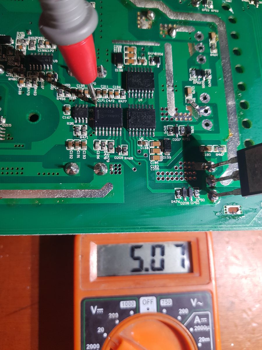

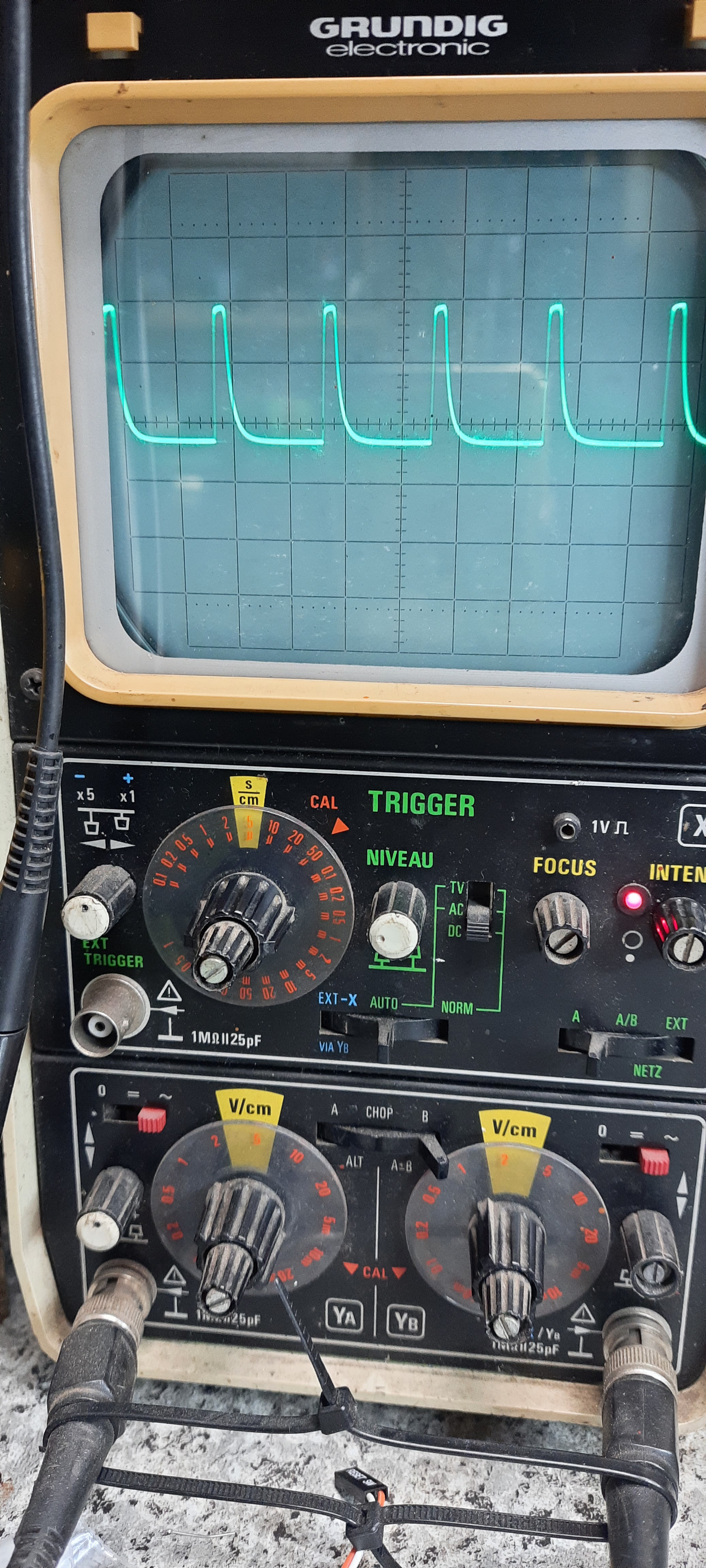

    Check what voltages you have at these points.
    Measuring voltage on a circuit board using a multimeter Voltage measurement on a circuit board using a multimeter. Measuring voltage on a circuit board with a multimeter.

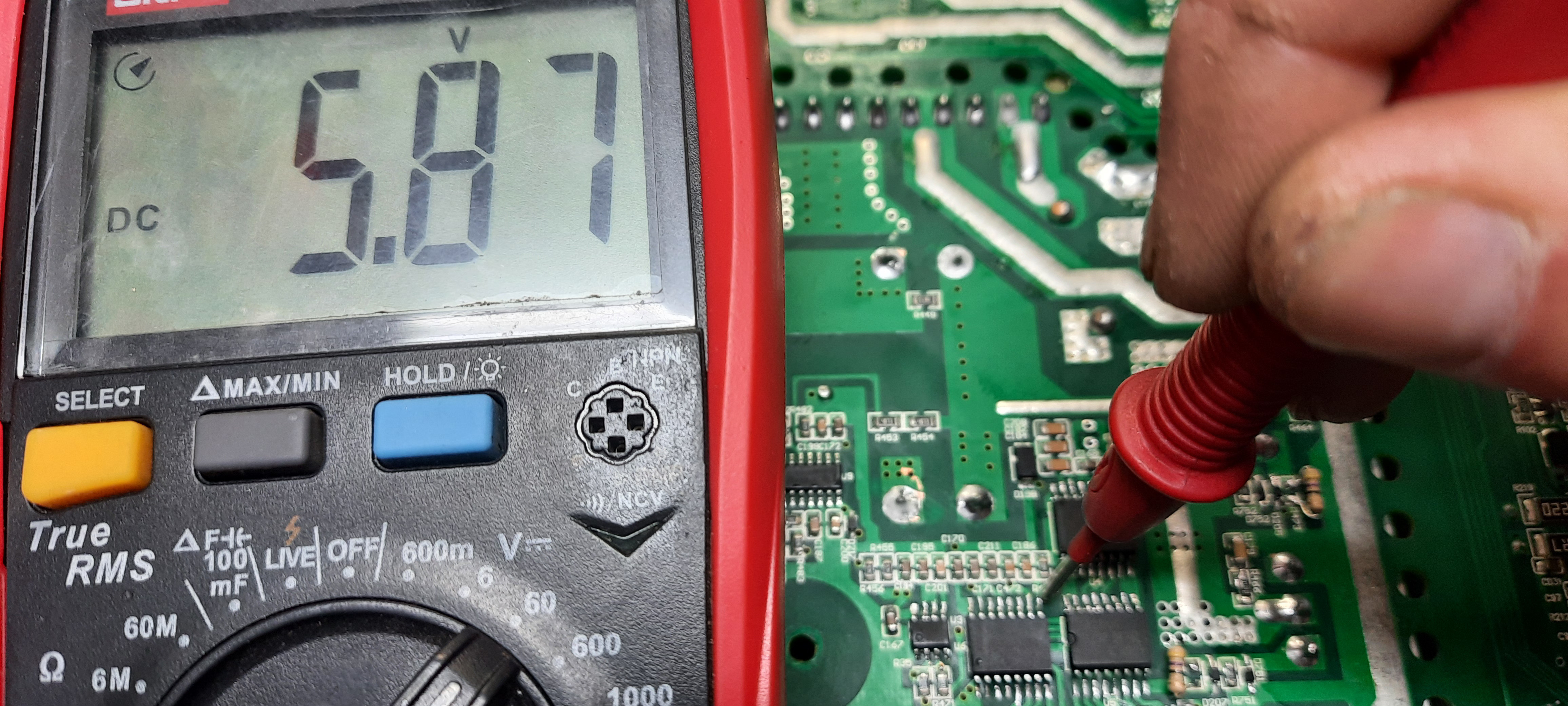

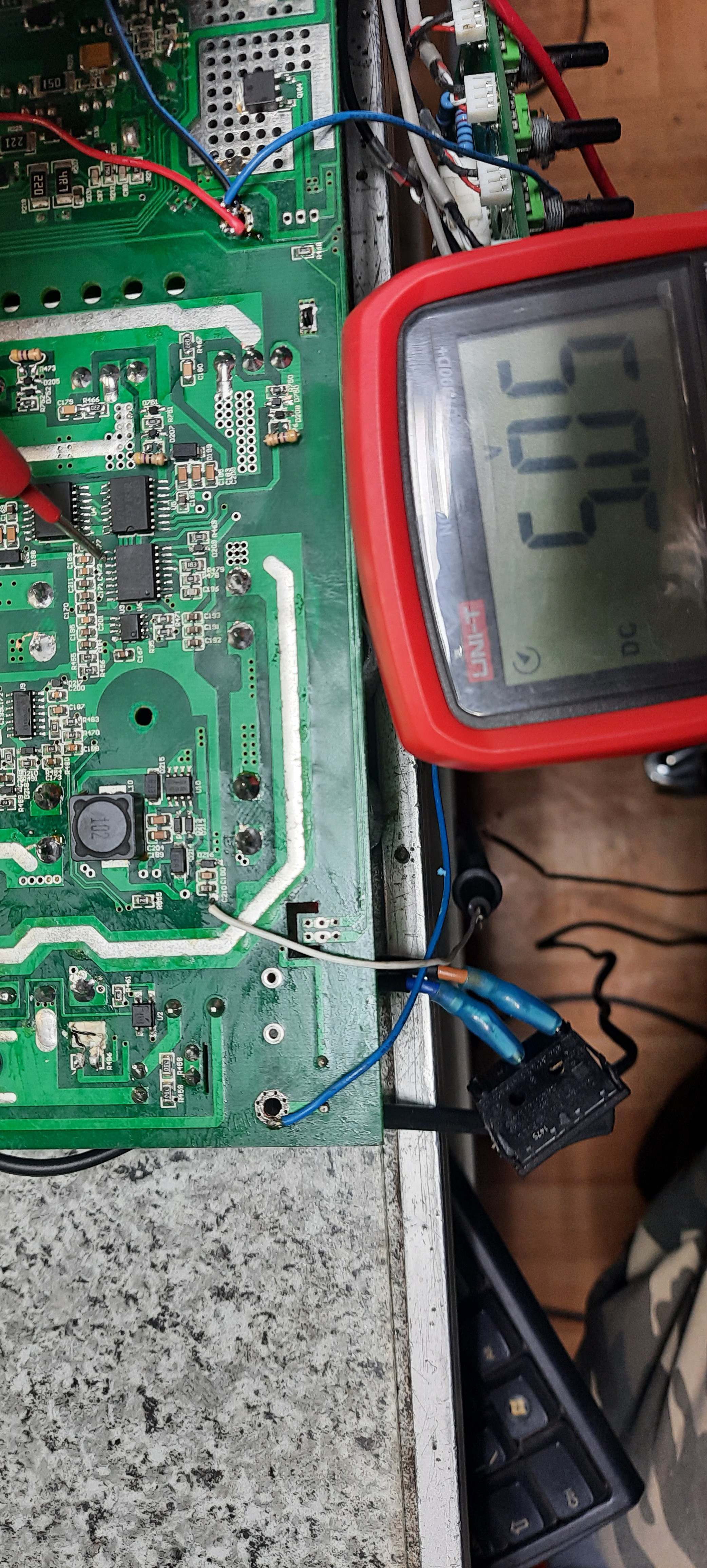

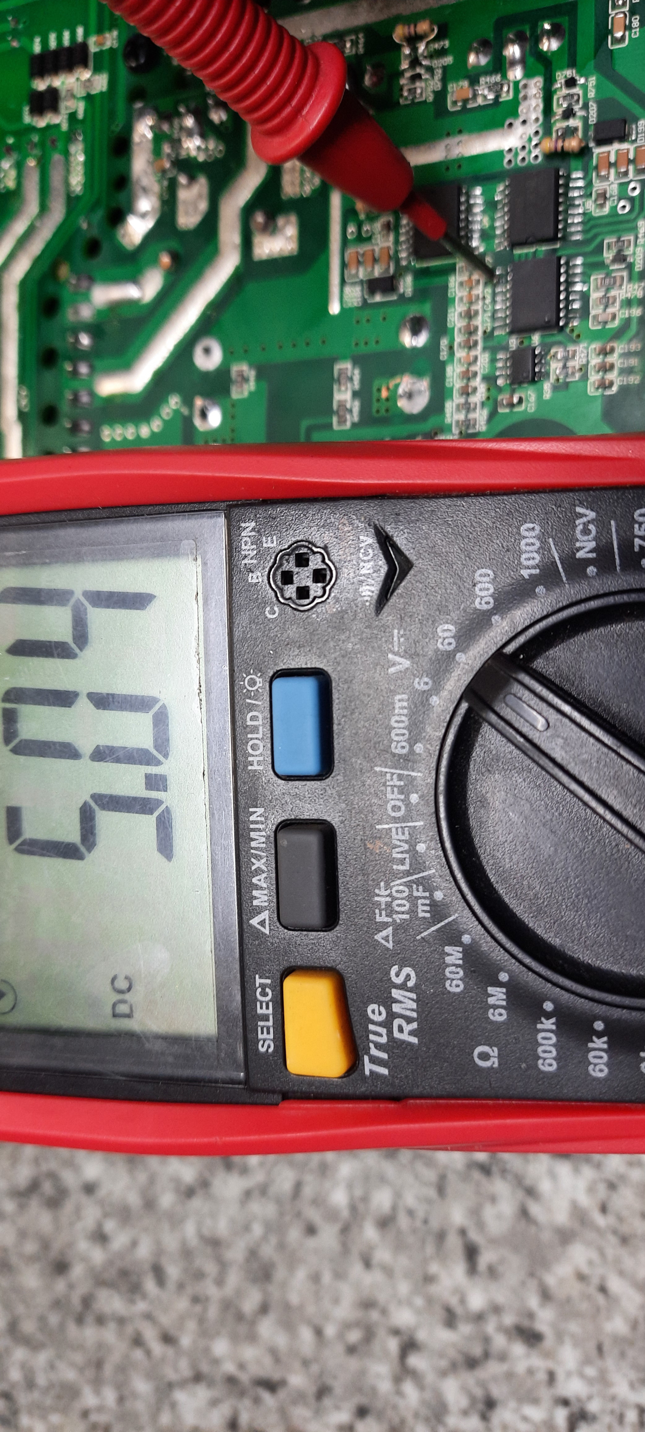

  • #289 21050899
    zbyszekdymny
    Posts: 93
    Rate: 46
    So. On the 16th leg of the SG I have 5.08V, on the tenth leg it is 5.04V, and it should be 0.11V. Just like my friend`s, and on the ninth o`clock I have 5.87V. So this one voltage is too high. Waveforms at the outputs 4, 5 and 7 of the SG3525 system. There is no signal at outputs 11 and 14.

  • #290 21050982
    Robercikxxx
    Posts: 141
    Help: 8
    Rate: 9
    You need to look for the problem on lm339 and ne555, there should be no 5V voltage on leg 10 of the sg3525 system. If you replaced the ne555 and lm339 chips, put back the existing ones.
  • #291 21052253
    zbyszekdymny
    Posts: 93
    Rate: 46
    So I will, but tomorrow, because today I am already completely knackered. It is possible that fakes have hit.
  • #292 21053315
    zbyszekdymny
    Posts: 93
    Rate: 46
    LM339 I did not replace, it is what it was and LM555 I replaced. I'll order both chips I'll solder them in and let you know what the results will be.

  • #297 21068970
    zbyszekdymny
    Posts: 93
    Rate: 46
    I inserted this LM339 and the inverter got up. The amplifier started up correctly. I did a test under load and everything seemed fine for about 30 minutes. After turning the amp off and restarting, at first everything seems fine - the fans start up, the amp starts playing, and a reboot occurs - everything shuts down and turns on again, and so on and so forth. After checking what's gone wrong, I have one IR210S driver and one capacitor in the gasifier damaged, 22Ω resistors good. Is it possible that it is due to the lack of this capacitor that this IR could have failed? IGBTs working fine. After replacing the driver the inverter works, but I do not tire it without this incomplete gasifier. At the moment I don't have a capacitor of this value.
