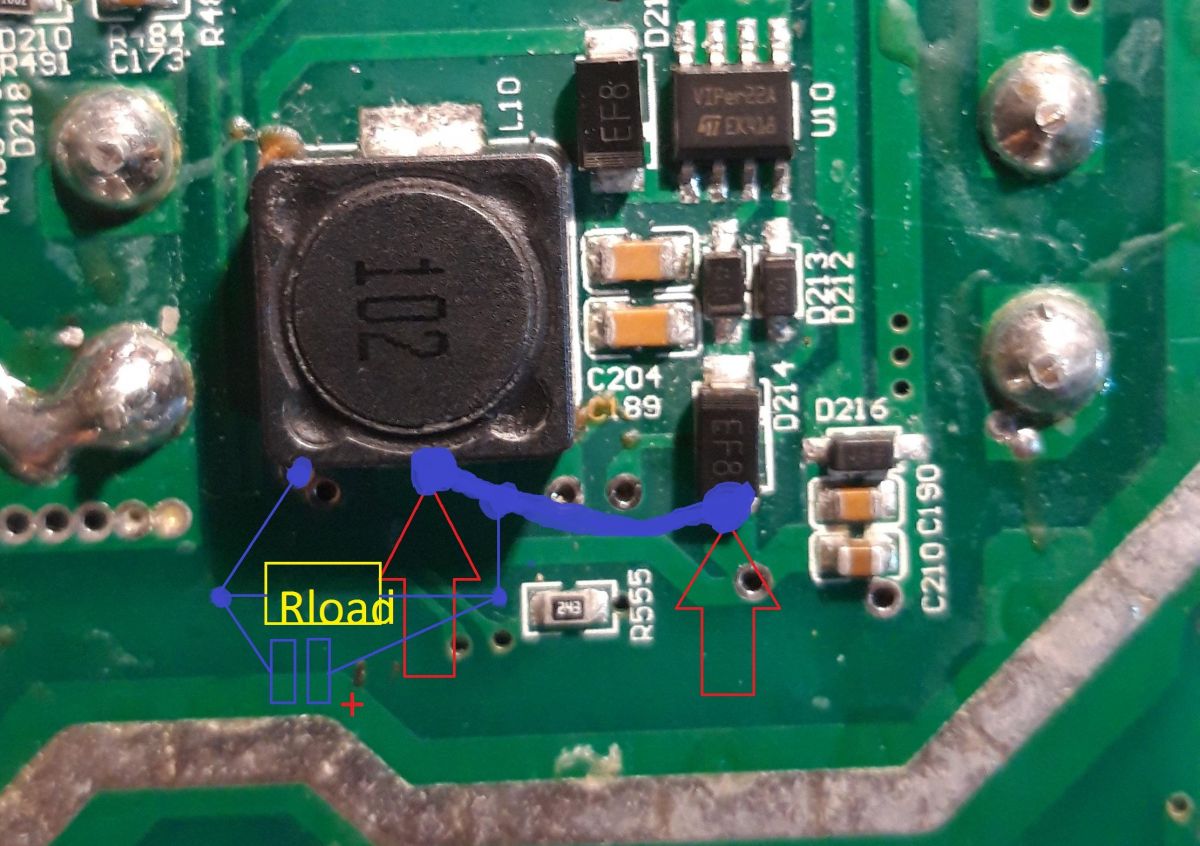

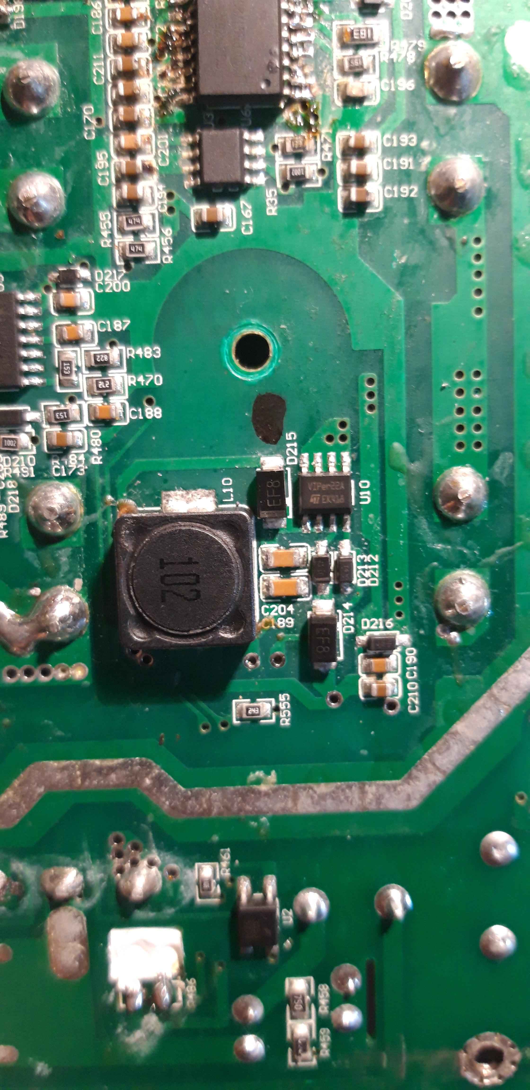

    The voltage on the SG3525A at what points did you measure?
    There should not be such a high voltage between pin 12 and pin 15 ... Repeat the measurement on these pins.
    However, as you have a higher supply voltage, it is possible that the zener diode is 15V on the converter.
    The squeaking of the inverter may be caused by a temporary load on the inverter. On the other side, it fills the capacitor near the LED, I assume that the latter is larger than the filtration of the output voltage from the converter.
    By the way, the efficiency of the converter (Step-Down on the Viper22a) is about 15V and around 100mA
    I would also like to see a clear photo of the Step-Down converter itself. I want to analyze the circuit.

    Can you specify from the VIPer22AS datasheet which specific pins were shorted?
    As you say, it is possible that something shot in the control of the key. But there is also a risk that with a short circuit, the inverter released the overvoltage and burned the SG3525A and IR2110s. Flashing may be because downstream circuits are short-circuited and the inverter is resetting overload.
    Its amperage is only 100mA around and the ICs are unlikely to show any damage.
    The Zener diode D213 is responsible for determining the voltage of the converter. What's her symbol?
    I am enclosing a note below.

    The pins you entered are the drain pins and they are already internally short-circuited. A short circuit of either of them wouldn't affect anything.
    Maybe you misinterpreted which pin is the first pin. The first pin is the one next to the ST stamp.
  • #80 18375528
    Matek920605
    Posts: 54
    Rate: 12
    Exactly, I thought the opposite was true, so it was pins 3-4 or 2-3.

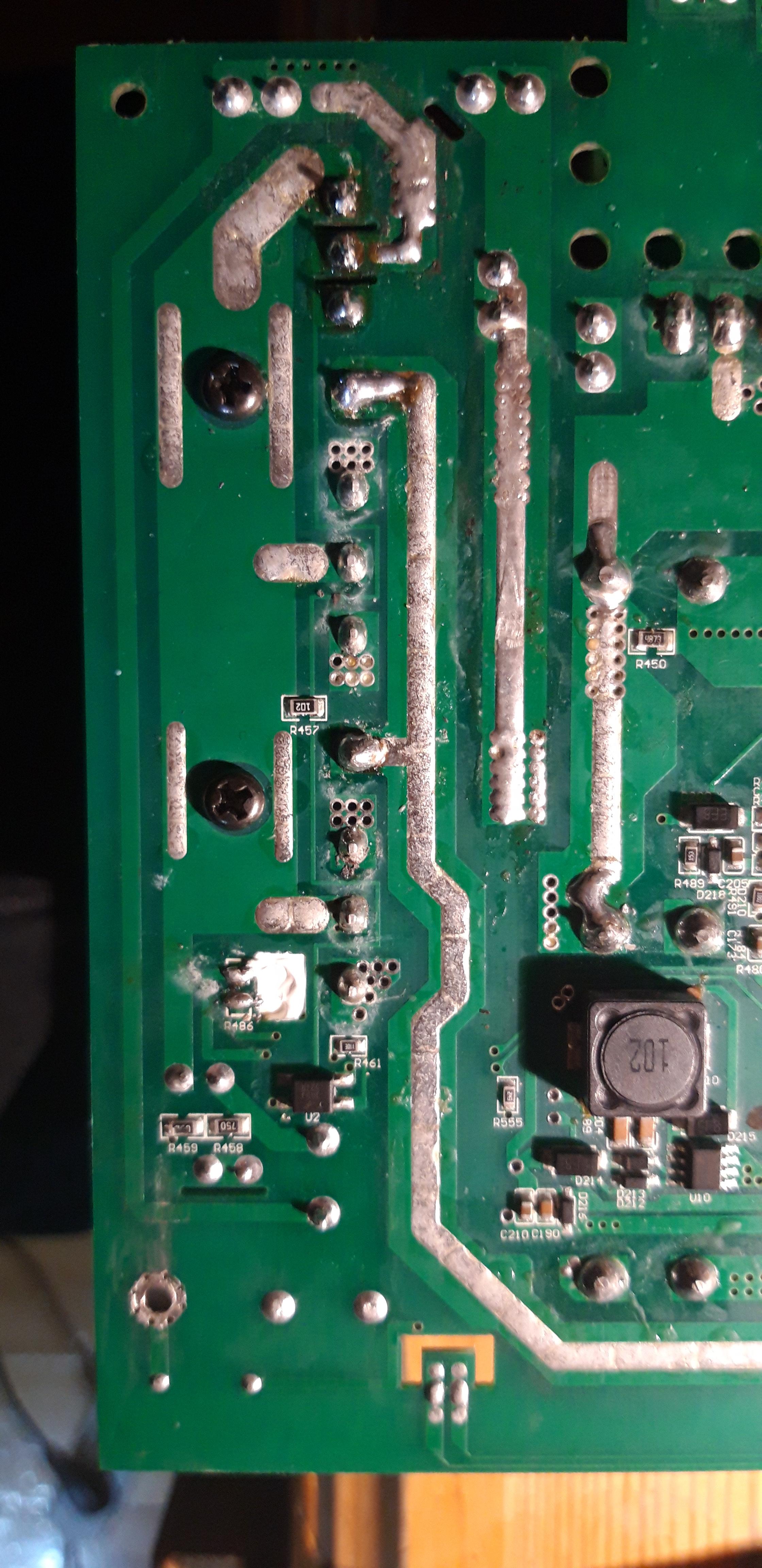

    Hmmm ... If only without starting the main power supply, just apply the voltage of the control systems supplied with the best laboratory power supply with the PROTECT function.
    At the beginning, set the voltage on it, e.g. 5V and the cut-off current of 300mA to 500mA. Apply the mass to the point behind the D215 diode, and the plus after the D214 diode. I have marked in the picture how to make the connection.
    And when the power supply would turn off due to overcurrent protection, it could mean that, for example, SG3525A or the drivers were blown.
    Check the D214 diode beforehand, because if it was punctured, it would constitute a short circuit in the circuit.
    Alternatively, you can use a power supply without this protection for the test and view the current with an ammeter plugged into the circuit.
    What do you think about it? Otherwise, to check the buck converter itself, you would have to disconnect the load from it.
    Edit:
    Of course, to the anodes of these diodes.
    Do you have the option to perform this test or look for other solutions? Because another solution is to desolder the SG3525A and IR2110s and then start the amplifier and it will come out whether the converter itself (Viper22a) will start or not.
    Or...
    If it weren't for SMD, the D214 diode's anode could be desoldered as well as the 102 foot of the coil. Both "pads" of both elements are on one output path (marked in the second photo). Short the soldered pins together in the air (with some wire) and add a balancing resistor to the ground of any value in the range from 300? to 1k?. This test will show more or less whether the converter itself is operational. The LED will not light because you will cut off the power to other systems. The voltage of the inverter will be put on the resistor and you only need to check if there is around 15V (on this resistor).
    And that I would be forgotten. You also need to connect the 220uF electrolytic capacitor at the output, so you can connect it in parallel with the resistor. Pay attention to the polarity.
    I would like to add that without an oscilloscope it will be difficult to go through the next stages ...

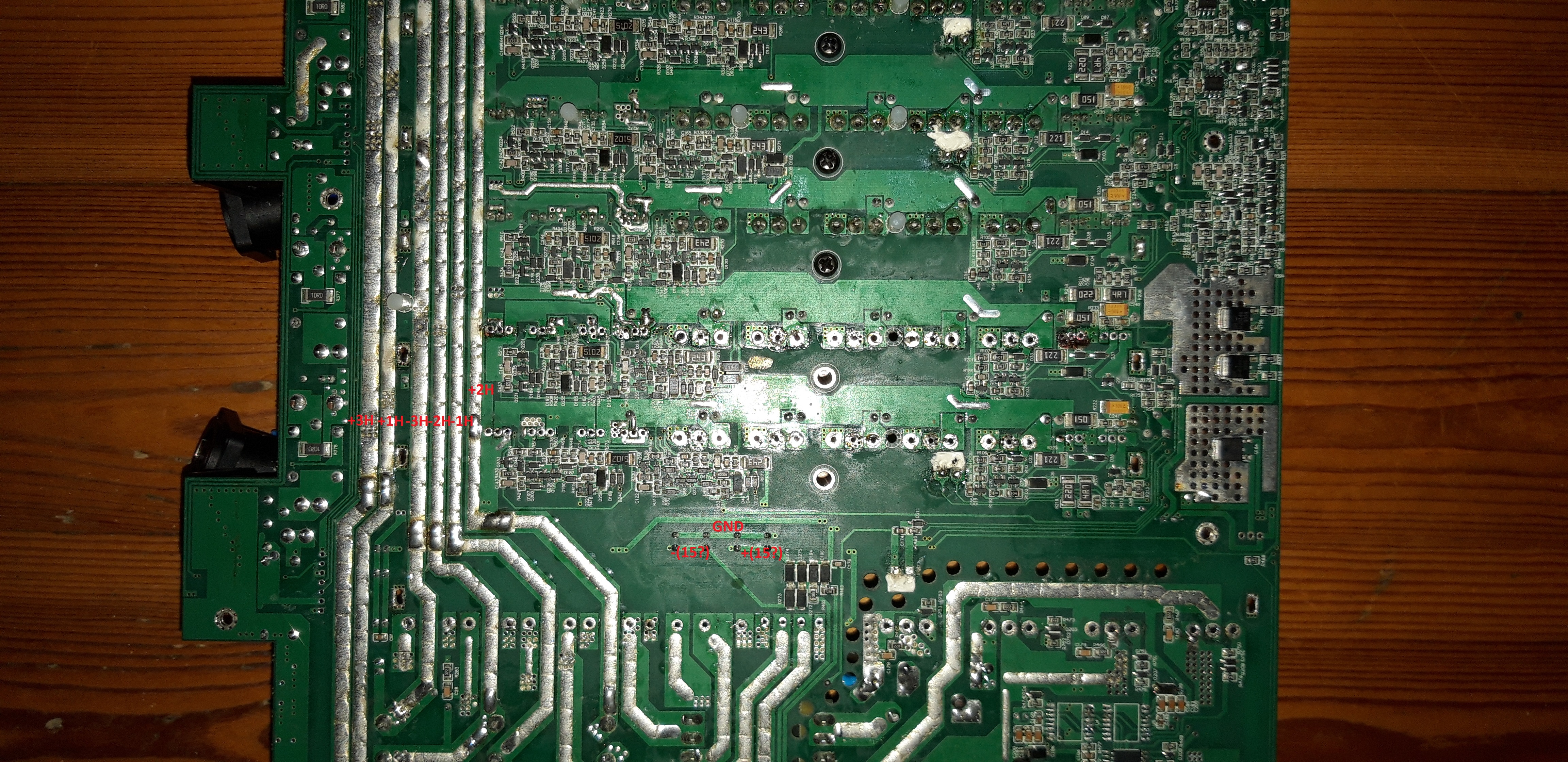

    My further analysis of the circuit shows that the power amplifier works in the 3H class.
    -The 2506SF bridge rectifies the 1H voltage. (+ -40V?)
    - GBJ3006SF bridge rectifies 2H step voltage. (+ -60V?)
    -APT60DQ60BG diodes rectify 3H voltage. (+ -160V?)
    -Auxiliary voltages are rectified by SMD diodes. At least + -15V.
    As for the configuration of the capacitor connections, they are connected in series (I assume).
    I read it all from the photos posted in the subject.
    I will get this tip on Tuesday at the earliest and start working ...
    Regards.

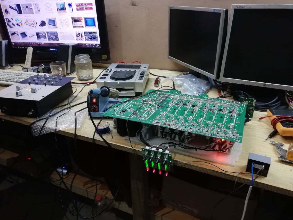

    INtRO_Tech
    Posts: 194
    Such a curiosity - I managed to fire this end under an alternative power supply, much lower, of course, it was about checking whether the power transistors, preamplifiers, etc. are functional and on the secondary side everything works.
    The tip spoke, the hero was a small 2x12V AC transformer, the impulse transformer was removed at the stage of measurements.
    I removed the CH2 block completely from the board because it had two terminal transistors punctured and a relay for this channel literally burned out.
    I started with the power supply, which supplies min. preamplifiers, connecting each symmetrical branch in turn, ending with H3.
    Ziro is right - this end is in the H-3, it has three power supplies, unless it is a typical H (H-2) and the next one after the auxiliary (the weakest) is also binding for the work of preamplifiers, accessories, etc.
    If I don't run out of time, I will organize a stronger 24V power supply and from some other amplifier I will connect a higher power supply to the power ends.
    ps. The faulty lights up because the amplifier had such a weak power supply that it did not have the strength to switch the relays, as long as the capacitors at the start kept this fault nicely extinguished :)
    Regards
