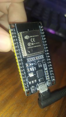

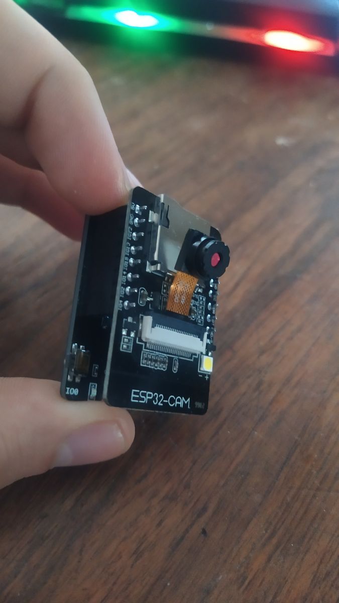

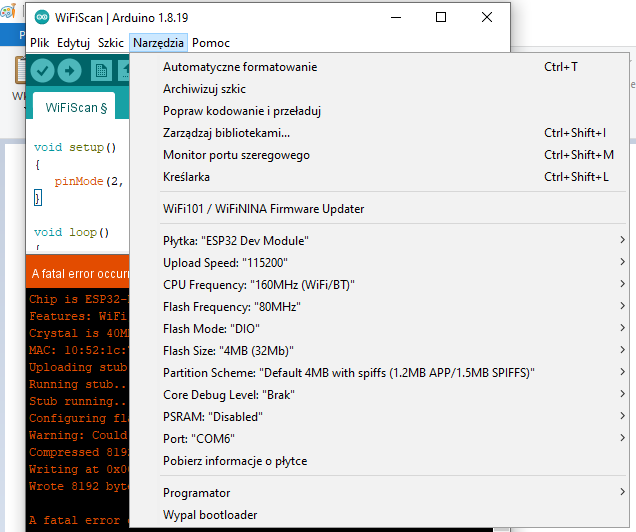

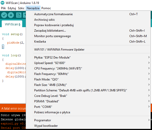

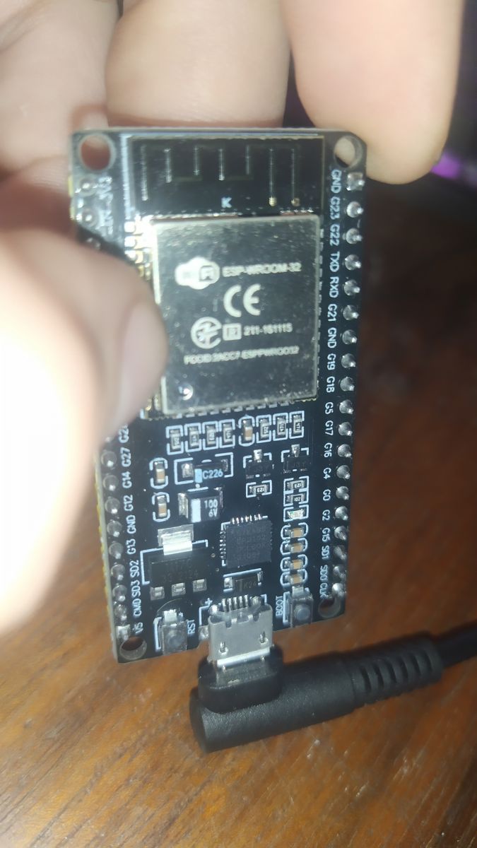

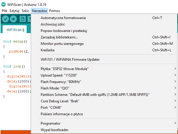

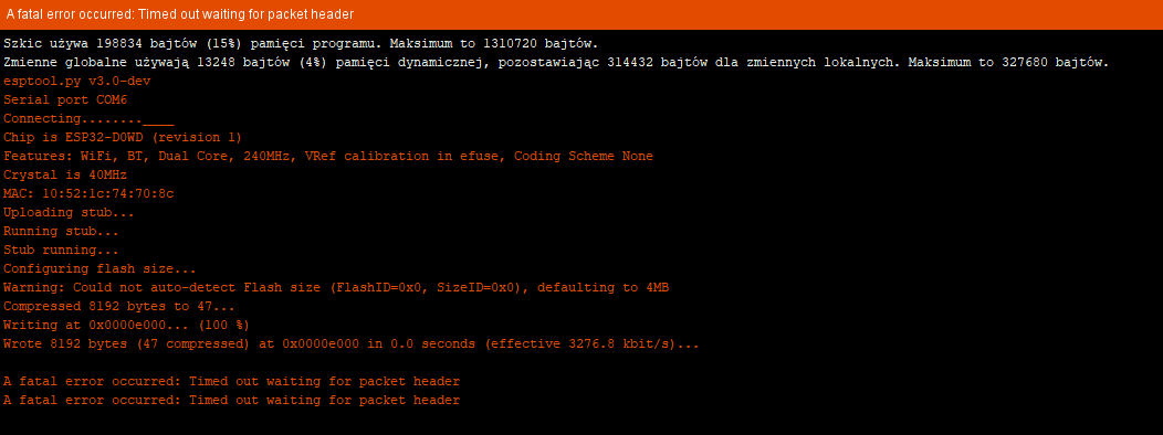

    Hello :sm9: , a few days ago two boards came to me from ali, one is ESP32-CAM the other ESP32 38 PIN.
    The ESP32-Cam board is not a problem, everything works, the sketch loads, connects to the wifi network and transmits the image. However, I have a problem with the second board, I can't upload a simple program there:
    Code: Arduino

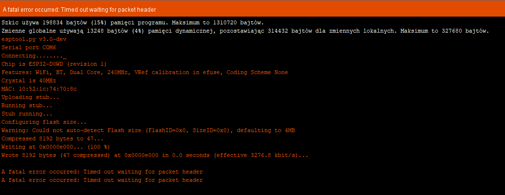

    In the console this information appears : .
    ESP32-A fatal error occurred: Timed out waiting for packet header .

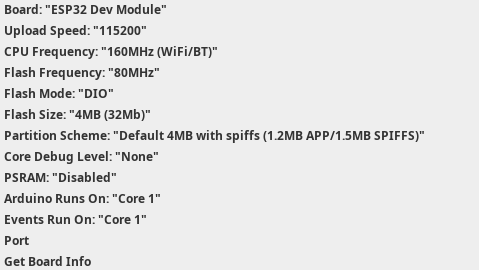

    Tile settings:

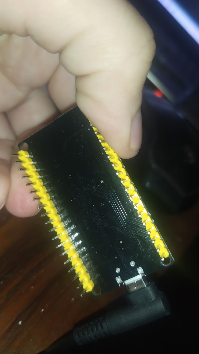

    Pictures of the troublesome tile
    ESP32-A fatal error occurred: Timed out waiting for packet header ESP32-A fatal error occurred: Timed out waiting for packet header
    Picture of working board
    I'm also not sure how to unambiguously determine the type of this board , it's hard to find another board like it in this configuration with the same circuit layout. In the auction it was only referred to as , "ESP-32 38 PINS."
    It is the third day that I am looking for information to solve this problem, but without success. I have seen on youtube and various forums ways that some people connect condensers or resistors under specific pins and this helps some to upload the sketch. I've also tried doing this but I'm not sure if I've connected to the right pins. I've also tried selecting different boards from the board manager in arduino but it's still the same.
    I don't know what I can do anymore on this topic so this is my first post on a forum (of any kind), so please understand :P I'm asking for help that maybe someone smarter can do something about it :) .

  • Wrong board selection caused upload timeout

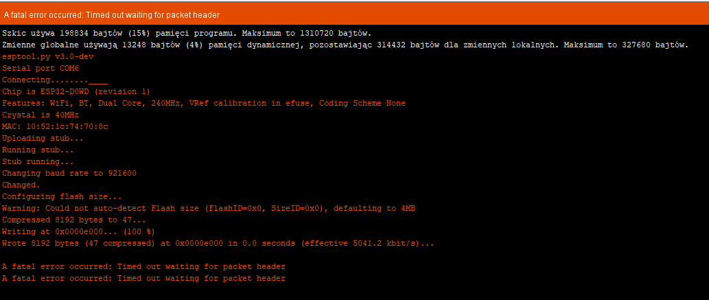

    When changing to:
    Further it is the same :

    After the change to : ESP32-A fatal error occurred: Timed out waiting for packet header .
    It continues as follows: ESP32-A fatal error occurred: Timed out waiting for packet header

    It is exactly the same as before : ESP32-A fatal error occurred: Timed out waiting for packet header
    Added after 4 [minutes]:

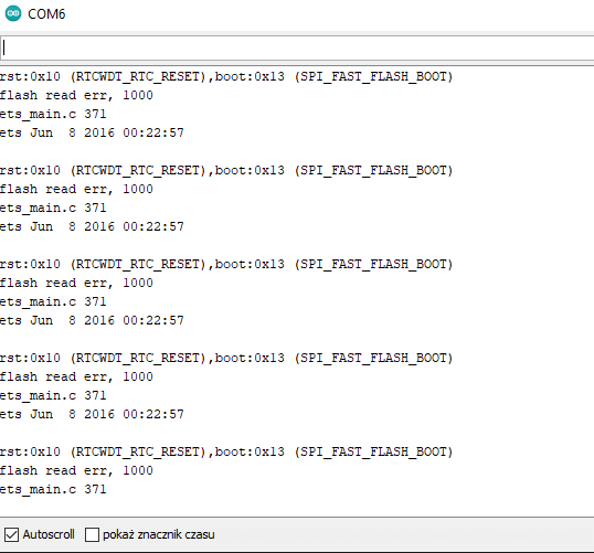

    I can also add that after pressing the button, RST, once, the port monitor displays such information (then the LED on the board flashes) : ESP32-A fatal error occurred: Timed out waiting for packet header .
    And after pressing "Boot" once (the led goes out) and the following is displayed : ESP32-A fatal error occurred: Timed out waiting for packet header
