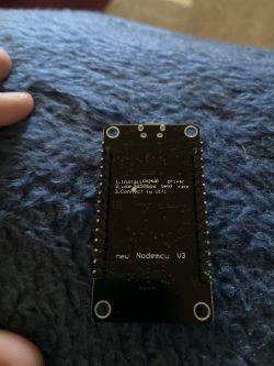

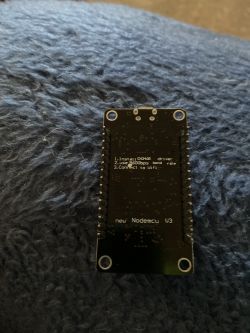

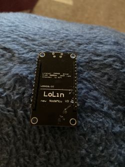

    I'm average at this but it's like this, I take a usb cable I plug it into my computer I have the drivers for esp uploaded and it detects my computer I go into arduino ide and upload and I get this error in 3 esp8266 and I can't upload it says connecting …….—-…….—-…….—-…....

    stasix909 wrote:
    I'm average at this but it's like I take a usb cable and connect it to the computer
    What ESP module is this specifically?
  • #5 19821915
    stasix909
    Posts: 7
    And such 3. 2 plain ones from amazon with no description and 1 lolin Error uploading code to Generic ESP8266 module - Arduino 1.8.19, Windows 10, board parameters Error uploading code to Generic ESP8266 module - Arduino 1.8.19, Windows 10, board parameters Error uploading code to Generic ESP8266 module - Arduino 1.8.19, Windows 10, board parameters .
