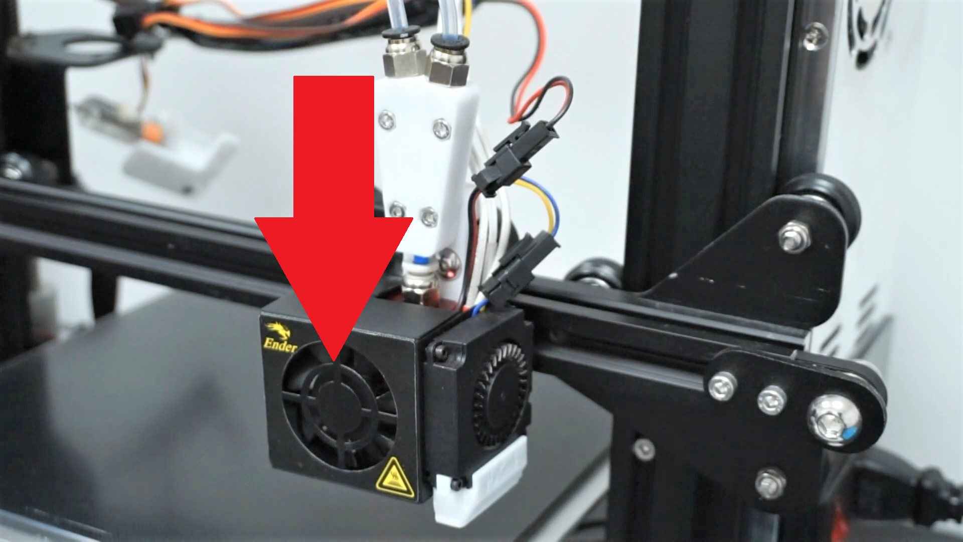

    Posts: 14799
    Rate: 12960
    tzok wrote:
    especially at the beginning of the print has a problem with the feeding of the filament, the extruder drive skips (with better pressure) or slips (with the original plastic lever).
    This could also be a symptom of problems with the fan that cools the filament just before it heats up, this:
    First 3D printer purchase - Creality Ender 3 Pro - My impression, review
    When this fan is not working, the heat from the heatbreak goes up too much and the filament overheats prematurely, over time clogging the whole mechanism.
    This problem can be found online under the name ' heat creep '
    And the fan itself tends to pull in filament threads sometimes, which can cause problems; I had to clean it once, but generally it's enough to keep an eye on whether it works at all.

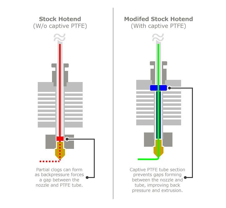

    The Ender 3 has a defect. This defect manifests itself when printing above 220*C. It concerns the loss of properties of this "Teflon" tube at high temperatures. As it reaches the nozzle itself, it begins to glaze and clamp onto the filament. In addition, if you switch off the printer without cooling the head, the end of the tube becomes blocked.
    I yesterday knocked off the original hearbreak and bought a fullmetal in china. I would advise against fitting the fullmetal kit from china as it is weak. The original heatsink has much denser fins, plus the heatbreak is too short and goes too deep into the heatsink.
    In practice, you should take the hearbreak alone from the kit. Put a couple of m3 washers in the original head and only the Chinese heatbreak. This should be done so that it enters the heatsink only as far as required. Then screw the whole head together as in the original. This time the Teflon tube only reaches the pads, so it will not melt and clog.
    This solution is ideal for materials printed at temperatures of 220*C and above. PLA can cause minor problems, but on PET G it goes great. An additional advantage of this solution is the "eternal" tube, which does not need to be trimmed every now and then :)

    I have so far:

    This is a good modification with PTFE split but not on the factory PTFE, which starts to swell with temperature. The problem is the PTFE tube tip deforming and blocking (sticking) with the filament.
