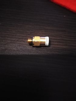

    What is this part called? It is located at the extruder First 3D printer purchase - Creality Ender 3 Pro - My impression, review
  • #79 19136802
    Posts: 14799
    Rate: 12960
    Bowden tube coupler. It should still have a (blue?) 'pin' otherwise the bowden tube (that white tube) will come out of it.
    This can be bought cheaply:
    but you should have everything included, have you lost the blue 'pin'?
  • #80 19136830
    tzok
    Posts: 38912
    Help: 3177
    Rate: 6562
    The pin can be printed for yourself.... but it's better to replace the coupling on the hot-end side with a non-through one anyway and separate the tube. This way it will be able to rotate freely with the head movement and will not be undercut by the coupling, nor will it slide out.
