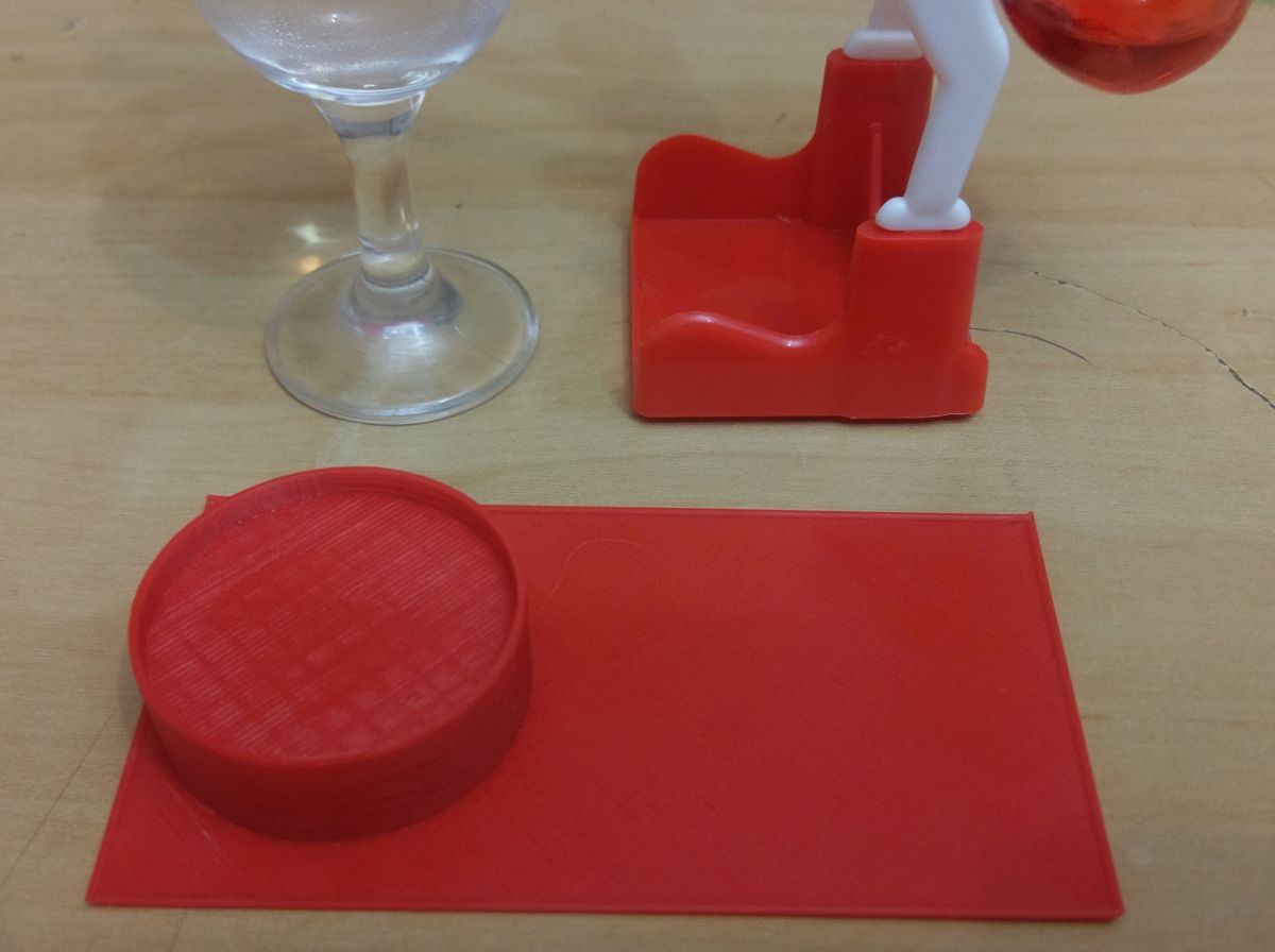

    Bed leveling was the only process necessary for me to get the printer up and running and make the first correct print. In addition to this, extruder calibration is sometimes done (i.e. measuring how much filament a given number of steps of the stepper motor ejected from the filament feeder), but in my case this was not essential. However, if you want really good print quality then it is worth doing this as well.
    Inadequate bed levelling generally results in the filament not sticking to the substrate at all (or not coming out of the nozzle at all), but sometimes it can also result in something like this:
    First 3D printer purchase - Creality Ender 3 Pro - My impression, review
    This photo is one of my first prints. The print substrate was not fully levelled at the time so it was slightly higher on one side and lower on the other, which clearly translated into an unacceptable deformation of the model.
    Poor levelling can also be seen from the model surround - on one side it is not even there and on the other it is not glued to the substrate.
    In contrast, this photo was taken later, with a much more level base:
    You can clearly see that it is better.

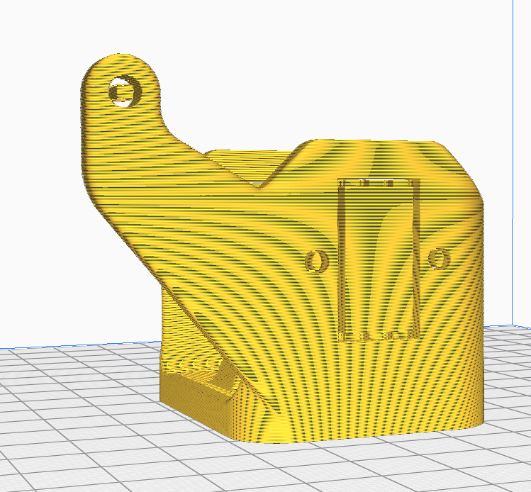

    - you can select the thickness of the print layer (which significantly affects print quality and printing time):

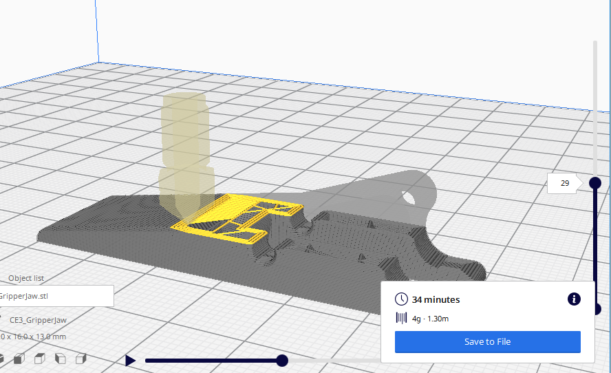

    - you can preview how the printer will print the item (separately each layer, exactly each movement of the extruder):

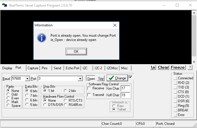

    Slight warning - Cura occupies COM (Serial) ports!
    I really didn't think I'd be writing about this here, but this problem has wasted my time a bit. The program Cura is able to block virtual (and probably also physical) ports COM connected to the computer.
    I myself sometimes use such adapters (for non 3D printing projects):
    And some time ago I realised, that when I have Cura enabled, I cannot use the port COM in RealTerm !
    The whole situation is well illustrated by a screenshot from Process Explorer :
    This probably comes from the fact that Cura also supports printing via USB , but I am really surprised that it occupies this port COM even when not using it. This is hardly how it should be. It caused me a bit of trouble, which is why I am warning against it in this topic.

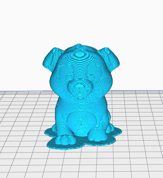

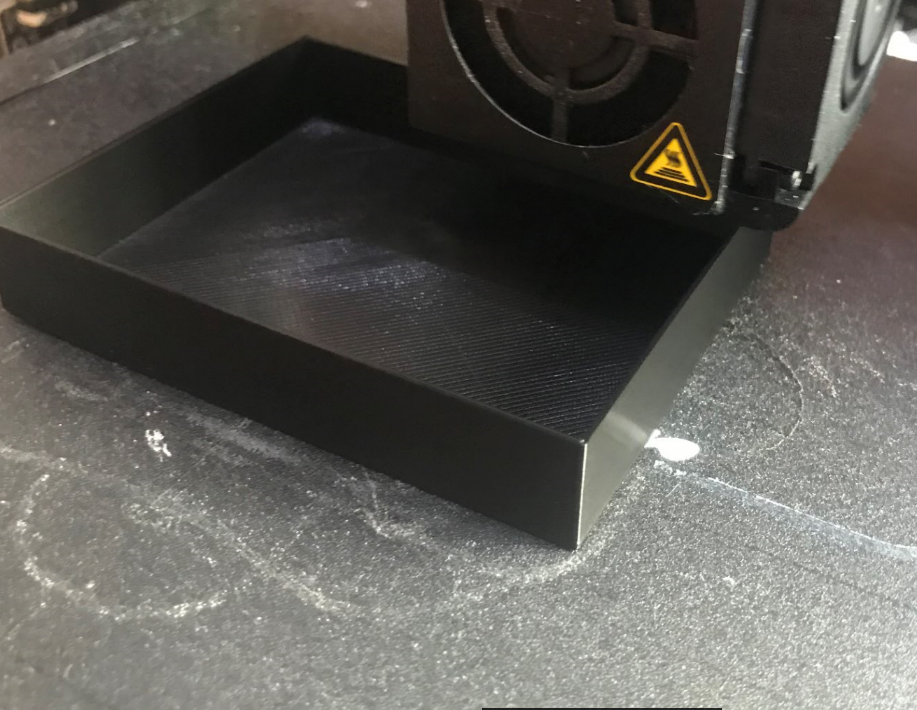

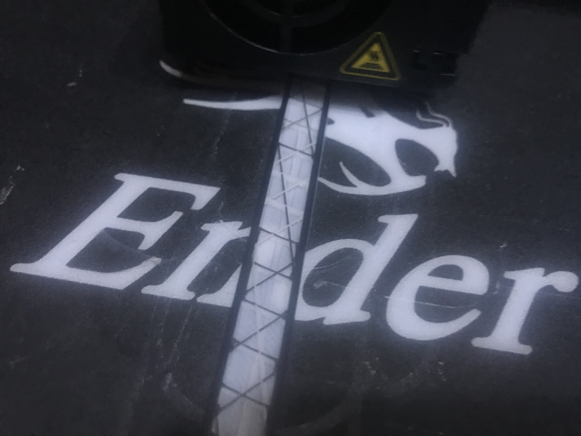

    Print pause
    The Creality Ender Pro 3 printer offers the ability to pause the print, but in my experience this is quite problematic. Enabling the pause results in the nozzle stopping movement, but inevitably the nozzle is still hot and some filament still runs off it, resulting in the formation of a filament spot as shown in the photo:
    In theory you should be able to remove it easily and resume printing, but in my case it stuck so tightly to the rest of the model that nothing could be done. The only thing that can be done about this is to keep an eye on the nozzle as soon as the pause is turned on, and keep removing the excess flowing filament until the extruder has cooled down. If this is done, then the interrupted print can be continued.
    The photo above is from my first test print which was the famous "Ender 3 Dog" figure:
    In the end, however, I didn't even have time to print it in full.

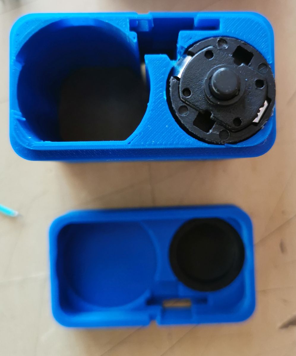

    Changing the filament during printing
    Changing the filament during printing is as possible and even very easy . You simply have to keep an eye on the printer and plug in the new filament when the old spool runs out and the filament line is fully pulled into the feeder.
    I've done this once, it was to change from white to black filament when printing a fixture part:
    During printing, you can see how the new layers of black filament overlap the previous white layers:

    Print quality, printer capabilities
    Simple models from the printer come out really very good quality and do not need to be processed at all. My drawers are an example:

    Very important for the quality of the print (and for its feasibility) is also the issue of supports , i.e. supports allowing to print more complex elements. Their use opens up a wide range of possibilities.
    An example of an object requiring supports:

    Preview of support automatically generated by Cura:

    Its source model itself looks like this:
    Here it should be noted that this model has a free space through its very centre for inserting a cable:

    Except that this object still had support in its centre, in that gap for the wire which you can also see in the screenshots from Cura. This support was quite difficult to remove, but I managed to push it out with a file:
    A bit of work and pushing on:

    The Cura3D software is able to block virtual (and probably also physical) COM ports connected to the computer.
    Just like any program that uses USB-COM adapters....
    A well written program does not block anything when not using USB-COM adapters ... this is a software issue, nobody forces the software to automatically open every available COM port without asking the user.
    The program can have this in the settings to be enabled or e.g. only open/enumerate ports when clicking "Send" or there "Print".

    No, 0.04-0.05mm. I set with a gap gauge to be sure, no problems. It was worth spending the perhaps PLN12.
    Well, I used sources where 0.1mm was quoted and that was the value I considered correct.

    I set mine to 0.04 mm with a slit gauge and somehow have nothing to complain about, besides, there are quite a few sources and more often a receipt than a piece of paper. The internet is the internet, but it is not an oracle.
