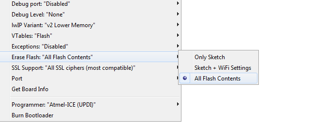

    When uploading the software from the project author's website, in the Arduino IDE I set : Board: "LOLIN(WEMOS) D1 R2 & mini". After uploading the software, my board (previously visible as ESP_25xxxx) "disappeared" in the list of available networks.
    Now also, when uploading WiFi.status(), I left the same settings.
    Is this a bug and is that why the problem persists?
    I would appreciate any suggestions.

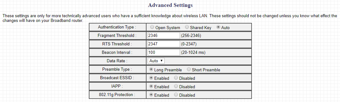

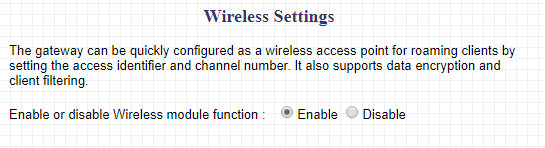

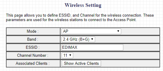

    @khoam removing the WiFi.disconnect() command doesn't change anything (it was added by the author to disconnect connections if there were any).
    BR-6204WG configuration:
    Touch does not work in the weather station on ESP8266 with ILI9341 Touch does not work in the weather station on ESP8266 with ILI9341 Touch does not work in the weather station on ESP8266 with ILI9341 Touch does not work in the weather station on ESP8266 with ILI9341 .
    After placing the command Serial.setDebugOutput(true) on the console I get:
    ....scandone
    no EDIMAX found, reconect after ls
    .reconet
    and it keeps repeating.
    Strange thing, because I have two phones and a laptop "hooked up" to this router. With the connection I had no problem, and with this module there is a problem.
    What is the issue here? :D .
    Mate @kaczakat - I uploaded the program for the AP and found my module in the network environment. Conclusion - hardware functional :D .

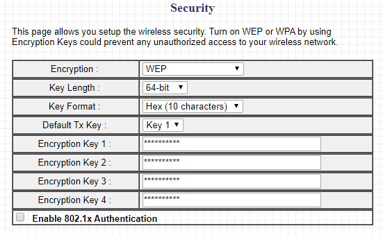

    Unfortunately, this router in "encryption" only has options: WPA, WPA pre-shared keey, WPA RADIUS.
  • #12 18579975
  • #13 18579986
    Gienek
    Level 37  
    Posts: 2776
    Help: 393
    Rate: 353
    At the moment, this is how I have it switched on.
  • #14 18579997
  • #15 18580005
    Gienek
    Level 37  
    Posts: 2776
    Help: 393
    Rate: 353
    Yes, sorry. I misstated the options. Should be: WEP, WPA pre-shared keey, WPA RADIUS.
    And I have WEP enabled.
    When I click on WPA pre-shared keey, the options appear: WPA(TKIP), WPA2(AES) and WPA2 Mixed.
    Just which version to use?
  • #16 18580036
  • #17 18580257
    Gienek
    Level 37  
    Posts: 2776
    Help: 393
    Rate: 353
    You are great :D I would never have come across that the password encryption system could have such an impact.
    Everything is laughing as it should.
    Thanks a lot for your help and patience.
