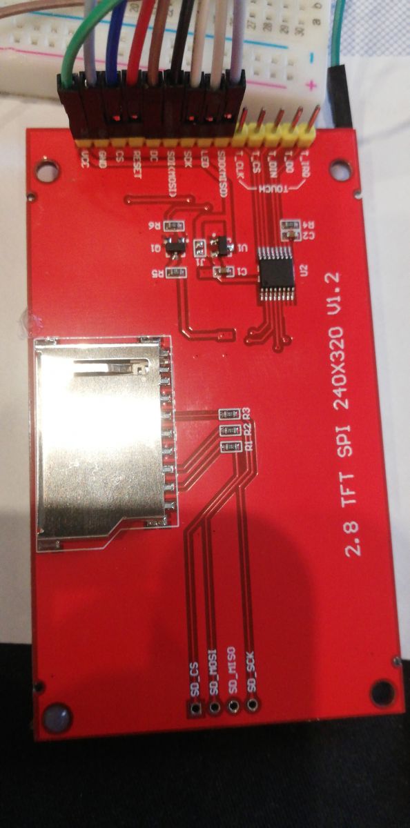

    khoam wrote:
    Maybe post a picture of the underside of this display module
    How to connect ESP32 to ILI9341 display? ArduinoIDE does not display errors. How to connect ESP32 to ILI9341 display? ArduinoIDE does not display errors. How to connect ESP32 to ILI9341 display? ArduinoIDE does not display errors. .

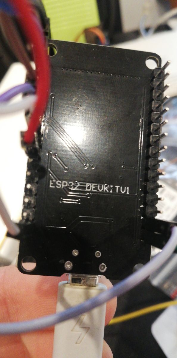

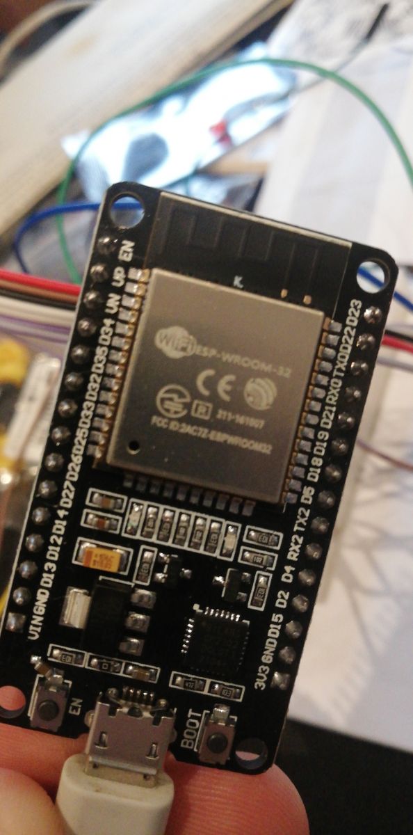

    khoam wrote:
    How do you power this display module?
    This is how I have it connected:

    Atypowy256
    Posts: 55
    Rate: 9
    The Vcc of the display is connected together with the LED to 3.3v in the esp32.

    khoam wrote:
    If this display is to operate with a 3V3 supply, then connector (pad) J1 on the display module should be shorted:
    Soldering and connecting the VCC to the VIN worked, thanks!
