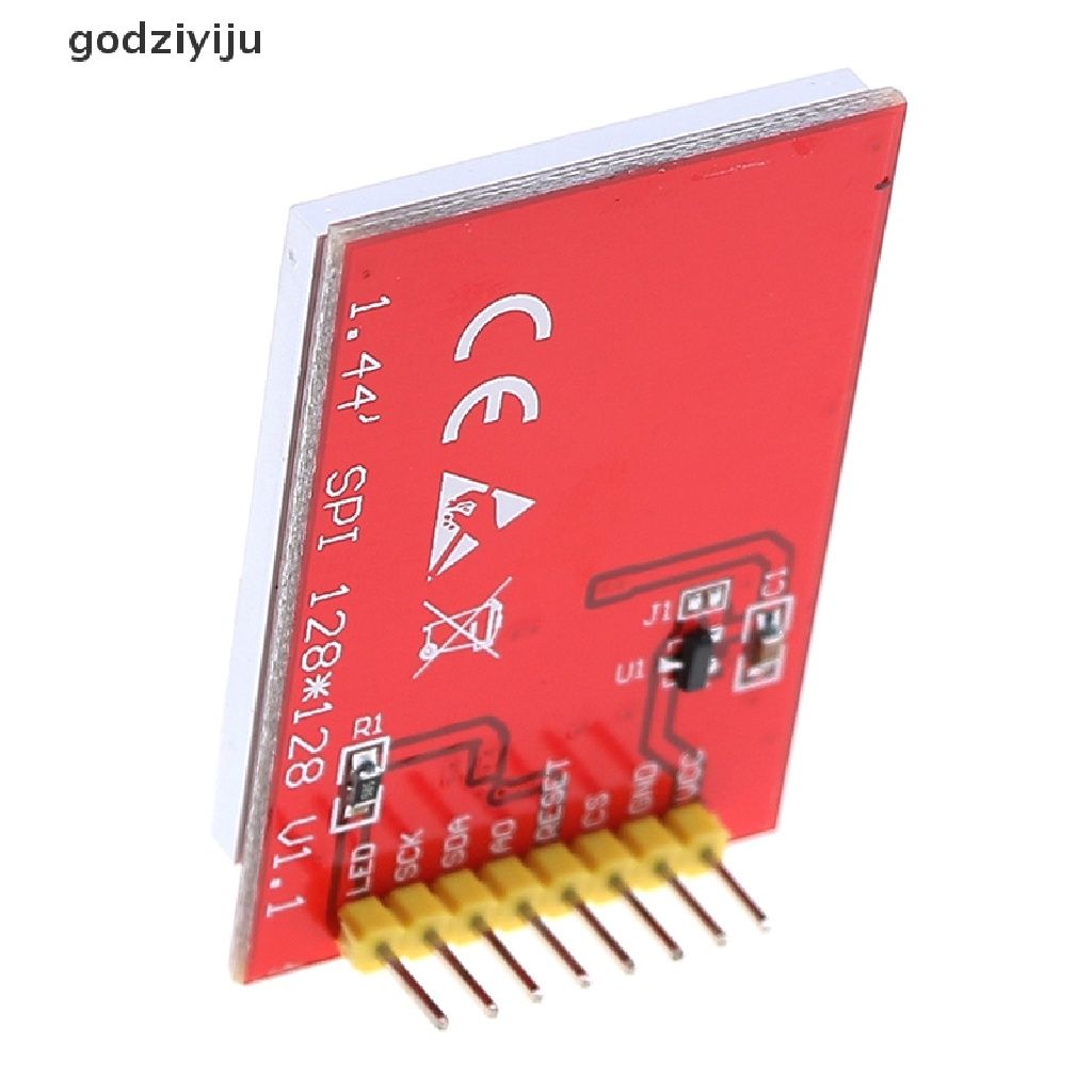

    Hello, maybe there will be someone to help me because I can't manage it myself.
    I ordered a regular 0.96" oled from myfrid, unfortunately or unfortunately the shipment included a 1.44" tft and I don't know how to connect it to the EspEasy for the hell of it.
    There are 3 ds18b20's and a dht11 connected to the board. Everything is working. The display was supposed to show sensor readings.
    Can someone help because I don't know how to connect the display. I can't find anywhere, maybe I don't know how to look.

    Standard outputs.
    How do I connect the TFT display to the EspEasy? I am looking for information. .
    Just where do I connect the rest of the pins.
    Vcc- 3v
    LED- 5v
    Gnd-gnd
    That leaves the rest of the pins

    Your display is probably not supported by ESPEasy. The most similar one supported is the ILI9341.
    Here is a description including wiring diagram and sources:
    https://docs.wemos.cc/en/latest/d1_mini_shield/tft_2_4.html
    Unfortunately I can't help much more as I am not familiar with this platform.
