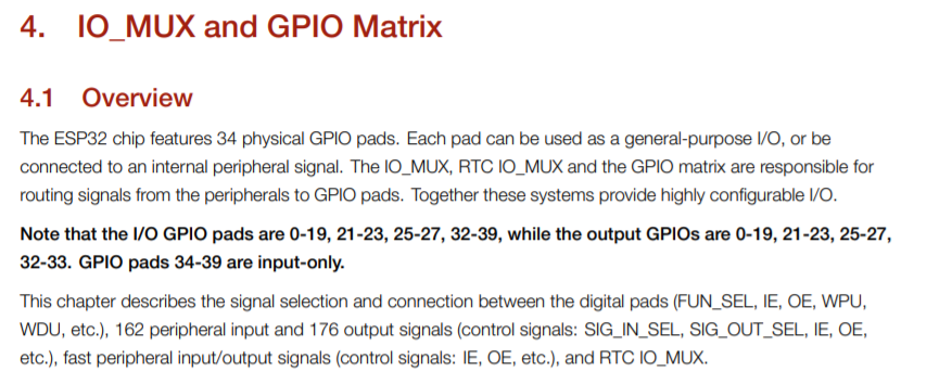

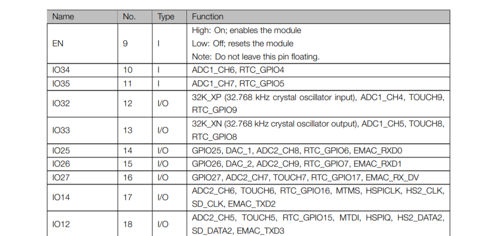

    Hi,
    I would like to connect several interfaces directly to the ESP32-Pico-D4 chip (I2C, UART, I2S, SPI). The documentation in one place indicates that the chip lead can be connected to any peripheral:
    ESP32-PICO-D4 - how to assign I2C, UART, I2S, SPI to pins? .
    and in another it shows what peripherals are available at a given pinout:
    Could someone more experienced share their experience and tell me how it is with this in the end? Can I connect any interface to any lead?

    #4 18480853
  • UART can be mapped to any GPIO except input-only pins
    #5 18482230

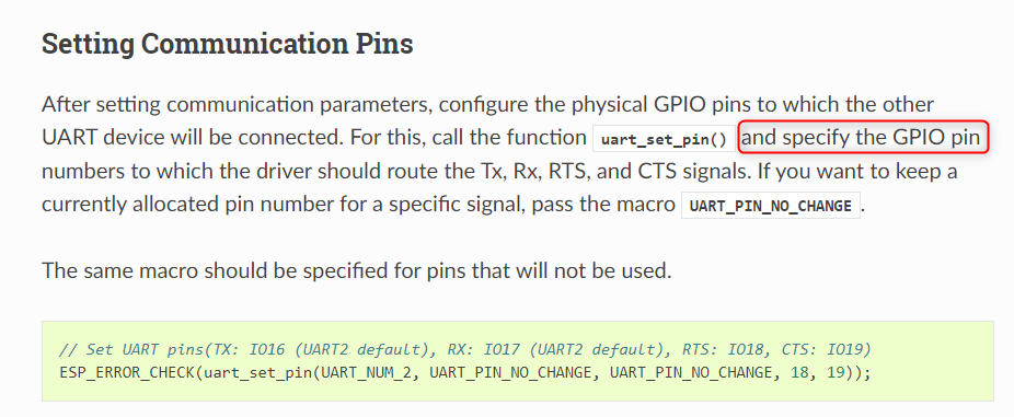

    padre_joseph
    Posts: 23
    Thank you for your help. Let me pull the topic further to understand the manufacturer's documentation.
    Assuming I want to configure the UART interface, I check the Manual attached by a colleague.
    It is stated that I can designate any GPIO pins to the interface, provided (according to the documentation) that I do not attach the TX (output) line to "Input Only". If I stay with the default settings, the interface will be attached to the default leads according to the table in appendix A.4 IO_MUX.
  • UART TX cannot use input-only GPIOs
