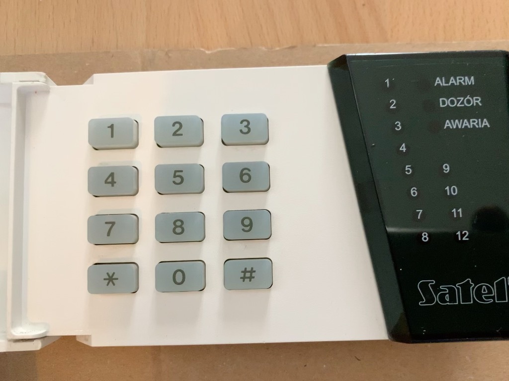

    Which keypad do you have? The one with the display or the one with LEDs only (KLED or K-LEDS)? The one with the display seems to have a dedicated chip built in so the communication would be different. The LED ones seem to be quite similar. Do you have any picture of the PCB of the keypad?
    I found only these images of the KLED from inside, but on this it looks like it is a CA6 keypad (no zones above 8). Actually, the PCB looks the same, so the communication would be the same to control the LEDs on it.
    https://sprzedajemy.pl/manipulator-led-satel-ca-10-kled-poznan-2-0010c9-nr61339881
    To look at the communication, it is better to start with the logic analyser and Sigrok PulseView. I looked at your spreadsheet, and it seems quite different from what I have seen from the CA6. Or somewhere the timing is off.

    I needed some time and finally, I connected the logic signal analyser.
    You are right the protocol seems to be the same. It was my mistake, I had changed CLC and DATA cable. Thanks for your help.
    I needed to adopt your program to run on ESP mini but it seems everything is working fine.
    Please see my LEDs mappings (my led numeration starts from 0 to 31). The minor difference compared to your findings.
    int LEDBits[] =
    {31, 29, 27, 25, 15, 13, 11, 9, //sensor/led 1 to 8
    -1, -1, -1, -1, -1, -1 ,-1, -1,
    19, //malfunction led
    21, //zone1 active led
    17, //zone2 active led
    23 //alarm LED
  • Logic analyzer confirms CA10 protocol and LED mapping
