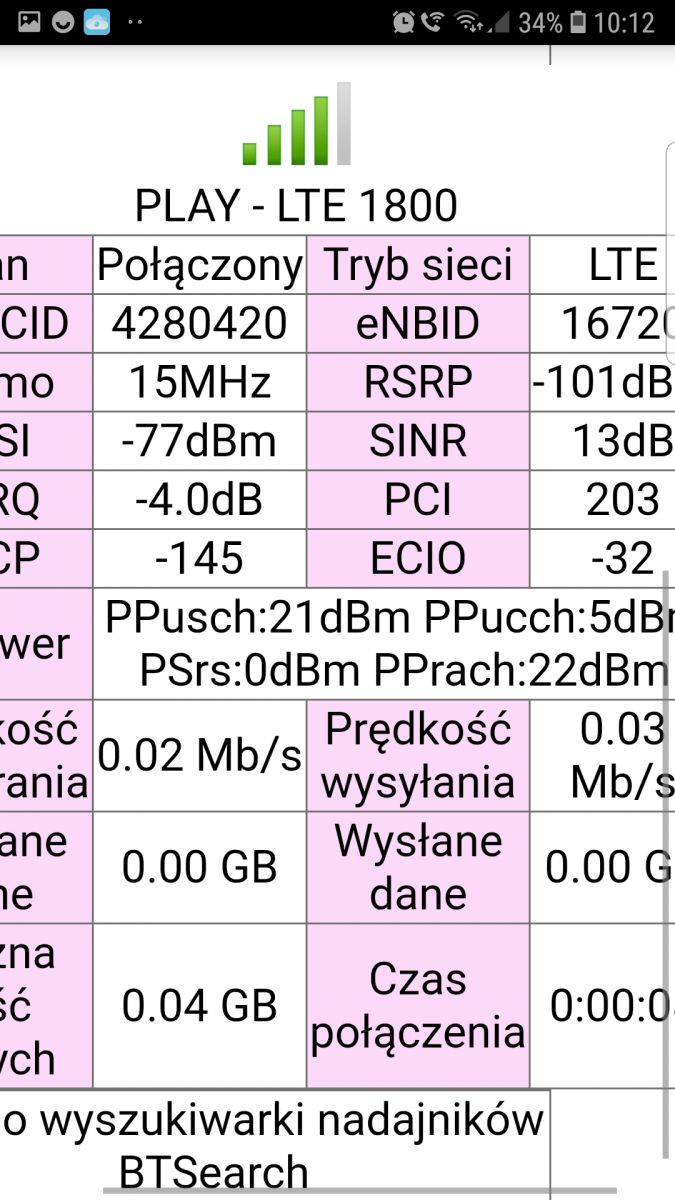

    hello, i also want to ask about the antenna for B818
    Best External LTE Antenna Options for Huawei B818 Router: Recommendations & Buying Guide
    1.9 km to the BTS
  • #38 18612214
    matek451
    Posts: 31253
    Help: 4352
    Rate: 5808

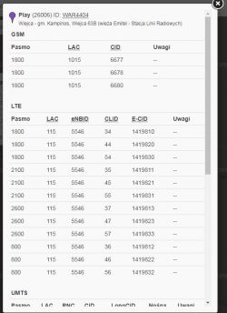

    Do you have this router? If so, at the beginning you do tests of single bands LTE2600, LTE2100, LTE1800 and LTE800. You force bands in the application on Android http://www.mediafire.com/folder/95m83y3qalgbv/B525s_-_23a or on Windows https://drive.google.com/drive/folders/1K1-S4ygFsS9GNdXmcEy4dQ9smsP8ksL4 and show speedtests from them test with b818 outside the window. These are the primary diagnostic tools for Huawei HiLink. Let my colleague, the author of the topic, use them, and check Play on LTE2100, lte1800, LTE800 and Plus on LTE180, lte900.
    At the beginning of a healthy and happy Easter :)
    @ matek451 as soon as there is a chance to arrive tomorrow, I will try to do the tests. B818 outside?
    Thanks for the links with the tools :D

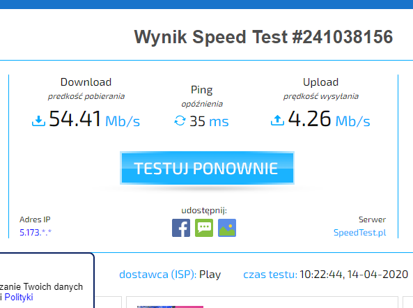

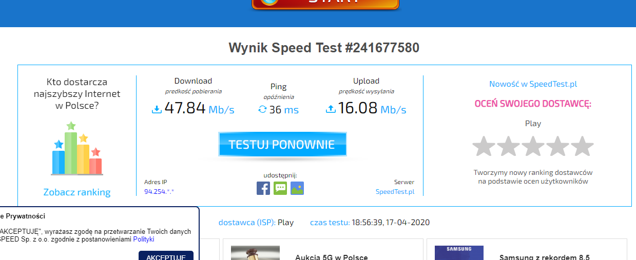

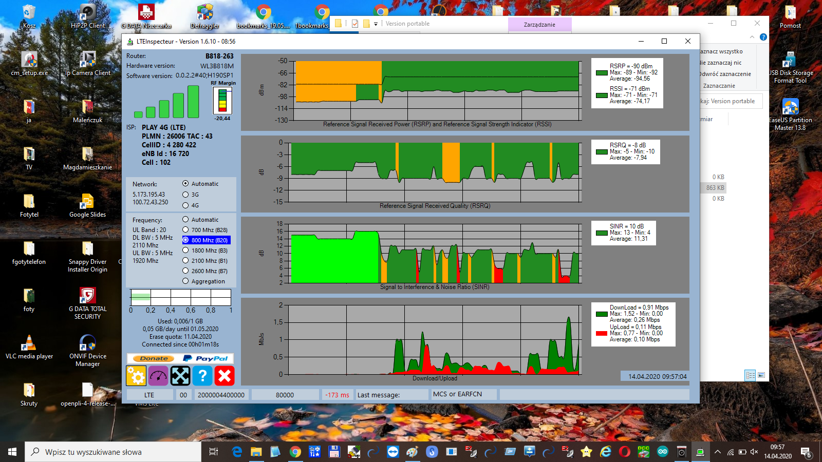

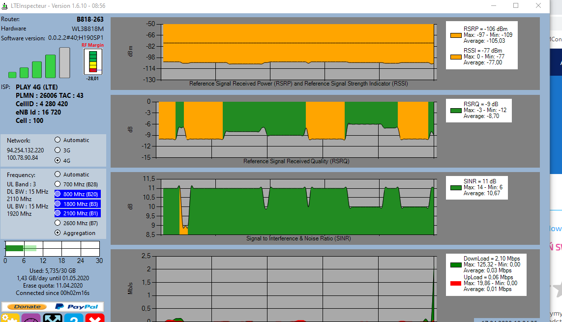

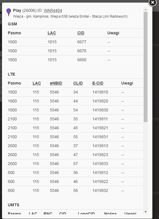

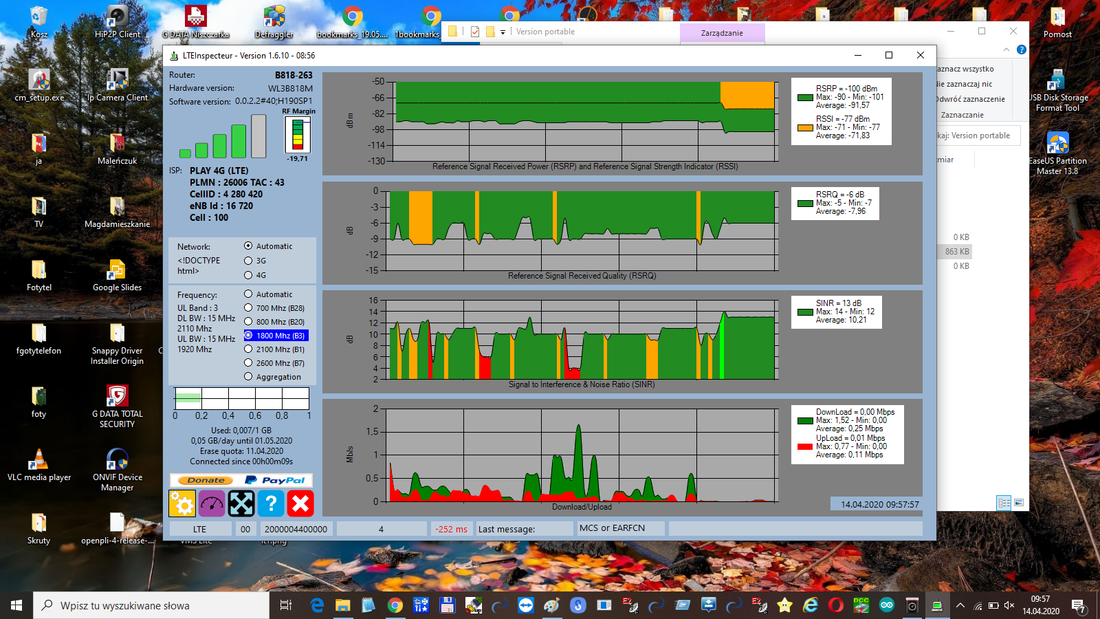

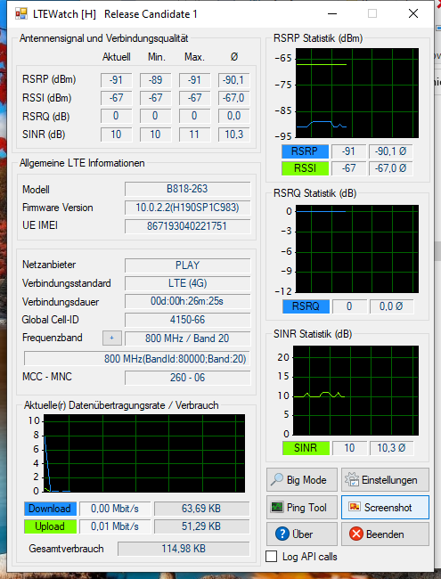

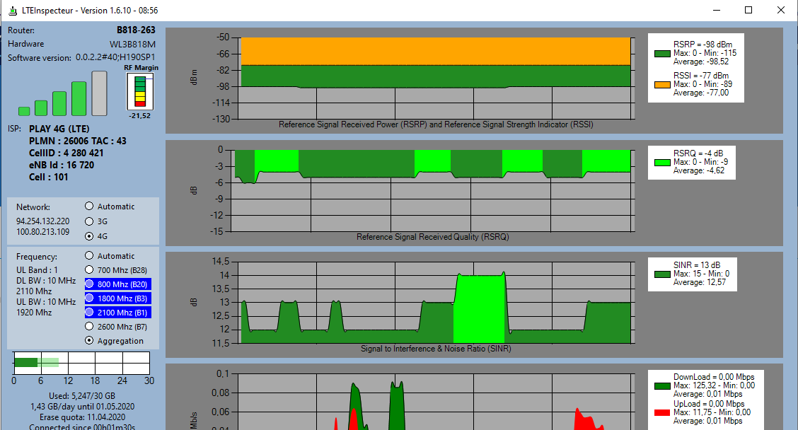

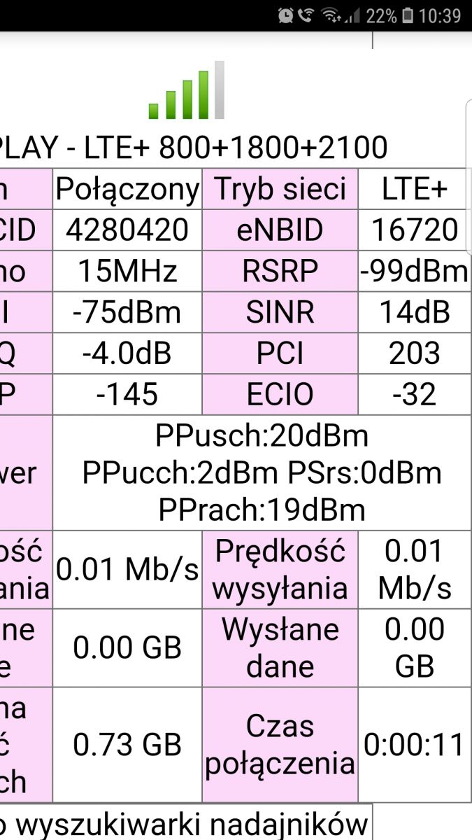

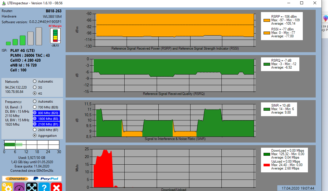

    Unfortunately, I can't in the evening, the results are in the morning

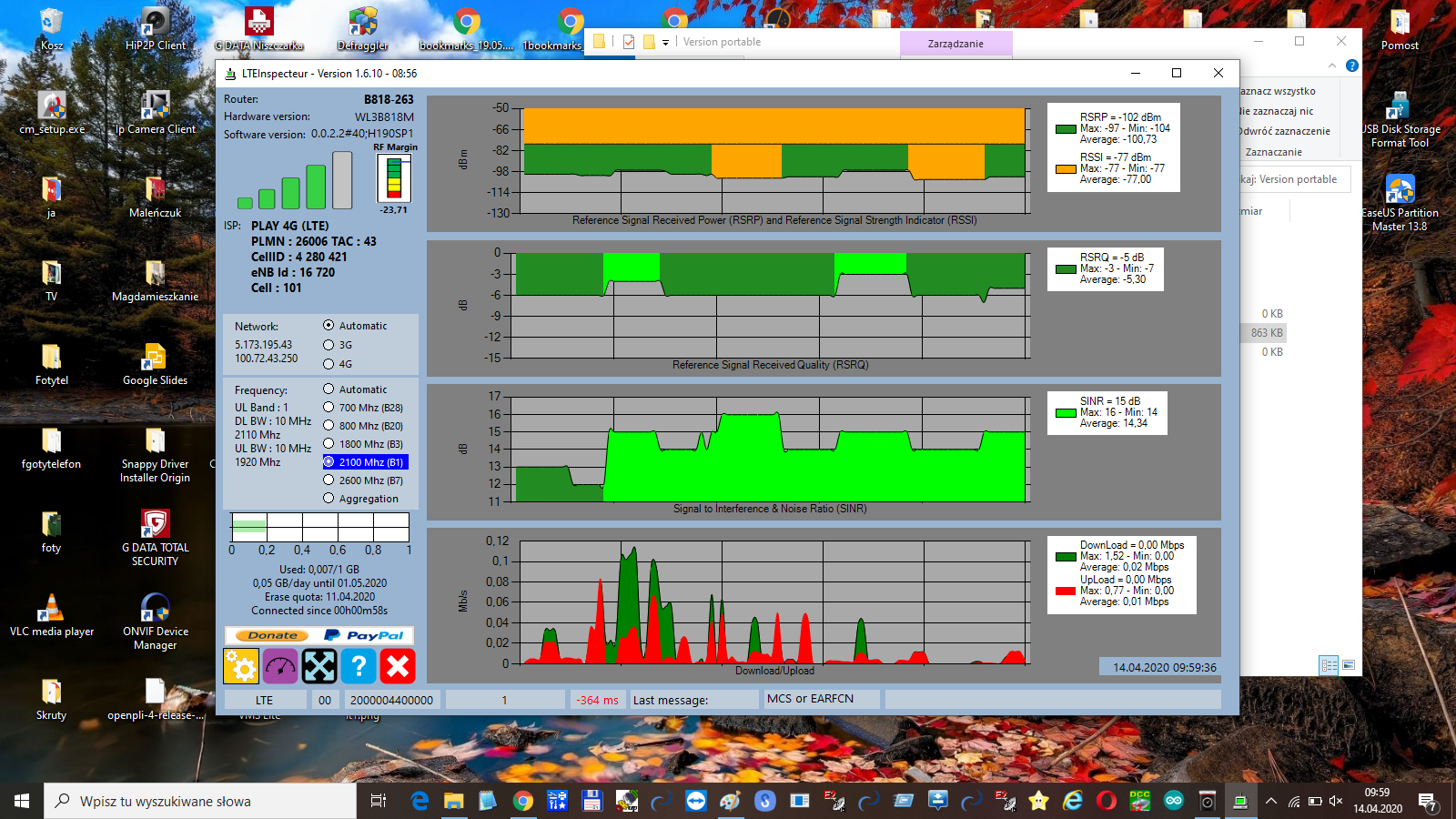

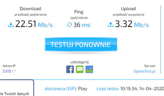

    Best External LTE Antenna Options for Huawei B818 Router: Recommendations & Buying Guide Best External LTE Antenna Options for Huawei B818 Router: Recommendations & Buying Guide Best External LTE Antenna Options for Huawei B818 Router: Recommendations & Buying Guide Best External LTE Antenna Options for Huawei B818 Router: Recommendations & Buying Guide Best External LTE Antenna Options for Huawei B818 Router: Recommendations & Buying Guide Best External LTE Antenna Options for Huawei B818 Router: Recommendations & Buying Guide Best External LTE Antenna Options for Huawei B818 Router: Recommendations & Buying Guide Best External LTE Antenna Options for Huawei B818 Router: Recommendations & Buying Guide Best External LTE Antenna Options for Huawei B818 Router: Recommendations & Buying Guide Best External LTE Antenna Options for Huawei B818 Router: Recommendations & Buying Guide Best External LTE Antenna Options for Huawei B818 Router: Recommendations & Buying Guide Best External LTE Antenna Options for Huawei B818 Router: Recommendations & Buying Guide Best External LTE Antenna Options for Huawei B818 Router: Recommendations & Buying Guide
    They arranged a bit chaotically but I guess it doesn't really matter.
    If I have a selected frequency or selected aggregation 800-1800-2100, does this setting stay?
    Speedtest on aggregation practically all the time down 50 up 5
    The router is placed on the roof of the Dutchwoman, then inside and the results are similar.
    The external antenna should help now the question of what?
    One more thing, despite these parameters, control and view of the shadow.

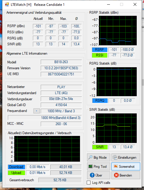

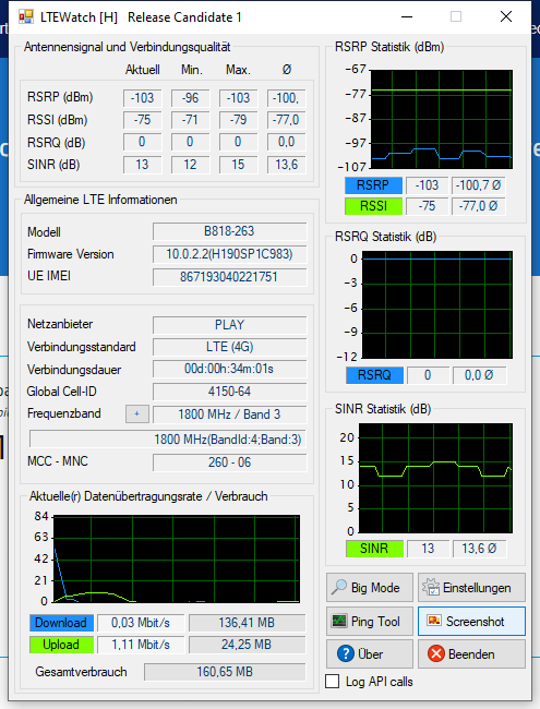

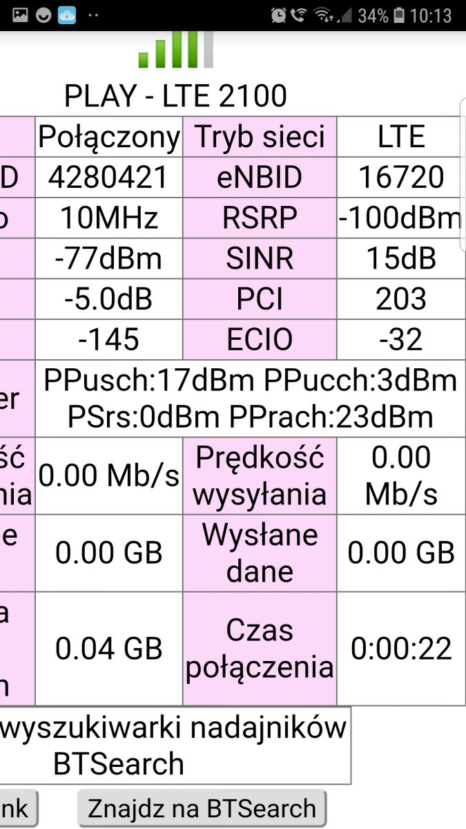

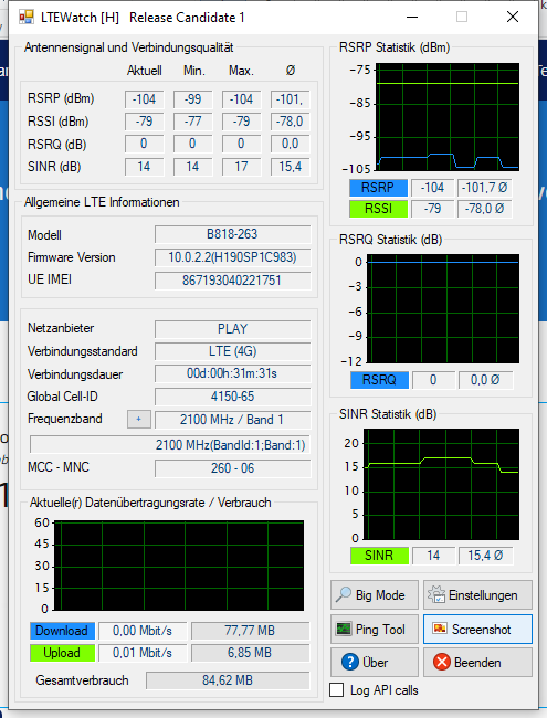

    Connection with BTS in Pełczyce. Perform speedtest on each forced band.
    As for LTEWatch drops, signal at 800 weak enough at 1800 and slightly worse at 2100.
    When it comes to HManager, there is also no chronology, although the last speedtest is much better, but the tests were unfortunately done in the morning ...
    In the aggregation of 800 + 1800 + 2100, the signal is sufficient, at 1800 - weak, and similarly at 2100.
    At the moment, you need to buy an antenna for the 1800-2100 MHz band.

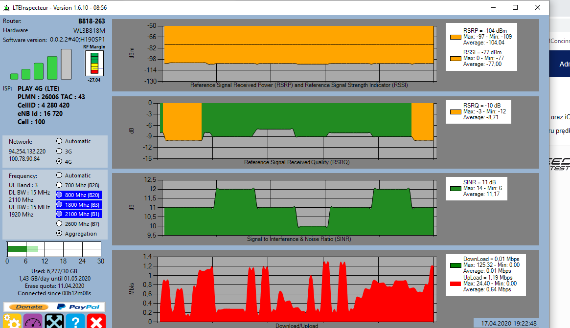

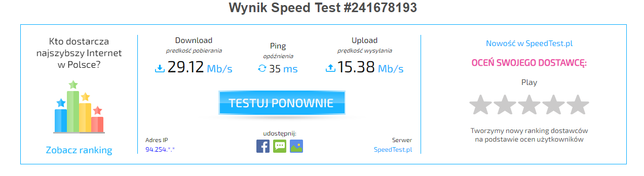

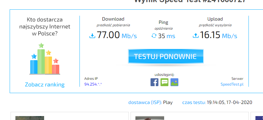

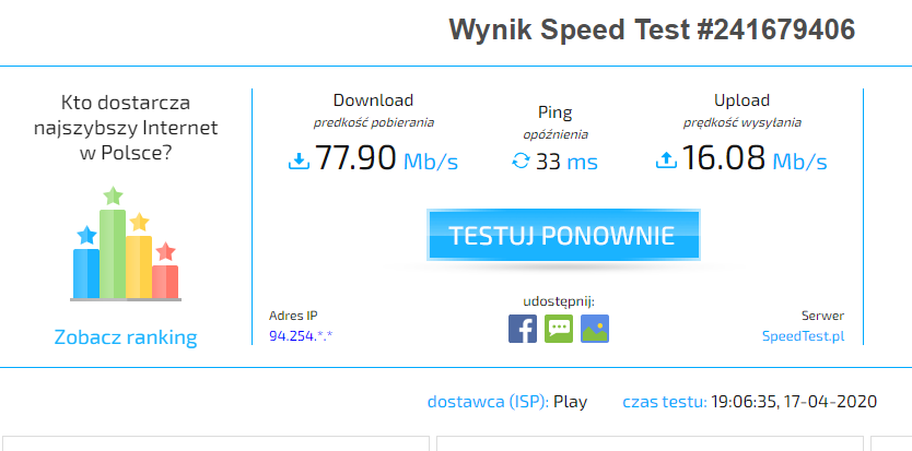

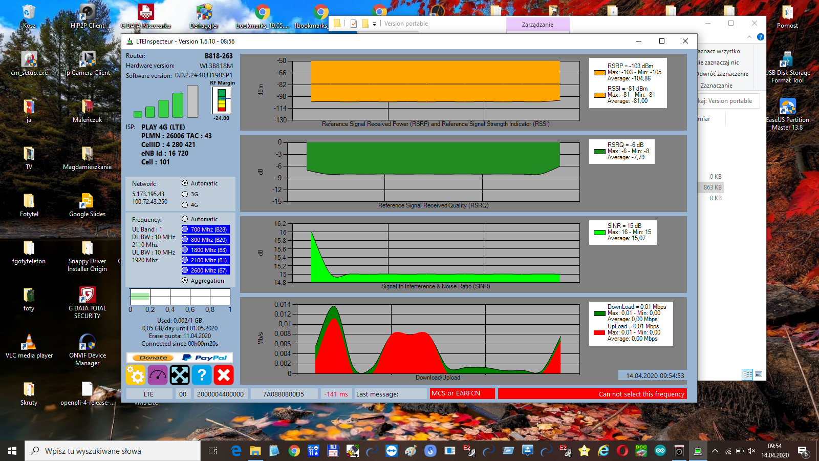

    This is what it looks like after connecting the ATK 502
    There is no madness with camera control, there is an improvement, but it is far from what I would expect.
    Why does it work smoother on this old router from TP-Link, despite lower transfer rates?
    And now I do speed tests they are worse and the cameras can be controlled better :( > What kaman? The results are worse and it runs smoother. I got lost

    Basically yes, with everyone. I checked the bands different. And d..pa. Now at this time, despite the fact that from the tests I am doing, the control works OK. What K..wa kaman. I am not a hazel grouse taken from somewhere and now I am starting to give up because I already lack ideas :(
  • #59 18626275
  • #60 18626469
    kameleon11116
    Level 26  
    Posts: 899
    Help: 72
    Rate: 129
    Now I do not have to take a screenshot (the other half took me from the site :( :( ) but after logging into the router it showed that two external antennas are connected. :( . Three cameras are connected, two for WiFi and one for WiFi and LAN
    There is only a cable and connected cables, then an adapter to the router.
    When I unplugged the antenna it was immediately worse.
    now at this time) (22:21) from home it was great on the computer and on the smart.
    Each touch of the up-down, left-right zoom is visible immediately.
